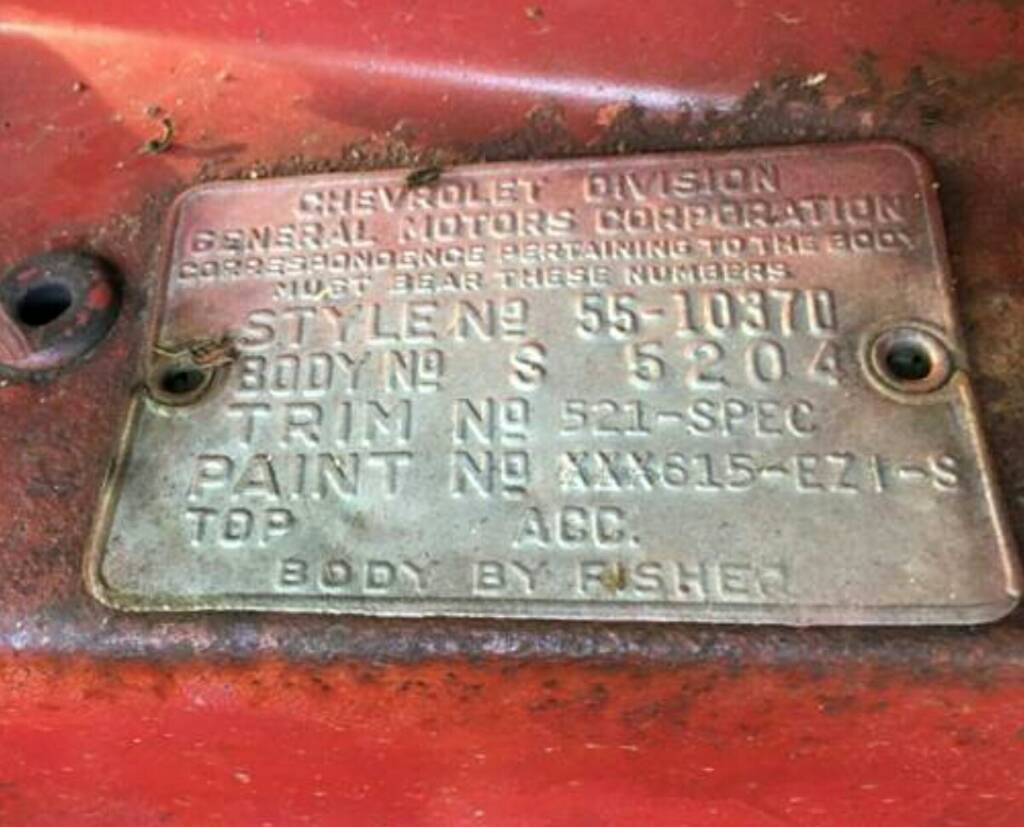

    Hey everyone I have a question about a 55 chevy I'm looking into buying and it's got a weird trim tag. It has stampings that I've never seen before. Trim tag reads as this....
    STYLE NO. 55-1037D
    BODY NO. S 5204
    TRIM NO. 521-SPEC
    PAINT NO. **X-615-EZI-S
    TOP. ACC
    Now I know it means it's a 55 sport Coupe Bel-Air and it was shoreline beige and gypsy red inside and out but the SPEC STAMPING and the **X is throwing me off because I know the EZI means tinted gl*** if anyone could help me out with this it would be greatly appreciated

    SPEC usually means the paint combination is reversed or altered from the factory style in some way, sometimes it's the dash that's changed in color or the interior garnishes. St Louis Fisher Bodies stamping **X by the paint code prompts the line to take note of the order. The S would probably mean Power Seat. EZI is of course tinted gl***.
    The BODY No. S5204 means it was the 5,204th BelAir Sport Coupe made at St Louis Fisher Bodies.

    Here is pic of trim tag it's a lot different then most important thing seen.

    It looks like the **X was stamped over another number, as if they changed the tag while making it. But I could be wrong, the pic is pretty good, but not quite close up enough, or high enough resolution.
