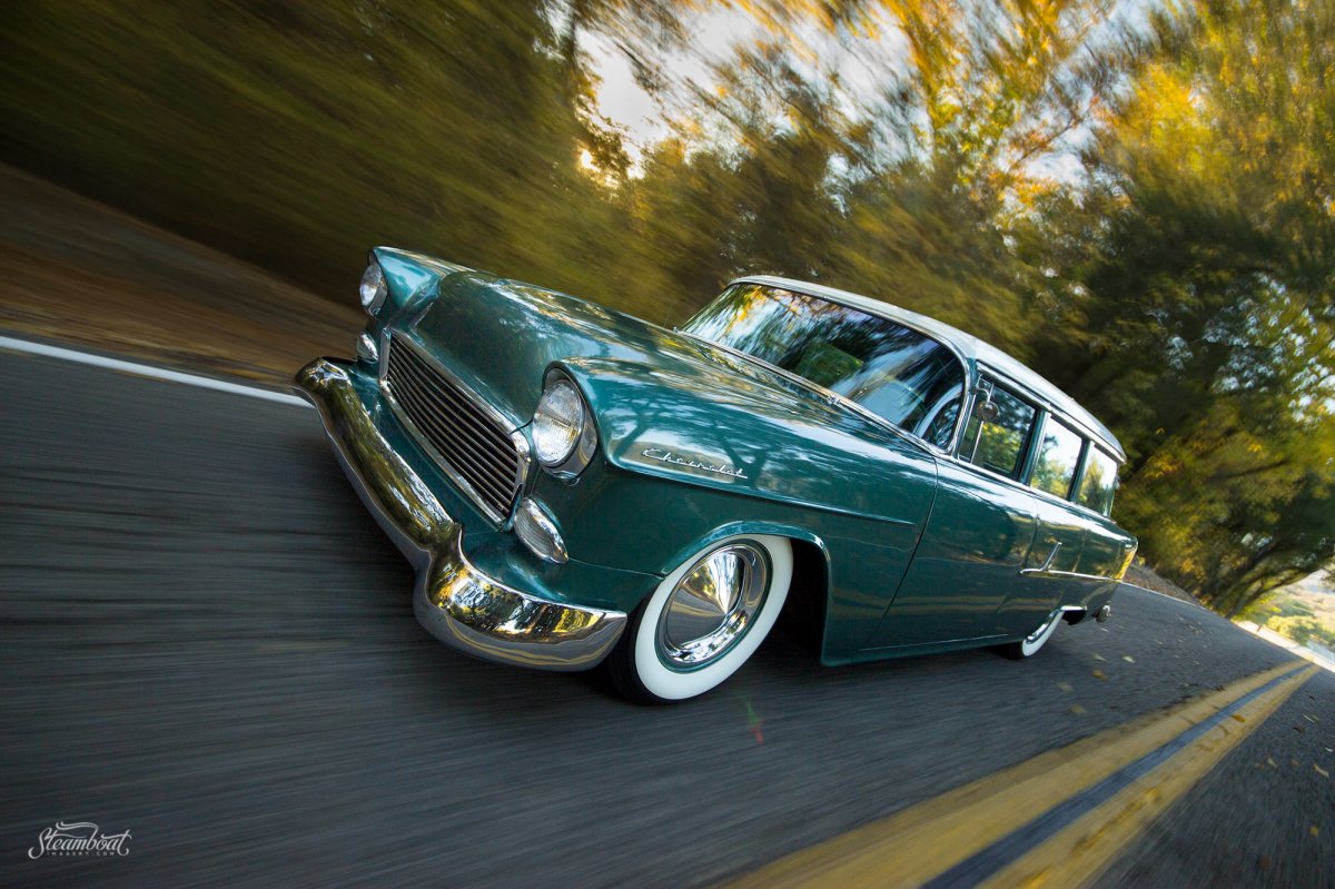

    2 in. dropped spindles with 2 in. lowered coils that I cut 1 more coil out of, and 3 in. blocks with saggy leafs. Jaybird1@.jpg
    SS327, HerMink, j hansen and 3 others like this.
  3. That looks killer, any other pics? Any issues with being that low?

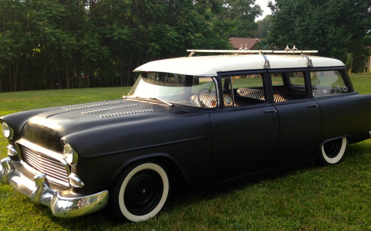

    No issues besides the occasional s****e on sped bumps and drive ways. Jaybird2.jpg Been running it like this for 20+ years.

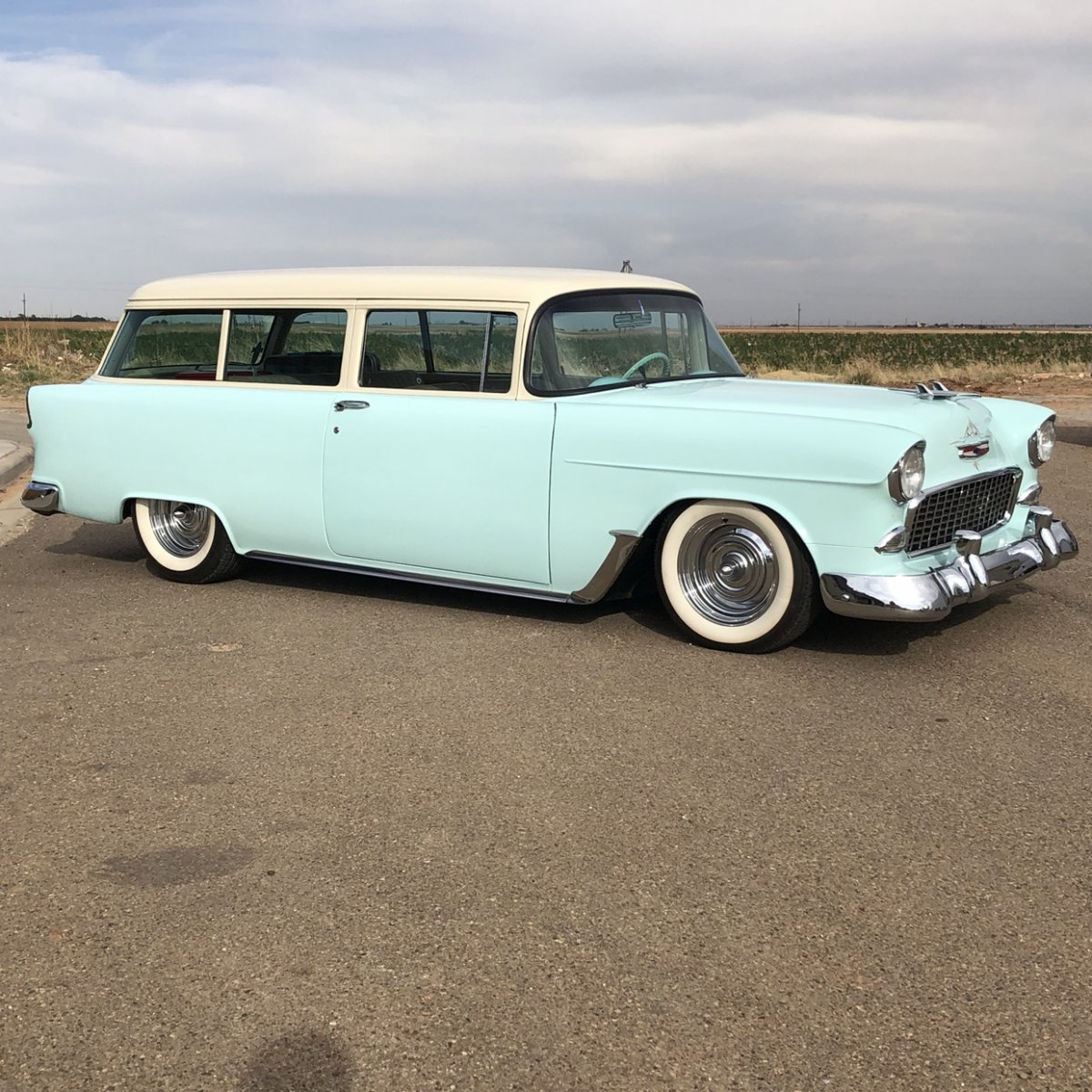

    Posie dropped rear springs, plus 1" blocks and lowering coils only, in the front. Still debating with myself on dropped spindles or not. Leaning towards leaving it for now. DSC02926.JPG

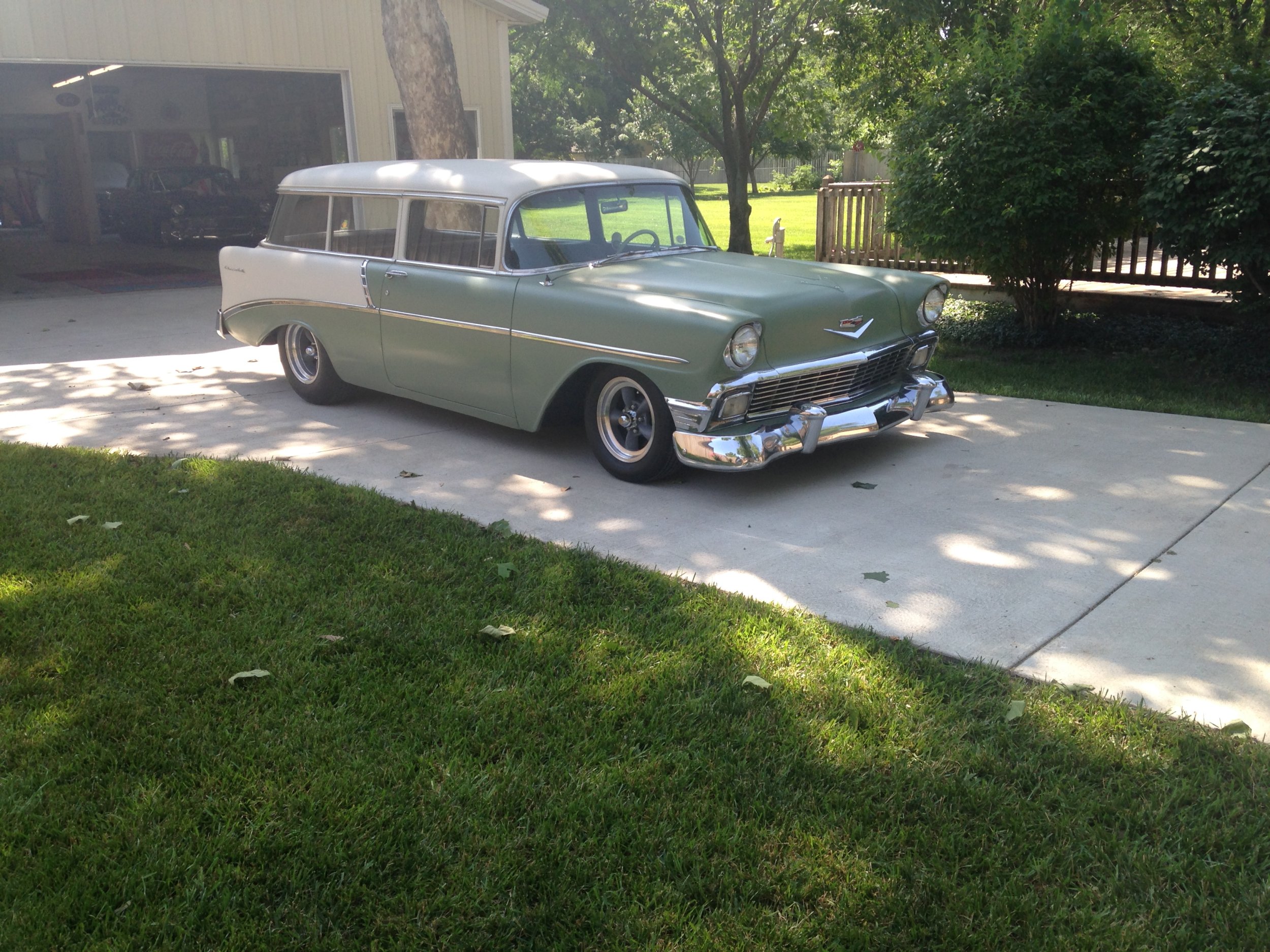

    2” dropped spindles 2” springs 3 “ dearched springs in rear without overload spring rode good

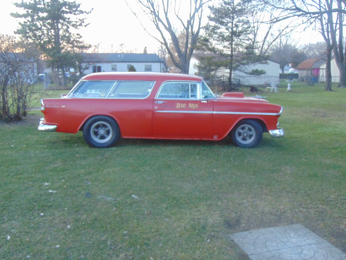

    [​IMG] [​IMG] 3" front drop springs from a 61 impala, (Because I had them from an old build)and 2" drop leafs from Dan Chuk, Rides and drives like new,
