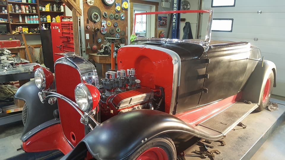

    Hi, I’m new to the site and I’m building a 1932 Chev Cabriolet. I’m doing it in traditional style. It has a 66 327/350 combo. I recently found a tri pak manifold with Rochester cars. I m having issues with alternator mounting now, as the front carb and filler neck are now in the way. I tried the driver side like mount but it won’t clear my steering linkage. Also we have found that the distributor cap rests on the rear carb slightly. Any one that is experienced with this situation? Thanks Darrell

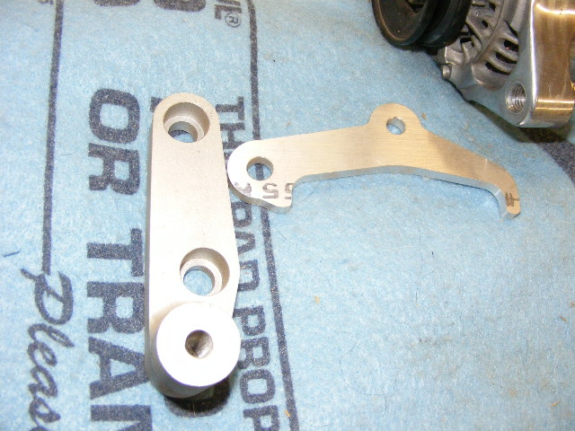

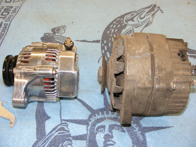

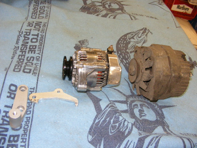

    Here's what I run in most cars/trucks that don't require a lot of Amps. This one puts out 70 I believe. Looks like your running a short water pump?. The bracket in pic is drilled for a BBC but the SBC looks the same................................

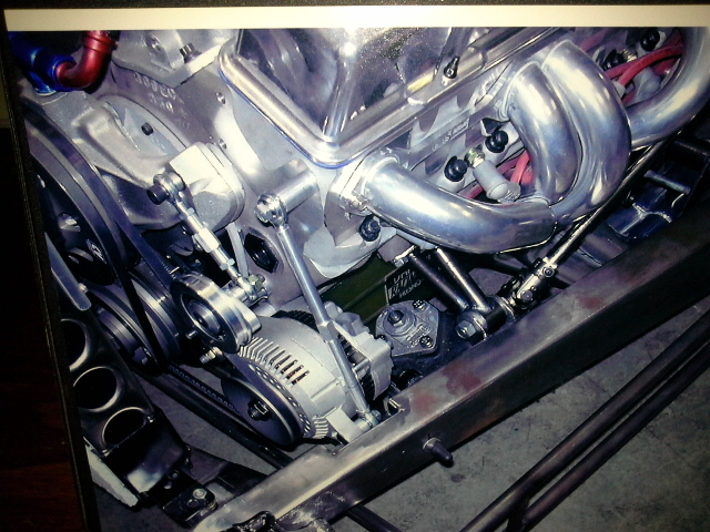

  17. DDDenny
    Posts: 22,856
    This is a full size alt. from Ford Motorsports, was tight but rectified it in short order.
    None of it came out of a kit either.

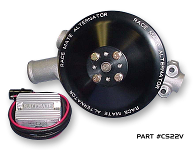

  18. brigrat
    Joined: Nov 9, 2007
    Posts: 6,081
    brigrat
    from Wa.St.
    2 words, Race Mate, or put together one word....................................

  22. The little fork truck alternators are great on simple hot rods.
    With a little digging you can get them easy enough and very reasonable.
    Or you can pay too much for the "race alternator" in an easy to find kit with great tech support. They've also got the brackets and mounting all figured out for you it's TOO easy but you pay for it.
    mad mikey likes this.
  23. The racemate is pretty damn slick.
    It like the guy took apart his Harley stator and said hummmm? Wonder if this will fit on a Water pump. Very ingenious

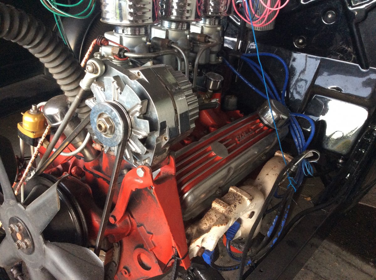

  27. manyolcars
    Joined: Mar 30, 2001
    Posts: 9,609
    manyolcars

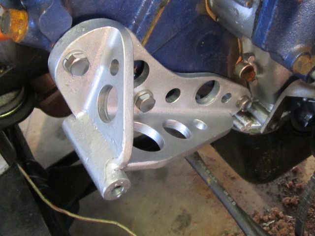

    I made this bracket to mount down low on the p***enger side
    I've never heard the term Tri Pak before

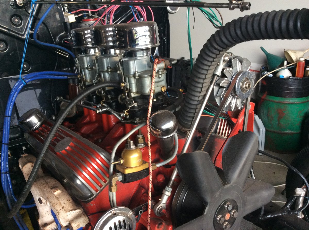

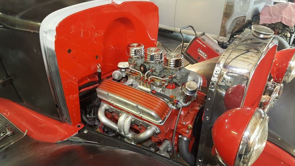

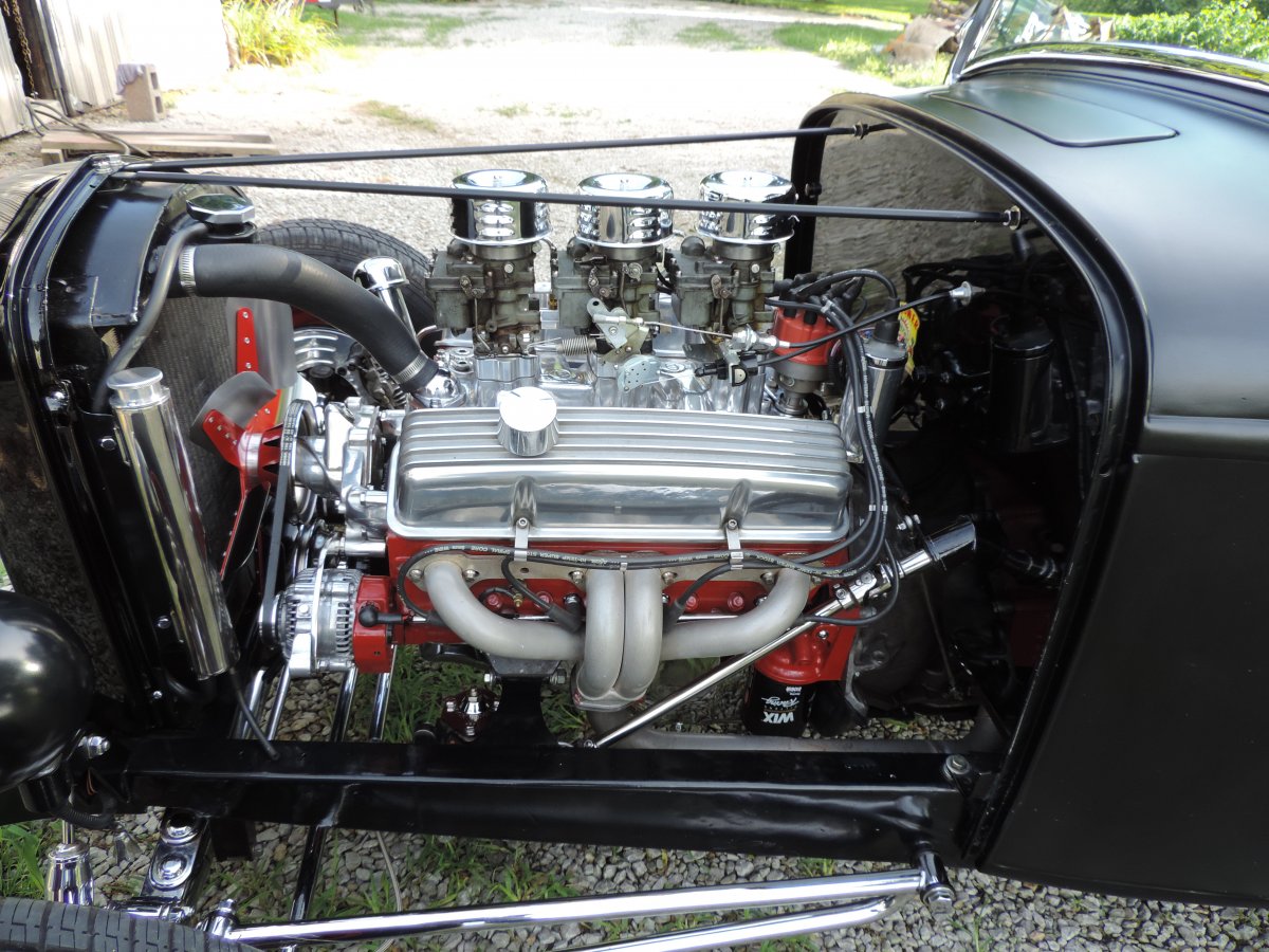

  29. Here is the ‘57 283 in my ‘34 Chevy. The gen bracket is a Jitney Jake Jacobs item. (I think he made an alternator version too?) ‘57 distributer. Edelbrock C357 intake.
    I could have made something off the Fenton bosses but switched to those later.
  30. flynbrian48
    Joined: Mar 10, 2008
    Posts: 8,757
    flynbrian48
    I am intrigued by your exhaust manifolds, I've never seen dual outlet, cast manifold like that. Or, am I seeing things? ;-)
