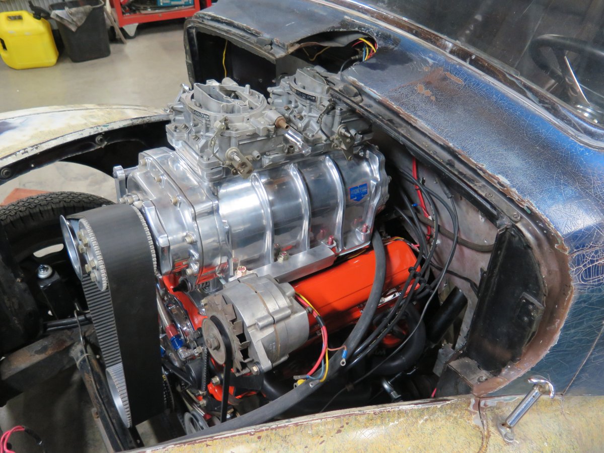

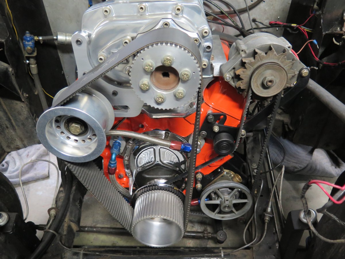

    Just a few thoughts. This "hide the alternator" problem has been around since generators and alternators were invented. Since it's a necessary part of any street driven car I suggest that you just accept it as a necessary part like a waterpump or a distributor and move on. You're not building a Riddler contender. Use a generator or early alternator, detail it nicely, and if you can't get it down low along side the balancer, and mount it up top where it fits best. Make brackets that resemble factory parts. I personally don't care for the look of a late model alternator on a period styled engine especially the imported ones.
    Making your own brackets is fun, an exercise in problem solving. You can mount the alternator solid and add an adjustable idler somewhere else if need be. Though it may lose the period correct vibe. Here's what I had to do to get the alternator mounted on my Austin street g***er. Kinda matches the "home made" look of the rest of the car.

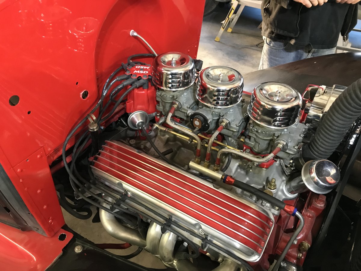

    As far as the distributor goes; on my roadster I had an early 3x2 manifold and the '57-up distributor. I had to grind off a little of the manifold where it interfered and also a little of a corner of the distributor cap to get the vacuum canister in the right location when the timing was set right. It didn't take much.

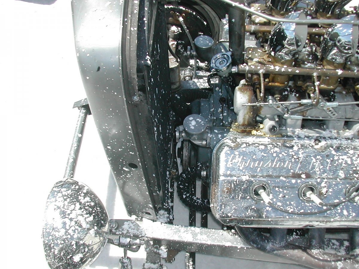

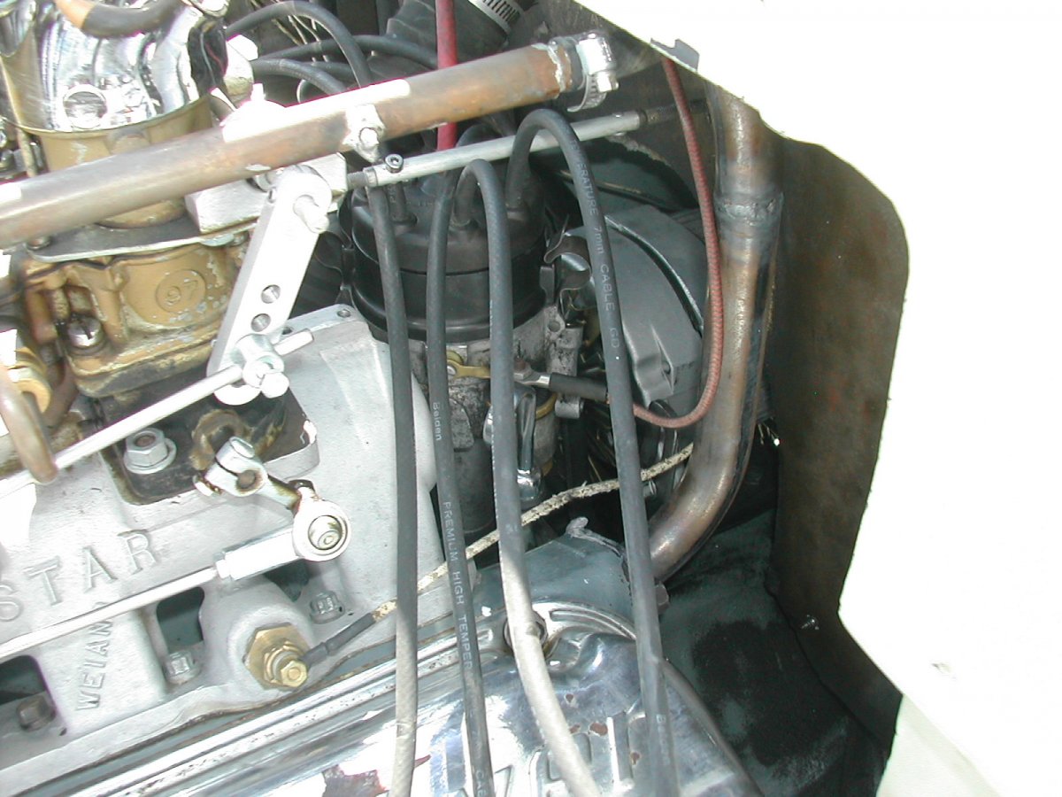

  18. Since photobucket has destroyed the Internet this will have to do.
    To remove the belt you need to slide the converter back, IIRC the alternator goes thru an access door in the fire wall. Kind of a pain but how often do you need to do it?
    We just did an alternator job on a 05 ford. We had to drop the cradle down a few inches and pull the steering rack 1/2 way out. That was a stupid ****ing job:confused:o_O $1500 was the going quotes around this area. We were 6 hoses and 5 electrical connections away from dropping the whole thing out the bottom.
    He also moved the water pump someplace,
    See the hoses looped under the block
