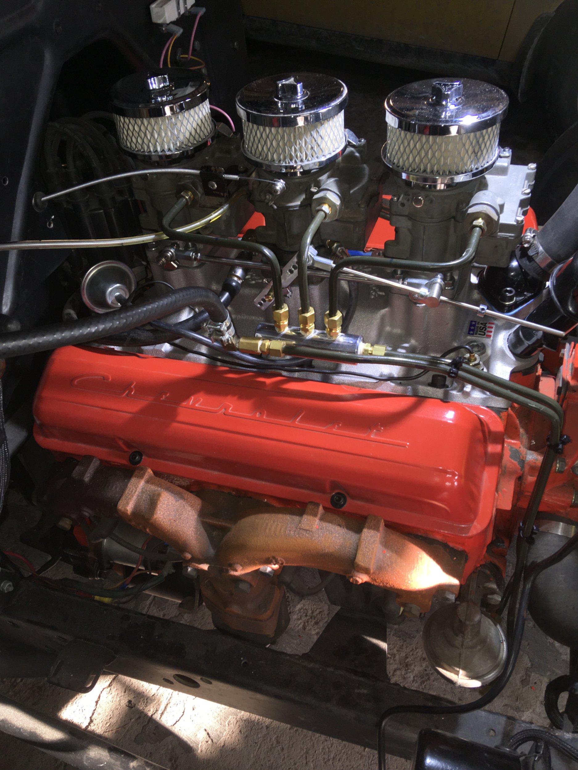

    It looks like the end carbs still have there idle circuits. I no experience with the adapter but you have the start of a diy tripower setup. IMG_1465.JPG
    This is mine.

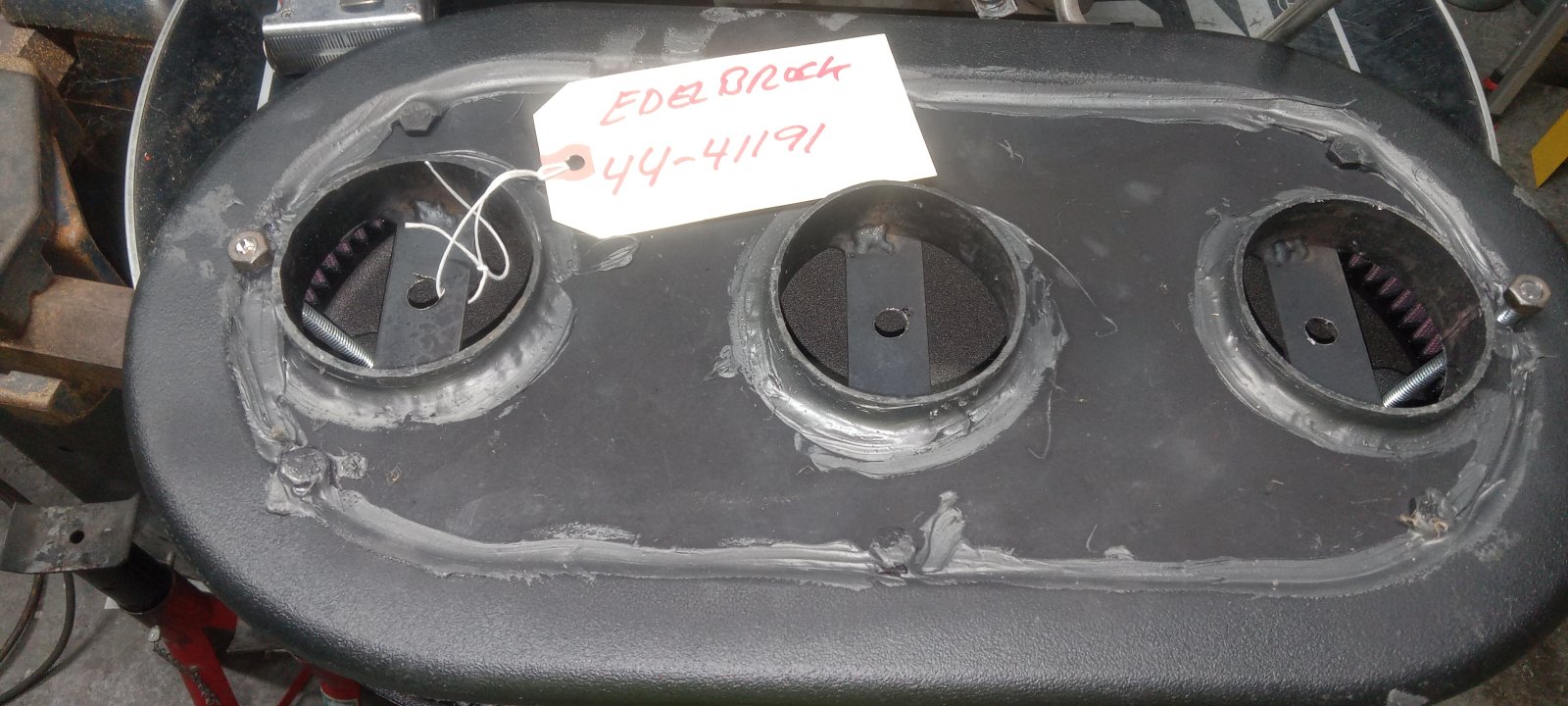

    Top bolts on with weird angled bolts the original bottom is 2 4bbls. Somebody made this trip hack job bottom. Let me know if you want me to measure something.

    Yours is for the dual 4 set up. I like that top better.

    No, it's for a 3x2, the top's holes line up with the end carbs air cleaner studs, the base is the same heavy cast aluminum.

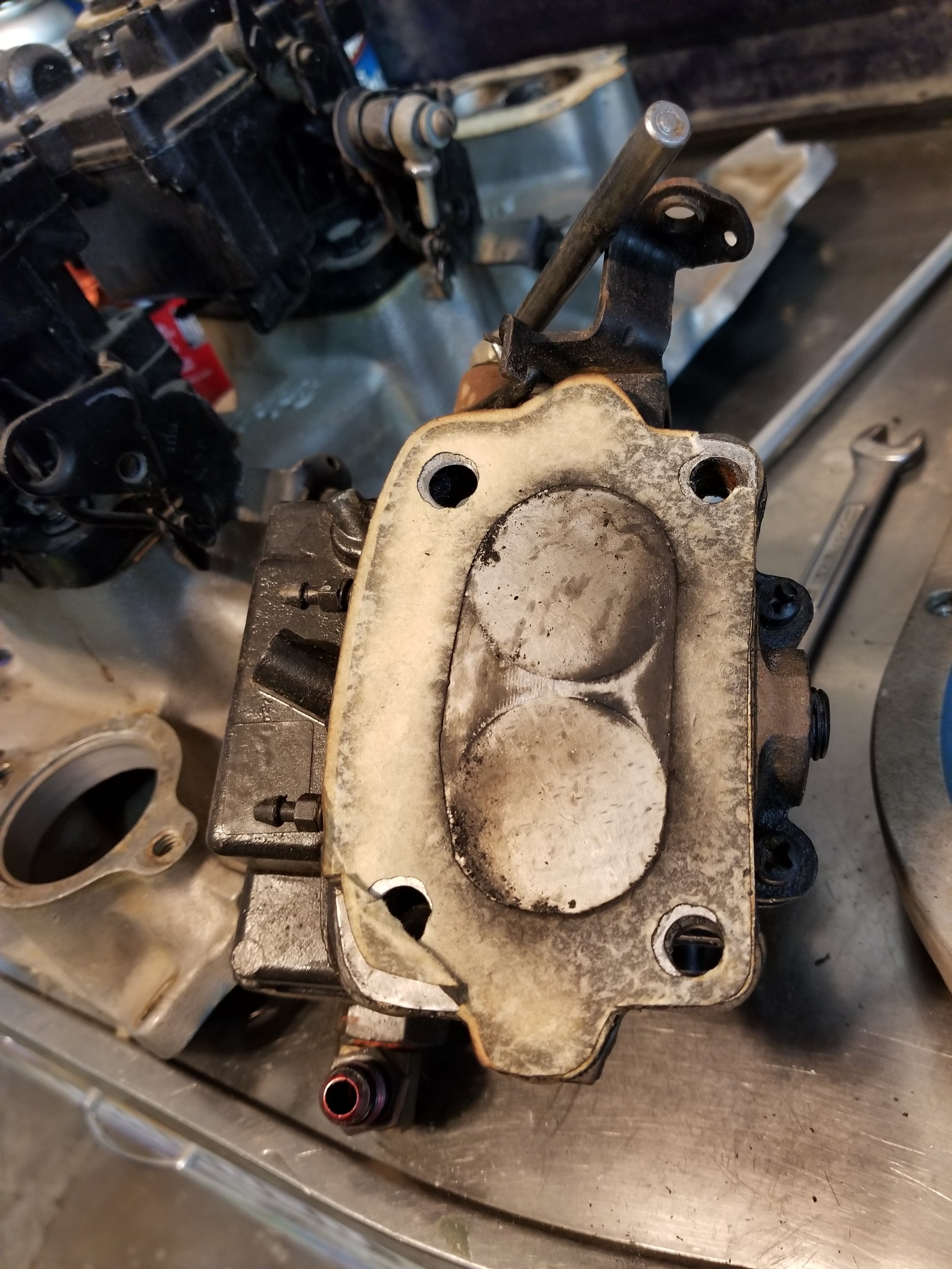

    I thought mine was a nice setup until I took the carbs off, both end carbs had block off plates under them and the throttle blades removed.

    Were the idle mixture screws at least turned closed. :)

    He didn't need to!
    The float levels were adjusted with ball bearings in the fuel hoses to the end carbs :p
