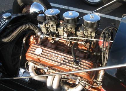

    I'm running a 400 SBC with 3 2Gs, converted from all primary carbs with the linkage on one side & i have no problems at all.
    Heres some pics!
    JimV

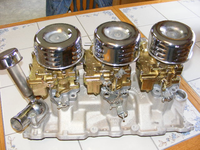

    I started this thread a couple of weeks ago, lots of research later/ listening to advice and this is what i have bought...
    I think its a good start for my first tri power build.

    This is how i set mine up at first, looks good but you would not get full travel out of the secondaries! The primary will be open alot before the secs even start to open up when the pri is fully open the secs will only be about 1/3-1/2 open.If you look at what you have the arc of the pri is the same as the sec.the pri linkage would have to be way higher on the arc & the front carb was down( Kind of like a big sprocket turning a little sprocket).
    run a search & look for the type or "blade" setup i used, i got it off here.trust me i went all thru this.
    JimV
    PS if you changed the "ratio" it makes the pedal too hard to step on.Plus you would need another collar behind the "block" on the front carb to make sure it closes all the way.
