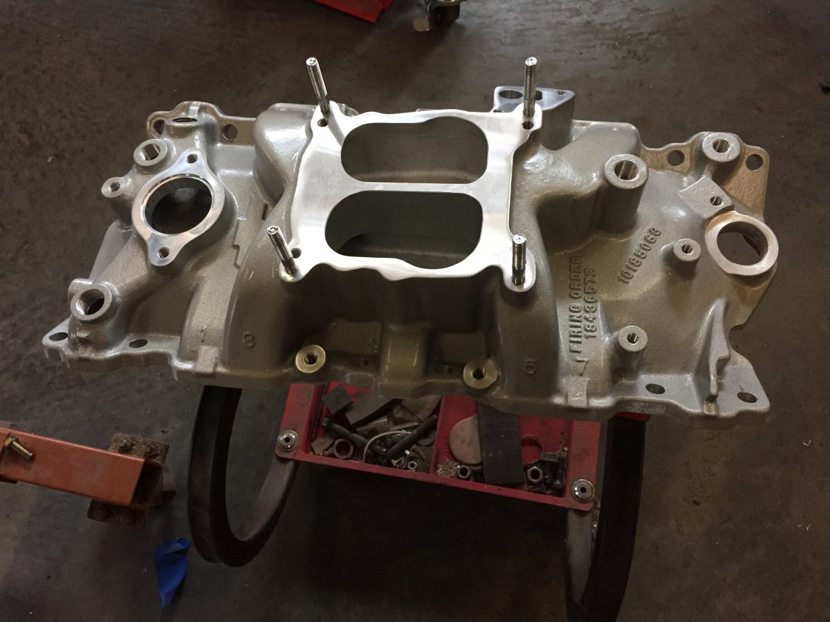

    I need some ideas on changing the factory cast finish. Been working on the 35 International and am changing out the single carb to Tri power. I'm not real excited with edelbrocks finish on the new intake so before I mount up the carbs I thought I'd get some input from you guys, cast paint finish, maybe a light grey, satin or flat clear coat?
    I appreciate your input!

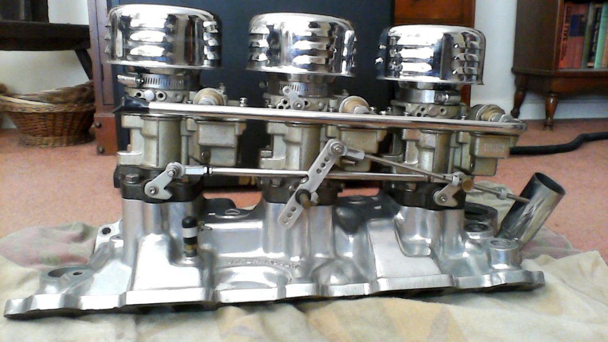

    Sold this one I had, Offy intake powder coated silver, looked like polished intake with some texture. WIN_20160212_114535.JPG

    You mean you are going to put three carbs on a single carb manifold? Look like it in your photo.

    OP, I see a picture of a truck and one of three carbs. No intake.

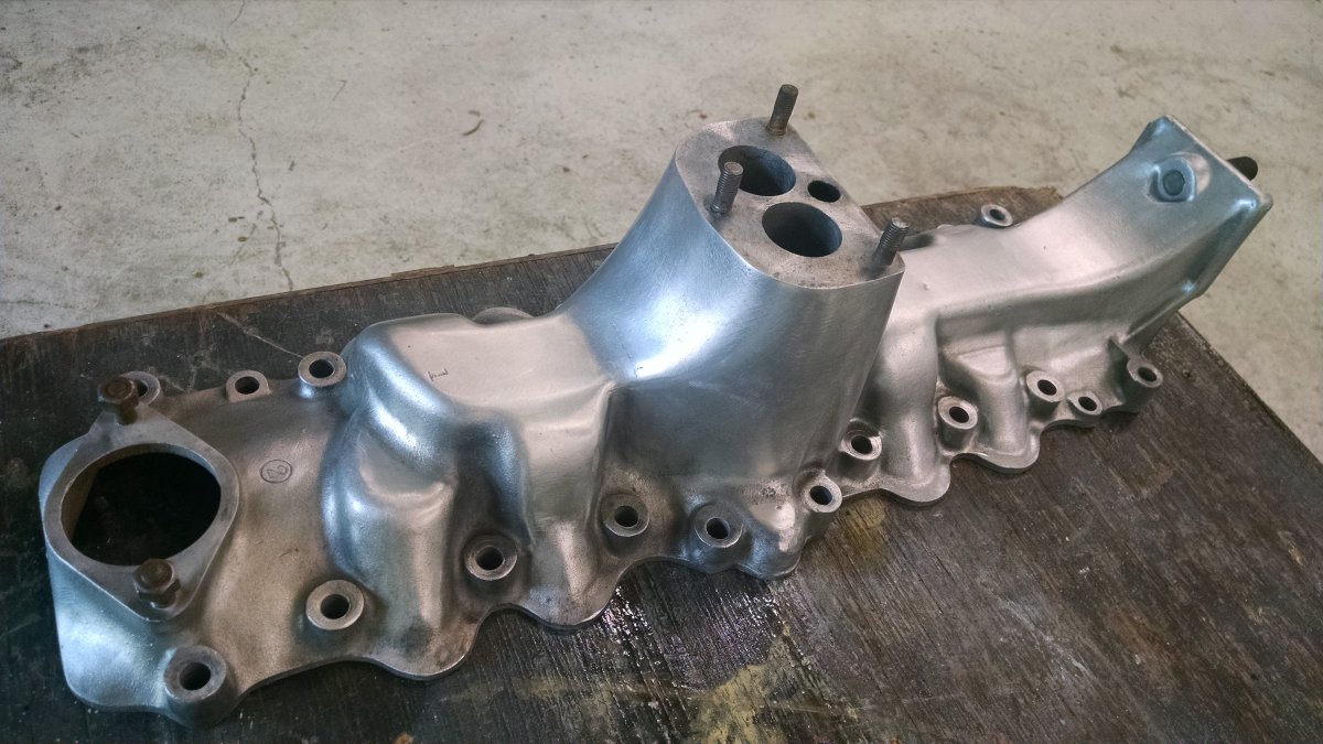

    Highlander, was thinking maybe more of an old school look. My buddy just painted his Flathead Eddie Meyer intake. I do like this finish. Cool motor too! IMG_1165.JPG
    j3harleys, mgtstumpy and slimcat7m3 like this.
  16. theHIGHLANDER
    Joined: Jun 3, 2005
    Posts: 10,823
    theHIGHLANDER
    That looks nice, I like it. I did this with some Dawn commercial aluminum cleaner for restaurants. Got it from our local "GFS" food wholesale. I used a worn out grey Scotchbrite pad, and lots of product. I don't want polish, don't want blasted, don't have a new shot peen source just yet. It'll do for a stocker.

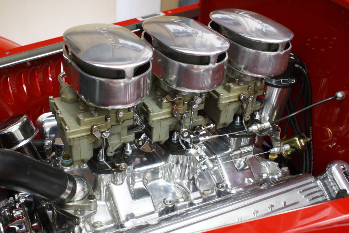

  27. Bandit Billy
    Joined: Sep 16, 2014
    Posts: 16,242
    Bandit Billy
    Russ tumbles aluminum in a ceramic trianglular looking media. I started with new products, de-edelbrocked them (sorry Vic) then let Russ do his thing. I took him the water pump, intake and heads. He clear coated them after tumbling. That was 5 years ago on my 396. I don't baby this car, I drive it hard, put it away wet, still looks great and wipes clean.
