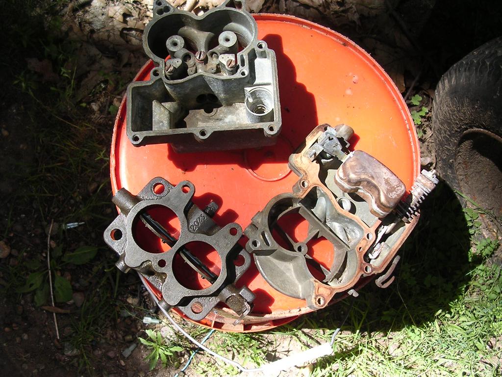

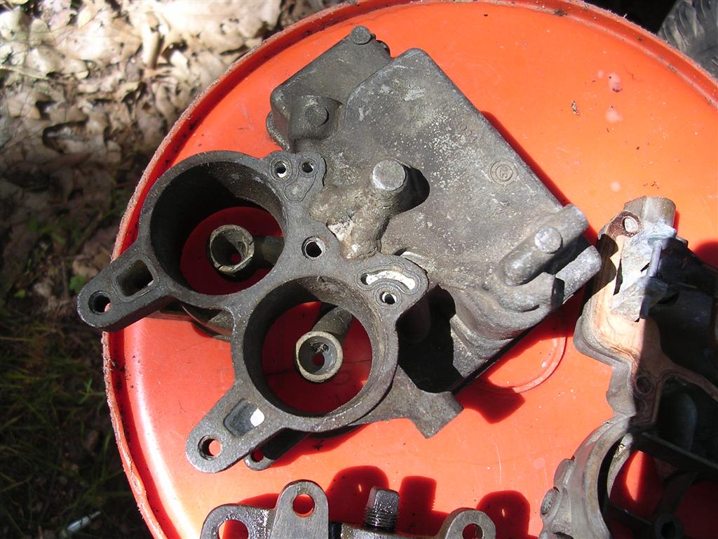

    Pics of a 1957-1958 Olds factory end carb. First thing to understand, is that all 3 main castings are the same as the center carb. The three casting differ from the center carb in the way that many things are not drilled out/machined.
    look at the top surface of the cast iron base; there are no holes except for the screws to hold it on the carb center section. GM blocked the ports that are still in the bottom of the center body casting, and the ones that are vacuum ports, fed the power piston and also the vacuum part of the automatic choke.
    on the middle main body casting; there is no power piston. It's not drilled or machined. The stock GM tri-powers all had a mechanical vacuum switch on the center carb. That was either "on or off" . It sent vacuum to a very large diaphragm can mounted to the front carb, which opened both outer carbs full on. There is not really a point where the outboards will be cruising at part throttle, so that is probably why a mid range/transition power system was not needed on an outer carb. But they did have a different main jet size to compensate. This carb has 66 jets.
    I've never had to convert a regular 2GC..so this is just what I'd try, being that you said the outers seem to cause it to run rich at idle? I would try to copy GM's design, and block all the extra holes "between the base and the middle body". I think it's worth a try. But this is not going to work if your plate sealing JB weld is still leaking a lot.
    If making a new blocking gasket is too much work for a quick test, could you lay something over the holes on the top of the base plate, and still re-use the same gasket? Maybe some thicker plastic sheeting or even black tape? Just to last long enough for a test. As long as whatever you use is not too thick, the stock gasket should still seal over it OK.
    The carb top casting is also the same, but like the main body, they differ in that many holes are not drilled out.
    The nozzle ***'y that is screwed to the top of the main body really looks the same as a center carb. But I never studied them side by side.
    Sometimes carbs can be misunderstood. If you took two of those stock tri-power bases, and bolted them to your intake, the engine will still run just fine with no main body or top ! As long as the plates stay shut, you could drive it that way.

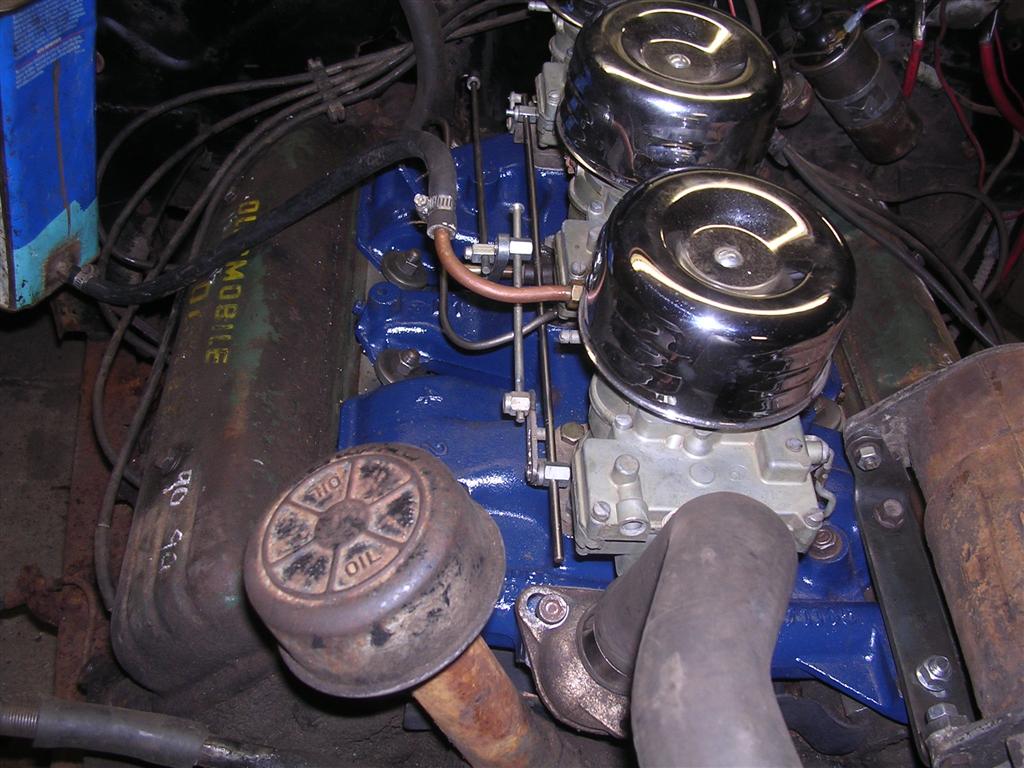

    I bought them already "converted". all the outer holes were plugged, and the little plugs where the choke flap in the top went are there. The idle p***ages in the baseplate weren't blocked, so I did that. Other than that and messing with the ****erflies, I haven't done anything else to them.
  11. rjones35
    Joined: May 12, 2008
    Posts: 865
    rjones35
    Heres one of the carbs when I was plugging up the idle mixture p***ages.

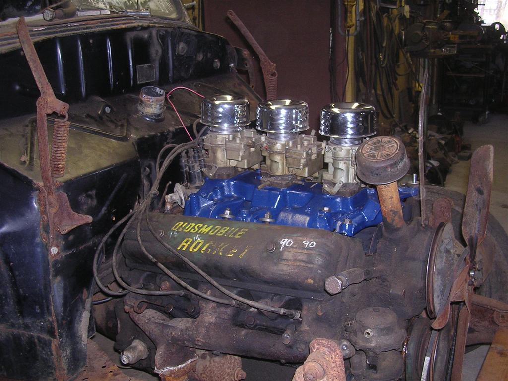

    Alright, this is what I did - plugged the power valves in the end carbs, got it running good on just the center, put just the front back on (ran okay, not as good as with just the center), took the front off and sealed the intake, put the back on (ran about the same as with the front on), took it back off and sealed the intake, checked it again with just the center, still running pretty good. SO, decided to put both ends on and see what happened. Kinda ran like ***. I'm still getting a slight air leak through both ends. If I cover the back one, the engine won't die, but it won't rpm at all, if I cover the front, still doesn't die but it does kinda smooth the idle out. Then I thought I should take apart the center and look at it. There are the four(?) holes in the throttle bores, the bottom hole has a little piece of something sticking out of it. Its metal, looks like its supposed to be there. It also has only 48 jets.
  27. BigChief
    Joined: Jan 14, 2003
    Posts: 2,084
    BigChief
    The thing sticking out of the bottom hole is the idle mixture needle. You can pull them out of the base and plug the holes with set screws. Also, if you look close it appears that the throttle blades are not open the same on each side....could be an optical illusion.
  28. rjones35
    Posts: 865
    rjones35
    Ha!! I didn't think about the mixture screws!! Thats kinda funny! Thanks!! Thats the center carb, the ends don't have those.
    It is an optical illusion. They're the same. I'm thinking I need bigger jets in the center carb? Or maybe its just a matter of messing with the mixture screws more.
