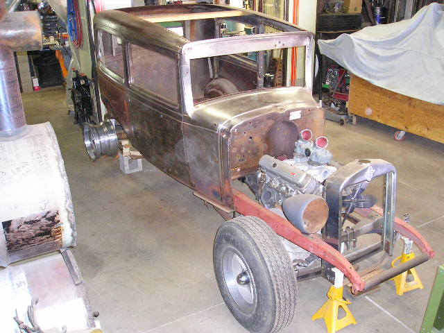

    Can't really provide much info about the carbs, but sure am interested to know more about your 31 Chevy. What is it? Truck, Sedan, Coupe, Roadster? I'm working on a 31 Chevy 2-dr sedan. Sorry for the crappy pics.
