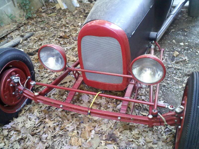

    Here's a picture of I stole of a 4 leaf set up

    Do the springs attach to the front axle with a shackle? Not clear in the photo. If they don't, isn't that just a fancy solid suspension?
    Also, how does it handle articulation? By the threaded rod end rotating in its sleeve?
  16. Impossible to tell from that photo, but I would bet that the lower springs on that IH truck are standard semi-elliptical, not 1/4s (note the pivot pin in the front hanger). Setups like the one you propose have been done before, but you may have a lot of pinion wrap and wheel hop with any kind of real torque to the wheels. Keep in mind that the pinion goes up under power, so the spring pack is arching against gravity (vehicle weight). Only the leaves that are actually bolted to the axle have to bend, unless the entire pack is clamped together (VERY rough ride...).
    Regarding the usefulness of triangulated upper links with 1/4 ellipticals, it really depends on how much arch the spring pack has at ride height. If the springs are relatively flat, then the attached leaf (or leaves) have to bend directly sideways to allow the axle to move side-to-side. Not likely! The more arch the pack has, the more the spring leaves can twist and allow axle movement. This is the same problem lifted 4X4s with high-arch springs encounter in corners... IMO, the ideal way to use 1/4 elliptics is with shackles on the axle and separate links, as shown here:
    If the shackles are plated (reinforced, not chromed;)), a fairly flat spring pack will resist side motion just fine on anything short of an autocross car.
    The real issue with solid links on any type of leaf spring system is conflicting motion. The leaf springs try to move the axle through a certain arc. Unless properly designed, the links can cause unwanted axle motion or binding as the try to force the axle into another arc. The picture in the OP is a good example...
    IF the suspension uses much travel (I'll admit it probably doesn't), the arched leaves will flatten out and push the bottom axle brackets forward. The top links are already flat, so the top brackets will begin to arc to the rear, resulting in a LOT of caster angle change.

    I REALLY LIKE THIS SETUP! CLEAN AND SIMPLE! One thing a person does need to remember when triagulating links to eliminate "side to side", is that the closer the top links, or angled links are to 45* the less the chance of this side to side sway. Any triagulation is good, don't think I'm nay saying in the slightest, all of these setups will work, and work well. Just the little bit of advice I can give, but remember, I'm not a doctor, just an asshole...

    I'll say it again - if those front shackles are welded to the axle (in the lower photo - hard to tell for sure) then there is NO SUSPENSION in that car, except for whatever you would get by the various parts flexing.
    Think about it.

    The other thing that really bothers me about the setup below, is that the top links are swinging on planes that are not parallel, so the points at which they attach to the axle CAN NOT remain equal-distant from one another. In other words, the bushings on both ends of those links are always going to be binding as the suspension moves. They are not using heim joint or similar there, which would solve the issue. They look to be using polyurethane, which has a little give but I don't believe that material is meant to be used in the way they are using it there. Basically, I think this setup is just wrong.

  20. You can't have shackels on 1/4 elliptic springs in that setup or the axle would be free to swivel.Just think of the spring as the lower link in a 4 bar front end.

    If those top links were mounted on bearings such that they could ONLY travel along paths defined by an axis represented by the bolts that hold them on each end, there would be absolutely no suspension in the car. The ends of those top links, on the axle side, MUST diverge as they swing. Being that they are mounted firmly at a certain distance from one another on the axle, the suspension can only move via bushing flex. Thus, on paper, the suspension geometry of that car CAN NOT move. It only moves in real life due to flex of parts that shouldn't.

    Exactly. If those upper arms were replaced by another set of leaf springs, it would be OK since the springs are designed to flex.
    The setup pictured is just a really complicated way of building a solid front end. ;)

    This front end will work fine as is, it looks like it has around 3-4 degrees of caster sitting static on the frame table. When under load, like others said it will have a caster increase, but so would a transverse spring with bones or hairpins. The longer the locating links, springs,bones etc. the less caster gain. The urathane bushings are stiff but all components will flex, including the axle just as an ibeam with split bones does although the ibeam will flex more than the tube. This design is stiff or resistant to roll, like a sway bar it works fine up and down in a linear motion but binds when trying to lean. A better design would be to make a wishbone or three mounts for the top link, say leave the urathane rear bushings and put a heim or sepherical bearing right in the center of the axle with one mount and all would free up. This may not have been done because of radiator or grille clearance.

    Yes, that axle will see extremely significant caster changes as that thang strains and flexes. That is hardly 'working fine'. It is in fact a major hack.
    Just because someone cuts pretty brackets and can lay down a nice looking weld does not mean that it is designed properly. From what we can see, that front end is as much a hack as something cobbled out of TV antenna tubing with pigeon sh1t welds.
  25. All that seems to matter is that it looks traditional.

    Thousands upon thousands of triangulated urathane bushed rear four bar suspentions have been installed and are running around and work fine, and when they go through suspention travel the pinion angle changes. There is allways a better design for something, many different designs work, some just work better.
