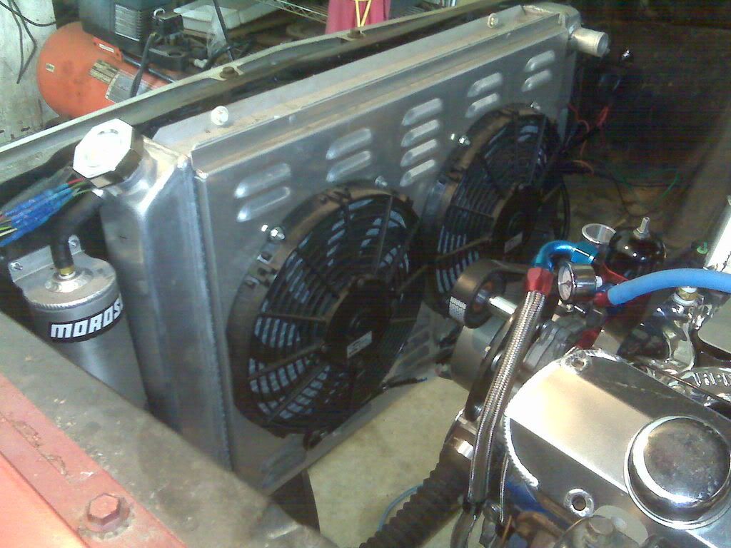

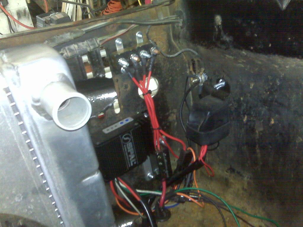

    Depending on how much effort and time you are willing to spend I ran all the wires under the front fenders. Where the factory wiring block goes through the firewall I just moved it over about 8" (IIRC) then I brought them back in right at the front under the lip where the radiator mounts (can't remember the correct name for thing that holds all the lights, radiator etc). For wires going to the motor (ie temp, coil, choke) it ran through the firewall either centered behind the motor or right under the throttle cable hole lined up looking down the side of the intake manifold. Use the smallest wire possible with black non split wire loom and it will not stand out as much. I have a bunch of fibre loom not the cheap plastic stuff. On my Vic jr intake I went in the center of the firewall and route the wires through the intake air space and you really can't see them.
    Here is the loom I am talking about.
    http://compare.ebay.com/like/130391...ffe337d&itemid=130391259158&ff4=263602_304662
    A nice neat way of dealing with the heater hoses is to you a latemodel tubular one that runs down the p***enger side of the intake then just a short run over to the heater inlet. I think it gets rid of that ugly rubber hoses hanging all over.
    P.s I think that big distributor is ugly as well.
    You can just barely see where the wires come back in the engine compartment here.
    I also mounted any relays etc on the front instead of the fender well so they are out of side when you are standing in front of the car. To me this is still messy so I am looking at ways to clean this up even more.
    Hope this helps some.
