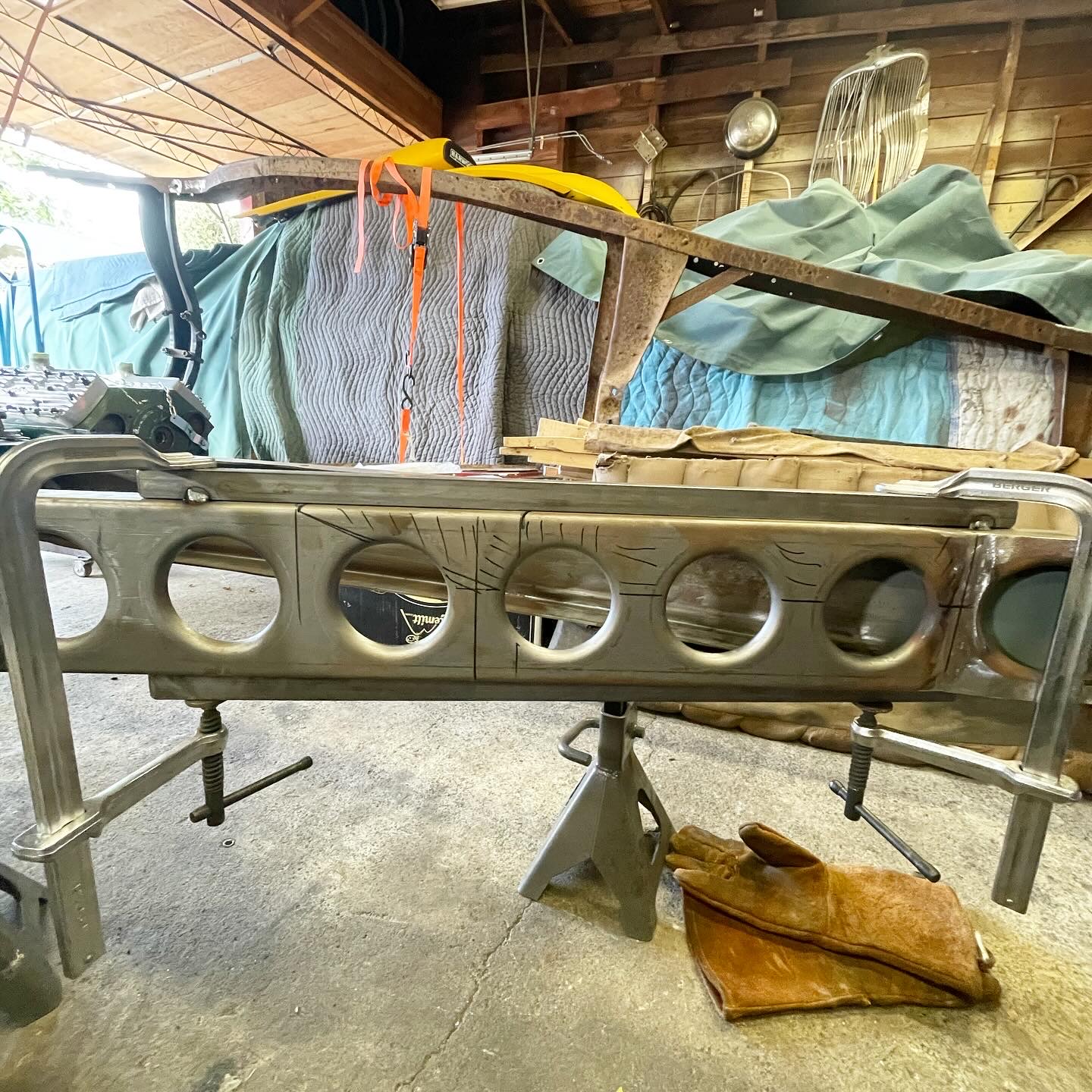

  3. DeadFast 33
    Joined: Feb 3, 2003
    Posts: 649
    DeadFast 33
    from Santa Cruz

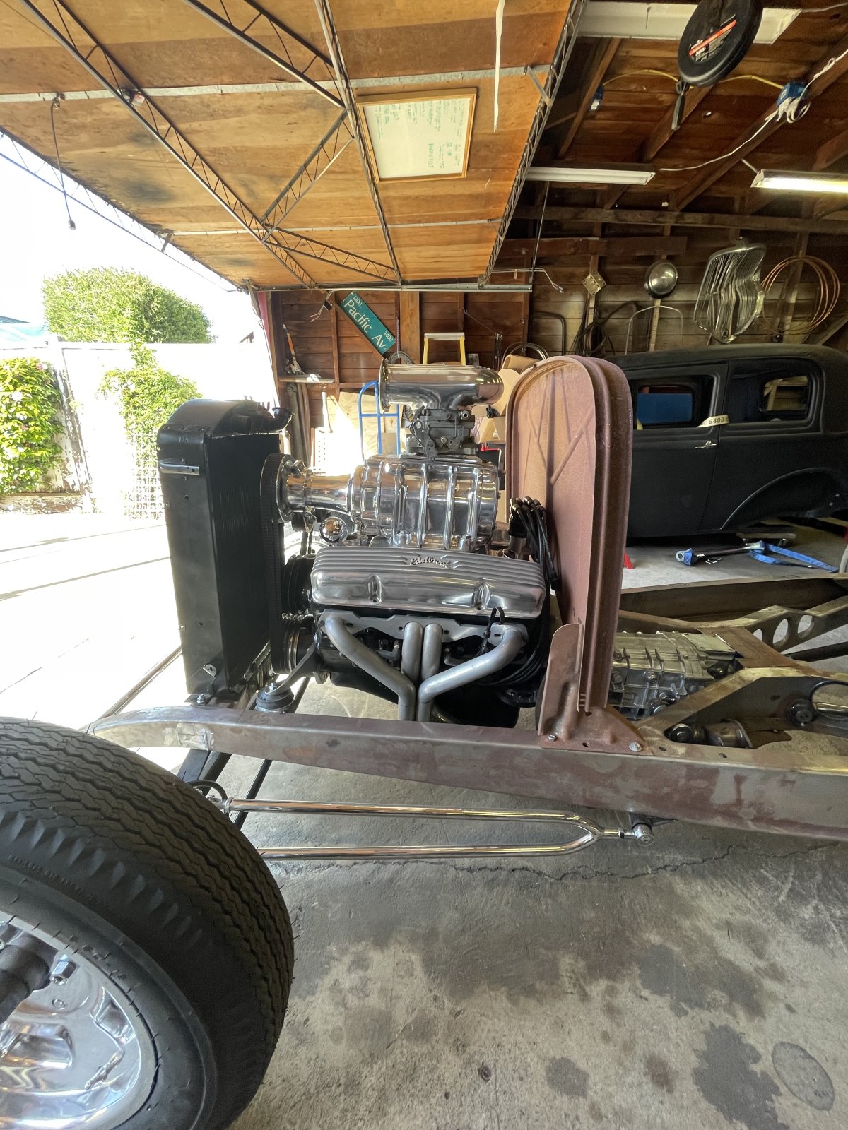

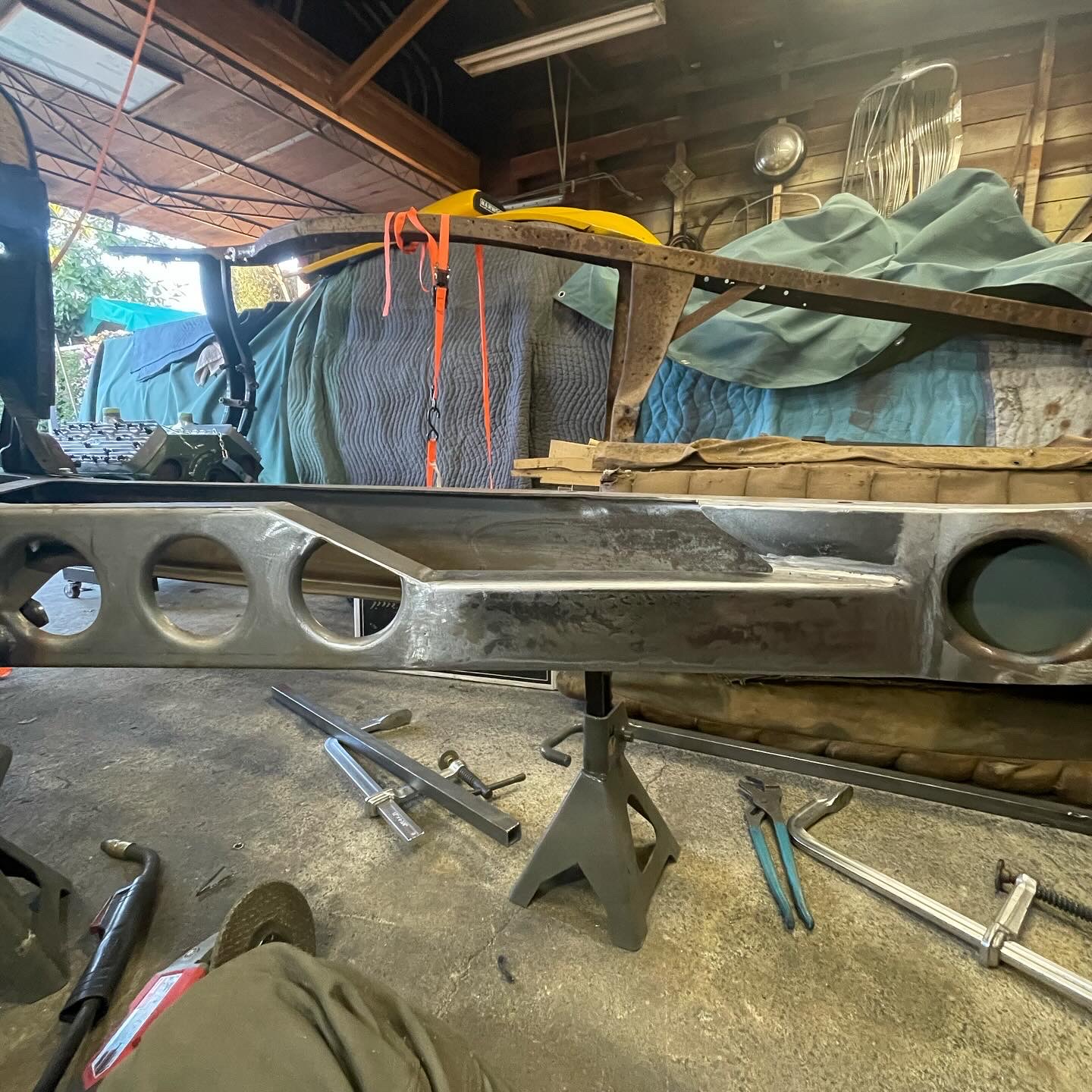

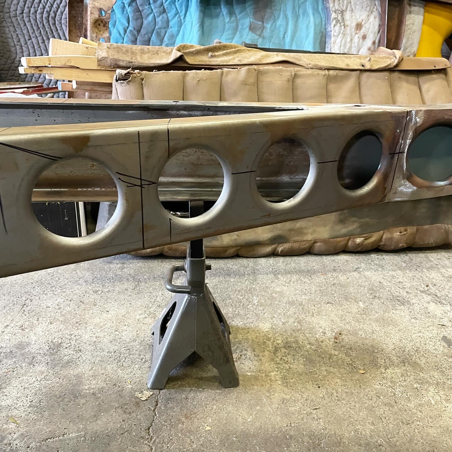

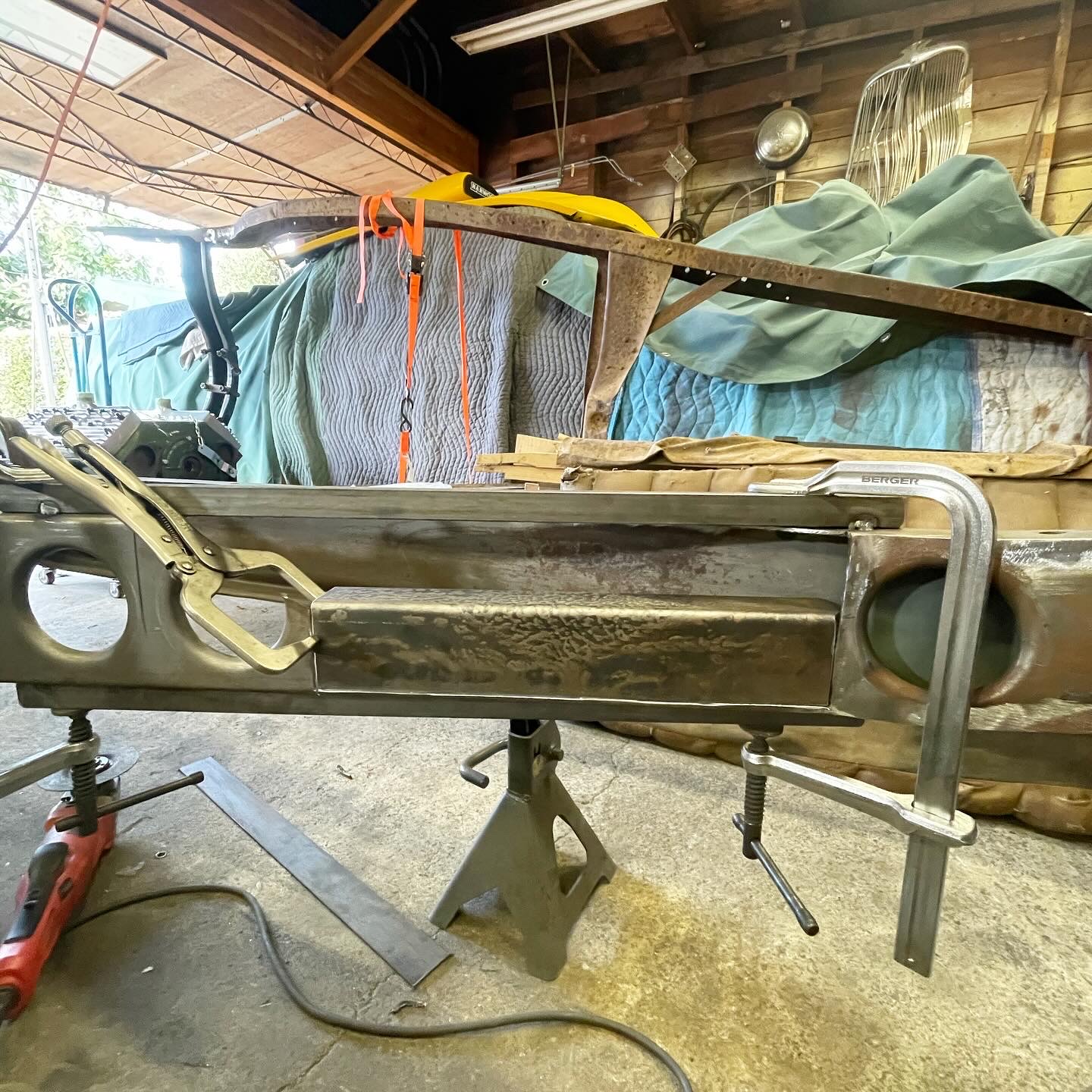

    Not so exciting but since the floor is stock, beautifully shapely and rust free I had to modify the X member to get the body on the ch***is.
    FLiP

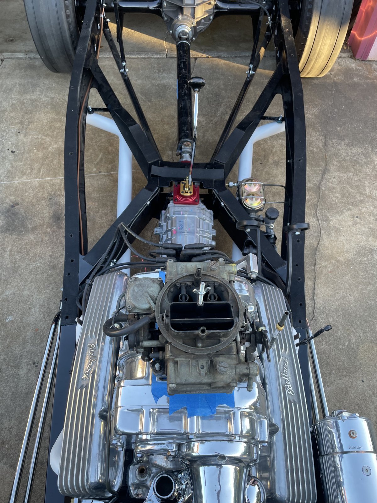

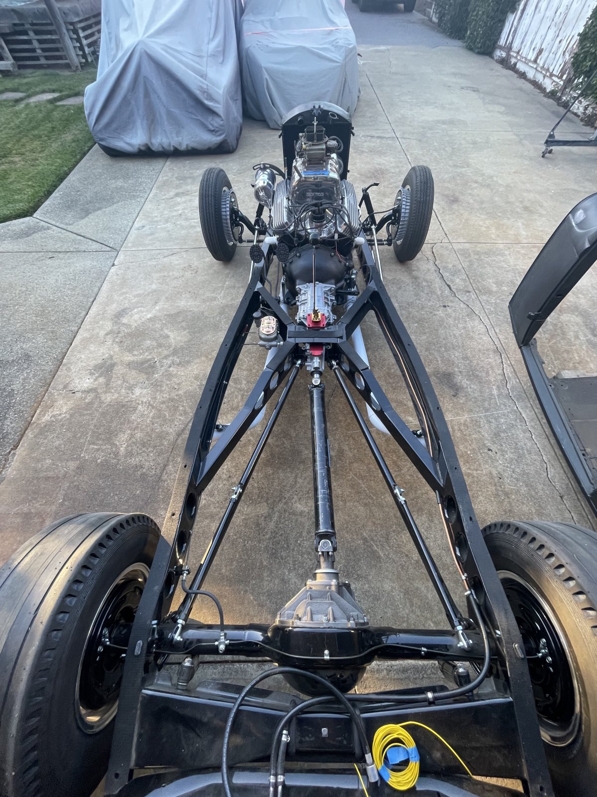

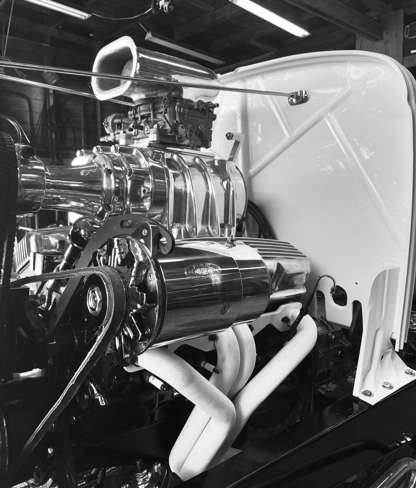

  8. DeadFast 33
    Joined: Feb 3, 2003
    Posts: 649
    DeadFast 33
    from Santa Cruz

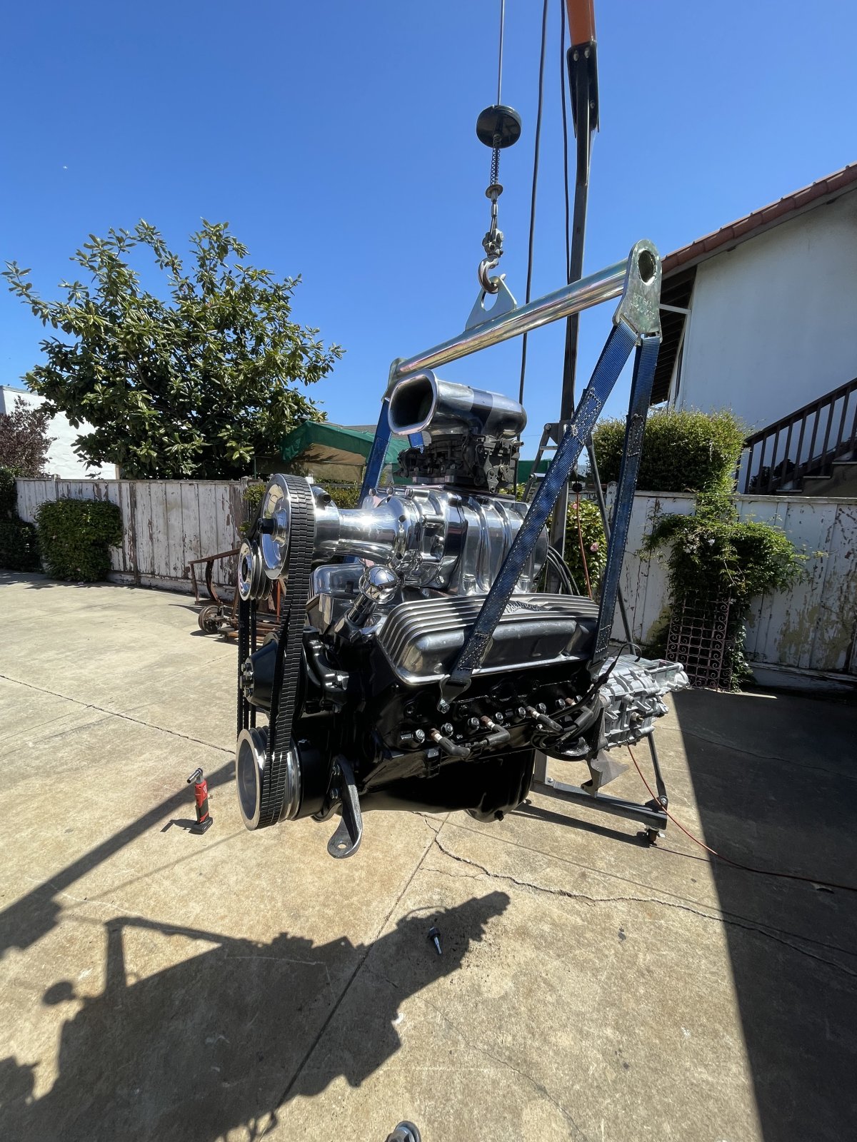

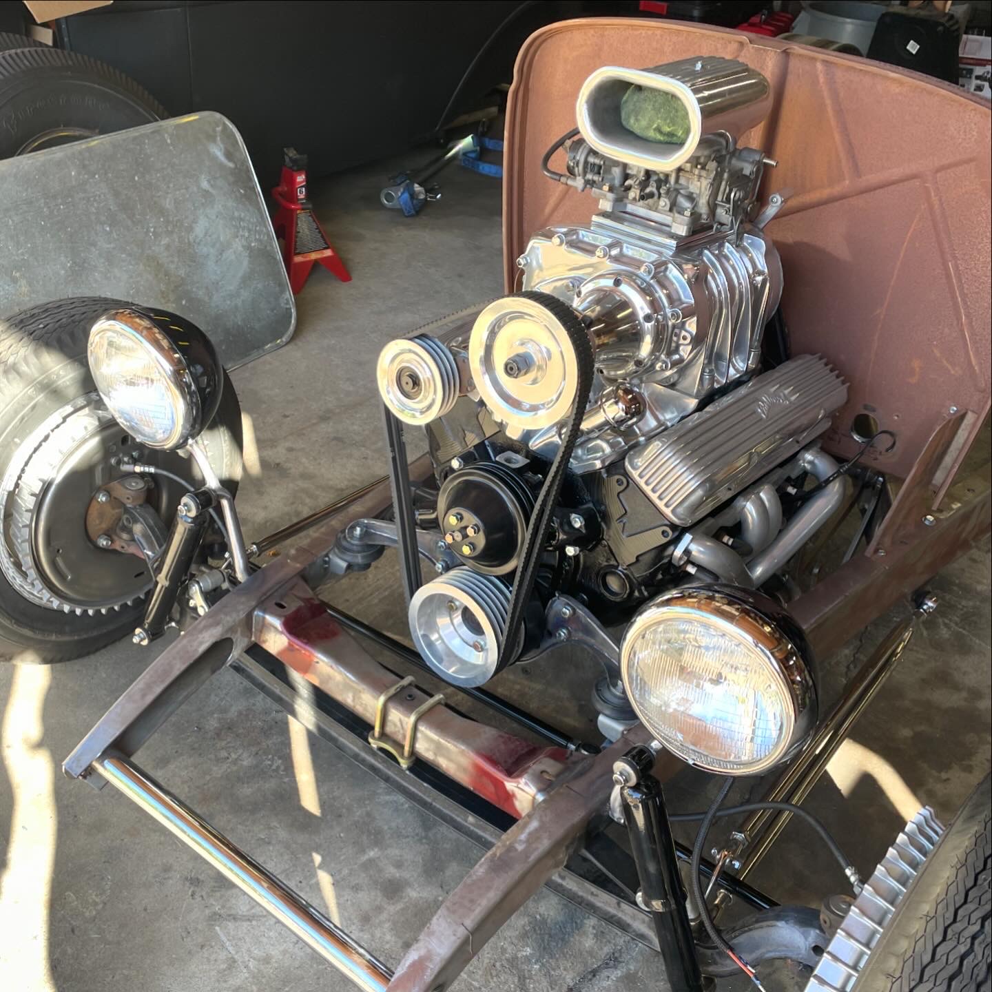

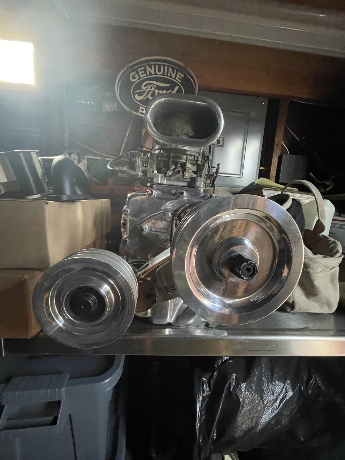

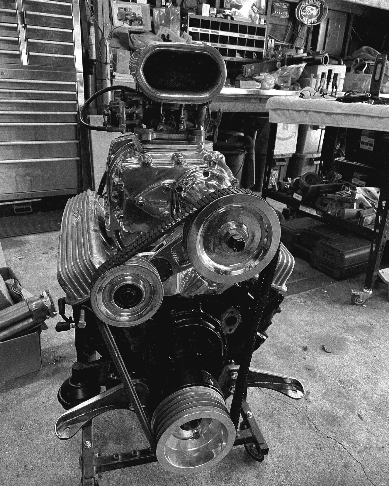

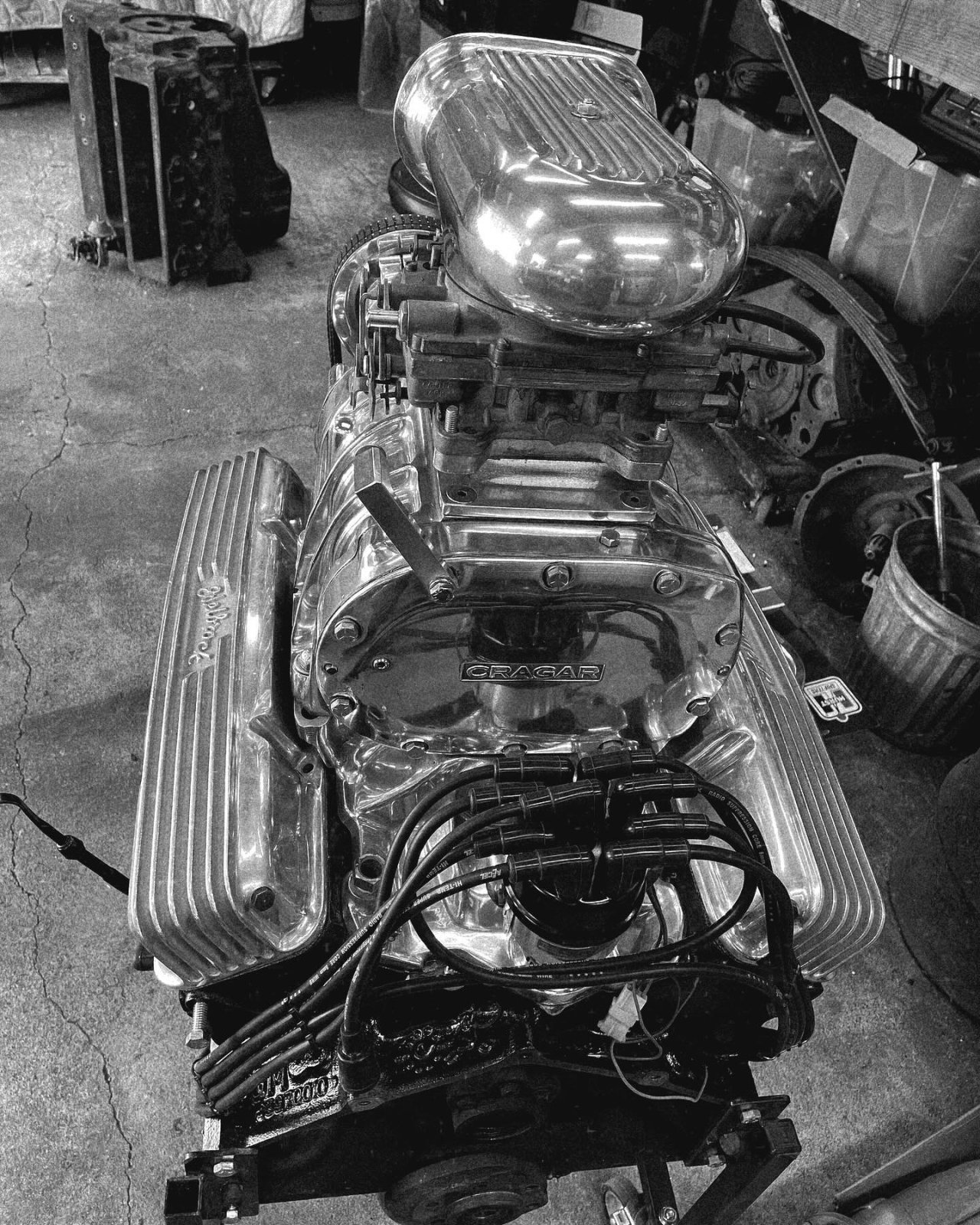

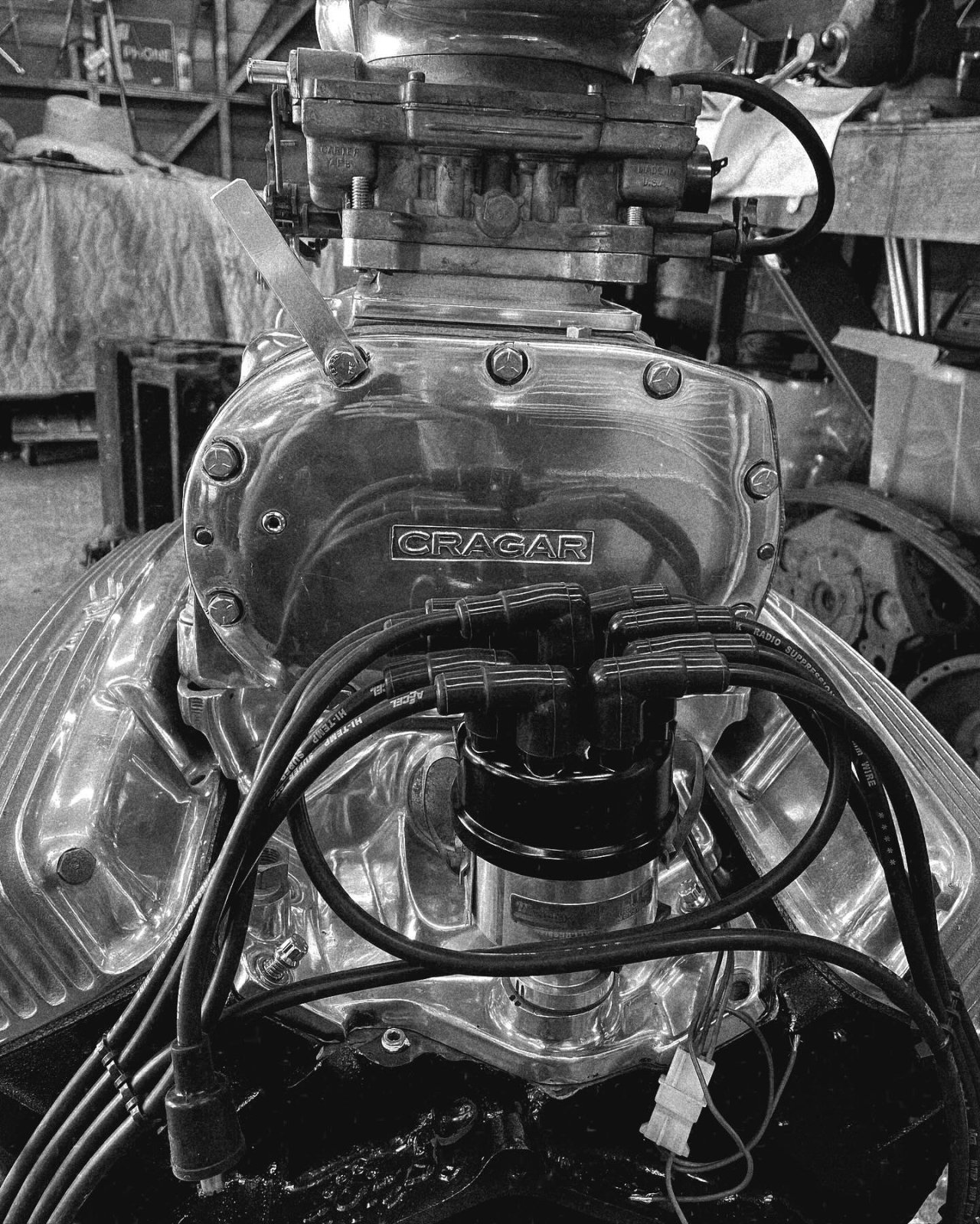

    Got the motor dropped in to check some things…the 5 groove crank pulley says that I’m going to need to recess the firewall or put a flat firewall in the car. The early 32 firewall is too nice to cut on! She’s tiiiight.
    I’m also pondering switching it up to hair pins instead of the split/not split bones……thoughts??
    FLiP
    Fordors and Outback like this.

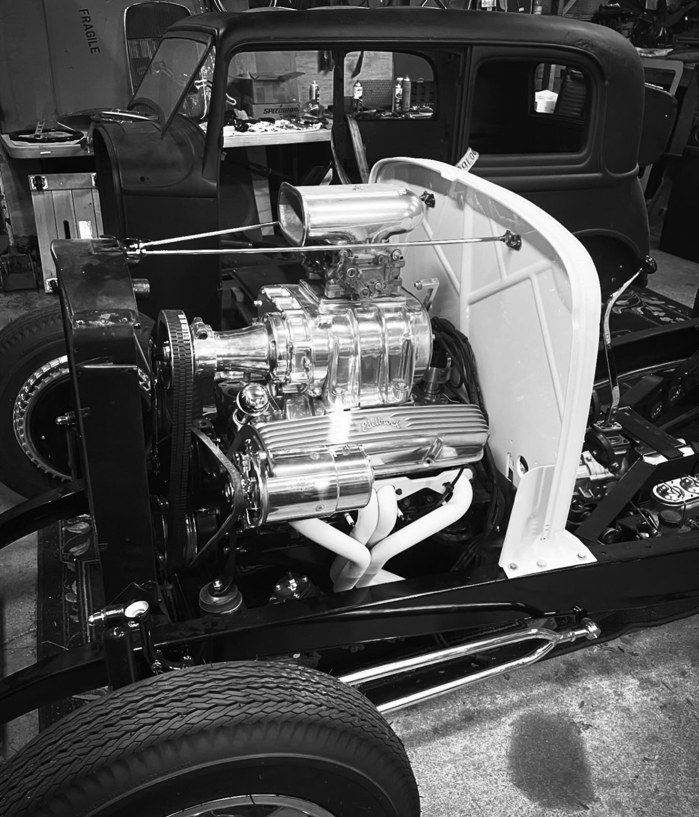

  9. DeadFast 33
    Joined: Feb 3, 2003
    Posts: 649
    DeadFast 33
    from Santa Cruz
    Another pic
    Fordors likes this.
  10. flamedabone
    Joined: Aug 3, 2001
    Posts: 5,763
    flamedabone
    That thing is *****n'. Can you live with the 3 groove that is on there, looks like it fits.
    -Abone.

  11. DeadFast 33
    Joined: Feb 3, 2003
    Posts: 649
    DeadFast 33
    from Santa Cruz

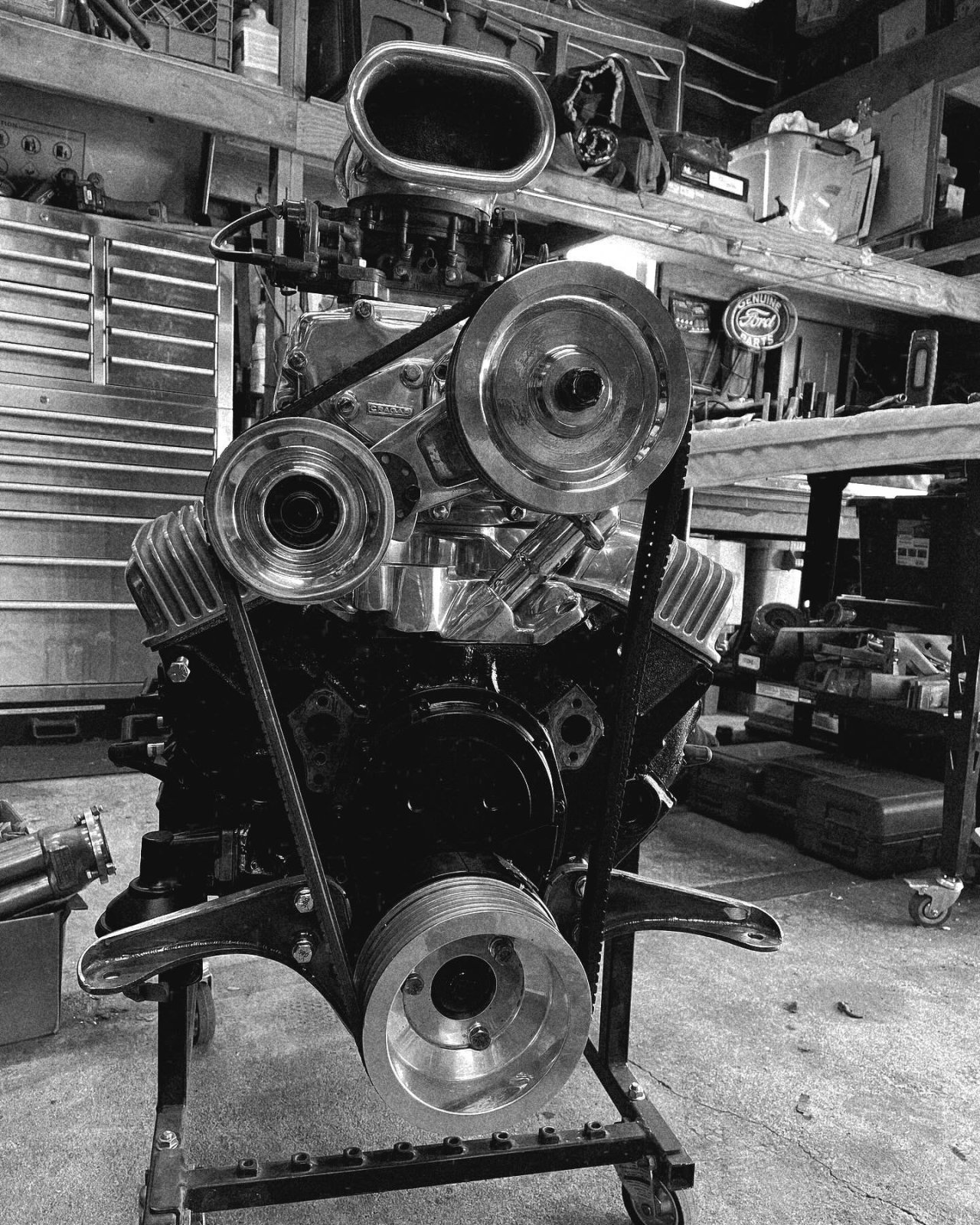

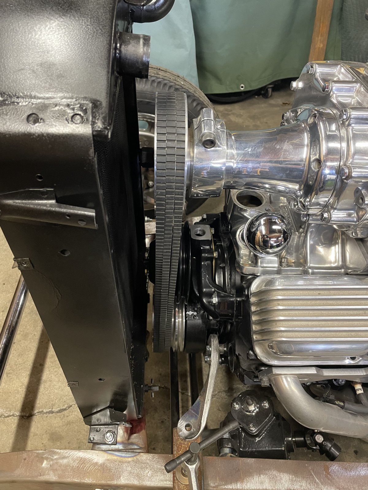

    On the crank pulley the first 3 grooves are the blower drive and the closest to the bock two are for the generator and other accessories. Unfortunately the snout and upper pulley determined that for me, I’d love to be able to snug things up a bit more but this is what I’ve got.
    FLiP
    GordonC likes this.
  12. DeadFast 33
    Joined: Feb 3, 2003
    Posts: 649
    DeadFast 33
    from Santa Cruz
    I’ve also got to find a way to get a fan in there, electric unfortunately.
  13. flamedabone
    Joined: Aug 3, 2001
    Posts: 5,763
    flamedabone
    Get your pulley arrangement up set in stone, find the actual fan you are going to use, then hack the firewall accordingly. You won't be the only fella to ever cut a nice cherry '32 firewall and once you make the first cut, you start to feel better.
    -Abone.
  14. DeadFast 33
    Joined: Feb 3, 2003
    Posts: 649
    DeadFast 33
    from Santa Cruz

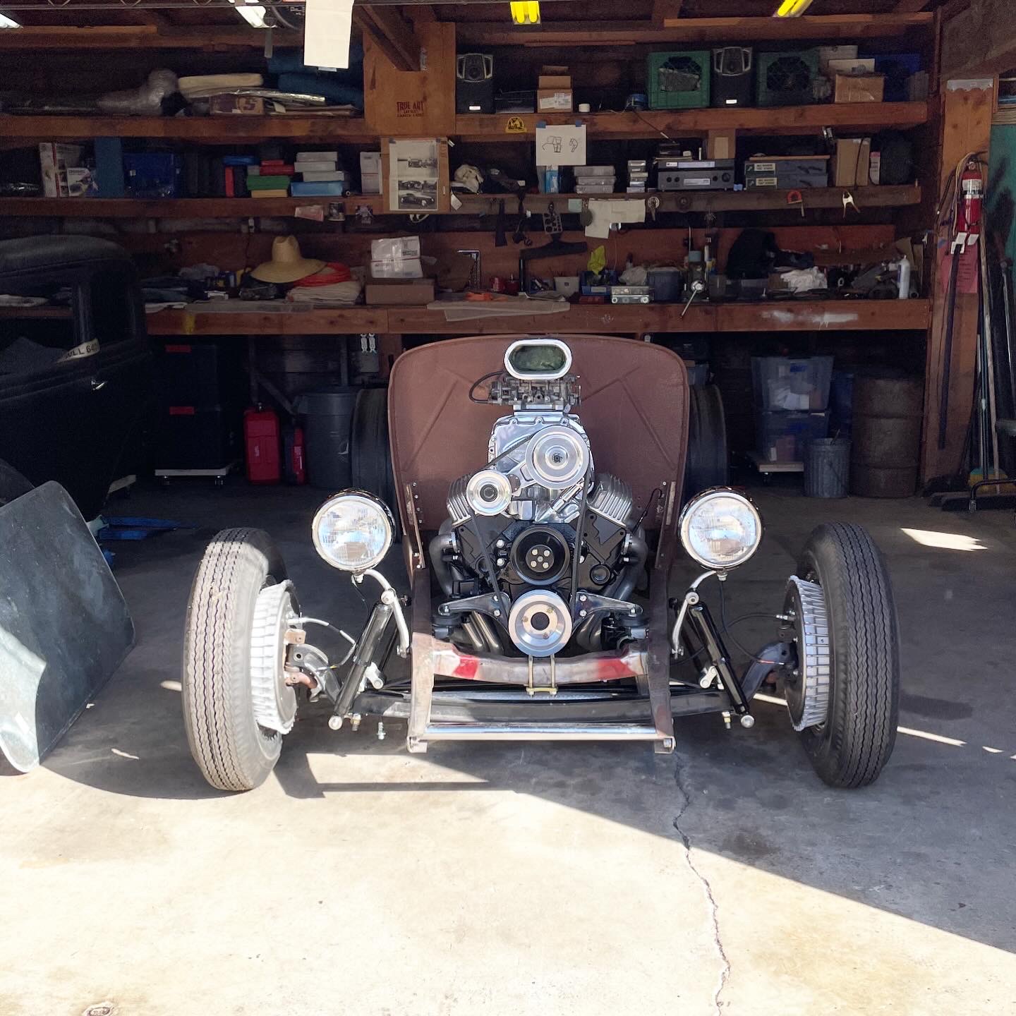

    I went with a flat firewall instead of cutting up the cherry original. I moved the motor back within about 1/2” of the firewall and locked it and the trans mount where I want em’. There is enough room for the electric fan and it looks like I might be able to run a hood top with the right air cleaner.
    I also ditched the 47 front bones for a set of polished hairpins, I feel like it is a much spiffier look!!!

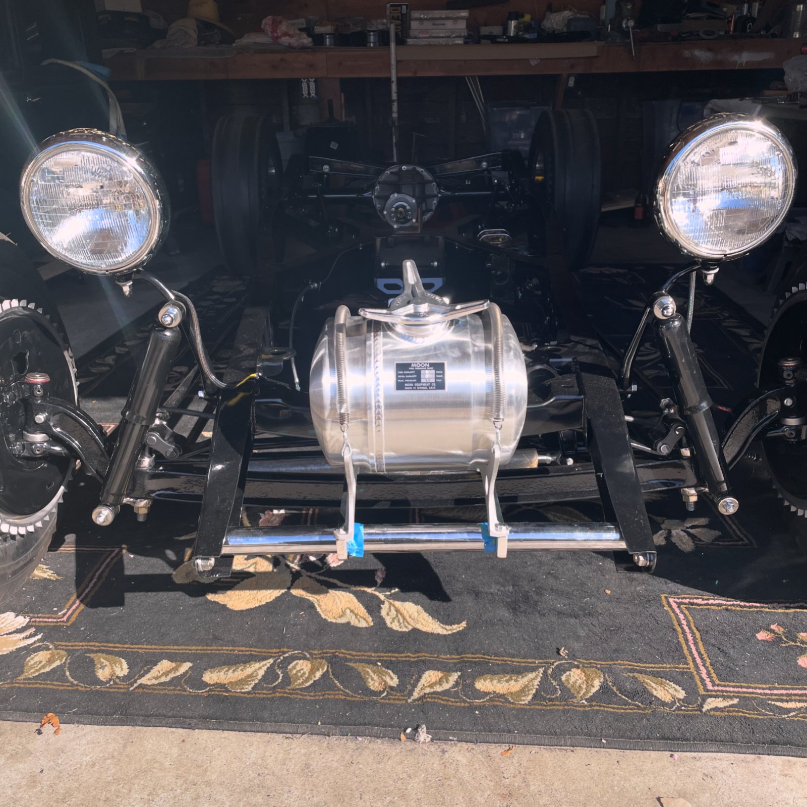

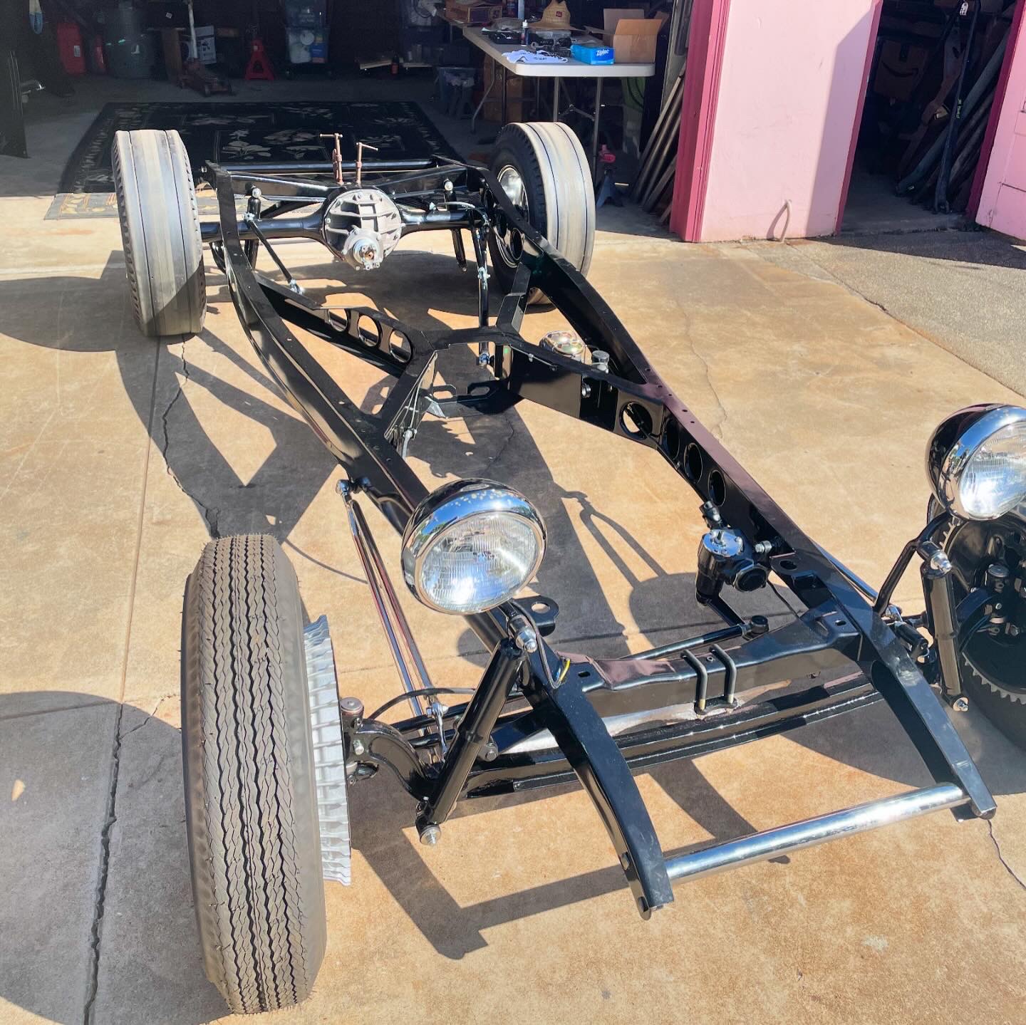

  15. DeadFast 33
    Joined: Feb 3, 2003
    Posts: 649
    DeadFast 33
    from Santa Cruz

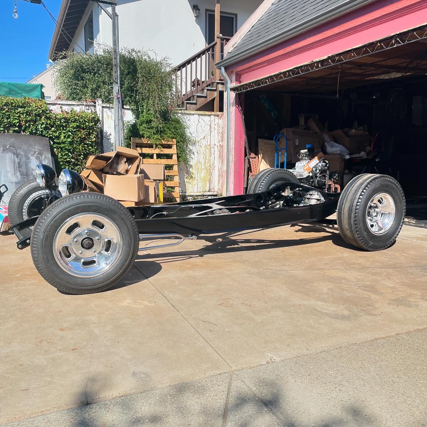

    I got the steering box where it will live, the pan hard bar mounted and the front shock/headlight mounts made, also rear shocks mounted. I got the brake line tabs welded up and started plumbing the ch***is. I’ll probably bust it apart next week and drop it off for powder coat!!

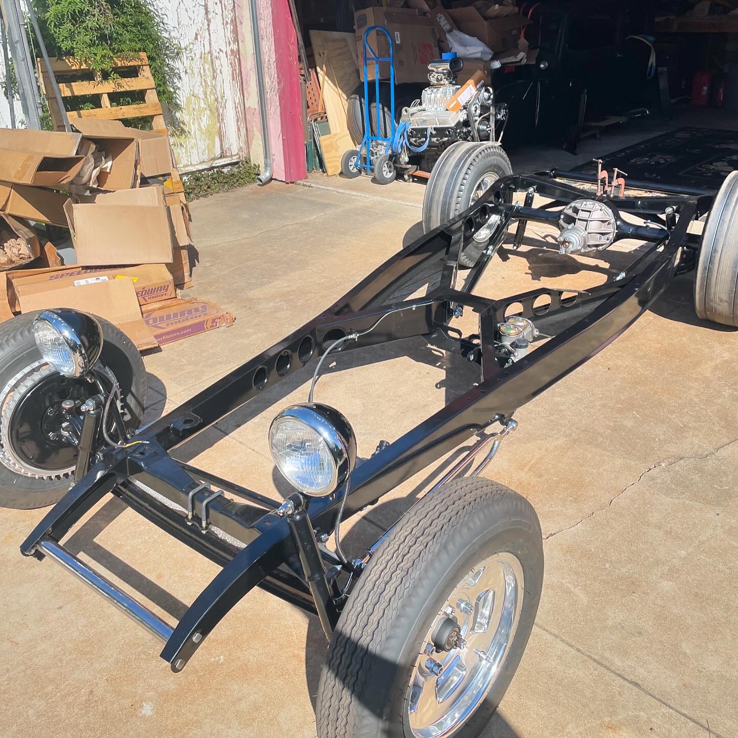

  18. DeadFast 33
    Joined: Feb 3, 2003
    Posts: 649
    DeadFast 33
    from Santa Cruz
    I got the ch***is bits back from powder coat a few weeks ago and haven’t had a lot of time but the adult size model is going together nicely!!
    ……should have the body touching down any day now.
    FLiP

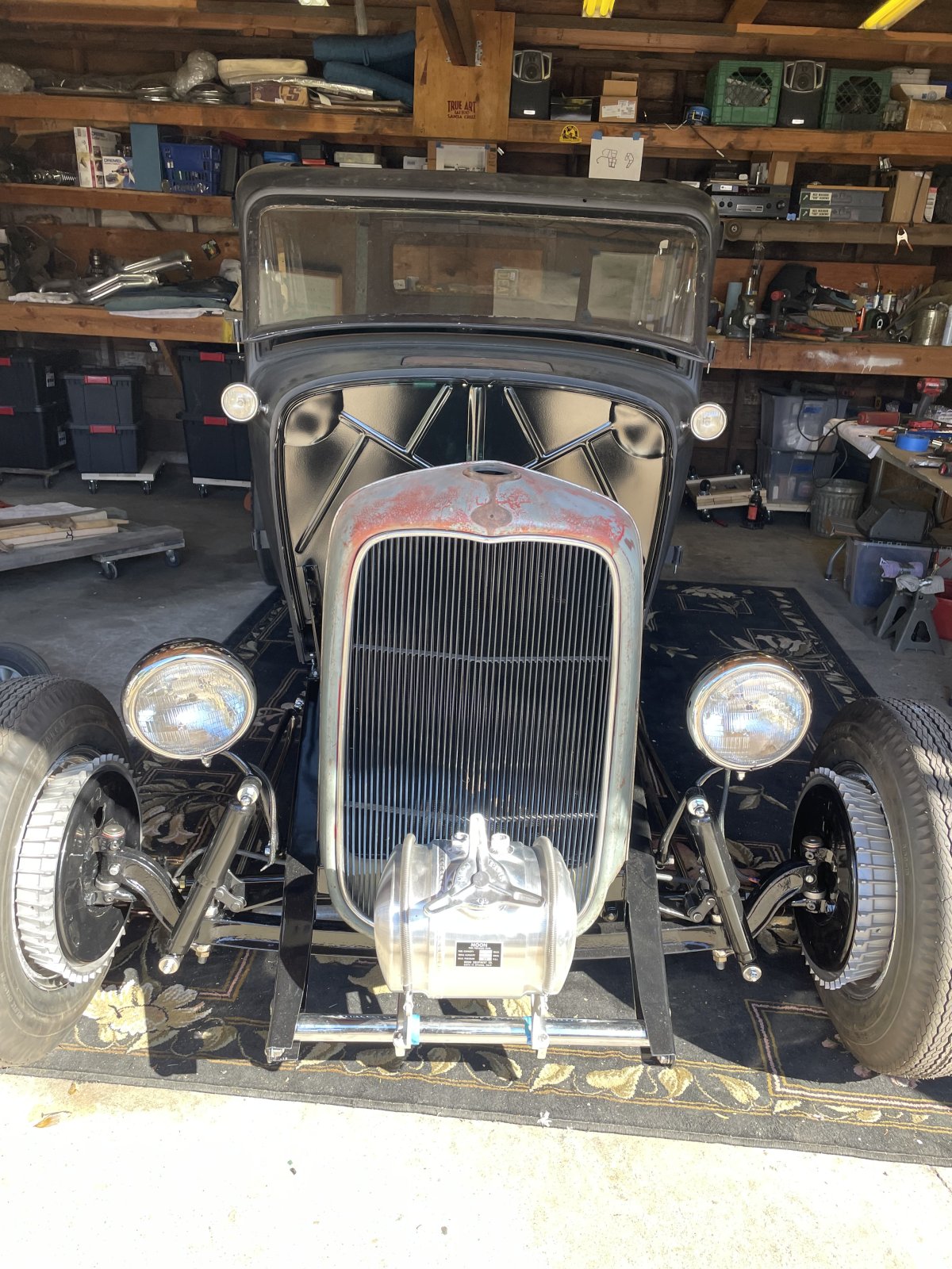

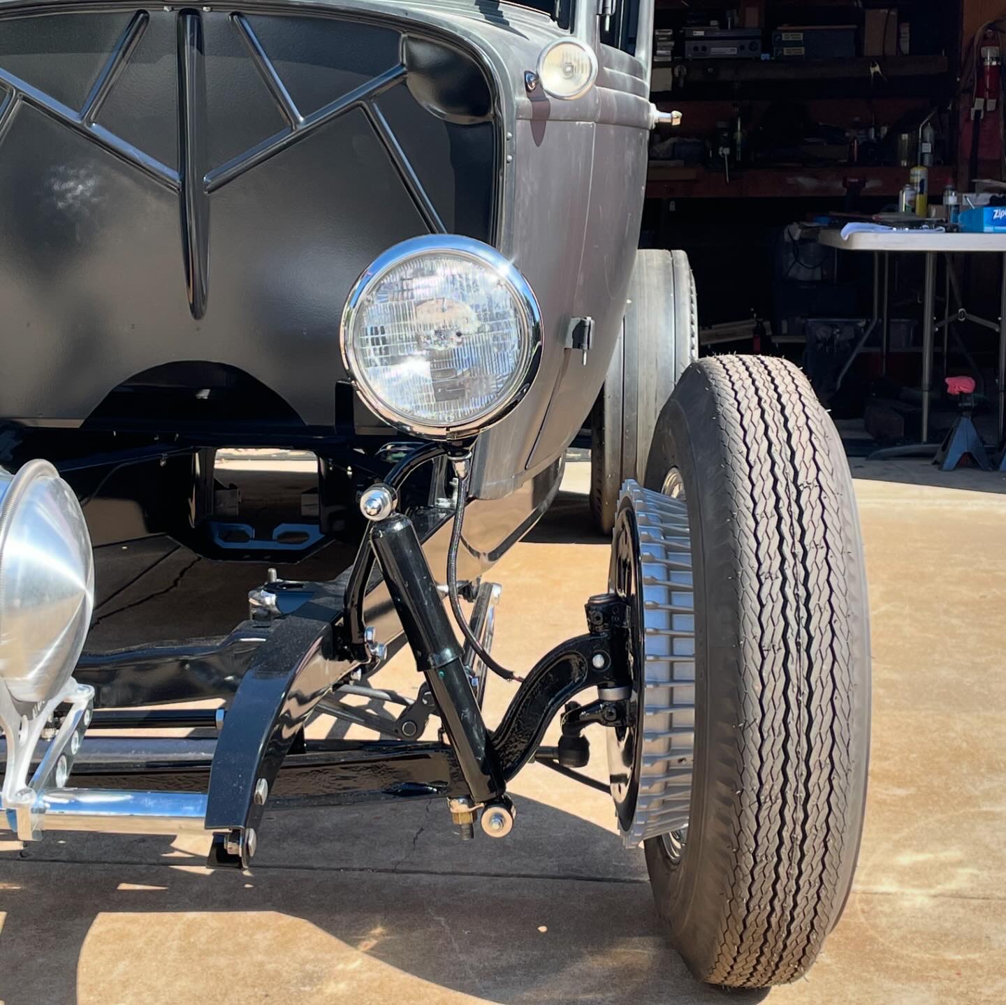

  24. DeadFast 33
    Joined: Feb 3, 2003
    Posts: 649
    DeadFast 33
    from Santa Cruz

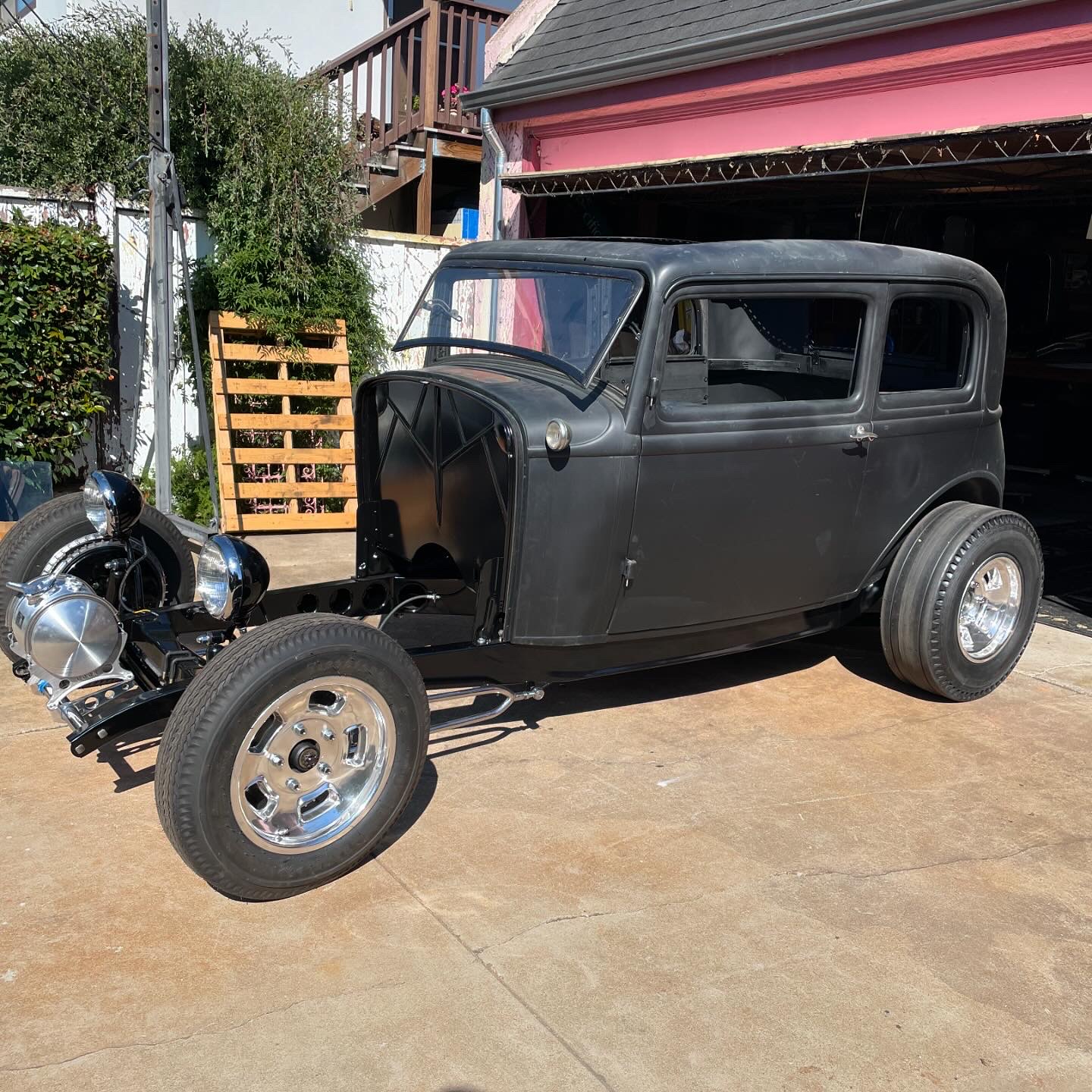

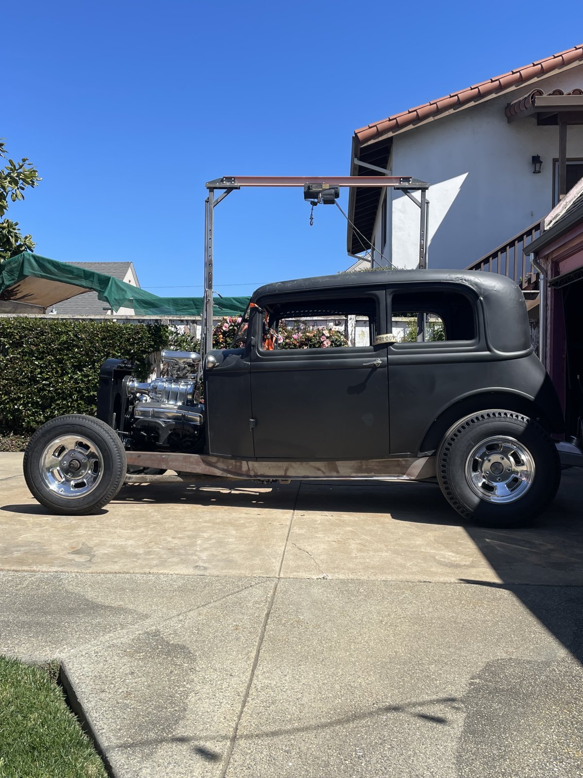

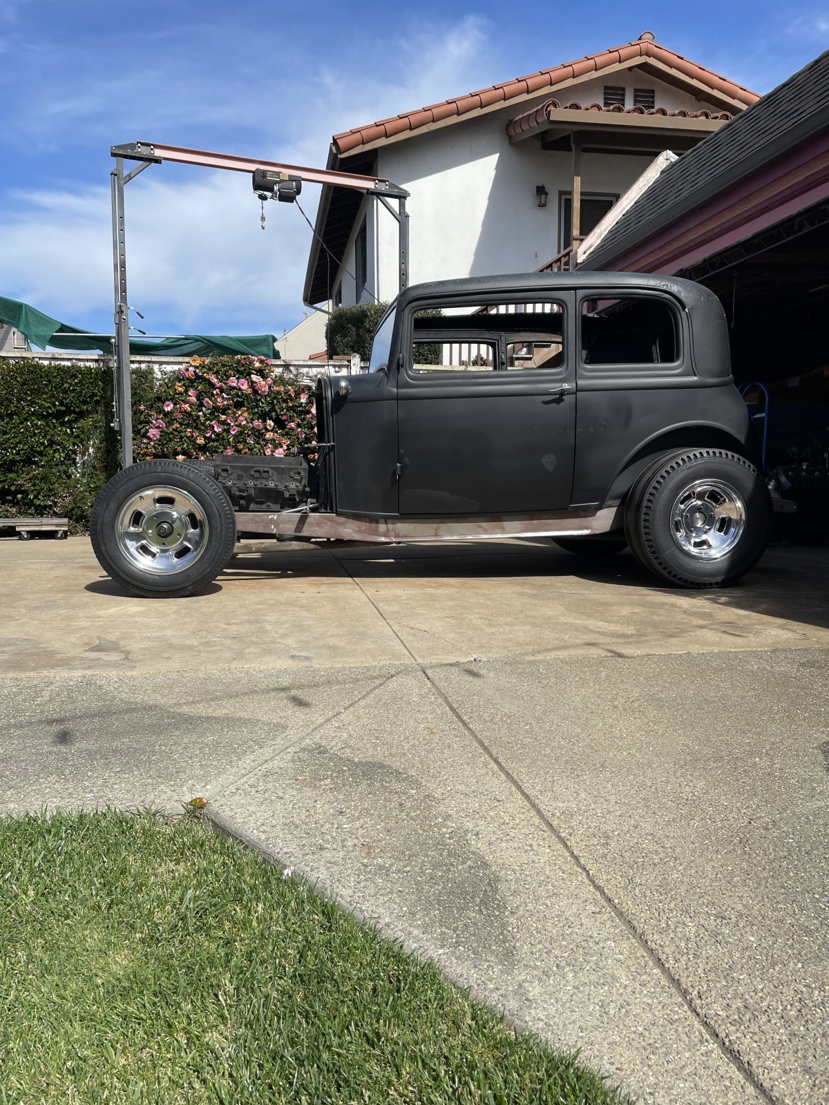

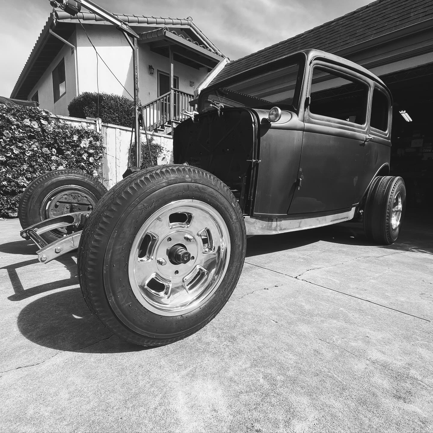

    I got the body on today.
    FLiP

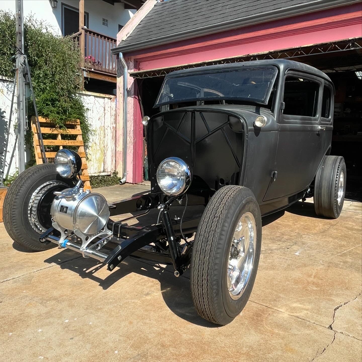

  26. DeadFast 33
    Joined: Feb 3, 2003
    Posts: 649
    DeadFast 33
    from Santa Cruz

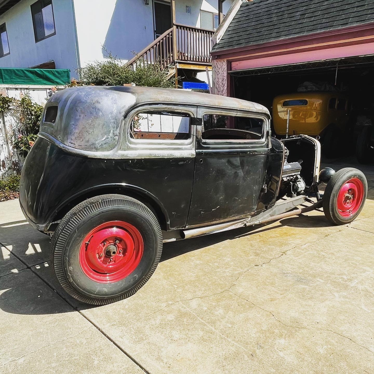

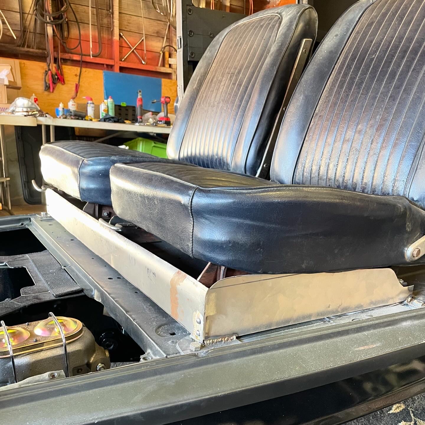

    It’s been awhile…..

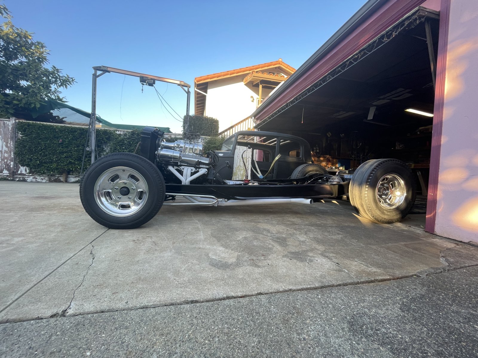

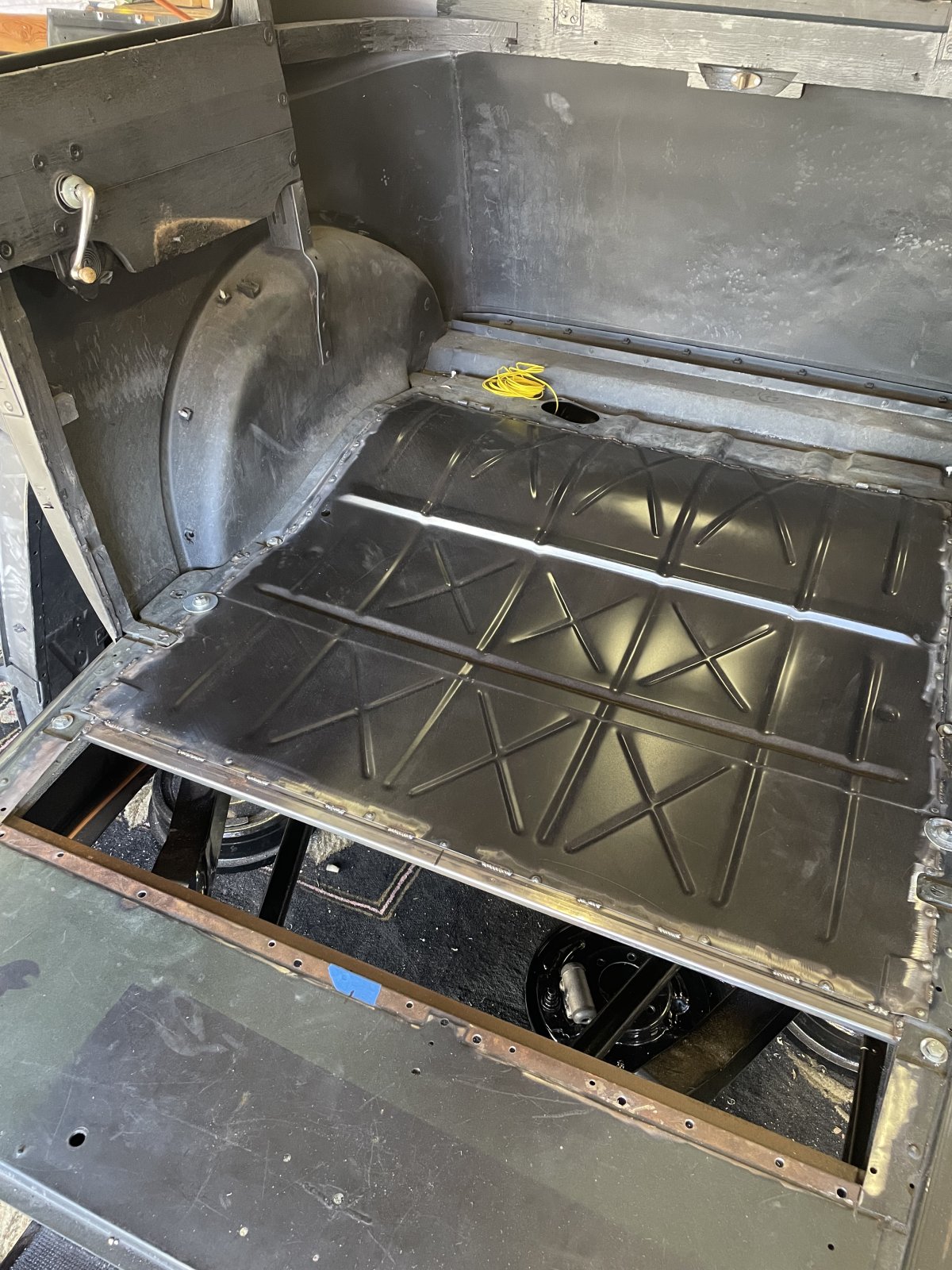

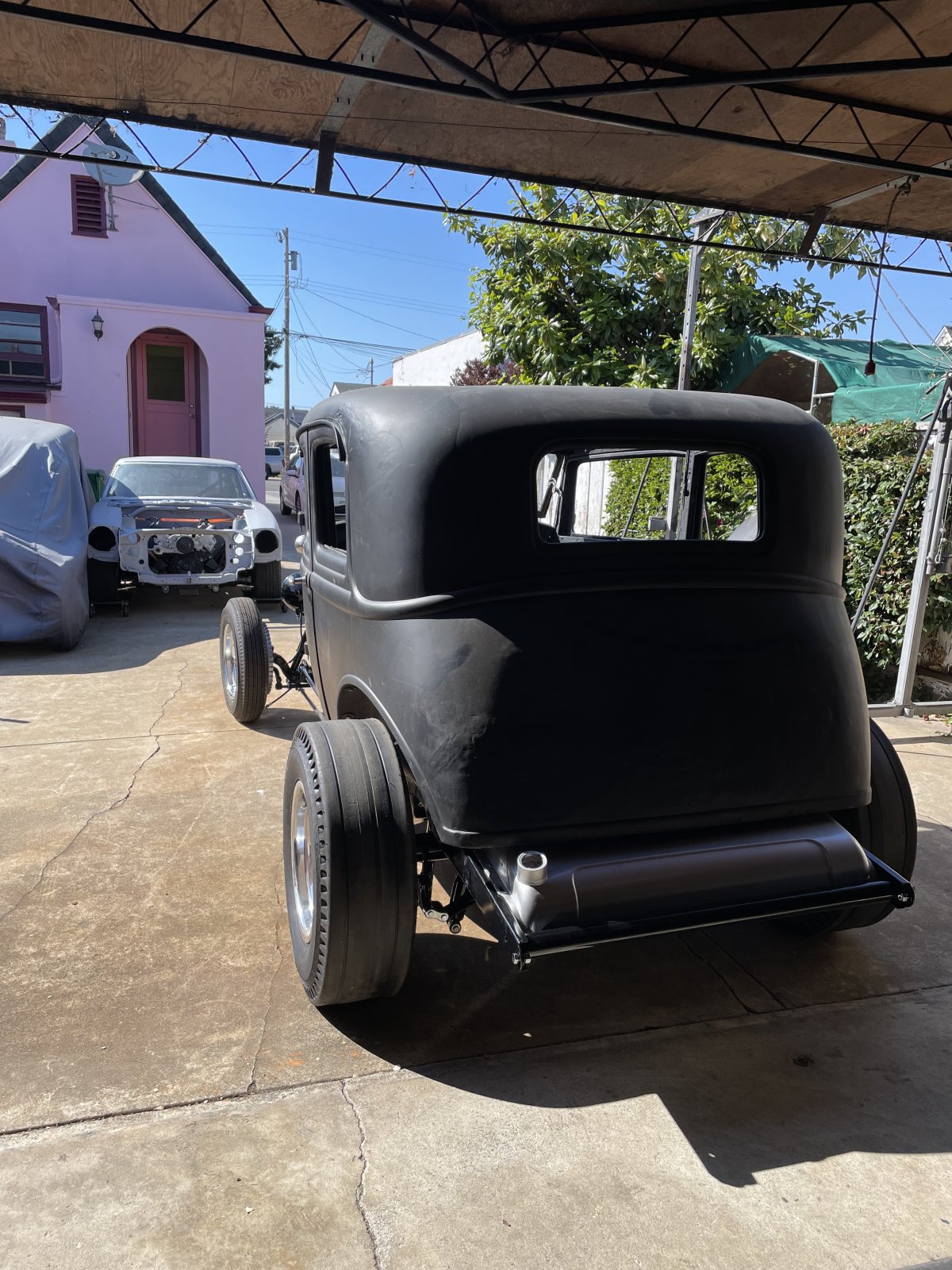

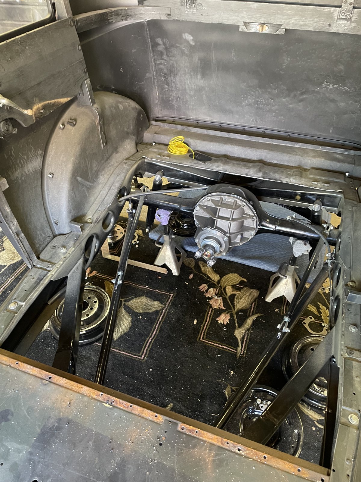

    Well the body came off again. I had to cut out the floor and install a flat floor because the diff was hitting the floor.
    Since the body is off I had a friend convince me to at least do some quick body work and get the car in colored primer for now, and also shiny paint some of the bits.(I won’t reveal the color until the body is back on the ch***is)

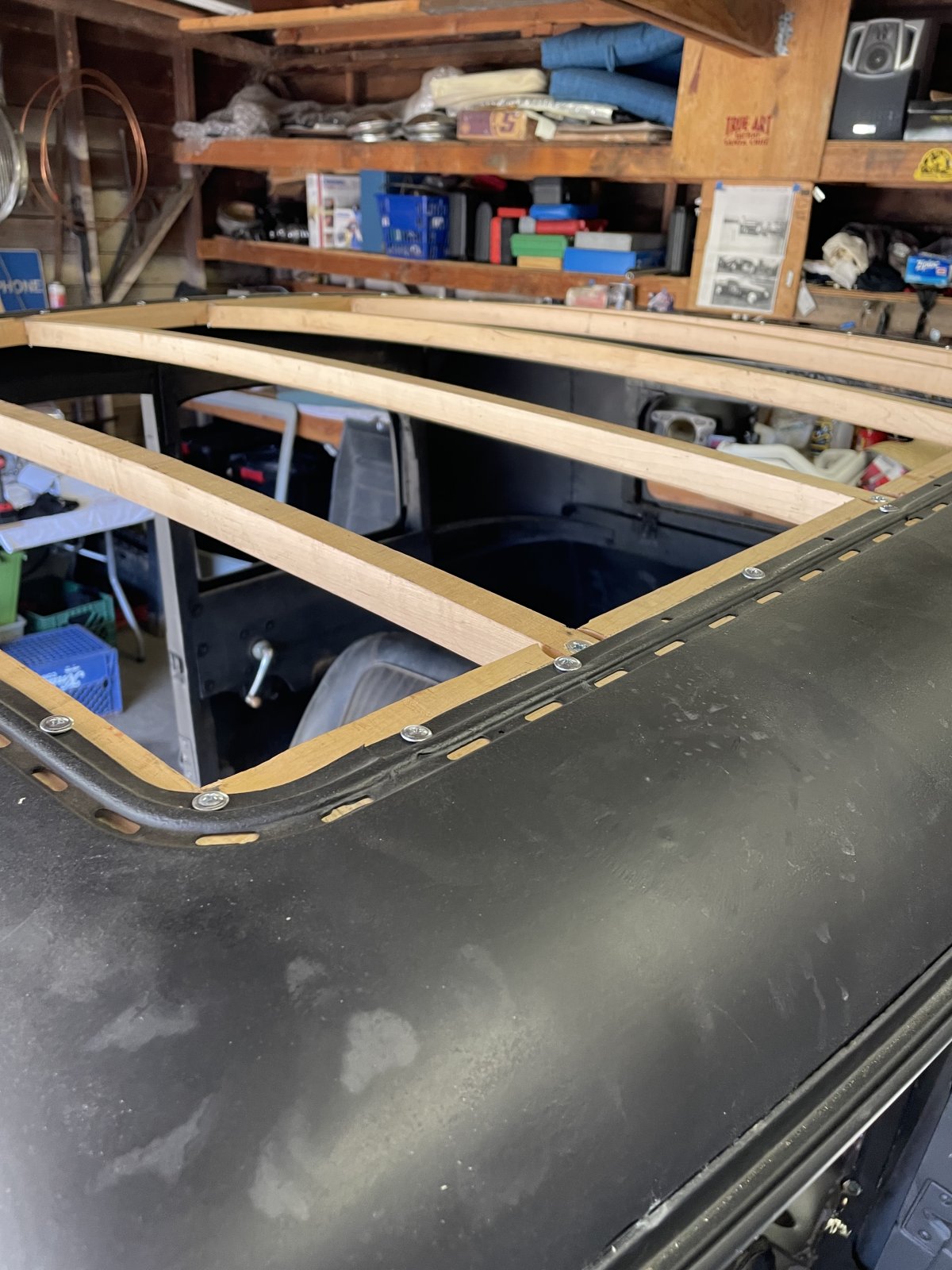

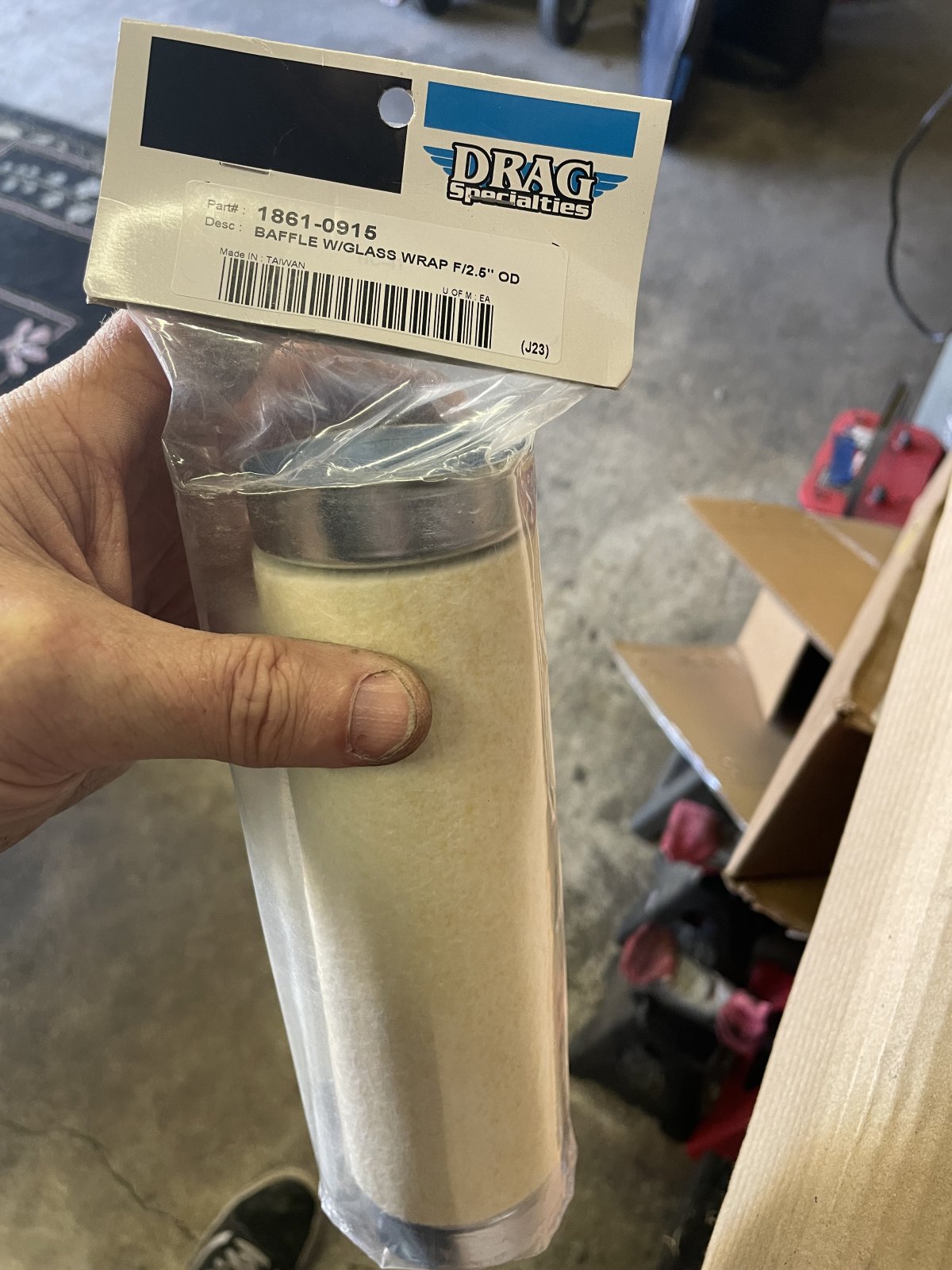

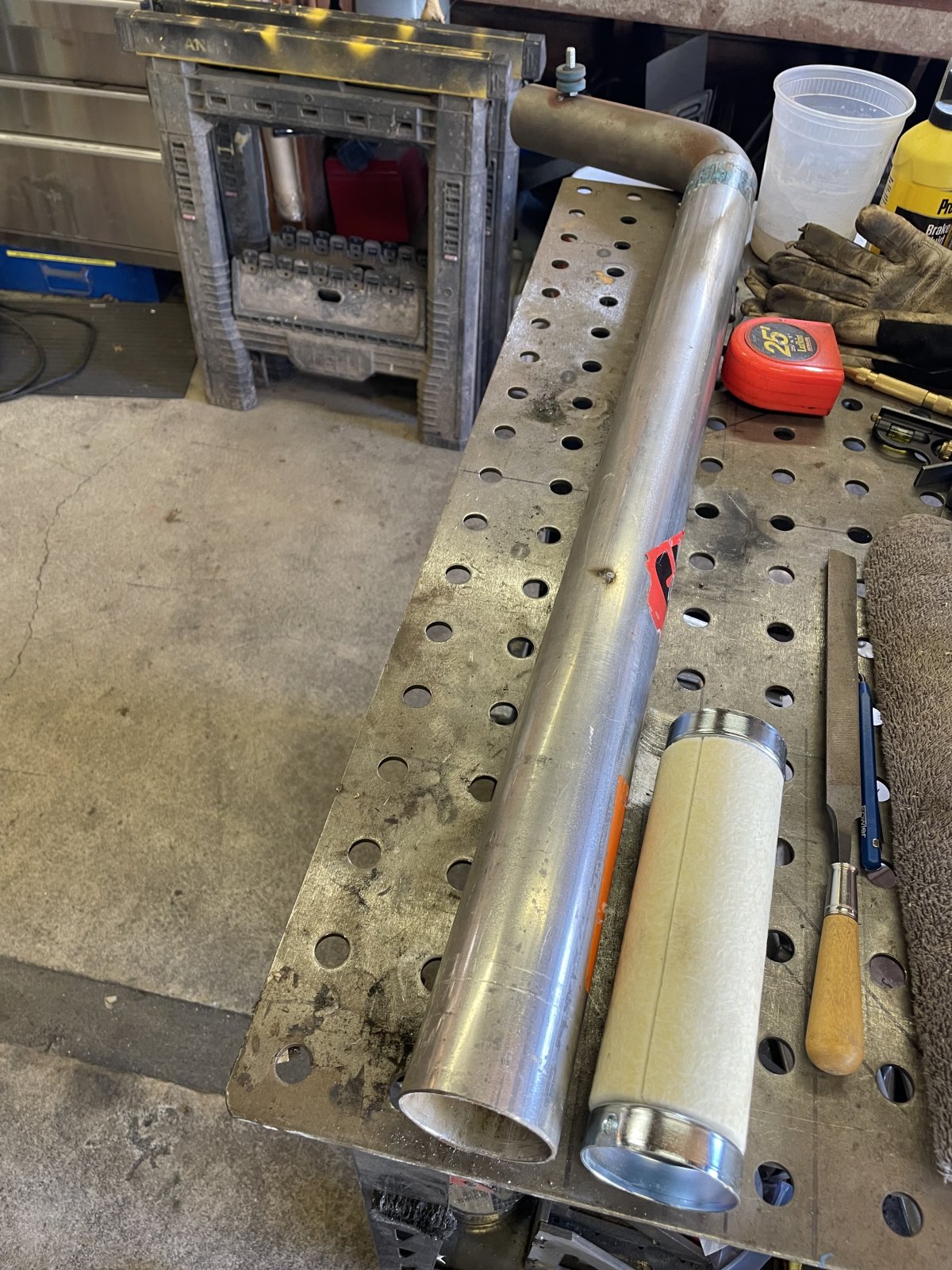

    since I have access again I built a quick and easy side pipe for breaking in the motor. I will do out the back under the car exhaust after I get the car on the road.

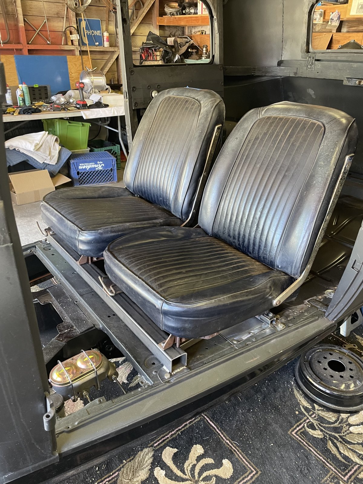

    I also did the top wood and built the seat riser with some little skirt doohickeys for appearance sake.
    FLiP
    winduptoy, Outback, Fordors and 3 others like this.
