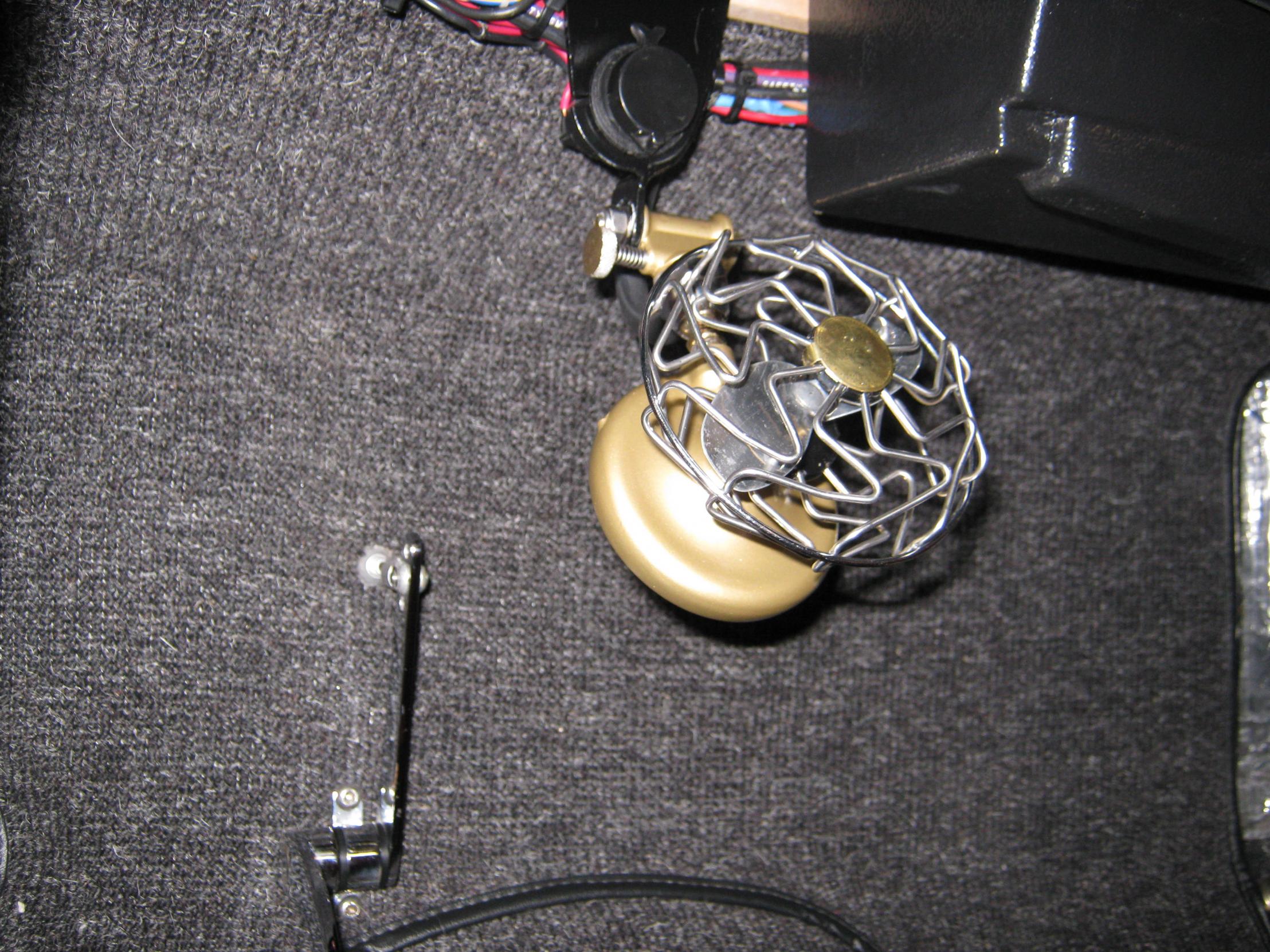

    All it needs is lubrication. The shaft needs oiling. It can be hard to get the oil to where it is needed. A spray can with the red plastic tube is helpful. It may take some time to work the oil though. The hole in it directs the air flow across the vanes inside that turns the shaft and of course the fan blade. Mine was slow at first too until the lubrication took effect and it would need a kick of the blade to get it started. You might try to hold the fan so that gravity will help to oil the shaft.
    I would not try to pry the back off of it. I have one with that back panel loose. I guess it could be epoxied back on but I see no advantage to removing it. The one in the picture looks to have a nice factory finish that I personally would try to preserve. JMO.

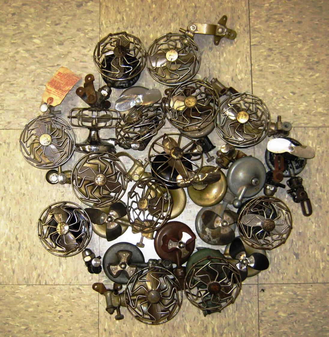

  11. I have snapped them back on dry. It's best to finger a dab of RTV around the housing before snapping it on. I have more than a few of these fans. I broke down and put A/C in my 34. I refused to put vents in or under the dash. The A/C worked ok and Honey's feet got real cold. I put my fan under the dash to blow some air up into the car. Worked good and looks cool. We call it our "****og entertainment device"

    Thanks for the info I will give it a shoot see what happens. This is the one I'm working on [​IMG]

  21. Did someone say Trico Fans? A buddy saw this and told me "step away from the key board and call the Bette Ford Clinic"
