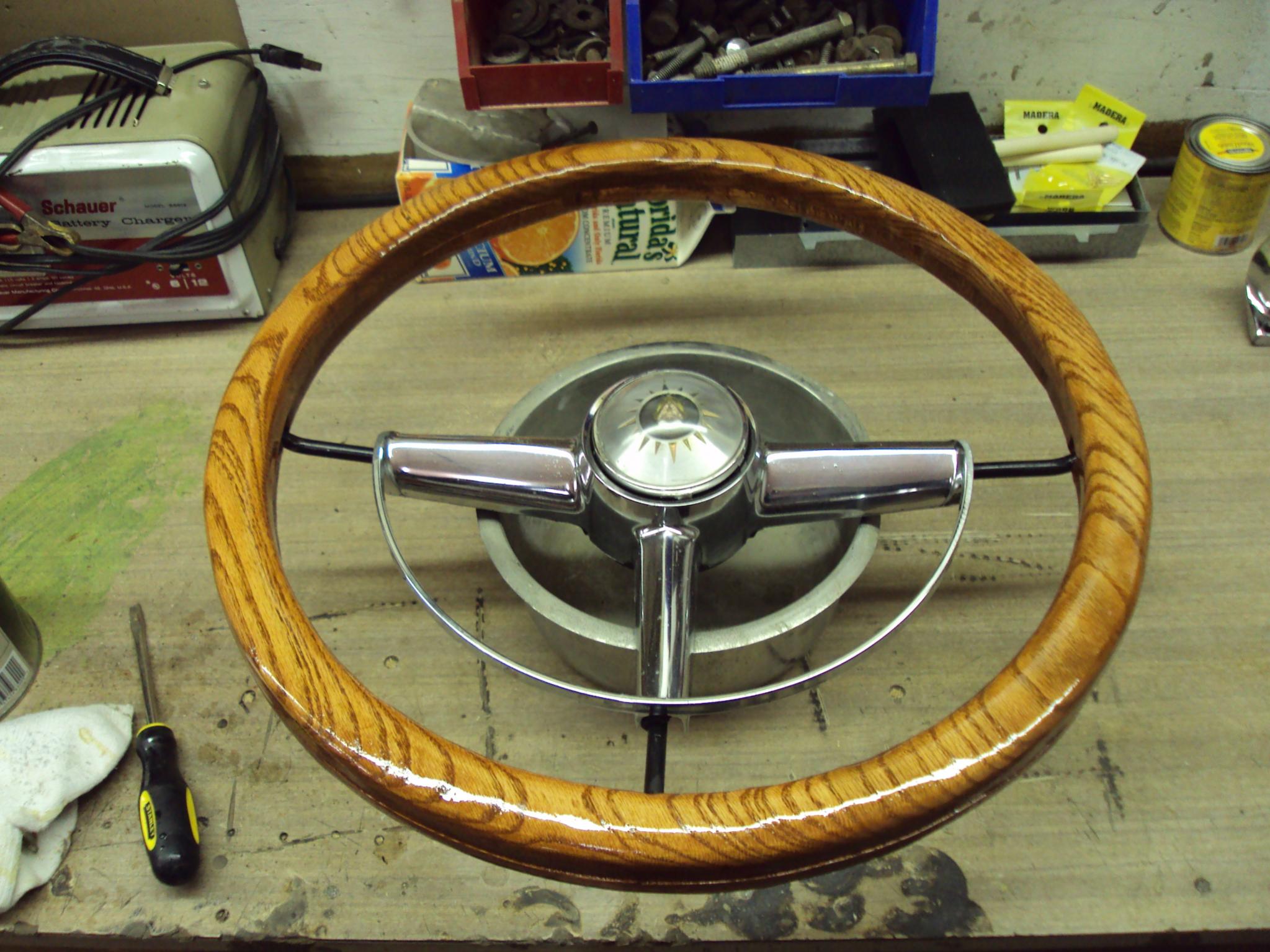

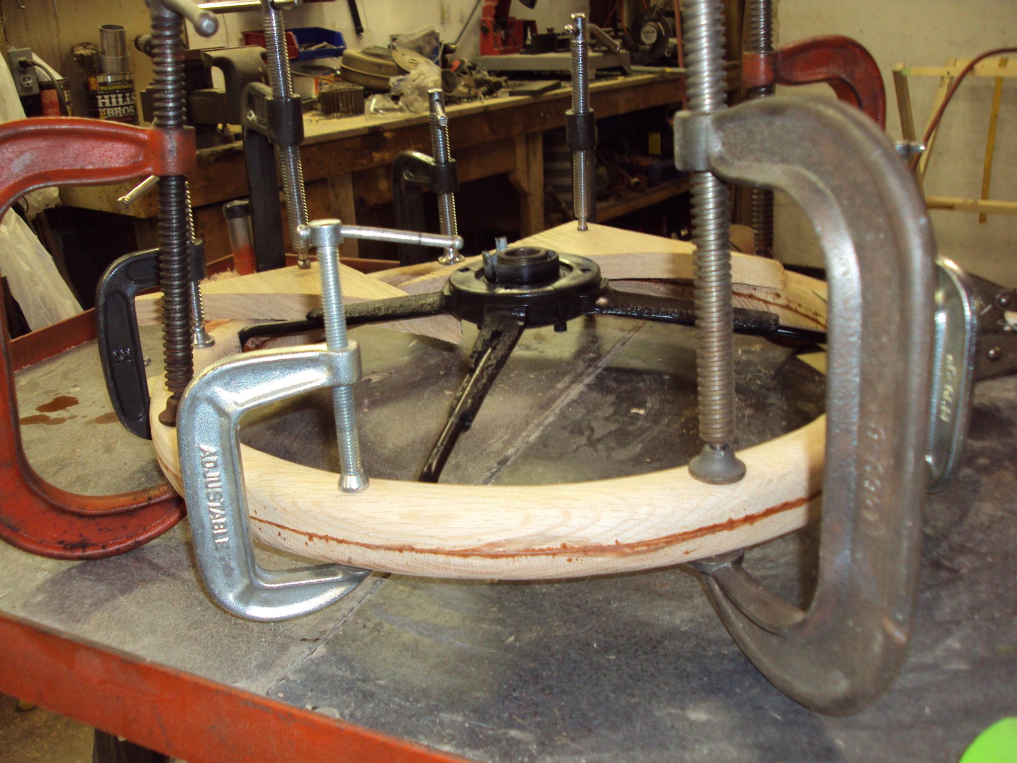

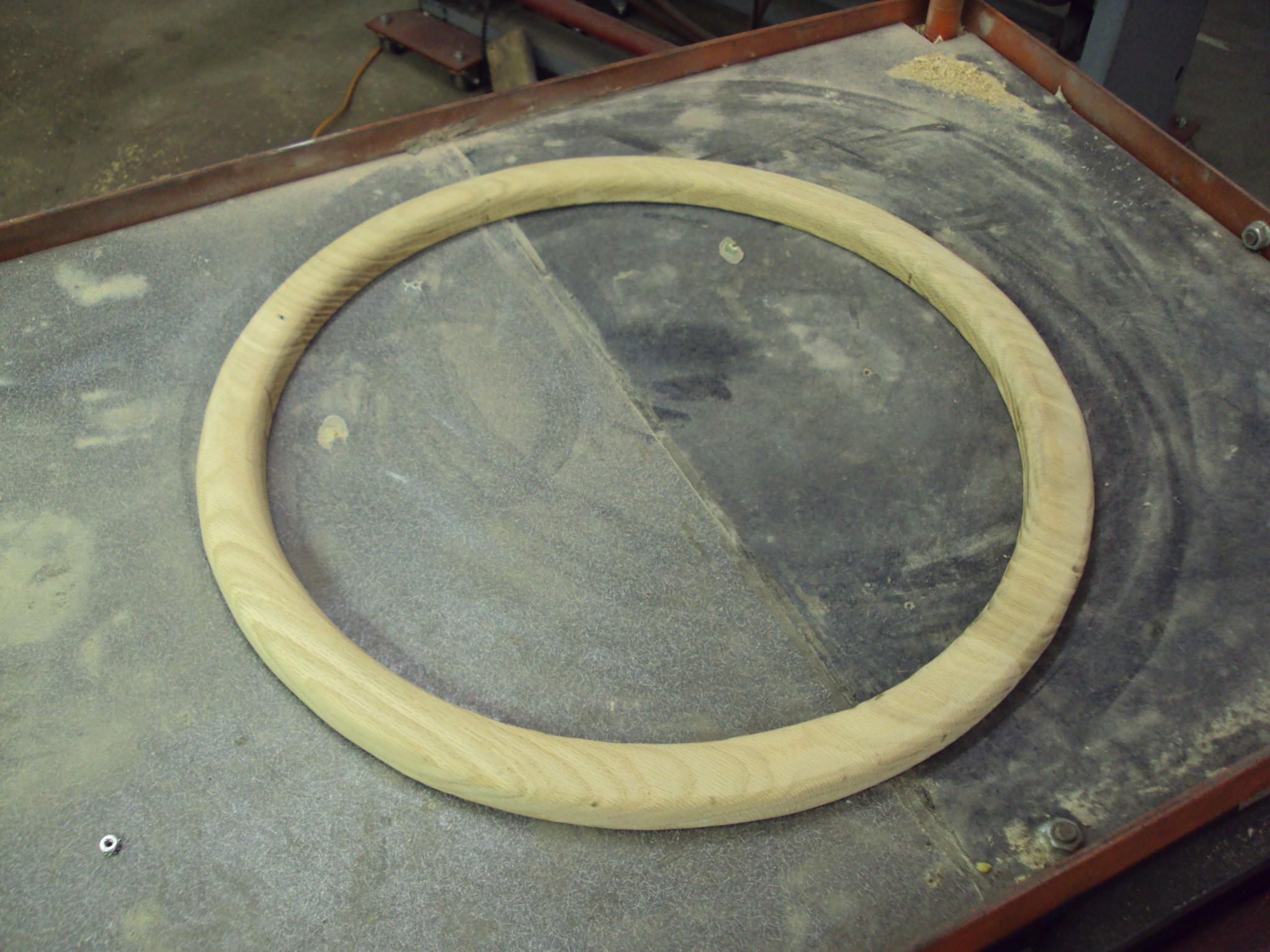

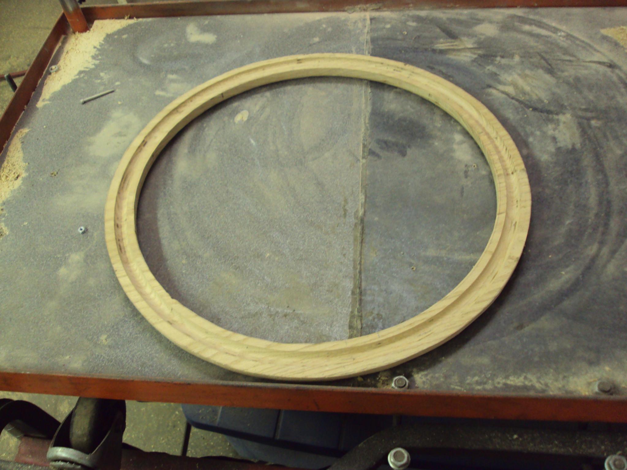

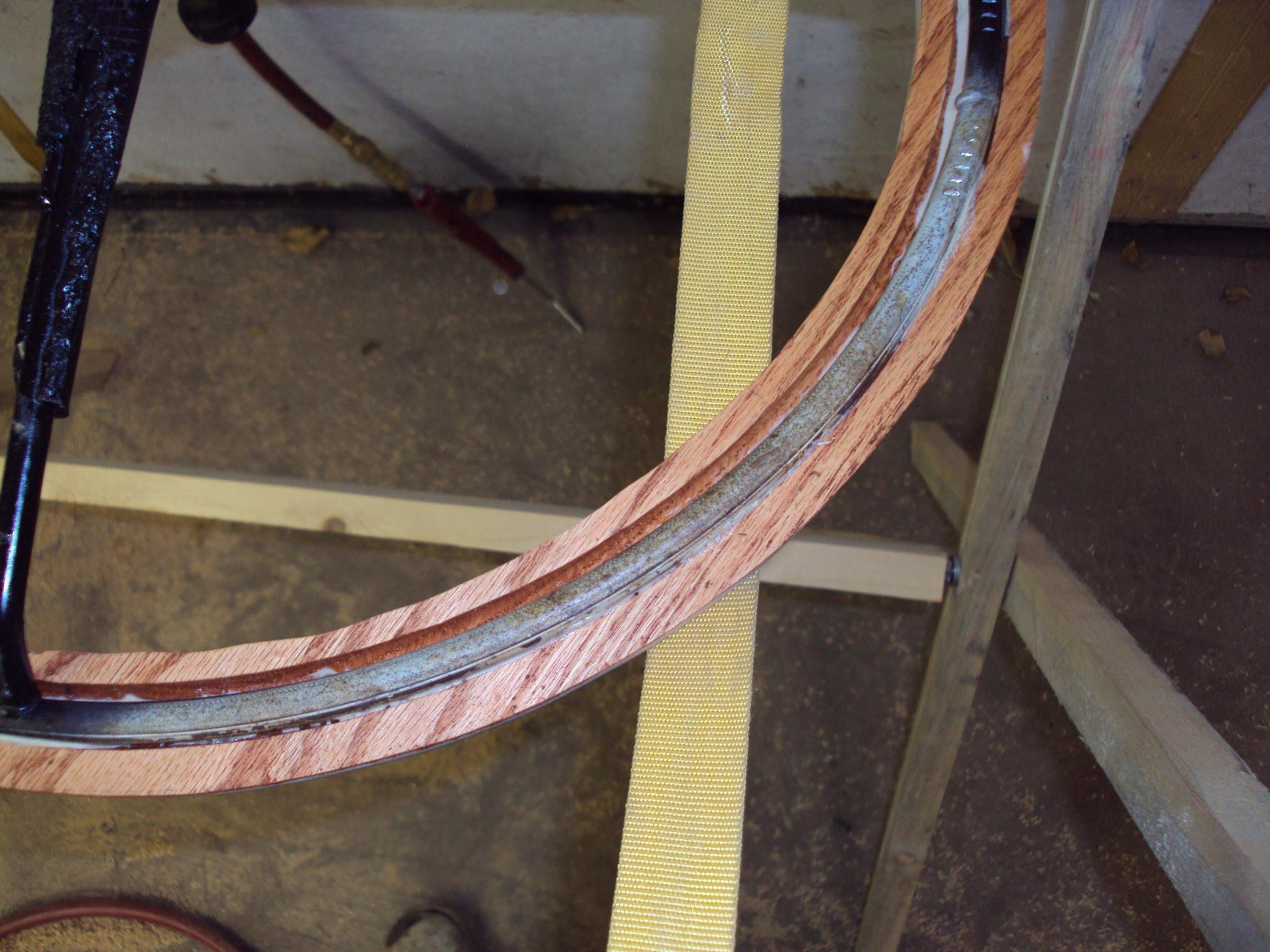

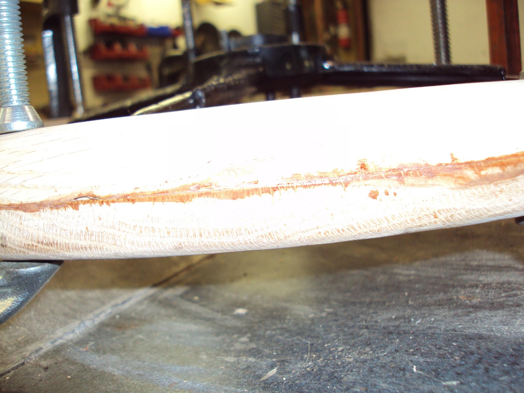

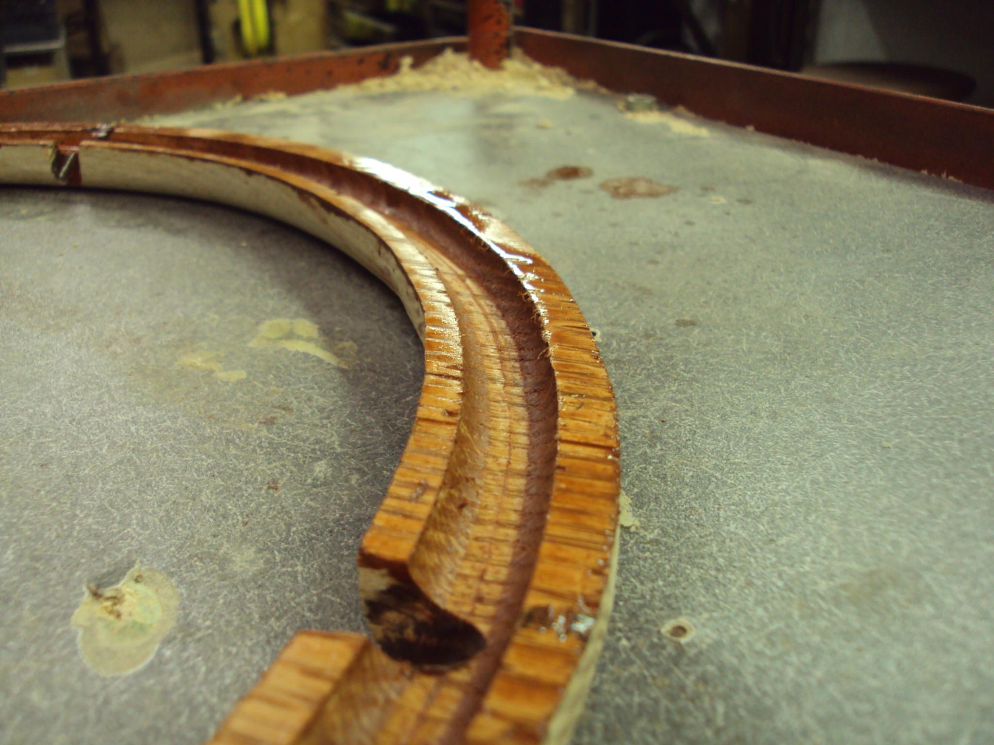

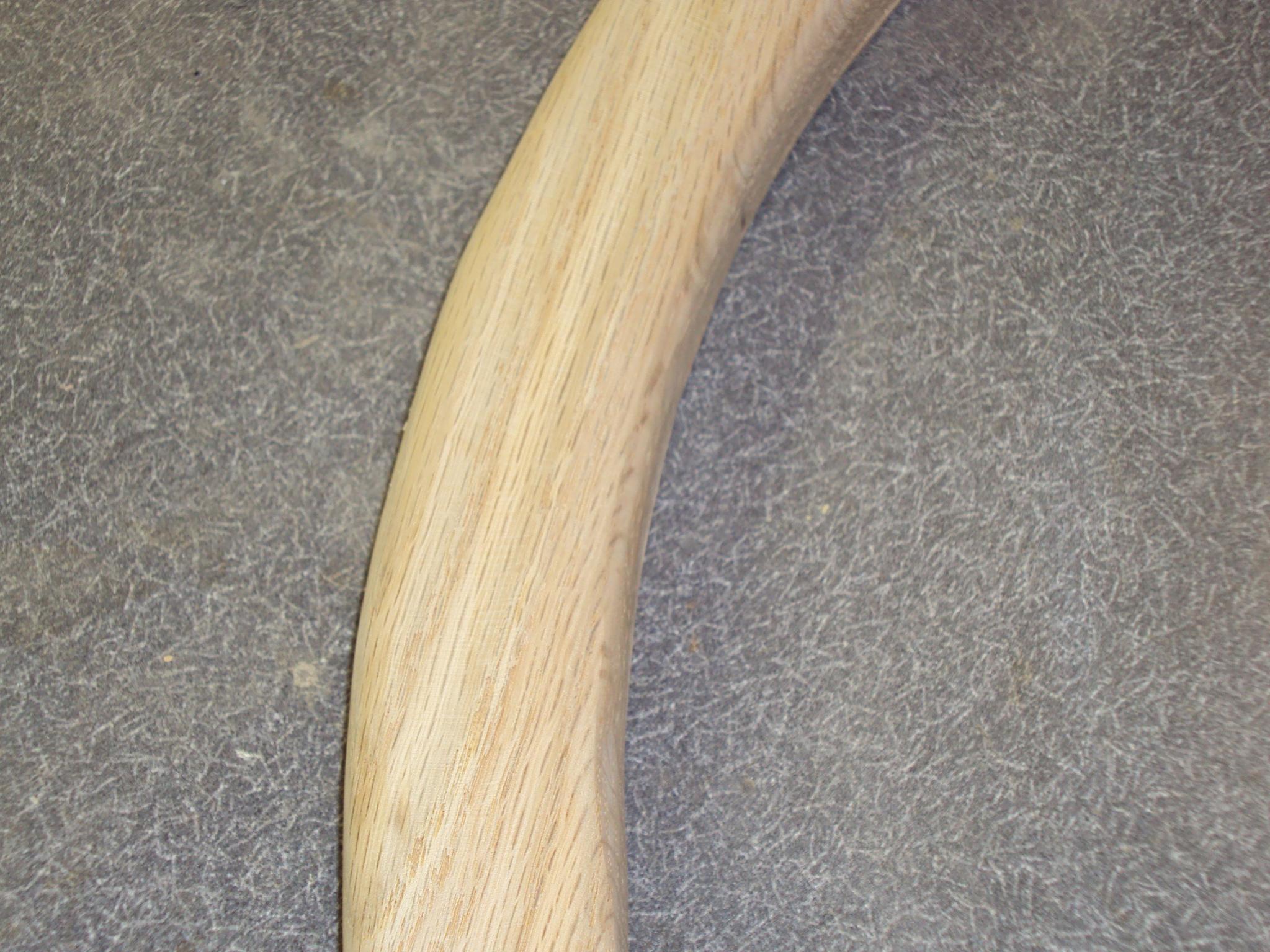

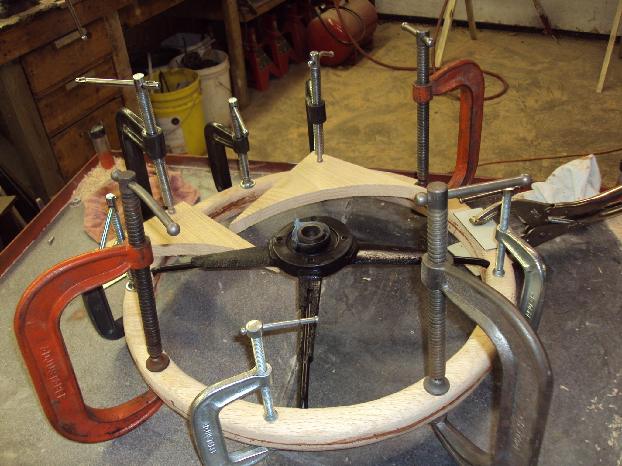

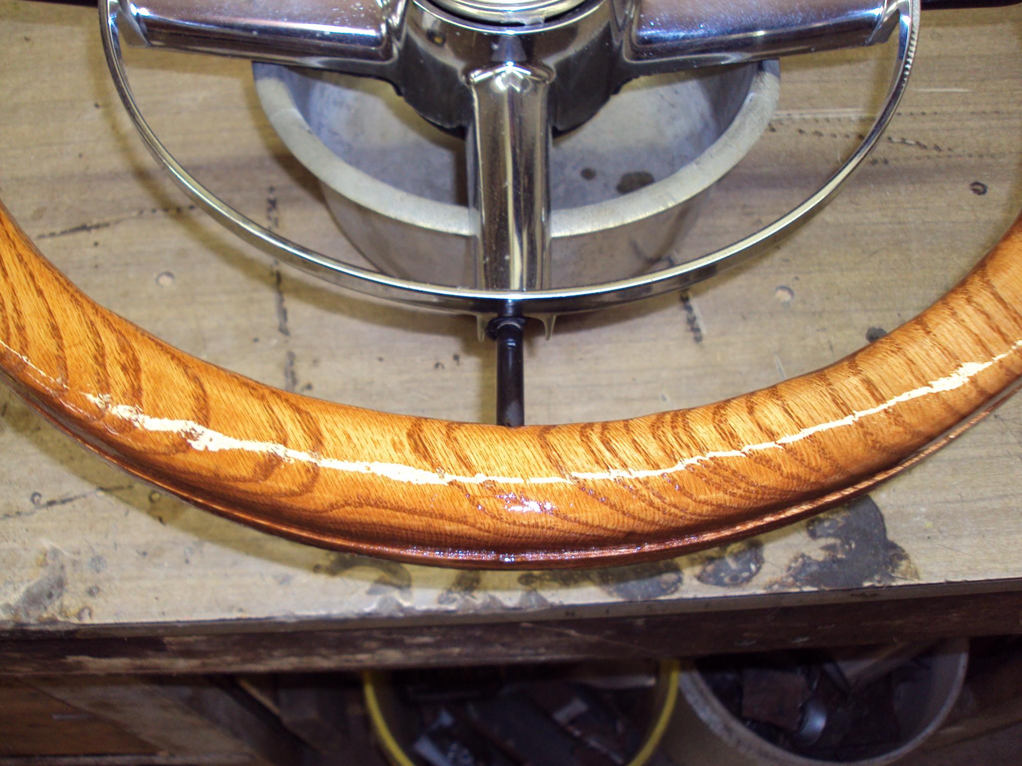

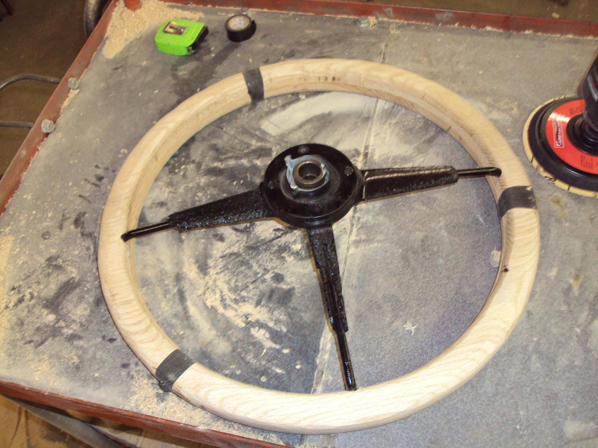

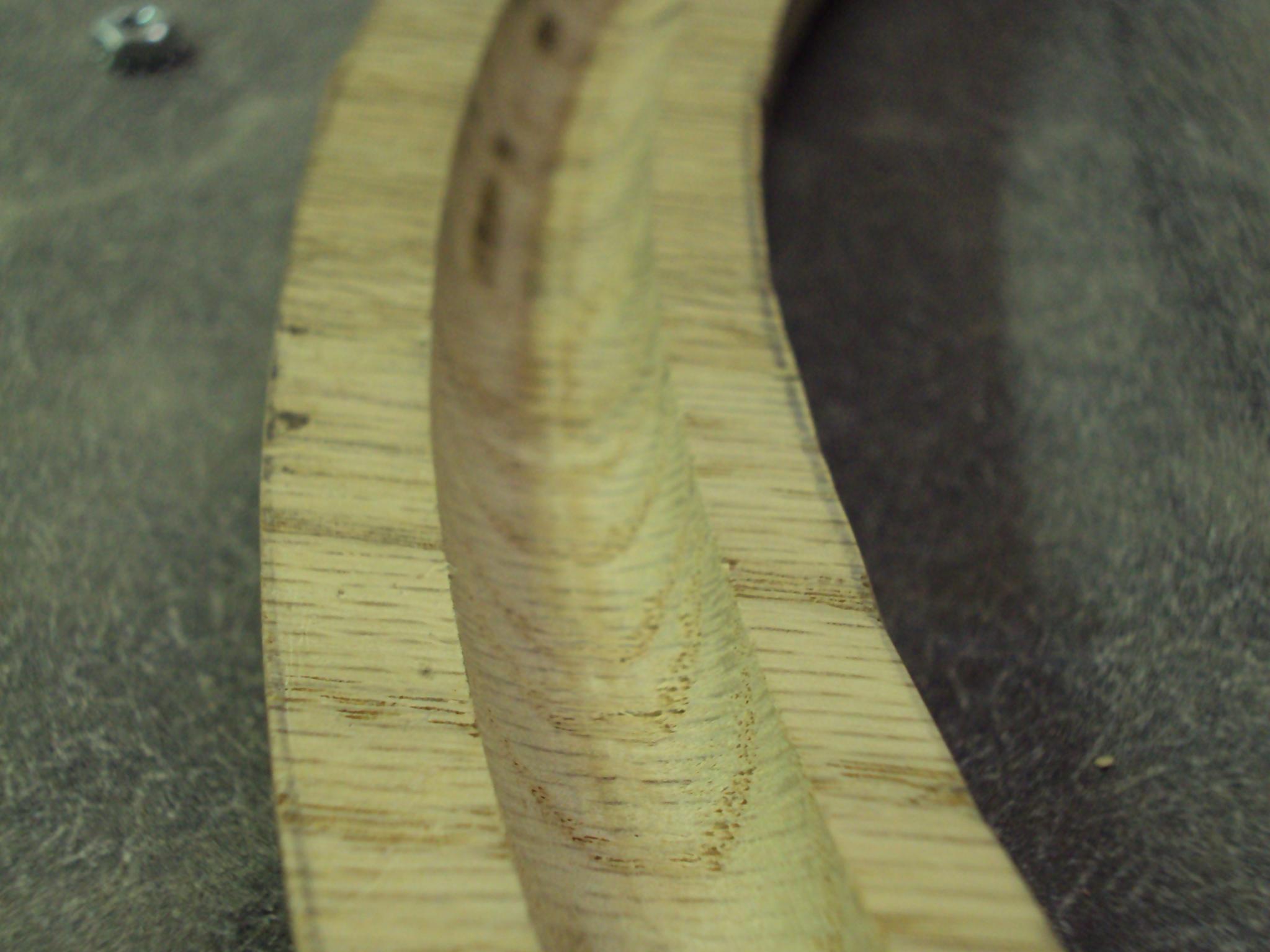

    I started out with two peices of oak that were big enough for the BIG DeSoto steering wheel. I then traced around it where the round-stock of the steering wheel needed to go inside of the wood and then measured out how big i wanted the steering wheel to be thickness wise. I had to make up a jig for the router in order to get a perfect circle which worked well. I first routered out the circle with a 3/8 wide by 1 inch deep router bit. After that was done... I used a 1/4 round router bit to get the general shape i wanted to save myself from TONS of sanding. I also used a 3/8 wide half-round bot so the metal rod could be channeled into the wood. Once that was done I used some liquid nails to hold it together and clamped it.. I also put a total of twelve screws evenly paced out though the back to hold it together. Once it had dried, i put a couple coats of MINWAX Gunstock Oak stain and let it soak in for a day. I put the poly on a couple of times and sanded in between coats to get a smooth coat. Steel wooled the chrome center ring and cut off the top part of the ring to give it a more custom look and it was DONE!!! I thought it turned out very well for my first shot at it.

    thanks.... im 19 and i kind of pulled it out of my ass... Turned out well i think... thanks for the compliments and would like ANY advise you might have!

    Thats a beautiful finish! way to go the extra mile. in the full finished picture the wheel looks kinda thick is that the way it looks in person also? Make sure and post it during tech week. Keep up the good work!

    nice job - looks great. The ONLY critcism I have is when wooden steering wheels are built they are often in segments or strips of wood that are joined together. Done for several reasons. Small strips of wood (even scrap) can be used instead of wide boards and cheaper to make. And most importantly the direction of the grain is longitudial instead of across the wheel which imparts strength to the structure. You are fine in your construction because you have the steel ring for strength. I have seen some where the builder used alternating dark and light wood (walnut and maple) and also made it in 2 halves so that top half and the bottom half can be sandwiched over the steel ring with each half rotated so the colors were alternated from top to bottom. You did a great job and much nicer than I could do!!
