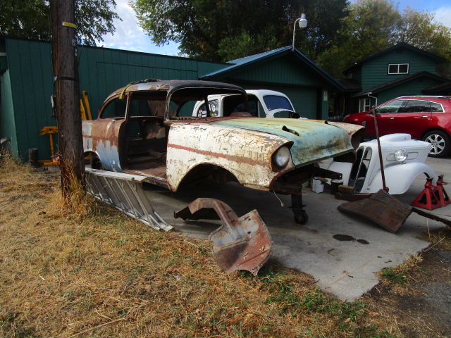

    1957 Chevy with a '57 Chevy truck axle, spring shackles in front or in back of spring AND why? On the truck Chevy must have spent a little R&D on this subject and decided to install shackles in front. I see gassers both ways. Pro's, Con's?
