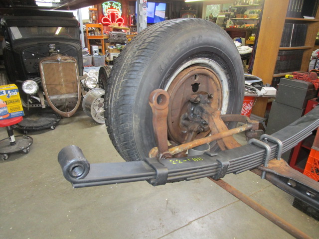

    Every time I have a question on anything you guys have come threw & saved me alot of time, money and frustration, thanks. Got '57 Chevy truck axle ready to mock up under my '57 Chevy 150, drilled axle holes, "fitted" '61 Corvette drum brakes to truck spindles, still need to drill backing plates. Question, need info on what type of steering box and arm to run. Remember pics are a plus! Thanks!

    First choice is to keep in front of the front suspension area clutter free if possible, but realize modifications will have to be made. Looks like I am jumping the gun a little. First rule of hot rod building is mount what has to go where it goes and modify to fit the surrounding parts. Will be back after the stub frame, axle & springs are mocked up under the fenders.

    My main goal is trying to make it look like it was built in the '50's-'60's, with parts of that era. Keeping it simple and safe, maybe I am dreaming! Already figured out that I better get it all mocked up under fenders with stub frame & BBC mocked up than figure out what can be done. With motor/trans placement, steering, headers, etc. At the most I may run a pan hard bar if not to cluttery looking or in the way of BBC pan. IMG_5440.JPG

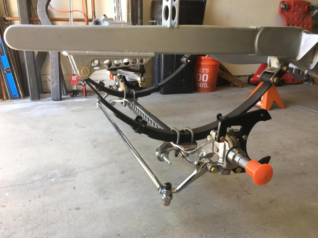

    55 Frame with 1958 3100 axle, custom springs and Borgeson 525 box.
    [​IMG] [​IMG]

    Is it me or my mind losing it. Is that axle or parts of it-in funny. Seems to me the axle should decapitate the chicken, before tie rod.

    Appears to have the tie rod up front, so I hope the steering arms are outside the kingpins to have the correct Ackerman angle? It's much easier to attain correct angles with the tierod behind, but it can be done in front if your wheels have enough offset to not hit the steering arms.
