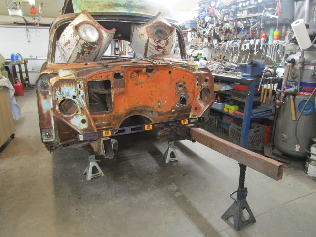

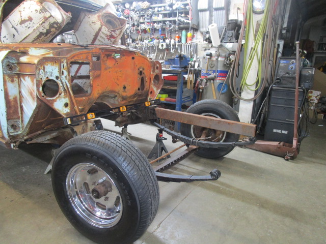

    IMG_5480.JPG What size rectangle tubing for the sub frame? I have 2" X 4", 1/8th wall but it looks a little wimpy, should I jump up a wall thickness to 3/16th.?

    2" x 4" x 1/8" wall is more than strong enough.
    Most Car hauler trailers have that size for main frame rails [with a heavy car straddled each side of the central suspension mounts.]
    If you look at your photo above [and here] the suspension loads are transferred via 4 points. [2 are attached to the original frame]
    If your car weighs 3600lbs with 50/50 front to rear bias that = 1800lbs on the front.
    The extreme ends [front] with maximum leverage need to support 450lbs
    You also need to lower the rear hangers by using mounting plates so the springs are a lot higher in the front.
    That way the axle will arc rearwards [red arrow] to counteract the spring lengthening as it is compresses [yellow arrow]
    This minimalizes wheelbase changes with suspension compression [and roll steer]

    The wheelbase changes from spring compression are so minor it's really not worth worrying about. If you ever compressed the springs hard enough to even get 3/4" movement you're probably going to have bigger worries than wheelbase changes.
    And if you put the shackles front or rear it's not going to change how the springs compress. I personally don't put shackles on the same side as the drag link so the drag link doesn't push/pull against the shackles. But if shackles are kept short around 3" eye to eye, and made of good bar stock then even this isn't an issue.
    Roll steer shouldn't be an issue either unless your springs are fairly soft. The average spring packs used in a solid axle build don't allow as much body roll as any A arm coil spring front setup.
    Not sure how you'd ever get 54" springs under the front of a Tri Five Chevy? The front mount will likely be way out beyond the bumper! There isn't 27" from axle center to the bumper on a Tri Five.

    1971BB427, I think Kerrynzl's drawing above was intended as generic? Just like you I always appreciate all of you taking the time out of your day to respond to Hammers questions. Just trying to tack weld in sub frame & mock up axle and wheels/tires to get a feeling for where "things" like shackles & steering box will be mounted, easier for me to go to "A" to get to "B" than "C"!
