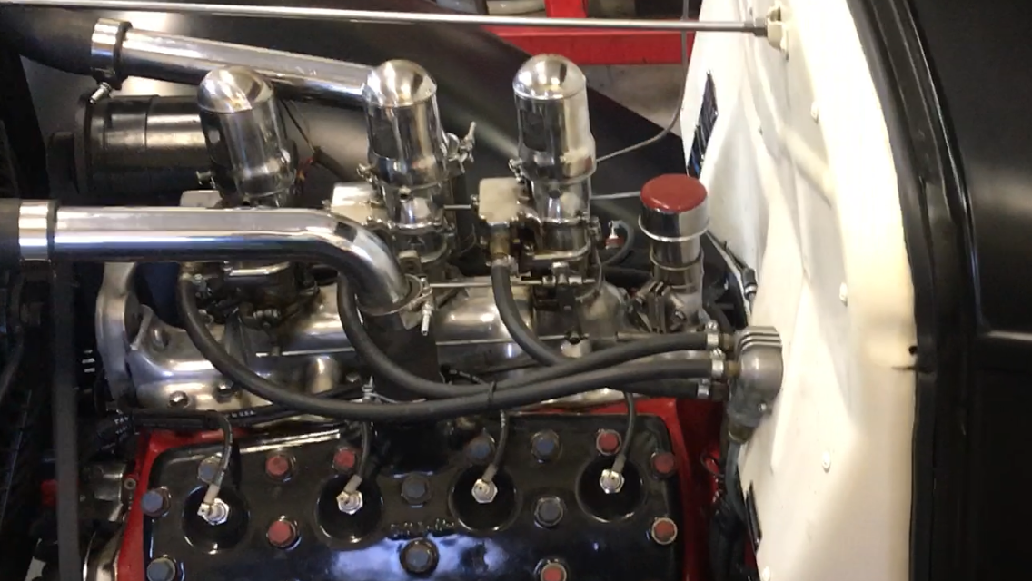

    IMG_0479.png Sell your three carb setup. You don’t need it and it will be a pain to keep that tamed engine operating efficiently.
    If you do want to run three for looks blocking off the center carb with well ventilated manifold runners will work.
    I’m running my center carb closed, I’m also running an offset generator on this hot flatty.

  12. Question: It appears you're not running a fan idler . . . so you're either not running a fan or you're running an electric fan?
  13. Petejoe
    Joined: Nov 27, 2002
    Posts: 12,637
    Petejoe
    from Zoar, Ohio
    Electric puller.
