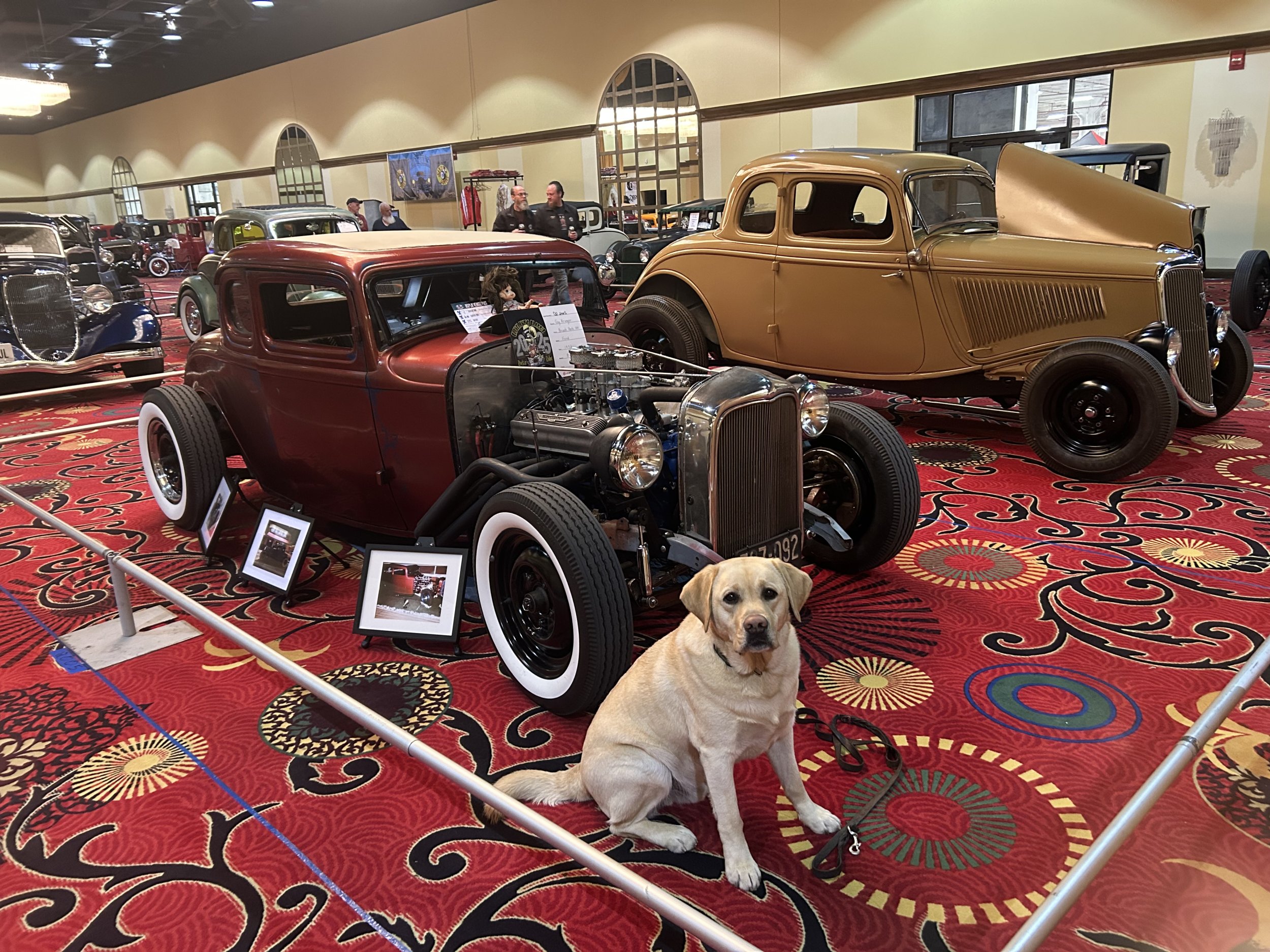

    you're gonna have a rich stumbling problem with that exhaust no matter what you do... torque band must be nere 5'000 rpms... and even worse if there are baffles...you have zero scavenge.... that set up needs a blower...#2 pipe is probley a foot longer than #8.... you need a collector and a 18'' scavenge pipe...
