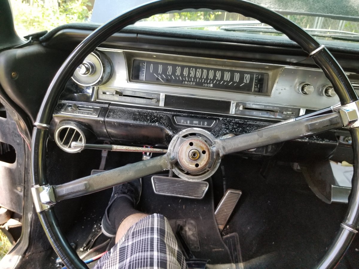

    I understand that. I am trying to help you figure out how to remove the steering wheel. But I can't see exactly what is wrong.
    Is there no way for you to take a picture of it?

  12. squirrel
    Joined: Sep 23, 2004
    Posts: 59,234
    squirrel
    yay, pictures!
    But can you take a close up picture of the threads, after they got messed up?
    Also, when you say the wheel won't come off, did it move at all when it popped? Or do you think maybe the puller just slipped, or something?
    Johnny Gee likes this.

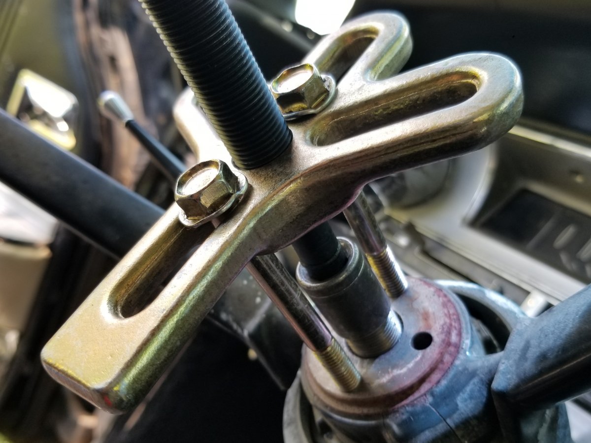

    ^^^^^ Using a balancer puller to pull steering wheels (guilty) the bolt/bolts sometimes slide inward under tension just a tiny bit and make a popping sound.

    I dont have pics where the thread went out i put everyrhing back on. It's not the first time ive used a pulley have taken off steering wheels off before. I used two pulleys for this and had no luck. It would not come off i did notice while bitting it w a rubber mallet that debree in the middle was coming off. Or maybe rust that has been there for years. When i would pull it would feel like the whole steering column came towards me and not coming off the teeth. I would even twist the steering wheel to see if i got any play but nothing would happen

  19. Johnny Gee
    Joined: Dec 3, 2009
    Posts: 14,051
    Johnny Gee
    from Downey, Ca
    Photo's OK. Can't tell if there are threads showing or puller has bottomed out on steering wheel hub.
