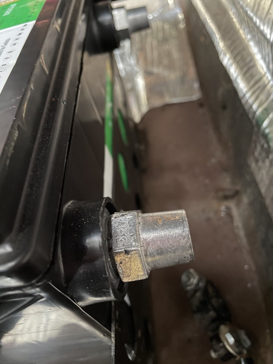

    Well **** I’d never thought about that. 02413F4A-EECA-49D5-A686-AD6533C56862.jpeg Looks like we could have a winner. I’ve always figured the made the connection threw the threads or the bottom of the hole.

    tell us why there is a side post battery, with top post type terminals on it?
    Does the battery have to have side terminals so it will fit in the car? If so, maybe you ought to buy the correct battery cables, or at least the correct terminals to put on the ends of the cables.
    RMR&C, saltflats and Tman like this.

    I didn’t intentionally buy a side post battery. I looked up what I needed spec wise and the photo and info online suggested top posts.
    when it showed up it had this arrangement. Website must be wrong? Everything else looks correct.
    anyhow I figured I’d just put the lugs on it and go about my day as it doesn’t really make any real difference space wise where the cables land.
    when I looked up screw in battery posts there were plenty to choose from so it never crossed my mind that it was unusual to do?
