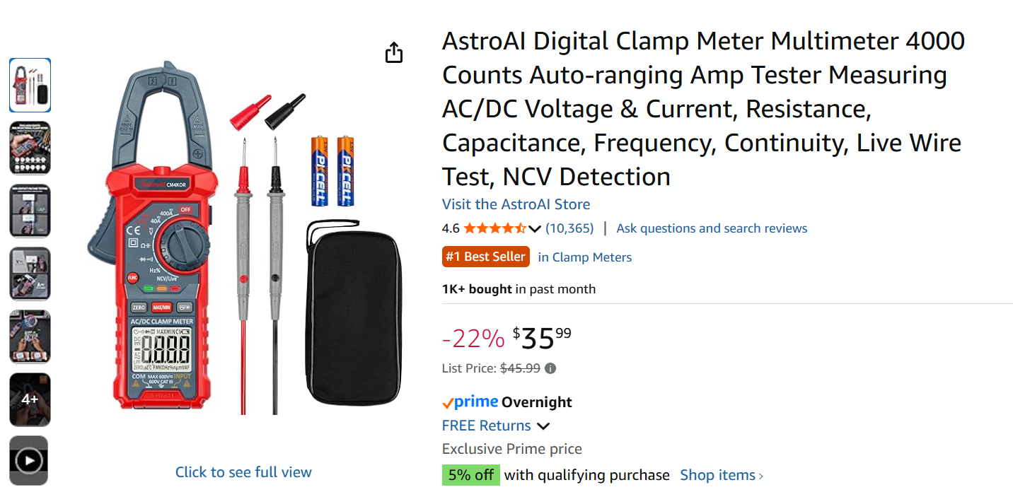

    That aint the best idea as it can easily take out the diodes. I just bought one of these on amazon. I have a nice multi tester but these inductive amp meters are worth $35.
    The alternator is suspect but needs testing rather than replacing. I had a Camaro that would go flat overnight but only sometimes. Other times it would be fine for weeks. Alternator had a bad spot where it would stop occasionally and kill the battery, it was like Russian roulette until I finally replaced it.
