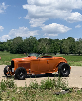

    I put a 4 speed Muncie in my 32 Ford. Started out great the first 200 miles.
    Then it would get stuck in 4th. If I tried hard it would come out. Then would work fine until getting stuck again. Then it started grinding going in reverse,but not every time. Now I’m having trouble in all gears but not all the time. Getting stuck and or not going in gears. Before I say all I’ve checked or have done I would like to hear what you think.
