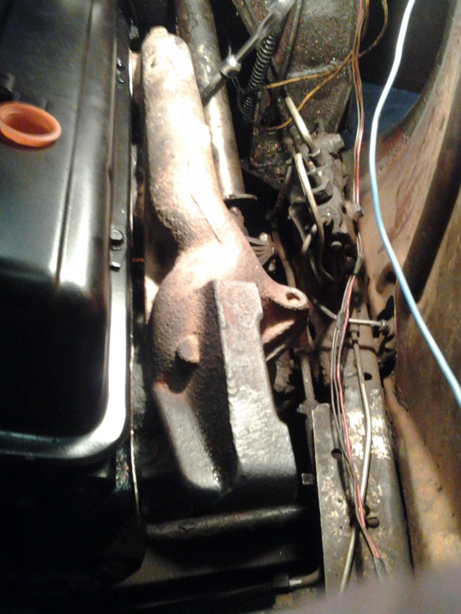

    just an example. installed in a 33 chevy. note steering box, exhaust,and mechanical clutch linkage. installed in an engine compartment smaller than yours. DSCF4148.JPG

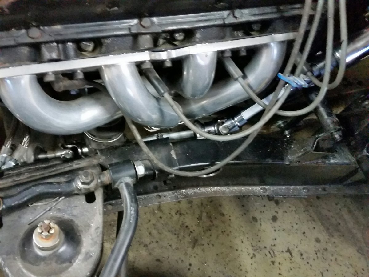

    those are original hedman headers from 1957. they were modified to hook around the steering box by my dad and uncle when they were teen agers.

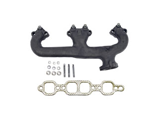

    If you can find one a tri five chevy exhaust manifold works well they dump more towards the front there are also others that dump to the front. Here's a picture of the tri five and another one I think came off a truck you can run the numbers to see hope this will help. 20170724_105503.jpg 20170724_105212.jpg 20170724_105850.jpg

    Some of the Z28 Camaro manifolds had a nice exit out the back. I see them as used on evilBay all the time and probably someone makes them new but for big $$$.

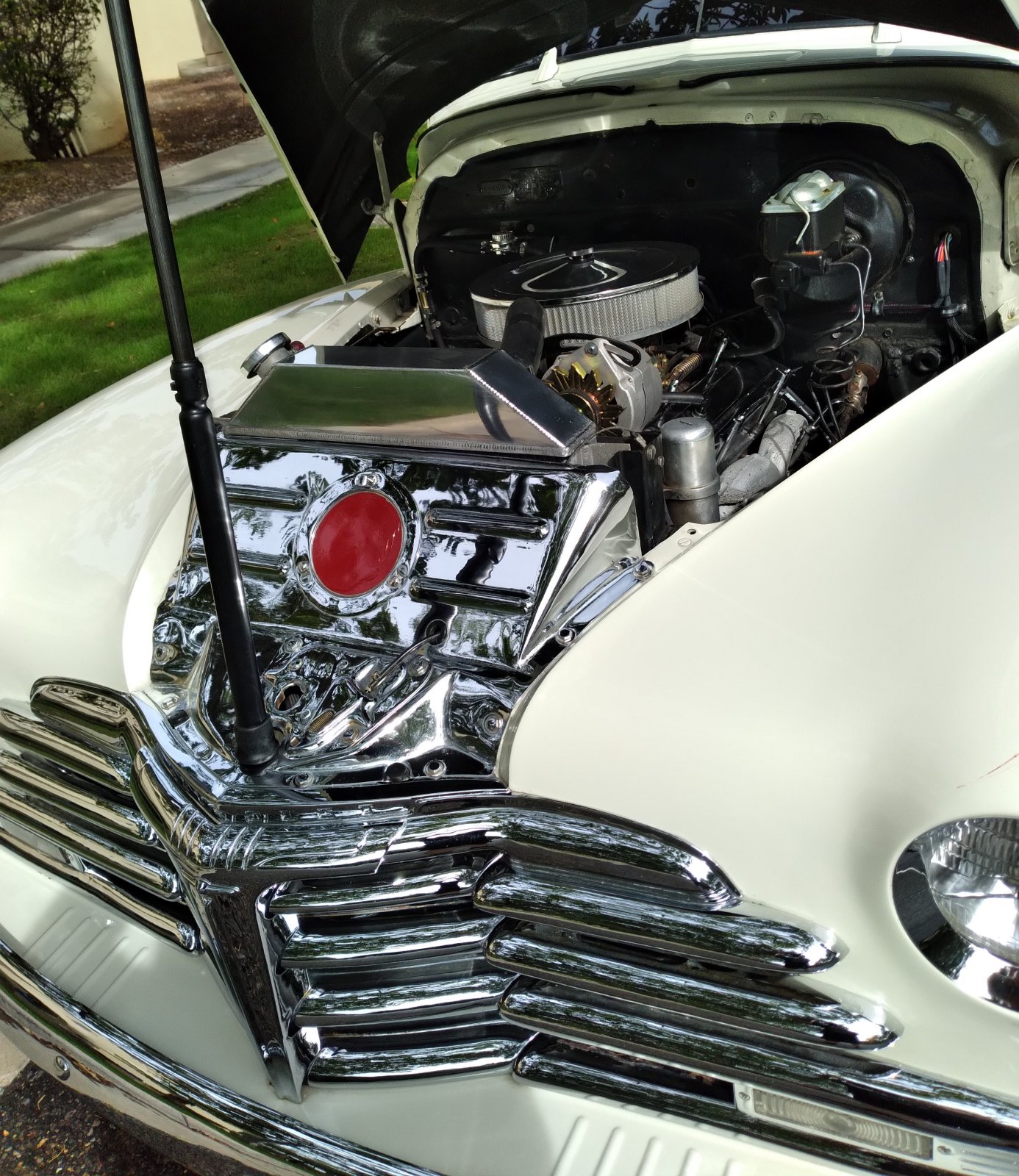

    I don't have headers, just the stock units. No problems with clearance anywhere.
