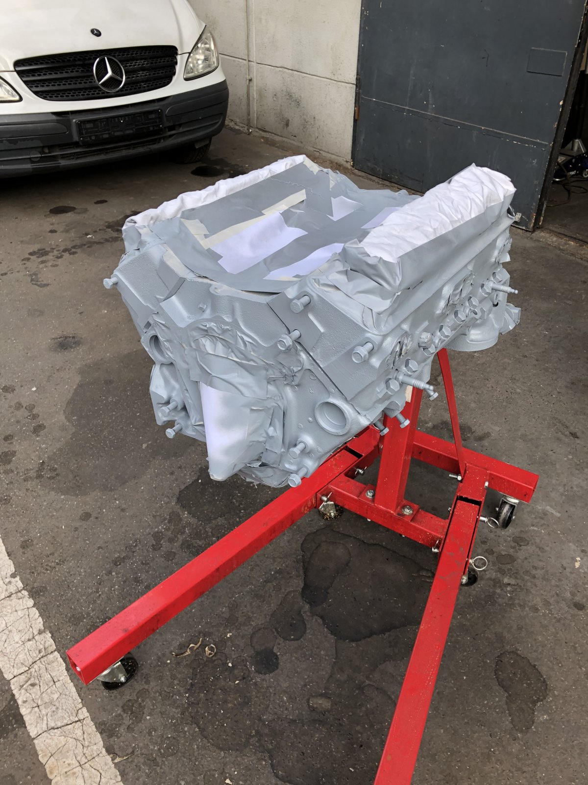

  2. Thank you xhotrodder for that very helpful text you wrote!
    My car comes out of the bodyshop after 2.5 years... so I will now start with the engines final position.
    I found a good set of tri-five headers and cleaned the engine inside & outside... painted with motor enamel and gave that oil-pan a fun-finish because the surface was so wavy that a uni-color let it look like sprayd over junk. So I decided to do that fun-painting - working like a came-foiling on that test-prototype cars you sometimes see on road-test.
    I also got a be-cool radiator from a friend and a second set of bolt-on engine-brackets for backup and many other parts...
    I will report how everything worked out.

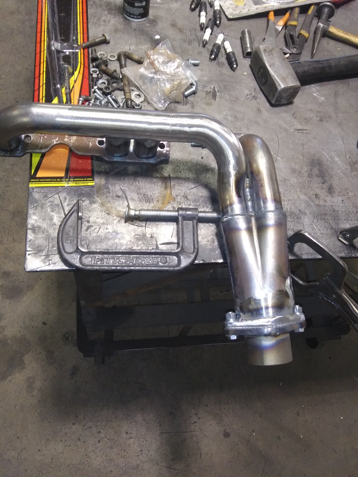

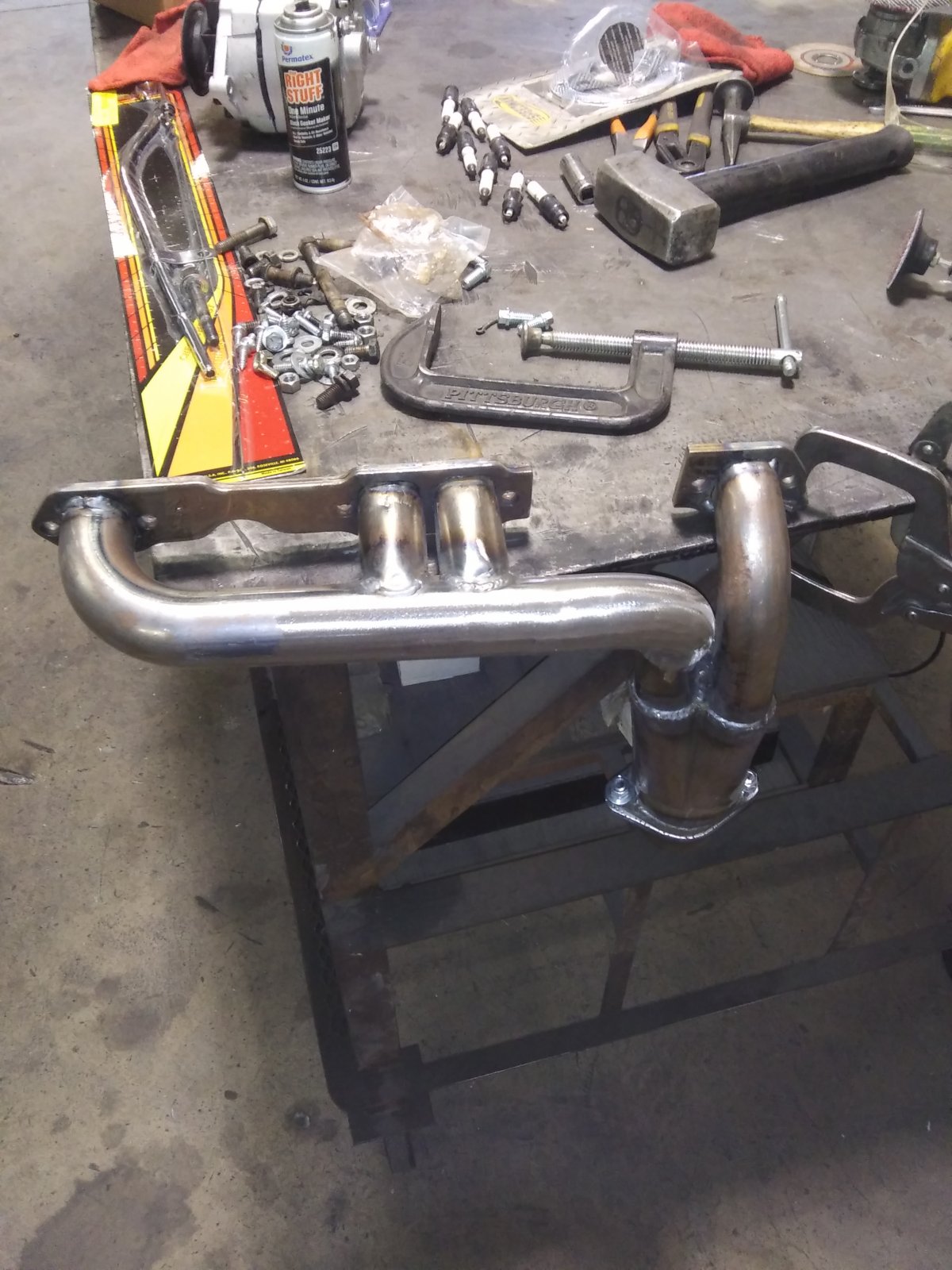

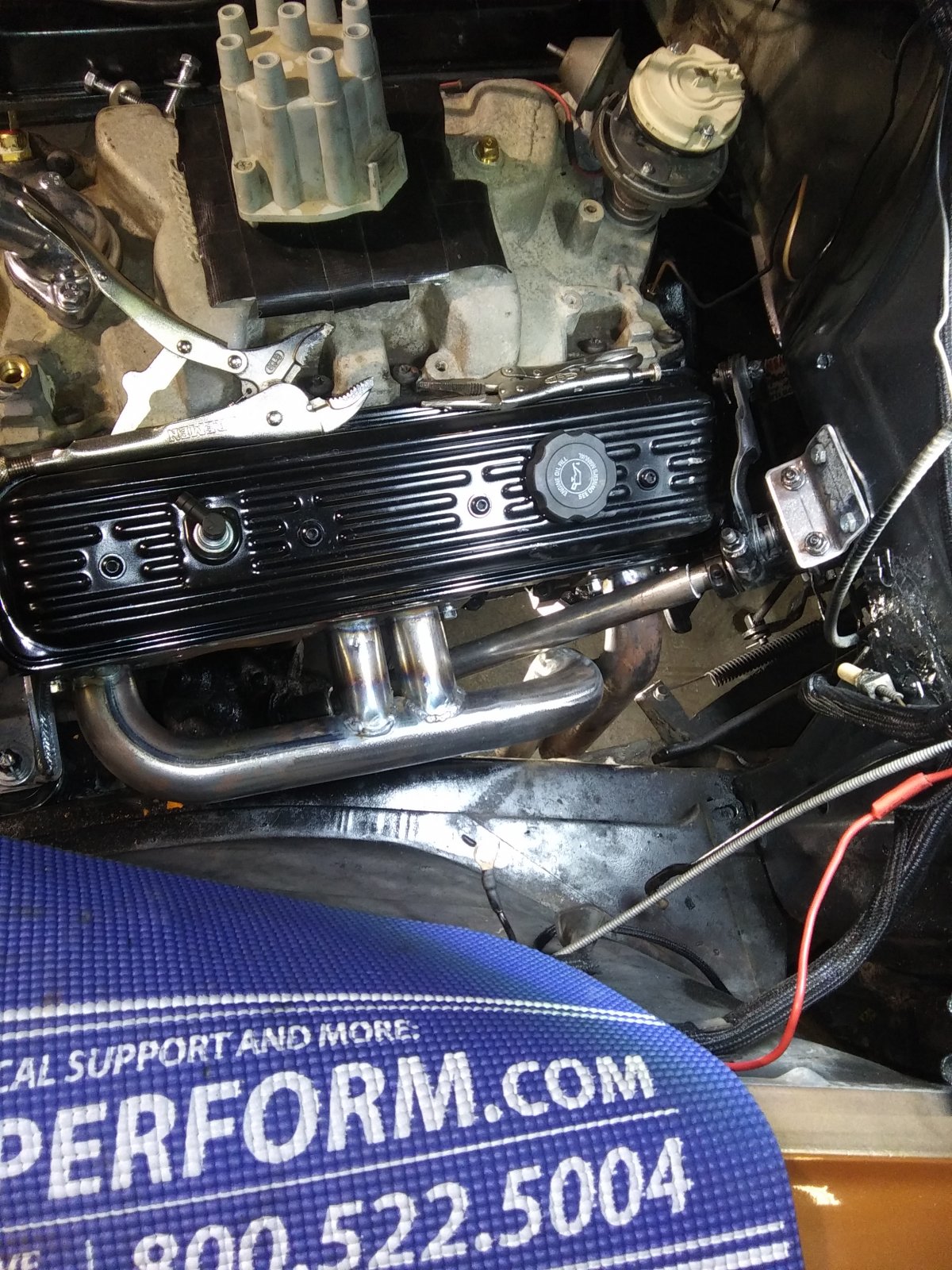

    I know this is an old thread but 20221010_152312.jpg 20221010_171240.jpg 20221010_171303.jpg here's what I did just recently. Had a customer with the 48 Chevy sedan with the 216 and I converted it to an automatic for him and open Drive. Well he blew up the six. So I just put a V8 in and since the transmission was already mounted I didn't want to move it around anywhere or lengthen or shorten the drive shaft. I used a Hurst style front mount and chopped the steering column tube off to gain some clearance. Had to make a header for the driver side and I used some accel short spark plugs for the middle 2 cylinders.

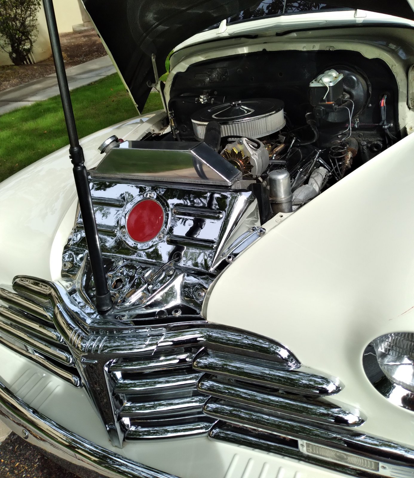

    Mine was an automatic in the '48 Stylemaster.

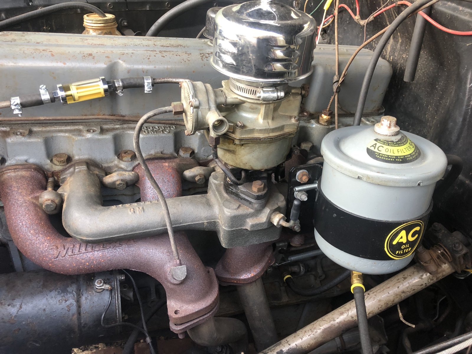

    FAFB9E58-A7E1-457F-8B03-8E804B8364CC.jpeg 78C53C85-09C4-4420-AFDD-F7986D81EA0F.jpeg When in doubt, stick with a six! 235 is an easy way to go for better reliability over the 216. And it shoehorns in readily.

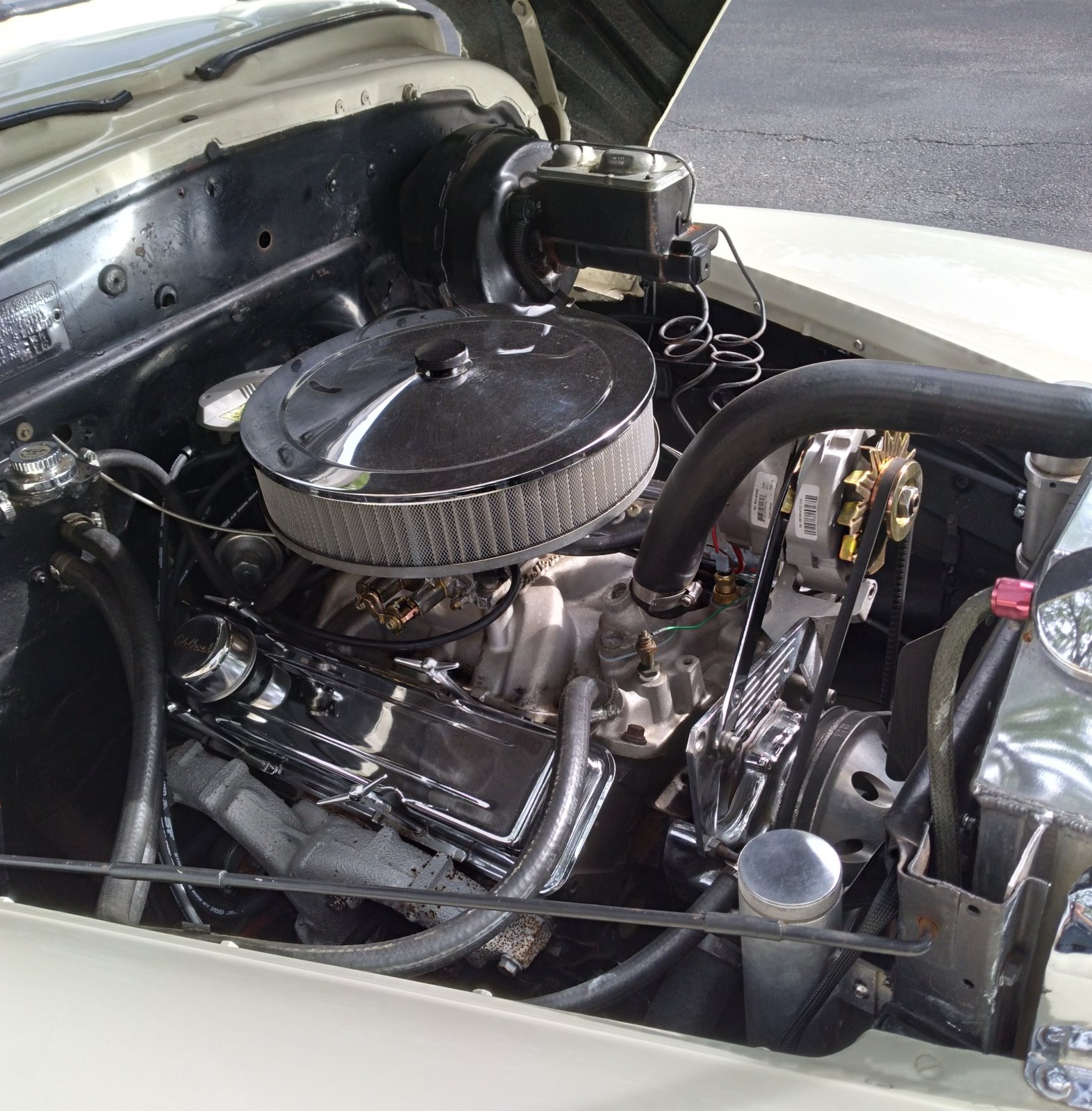

  14. Used CE engine mounts and 2" rams horns with 2" pipes snaked around the stock steering on my 47, was'nt too hard. ! IMGP2489.jpg
