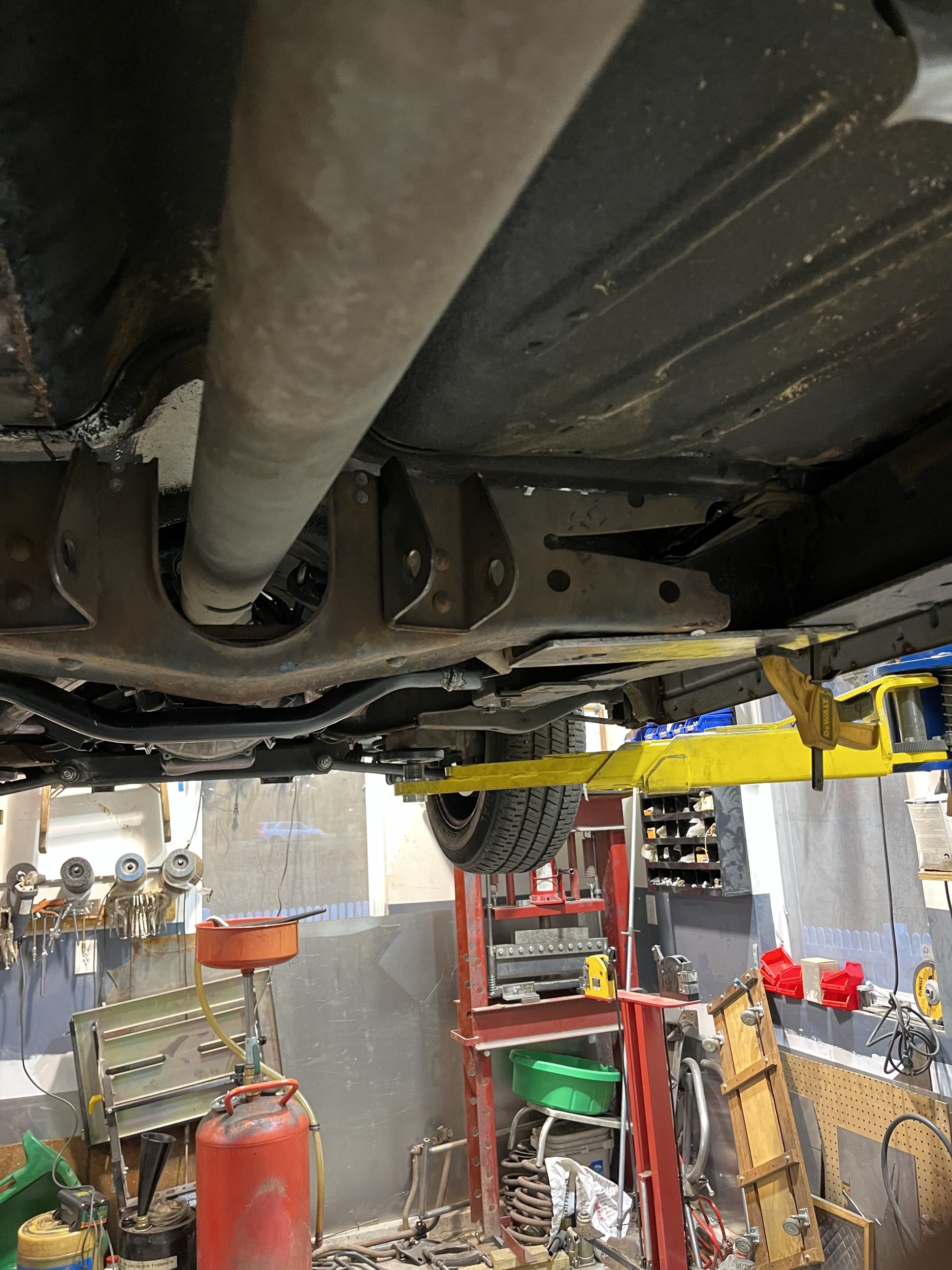

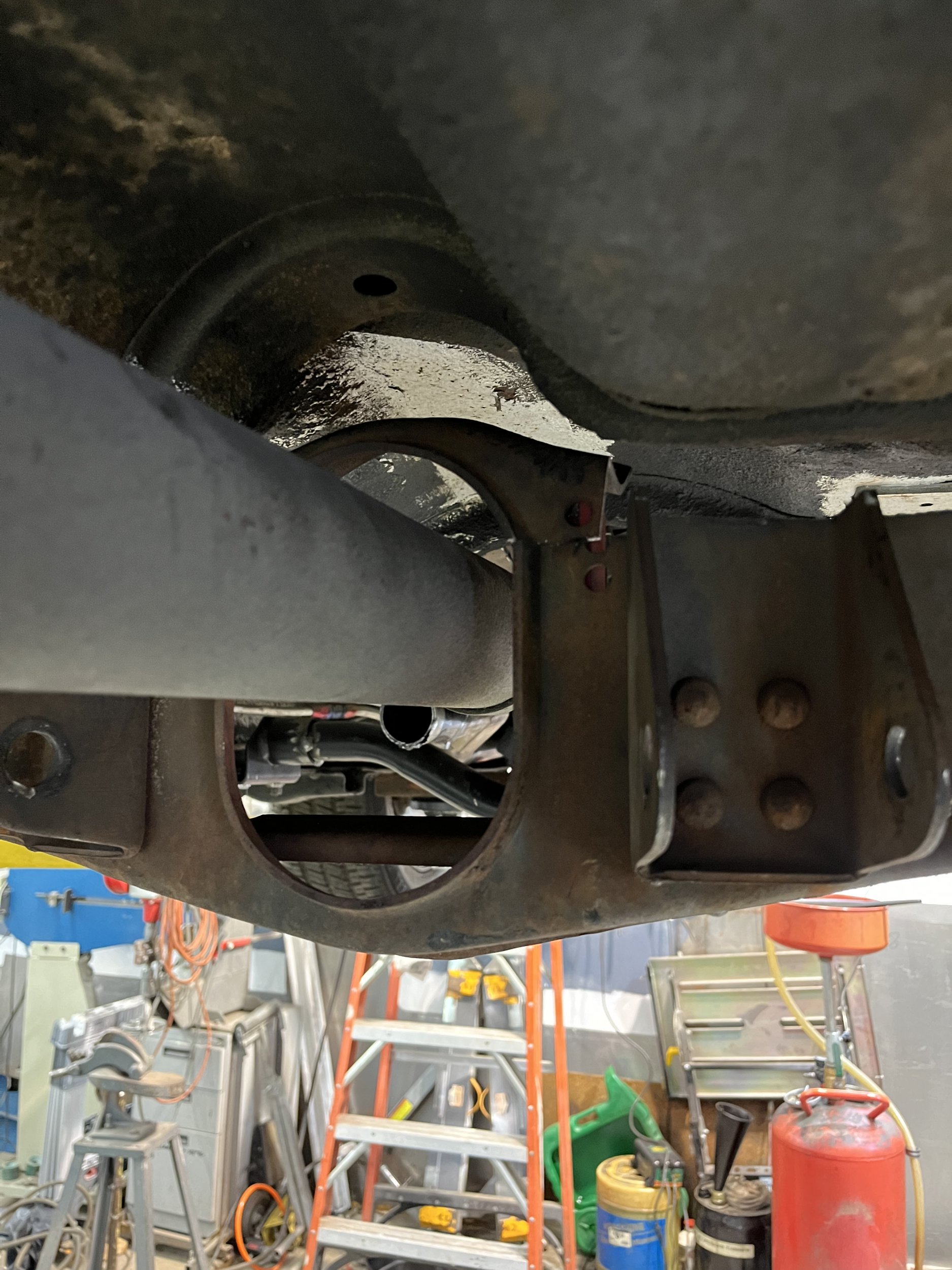

    I have the c10 cross member, arms , axle bolts (will buy new ones eventually), new saddles and everything off the back of the c10 including springs.

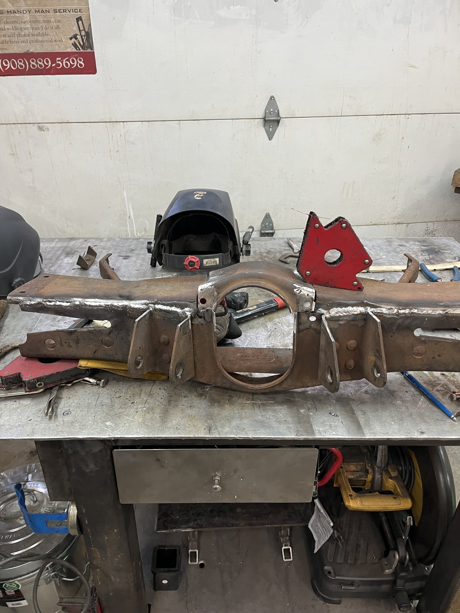

    I had to section the cross member a few inches to fit under the car and I’m pretty happy with how it will fit and the approximate location.

    I’m also going back and forth with welding the crossmember in or welding on some brackets to the frame to bolt it in.

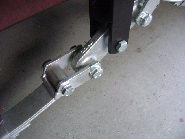

    It was a crazy noise, but I had me and a buddy jump on the bumper (under 400 lbs) and the loud bang came again.
    I was going a bit crazy for a while checking body bolts, trans, engine. I didn’t believe they could reverse but they did.

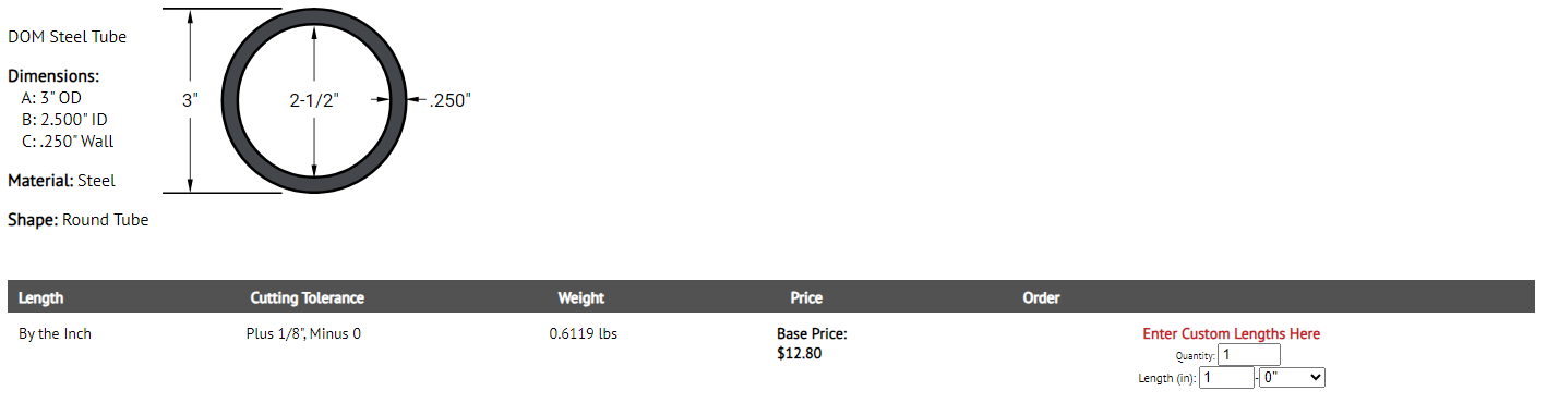

    3" round 1/4" wall tubing is exactly what I would do.
    If you diagonal cut 2 pieces of tubing at the same angle as the truck arms it would look almost factory
    split the tube pieces so it wraps 360° around the tubes and weld them. [just be careful with the heat]

    That bang you hear sounds like shackles trying to invert when the suspension is extended [this happens a lot on tandem trailers with brakes on the rear axle when the trailer is empty]
    A simple fix is limiting bars welded across the shackles.

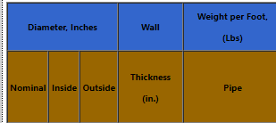

    Something to think about. If you don't have a friend in the pipe trades, 3" DOM tube with a 1/4" wall is EXPENSIVE. $12.80 per inch.
    Sch. 80 pipe comes close, but not quite what you would want.

    I actually have 16” of it I picked up on eBay for about $25. I just want to make sure this is a good option before I started.

    That bang scared the hell out of me. The car was used quite a bit and had new leaf springs put on for about 2000 miles. Then I decided to chop it and life got in the way and it sat for about 12 years … after the chop the first drive did the bang and I can definitely say it was nerve racking.
