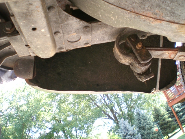

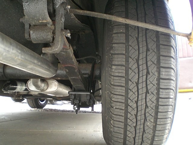

  21. Happydaze
    Joined: Aug 21, 2009
    Posts: 2,393
    Happydaze
    If the 48 is anything like the 41 the strange design of the spring mount makes 'jacking up' a simple matter of inverting the shackles! Apparently this can occur in normal use given the right cir***stances and will surely make a bang when the strain of going over center is released!
    There is a tab on the shackle to prevent this but remove it or re***emble it incorrectly and the feature is removed.
    Bit late now but the op might wish to check this.

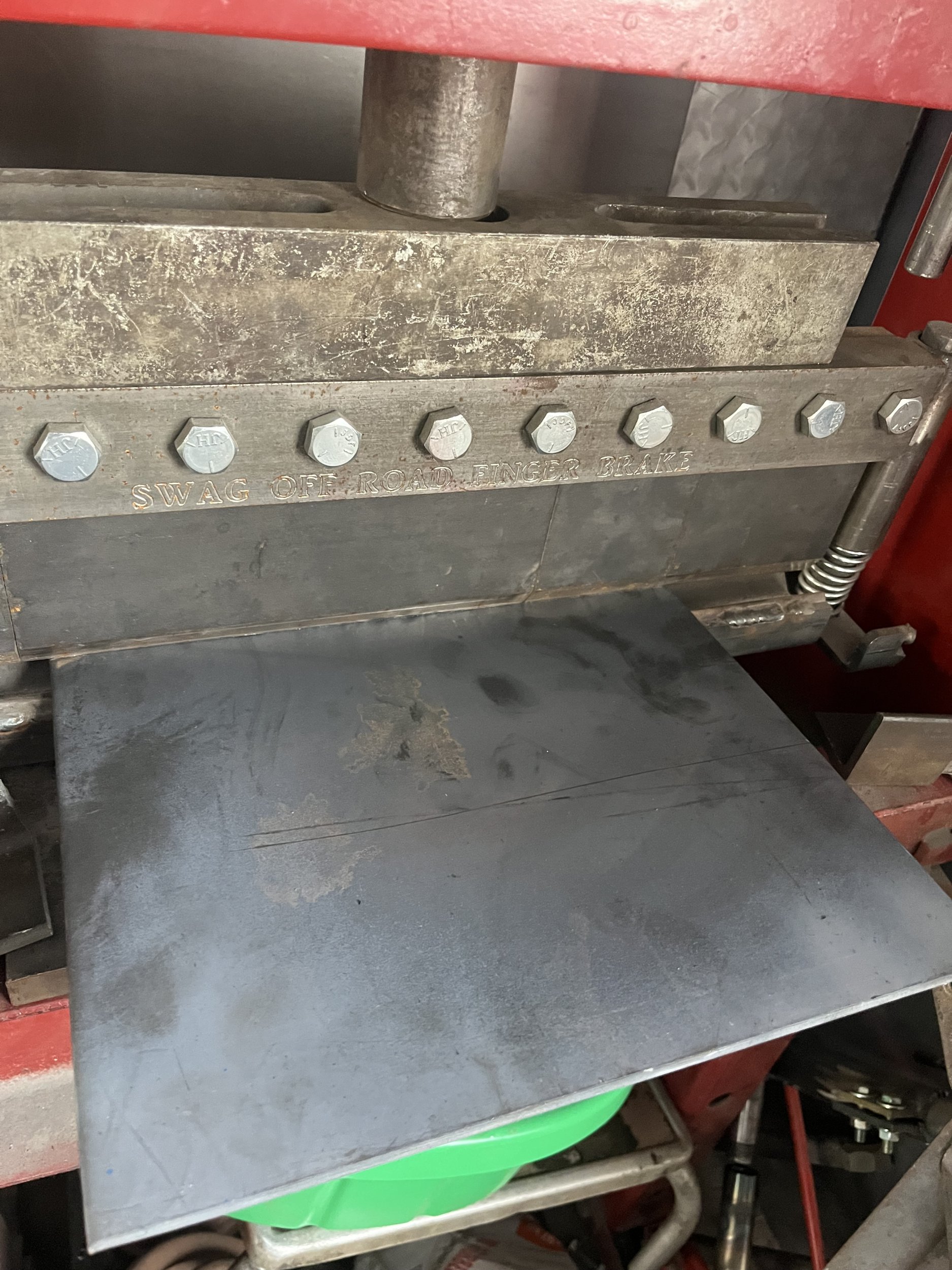

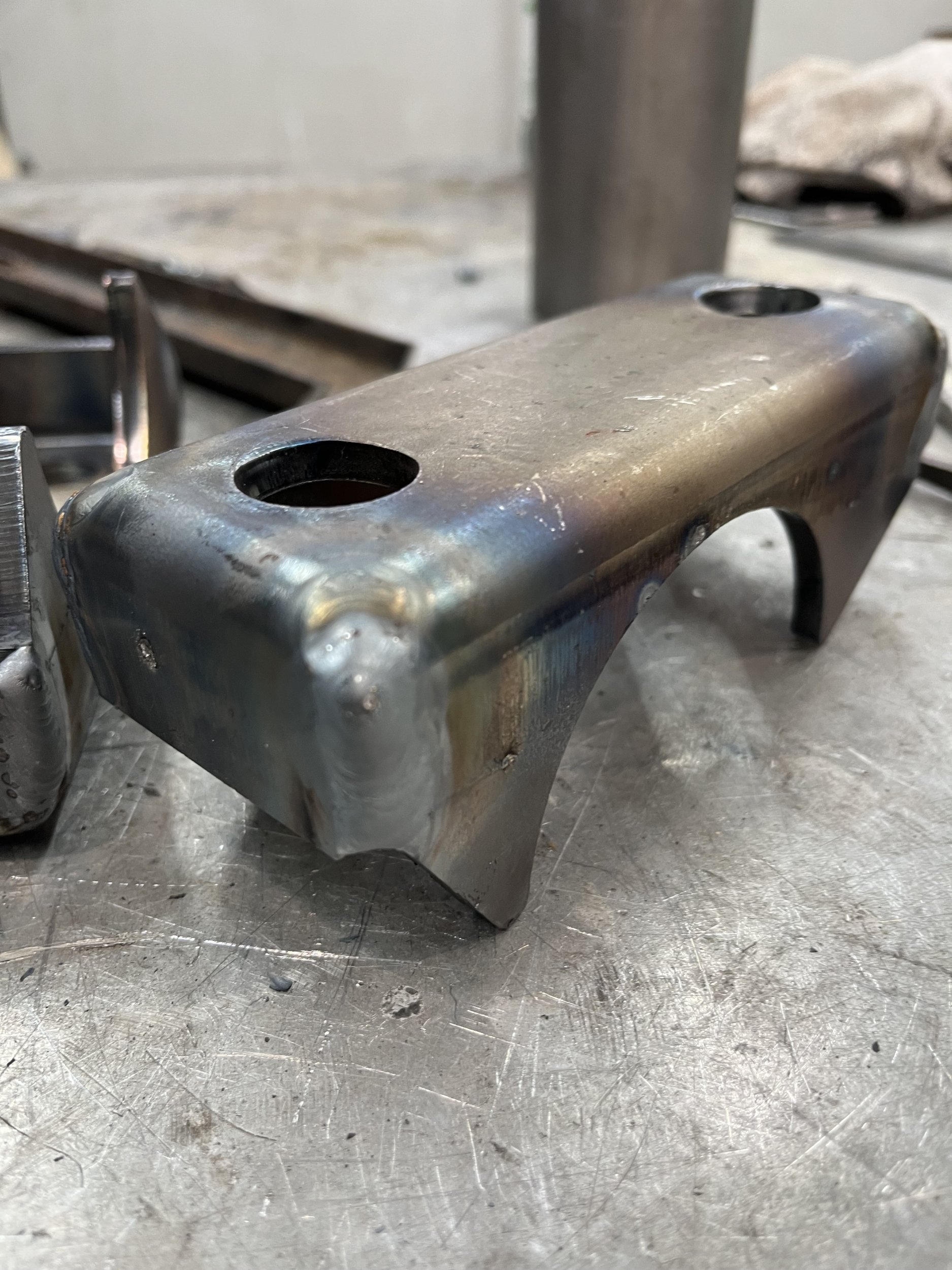

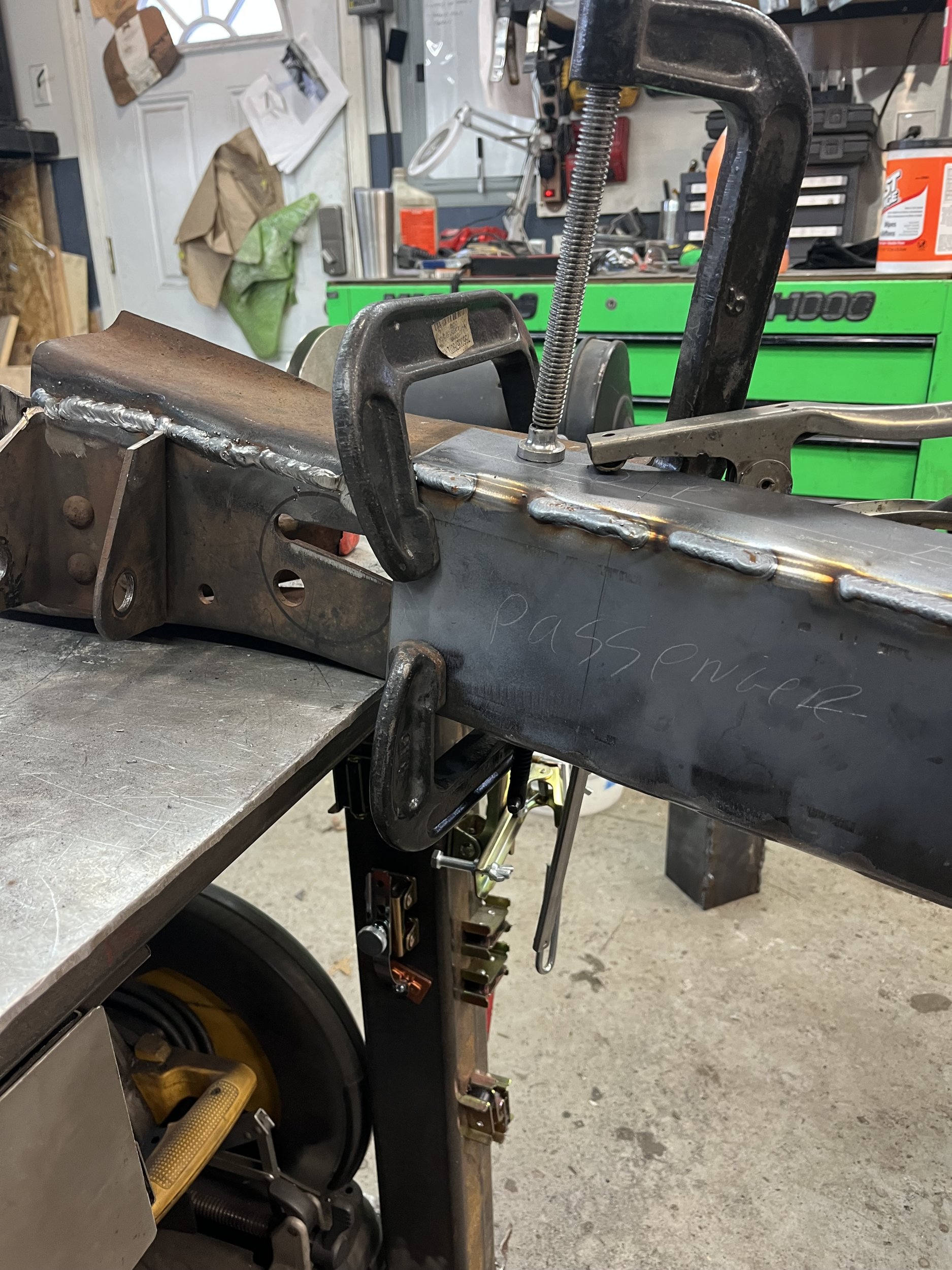

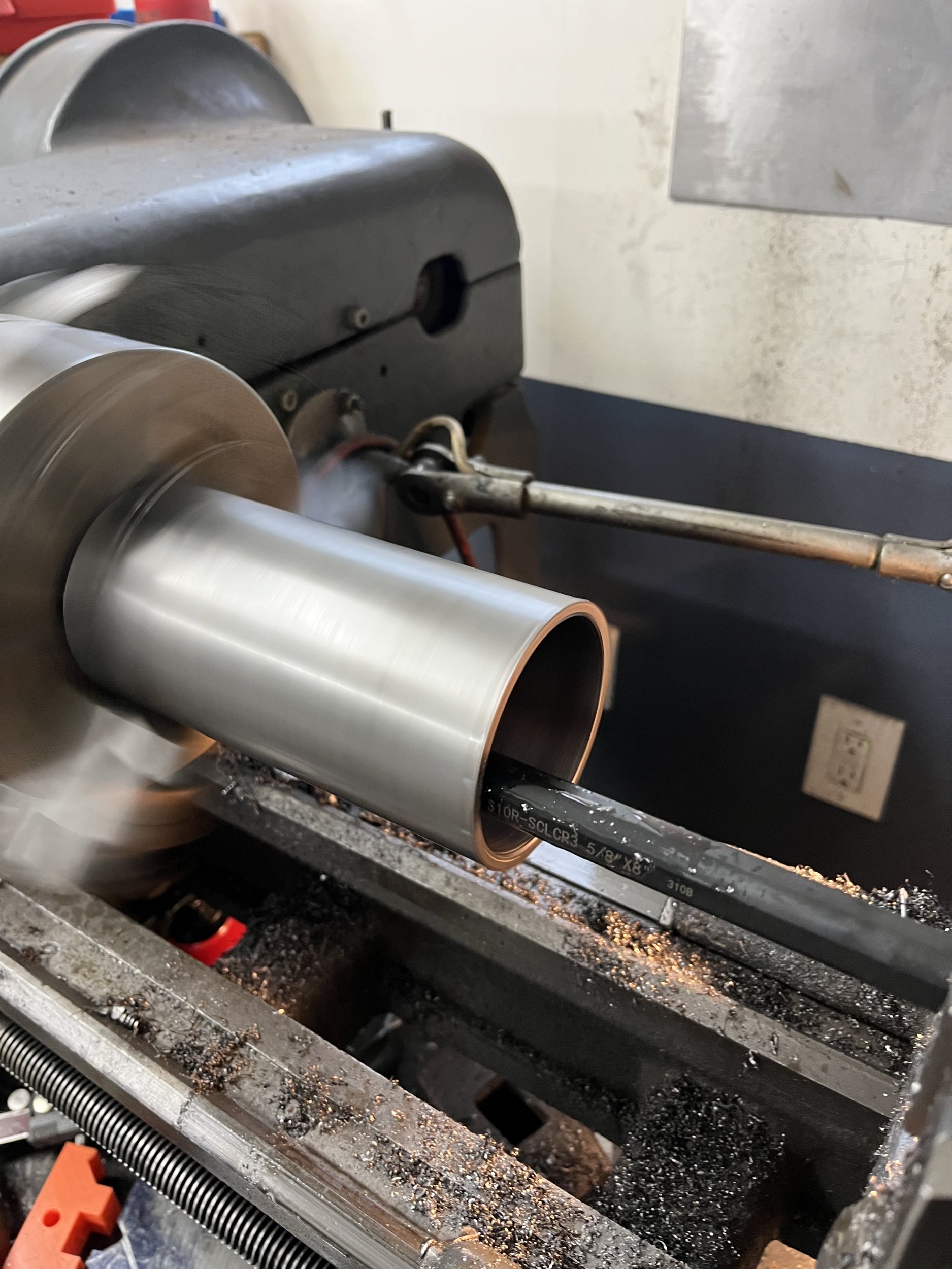

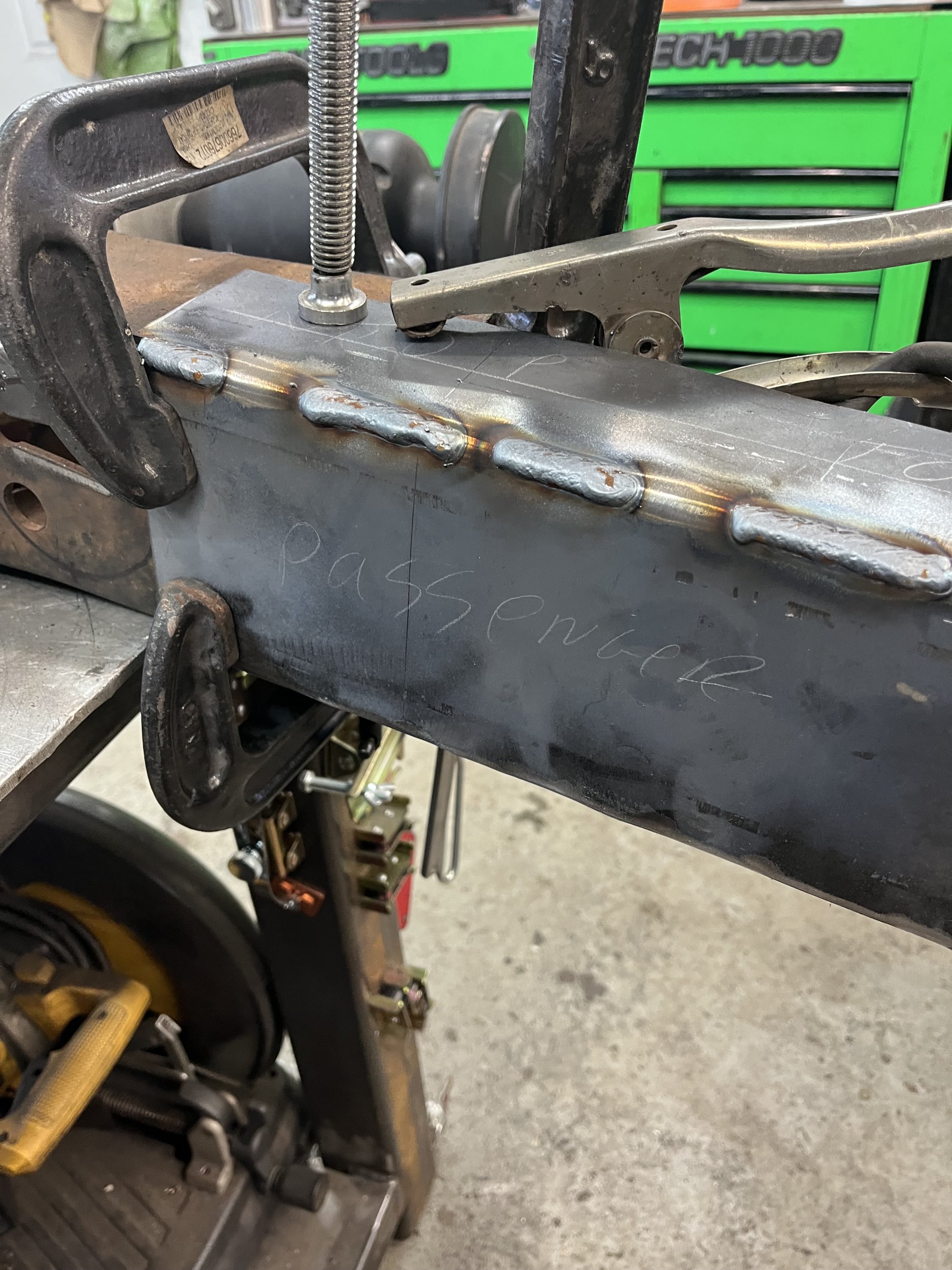

    Figured I would update on this.
    I had to take a little over a 1/16 out of the tubing and it fits great on the axle when I split them.
    I bent up some 3/16 plate to match the bends of the crossmember so I can extend it. I had to cut some slices and weld it up because I can’t bend 3/16 very easily.
    Had everything laid out on the floor and I’m happy how it’s looking. Now I have to make it fit and work. IMG_5069.jpeg IMG_5070.jpeg IMG_5073.jpeg IMG_5079.jpeg IMG_5081.jpeg IMG_5086.jpeg IMG_5085.jpeg

  28. ALLDONE
    Joined: May 16, 2023
    Posts: 3,938
    ALLDONE
    with all due respect..I use my home made welders for this kinda stuff.... so just asking as I know nothing.... but are you sure your welder is set correctly.... doesn't matter what you fab.... if it's not welded correct.... wire speed and heat settings look off...??? and again I know nothing... doesn't look like the weld are getting penetration???? again all due respect
  29. stinkity stoink
    Joined: Apr 25, 2005
    Posts: 240
    stinkity stoink
    from new jersey
    Not offended one bit and I’m sure there are plenty of people that know a lot more than me.
    I see a pretty consistent haze on the backside and see some penetration on the back in some areas. I think it’s good , but I can take the criticism.
    I did a bunch of welding tests before I started to dial in setting. I wasn’t that concerned about looks just penetration. I did cut and etch test and they showed good penetration and BFH test. I was able to fold some pieces over flat from 90 without breaking. Some broke , but it was probably beyond 45 of bending.
  30. ALLDONE
    Posts: 3,938
    ALLDONE
    I'll try to explain,... like said my home made welders, compe***ion winners at reno ...put there's a few ways to describe a welding inspection... what you lack is hase.... affected zone.... lac of fusion... you should see a heat ring Affected zone... like purple blueish about a 1/2 inch or so past the toe of the weld....should be a little bit of a dish there.... your welds are like caterpillars laying on top of the joint... and no haze,,,
