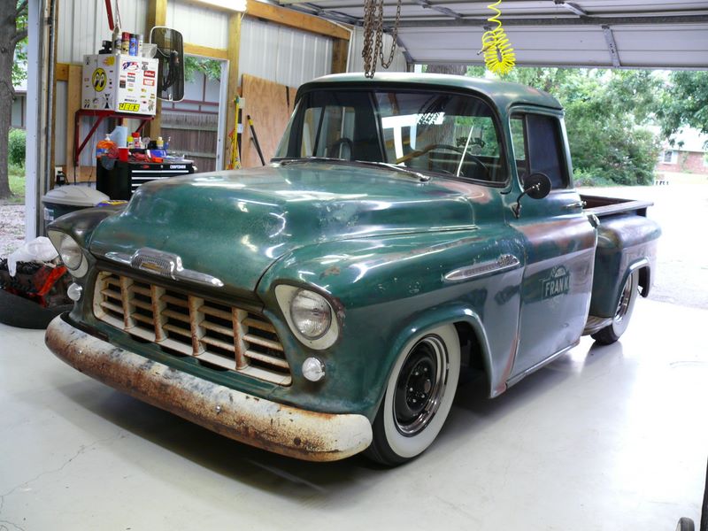

    My '56 chevy stepside is in dire need of a new wood bed kit. Wood, rails, bolts etc. What type wood do you suggest(pine, oak), and who sells the best kit?
    I'm thinking of using stainless rail strips and brush finishing them. Will prolly also go with stainless fasteners.
    I need to get this done asap for the Hamb drags. Thanks...:)

    The wood in my bed is so rotted, that the bolts ain't holding it down anymore and it moves around. This old girl has the original faded paint and I want to keep the aged look going. That's why I don't want much protection.
