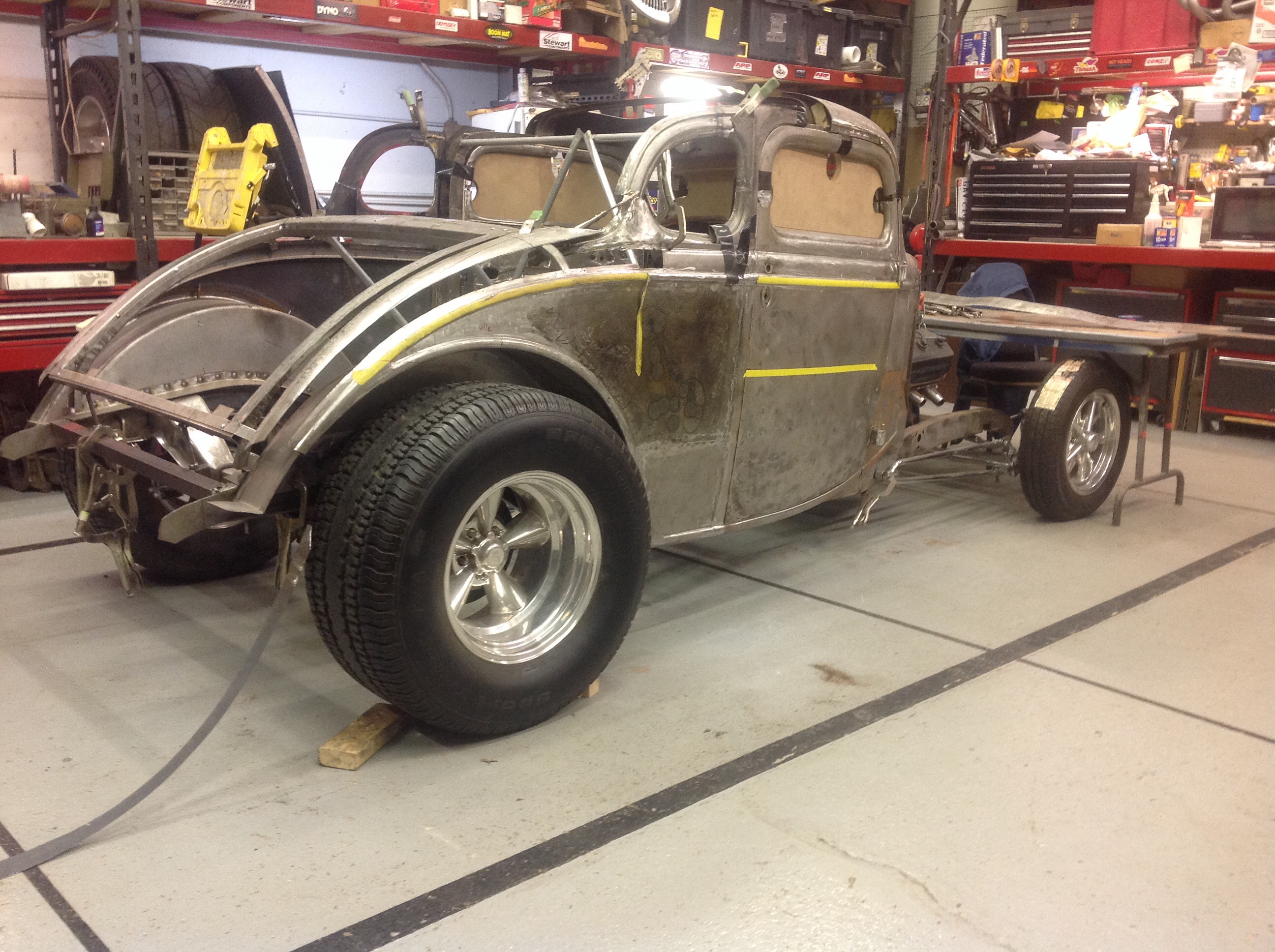

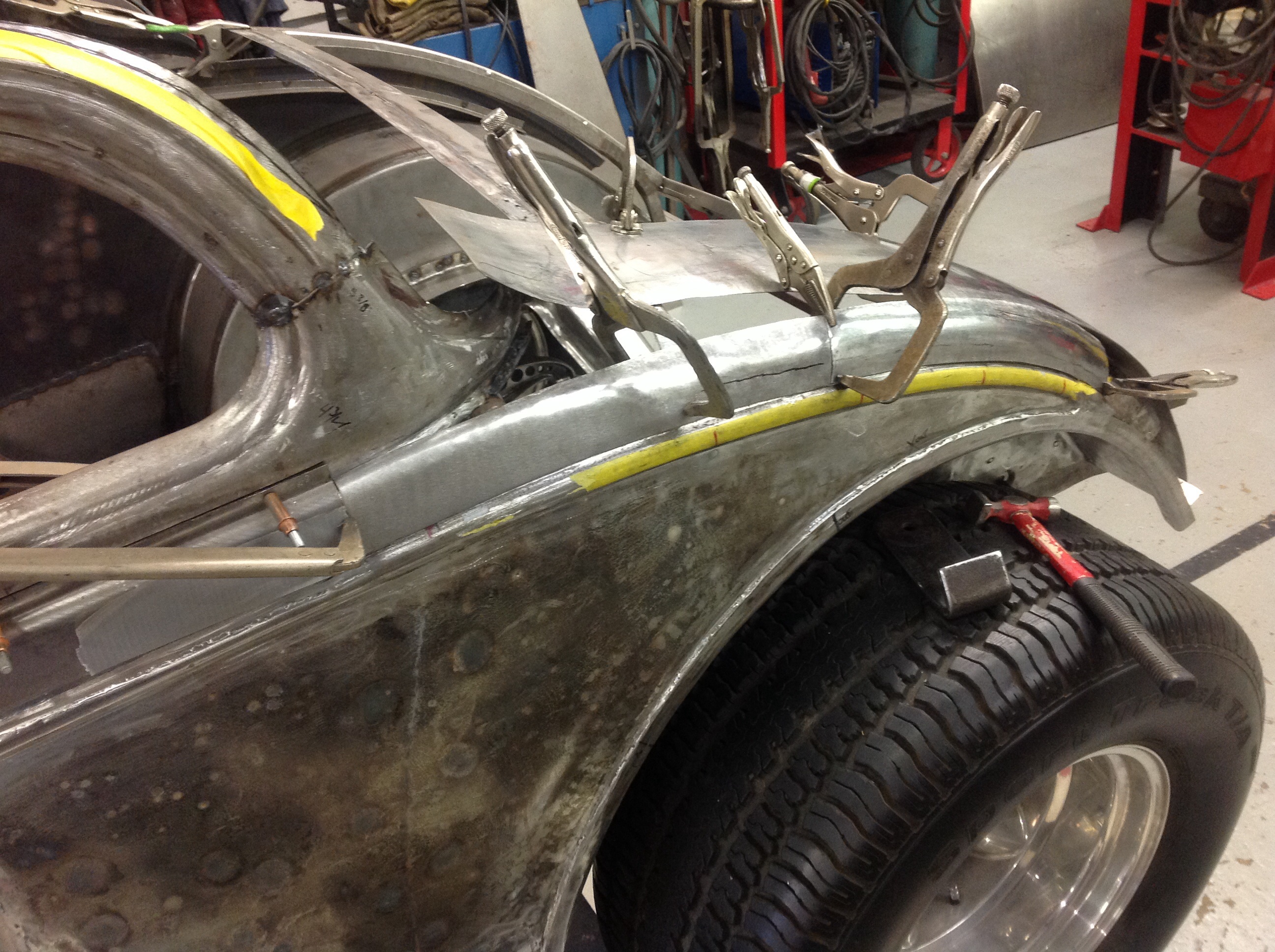

  1. For some reason I thought that I could get both sides done today.
    However that didn't happen but I did get 1 side's 1/4 window almost finished :)
    Stogy and reagen like this.

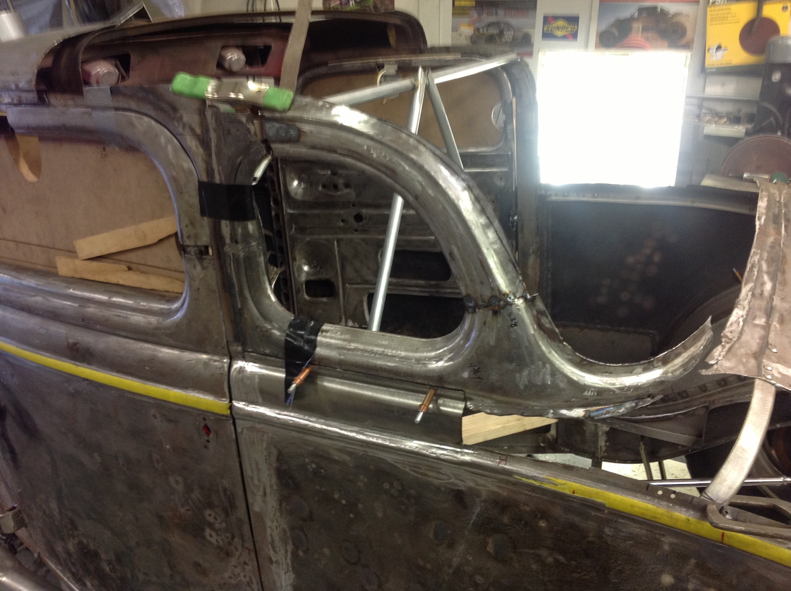

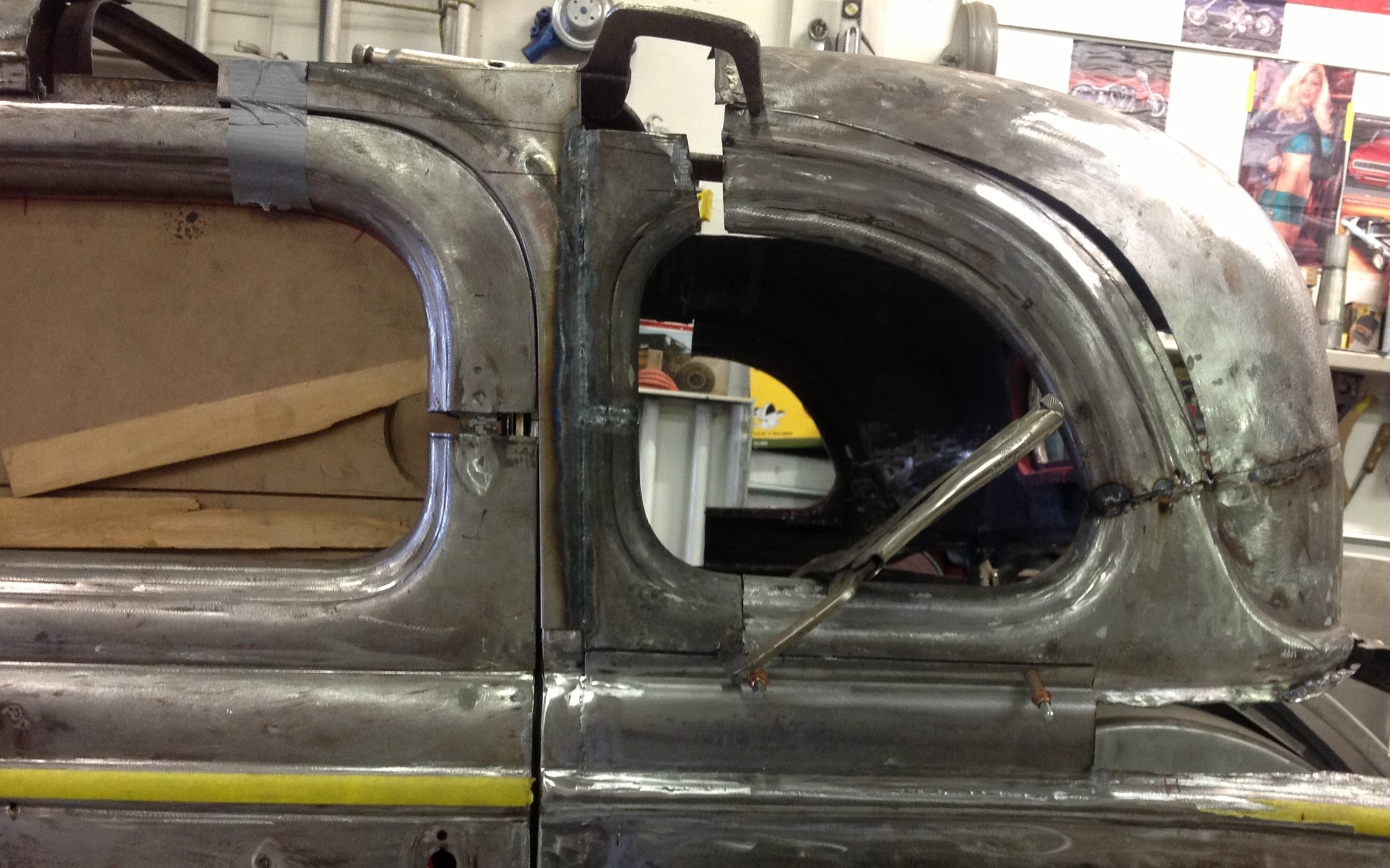

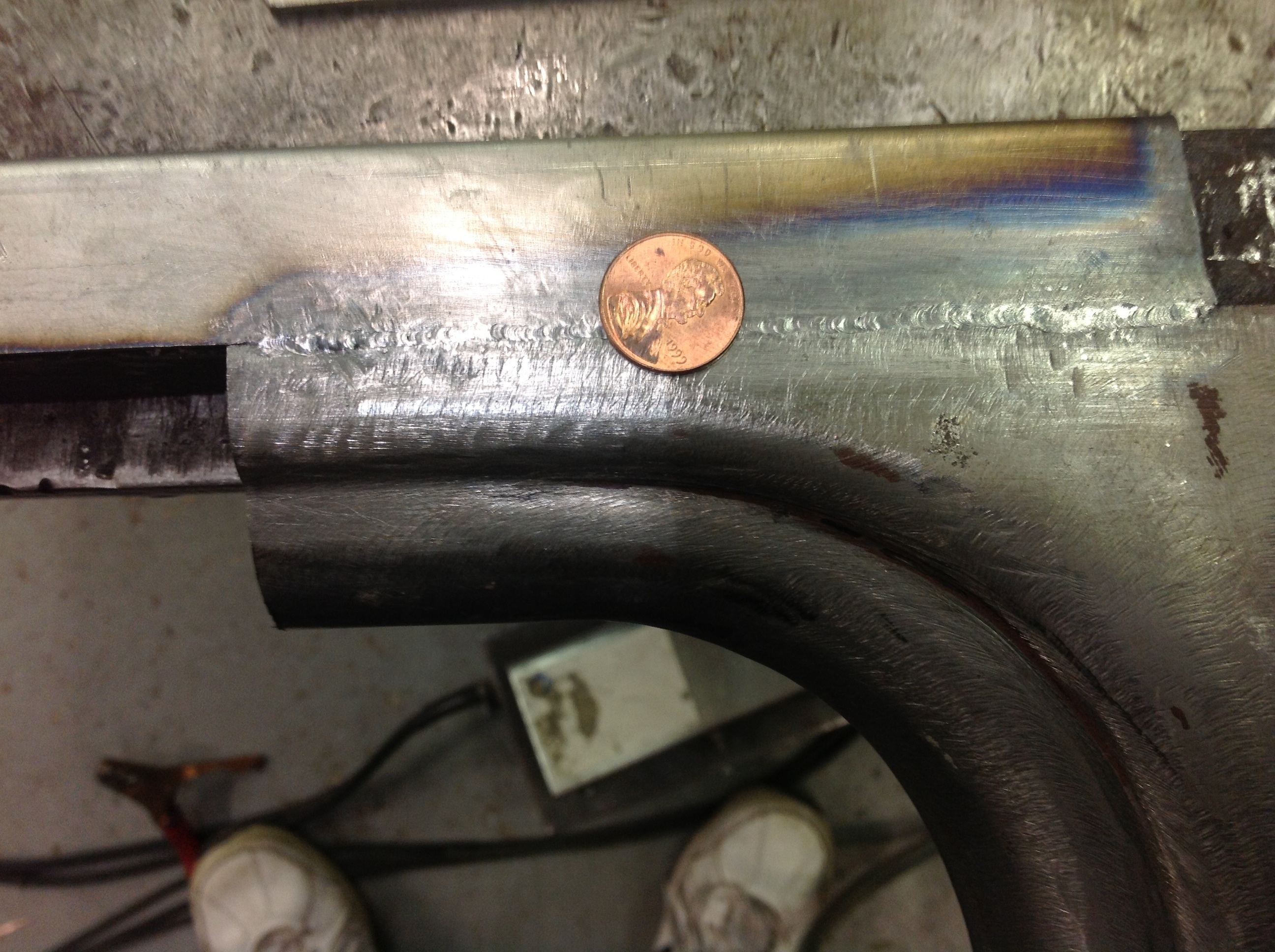

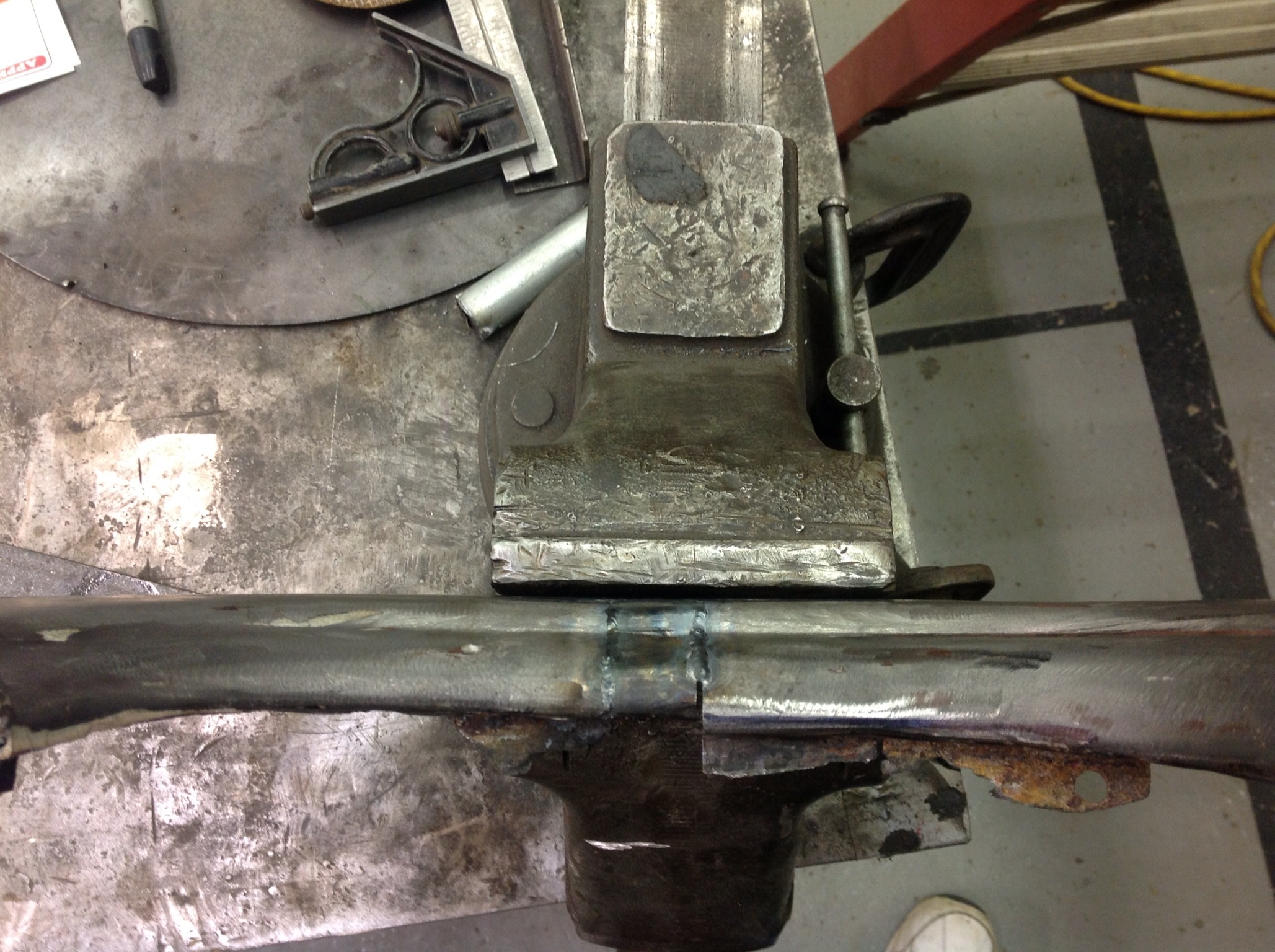

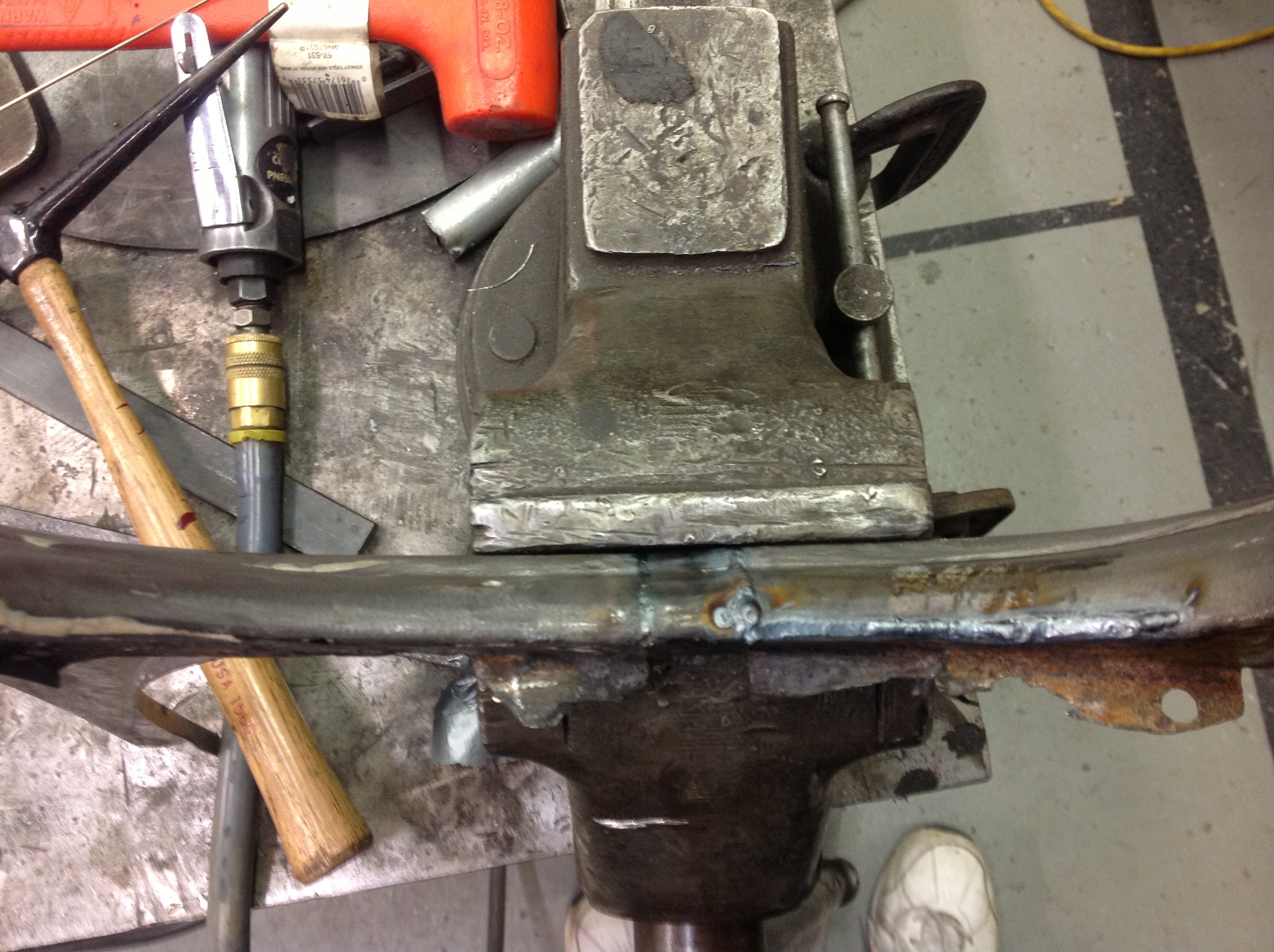

  3. image.jpg image.jpg image.jpg image.jpg image.jpg Details details details.
    It's not "brown dog" welding but I like it and I'm happy
    I really thought this was common knowledge, since I found it in this car it might not be so common. just incase its not ill go over it.
    When chopping cars and sections with taper, its nice to make sure they line up in 3 dimensions, especially when its a gl*** seating surface. Ill guess some have heard the phrase smooth as gl***, so where gl*** sits should be close to smooth as gl***.
    If the taper is chopped, the taper needs a new trajectory. A simple slice and clearance, reweld is usually all that's needed. Maybe a 15 min job total start to finish if you need to hunt down the cut off wheel and wait for your compressor to build up. However, if this pesky little detail isn't done & it gets painted & someone puts gl*** in the hole,,,, well it's a God awful mess and you'll need to tear into the paint work to fix it. Also building up the low spot to match the part not cut is not a good solution especially if nobody welded the B pillars.
    This is really close, close enough that the gl*** seal won't look like its negotiating a slalom course. If its really tapered the narrow side will need to be widened.
    Here's 5 pieces, it is the door gap, it needs to follow the body line, establish the location of the 1/4 window, establish the height and location of the rain bead considering all the cures that come into play and be just about perfect because every time the door gets opened, somebody will be starring at this. There's a couple more parts yet to go on this. The rectangle section needs added and the bead for the roof needs rolled into it.
    It goes here

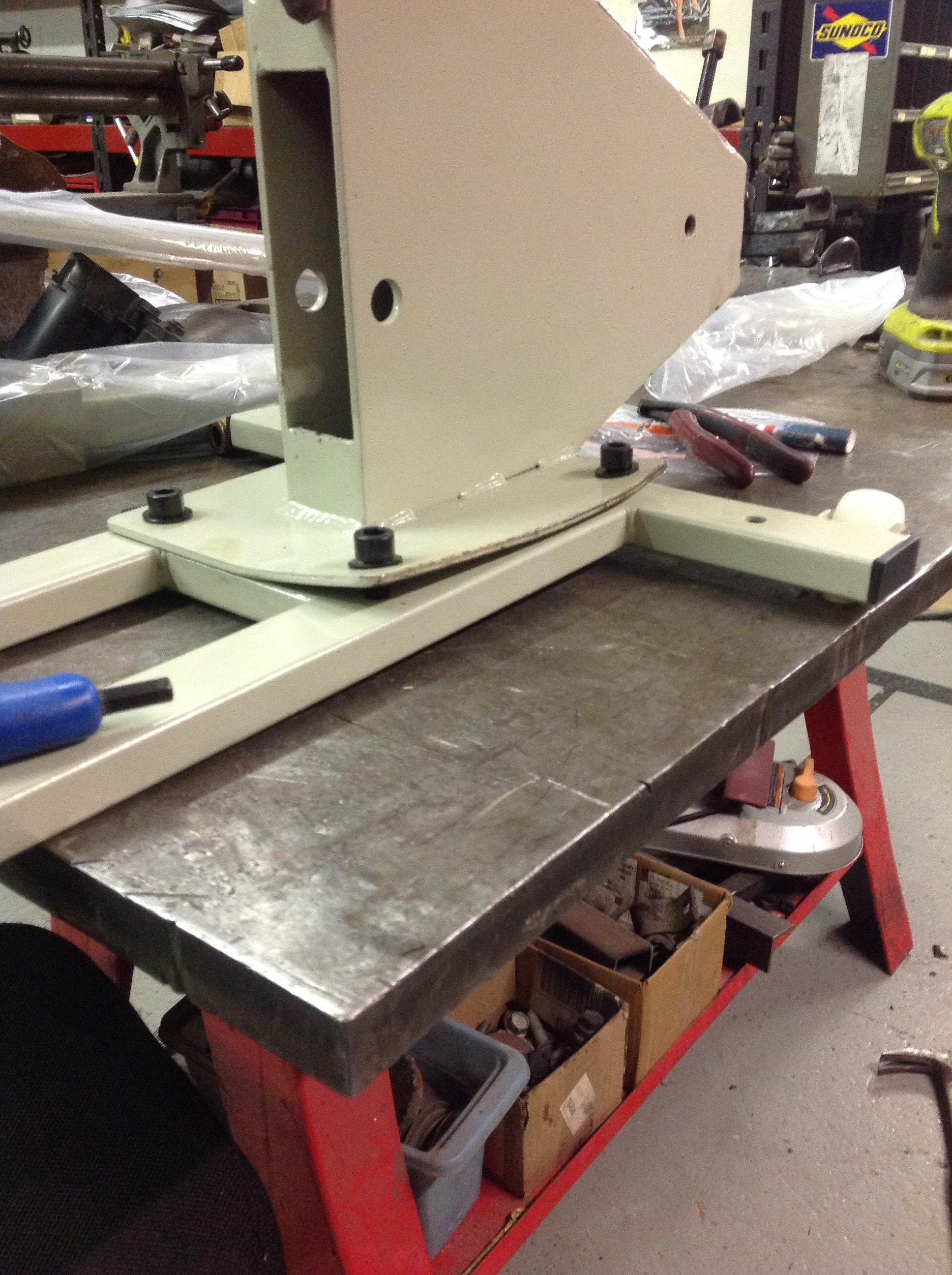

  7. Well I think I'm stuck without a deep throat shrinker.
    Anyone want to rent me theirs for a while?

  17. So y'all remember this ?
    Then i have a need for a deep shrinker, maybe you saw my thread on trying to rent one from one of you hambers.
    http://www.jalopyjournal.com/forum/threads/anyone-want-rent-me-their-deep-throat-shrinker.931769/
    This happened yesterday-
    So, I figured I'd break down and just order one from Balliegh because I can't be screwing around here on this for another month. Talked to Shane and he said they are back ordered till the end of August. Another month anyway ugghhhh . Sells them like hot cakes.
    Actually he's got 50 on the way and 45 are sold already. Really? Everyone has one I guess.
    If I had one I'd let you guys use it.
    So, I have one of those venting conversations with my girl. You know "how was your day honey?" Well I told her of my frustrations. She hops on the computer to amazon, and finds they have some in stock with free shipping with her prime membership. I was confused as to why amazon has them while Shane is telling me they are out of stock. So she calls amazon and verifies the availability does in fact exist ready to ship and that free shipping is true. Then Tells me this and says "run up to the grocery store and get 1100 in amazon gift cards, you'll get 132.00 in free gas with the fuel perks".
    I get back gift cards in hand and 5 mins later the order is placed and it will arrive on Thursday. No alliance discount but free shipping and 132.00 in free gas was way better !
    She really is the best!!!
    Should get really rolling again on Friday! :)

  20. Ok ok lol.
    Needs a repair brand new fresh outa the box. Easy enough fix but really?
    VANDENPLAS likes this.
  21. tb33anda3rd
    Joined: Oct 8, 2010
    Posts: 17,583
    tb33anda3rd
    go easy banging that down, you don't want to bend the work bench,
  22. kma4444
    Joined: Sep 24, 2008
    Posts: 197
    kma4444
    That's just.........................Absolutely fooking BRILLIANT!!!!!!!!!!!!!!!!!!!!!!!!!
  23. P
    lol, yeah bench looks thicker than just an inch in that pic. Maybe that's because you'd expect that bent base plate to be thicker than 10 ga and the tube to be thicker than 3/4 ?

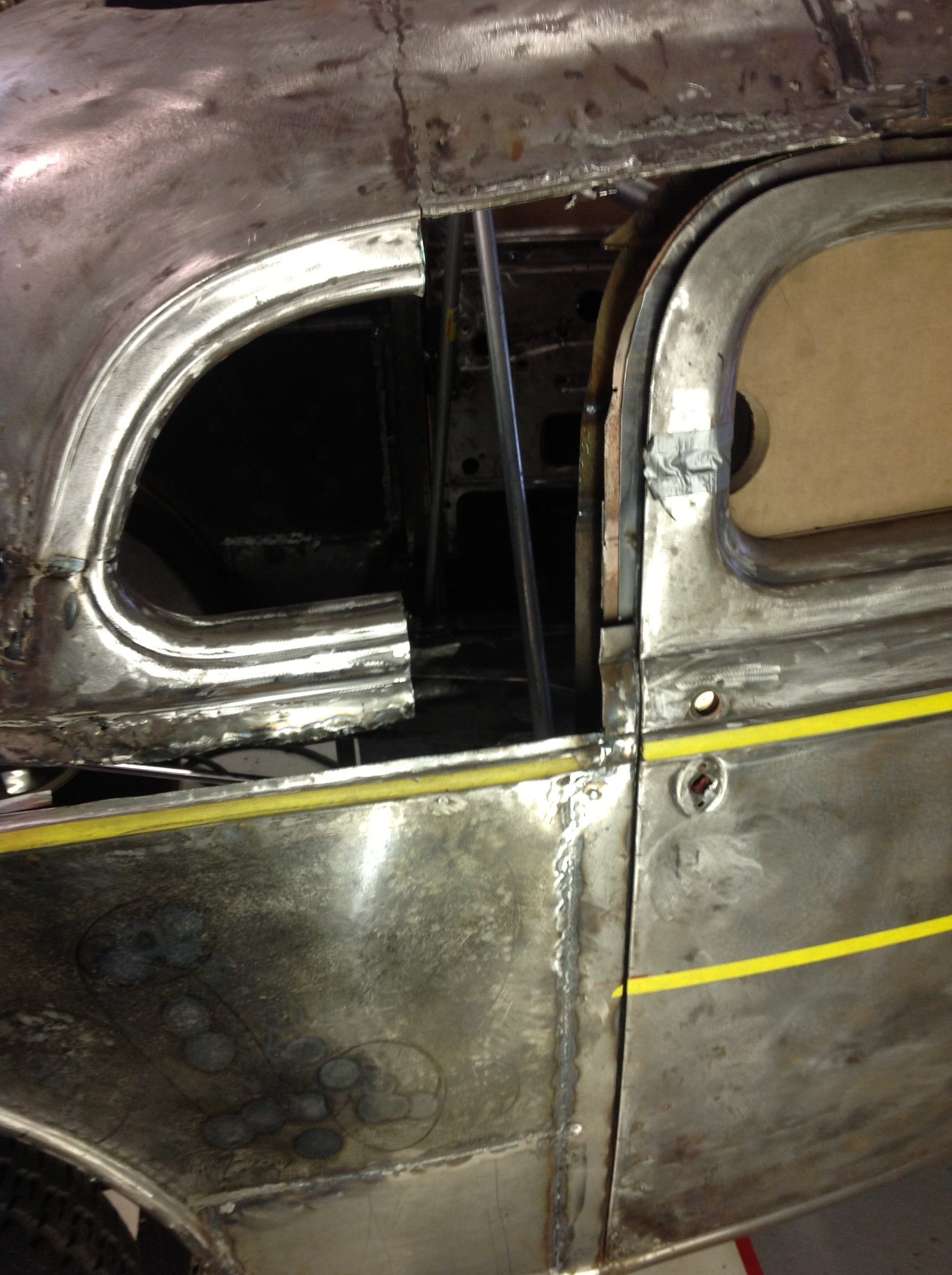

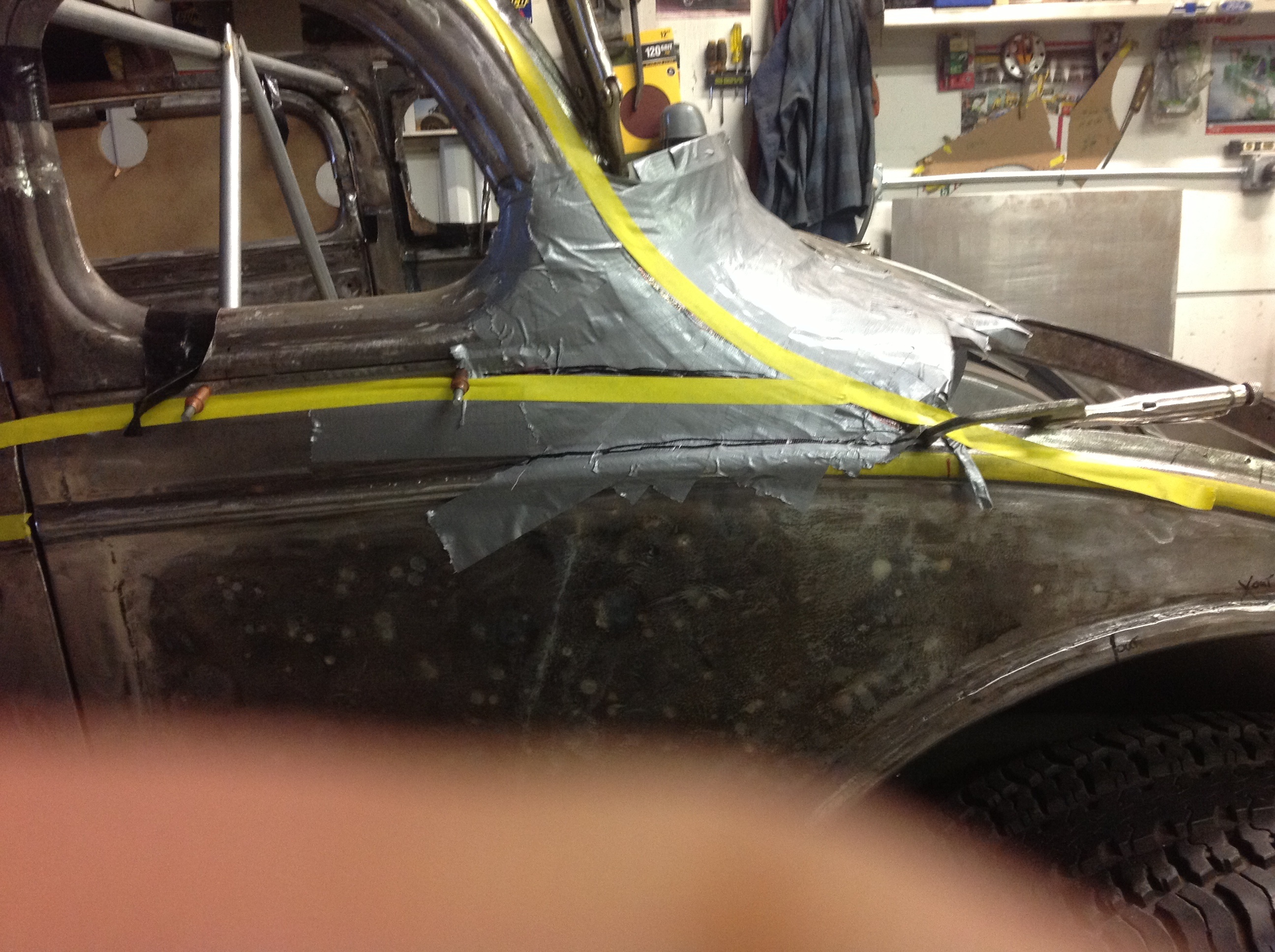

    Moving along with the top of the quarter

    Smooth. Other than the initial curve, is that all done with the shrinker? No banging or wheeling?
  28. Thanks :$
  29. Thanks
    Lots of banging my head on that table but not too much on the panel. Lol
    Started with a flat square blank.
    Layed out the "frame" of the panel on the blank which is a tapered curve.
    Loaded the top wheel with a rubber band cut from an inner tube and rolled the radius that goes from the bead to the deck lid. The rubber band on the top wheel acts like a break so the blank stayed flat but bent.
    Then with the deep shrinker, shrinking the edge, and stretching above. Check and repeat. The first few rounds of this is ok and goes pretty easy. As the compound curve develops the jaws make oval shaped flat spots every time & Those need wheeled out.
    It's a mind **** for me because the steel don't do what I think it will, exact opposite sometimes. Really the steel does what it's supposed to, I just don't know what I'm supposed to do to get the result I want. This is a strech of my skills and I'm learning lots.

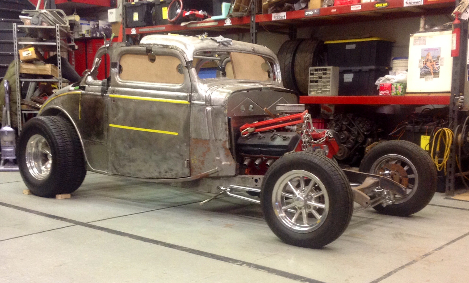

  30. So I had to break down and move this out of the quicky project spot over to the long term project spot. Not real happy about the status change but it provided a good photo op. There more room to really get after it here but ,,,,, it's "long term" now.

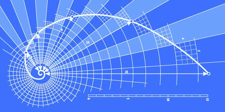

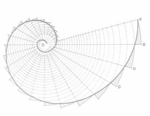

    I've been studying the golden ratio and the Fibonacci sequence. Pretty interesting stuff and the secret to great proportions.
    Here's a couple radii based off of them.
    Pretty familiar looking curves I think. Take them out a bit further and you'll see some more familiar curves. Like a lot of the lines of the 33/34 cars.
    The blue one is based off the sequence numbers as radians with their points in the golden ratio. The other is based off of the Area of rectangles in the golden ratio nesting together with a curve drawn around them.
