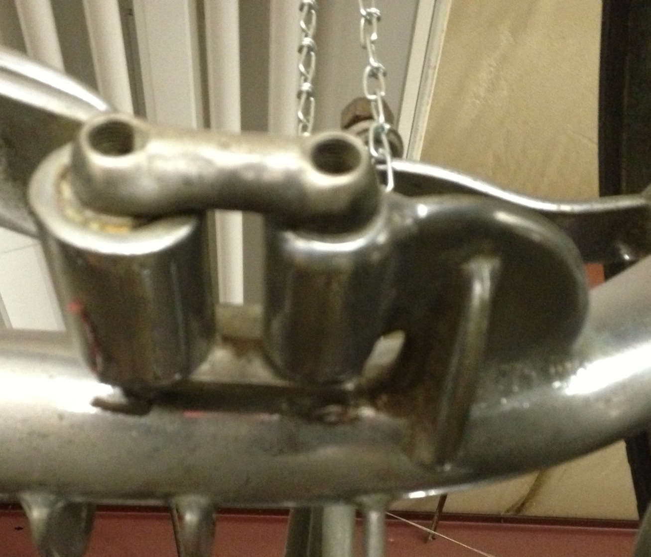

  6. I'm going to copy this style spring mount.
    It's on a really cool, really narrow old axle I have here.
    It's just fun to look at!!!

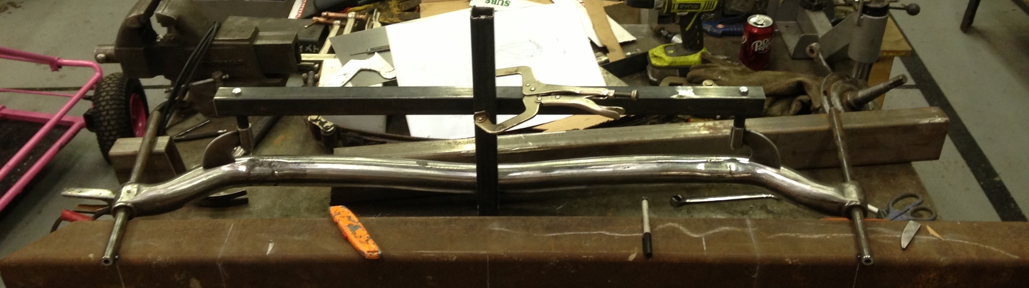

  7. If you ever thought building things square and flat was difficult ...
    Trying to get spring perches square and true on this curvy thing will let you know just how easy square and flat is.

  13. Any guesses what this is going to be ?

    No, but I'm guessing that it won't remain square? At least two brackets have yet to be cut out from it?
    Something to weld to your front axle maybe.....shock mounts or some such?

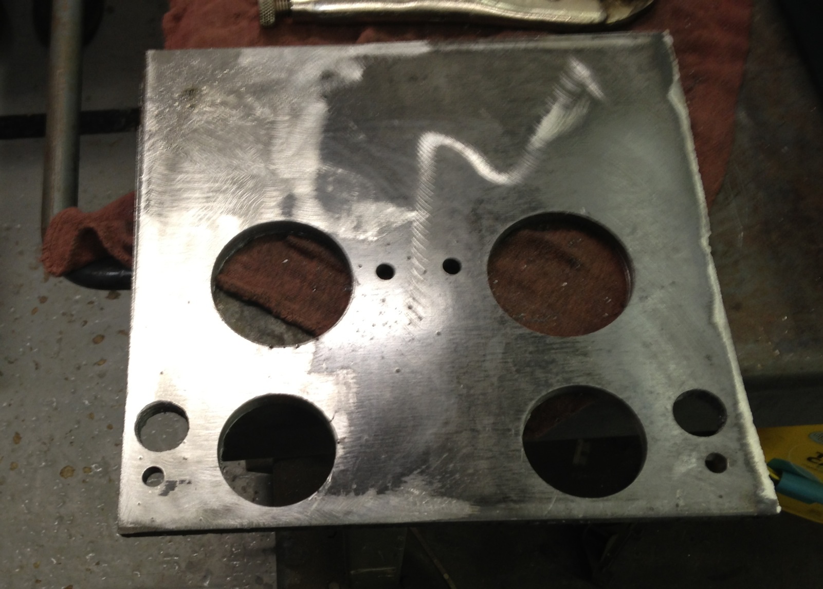

  16. Batwings for hairpins
    The 2.75 hole saw was so damn loud. Plugs, muffs & my ears are still ringing.
    7/8 and 2.25 holes were so easy and quiet.

    metal man
    That was my second guess. You did use cutting oil, right?:rolleyes:
    31Vicky with a hemi likes this.
  18. Oh yes , lots of it & drill press on slowest rpm belt arrangement.
    I think the tooth speed at 1.38 radius was just too fast.
