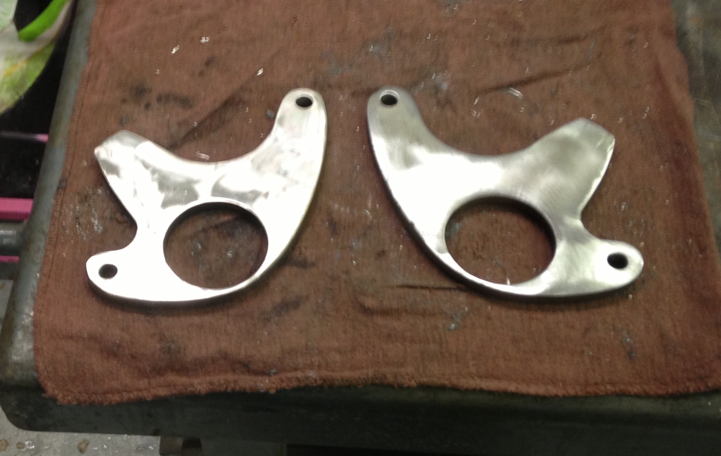

  2. Batwings all roughed out.
    Torch cut by hand between the holes

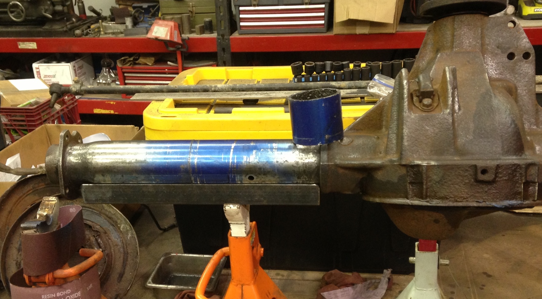

  6. Me too! This one is a lot of fun for some reason :D

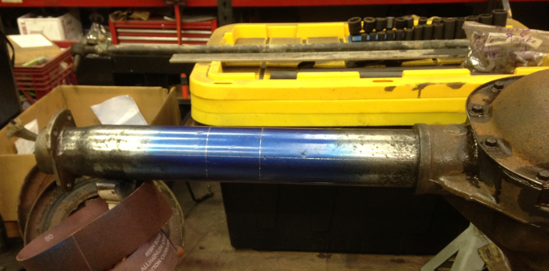

    Welding finished - it's no "brown dog welding" picture.
    But the weld is about 0.010 proud of the tube and staying like that, no grinding.
    3 p***es with a cap, total of 4. Root p*** was no filler sweating in the inner sleeve.

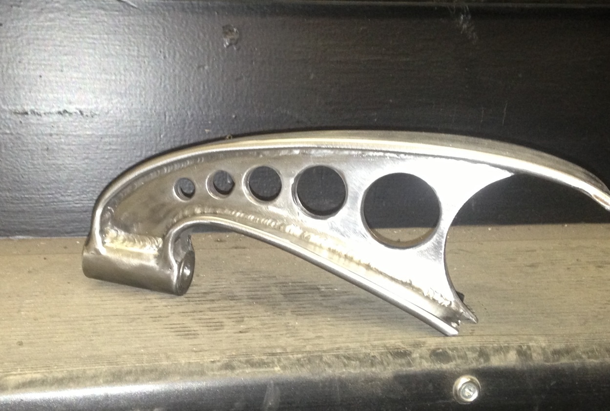

    Maybe ill post the entire narrowing process for tech week along with the gear/carrier change too. It's really simple and I didn't use any fancy tools besides a tig welder.

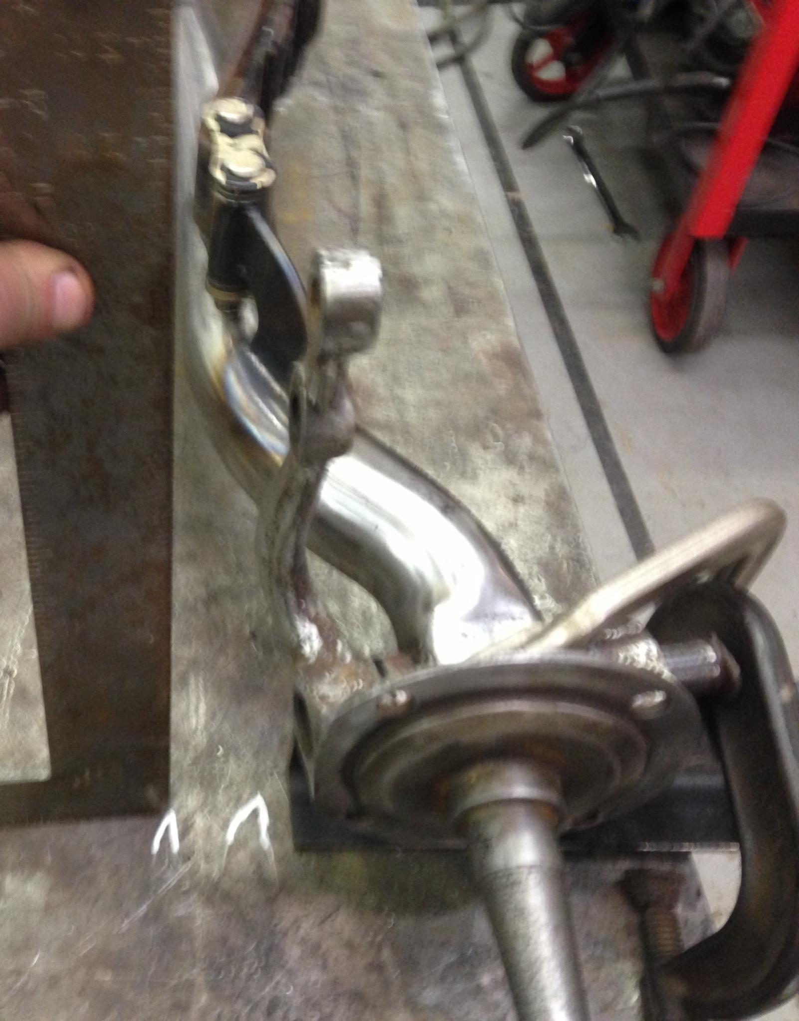

  7. Bending the ford steering arms
    Got this one before my phone went dead.
  8. tb33anda3rd
    Joined: Oct 8, 2010
    Posts: 17,583
    tb33anda3rd
    did you use a tubing cutter?
  9. No, that tube had about a 1/4" wall thickness.
    Used a pipe wrap and scribe, center punched the line about the cir***ference, made a short sawzall blade and cut it

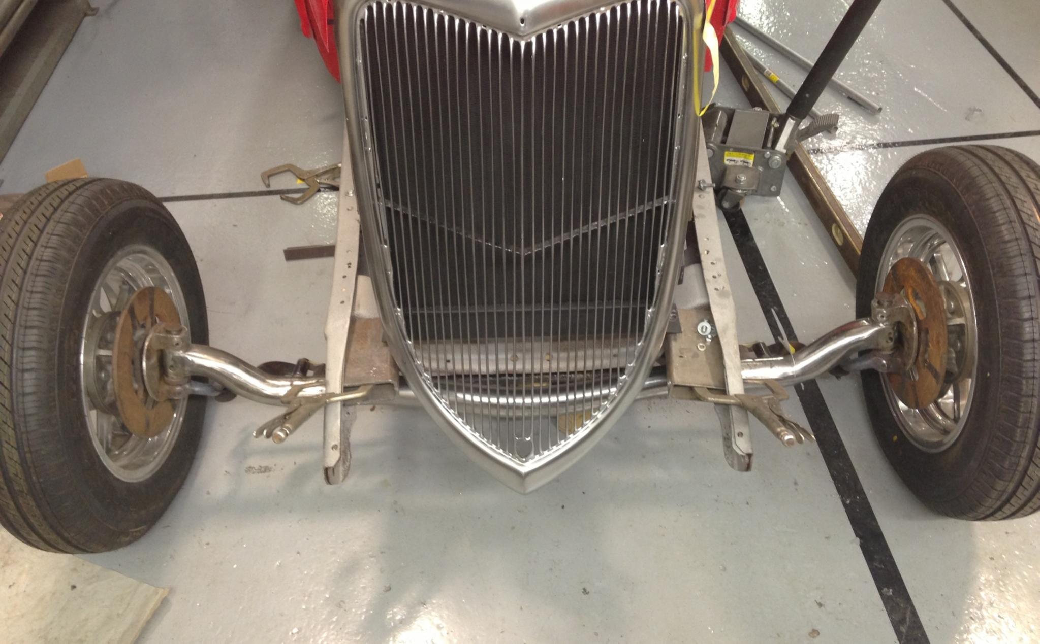

  10. Dodge tube axle mocked up.
    It's 3" wider total, 1.5 each side, than the chrome SB but for some reason it looks like its a foot wider on each side. Damn!
    Comparing this pic to pic in post 26.
    I have an idea I'm going to play with some today while I have silence and babysitting the washer and dryer. Lol

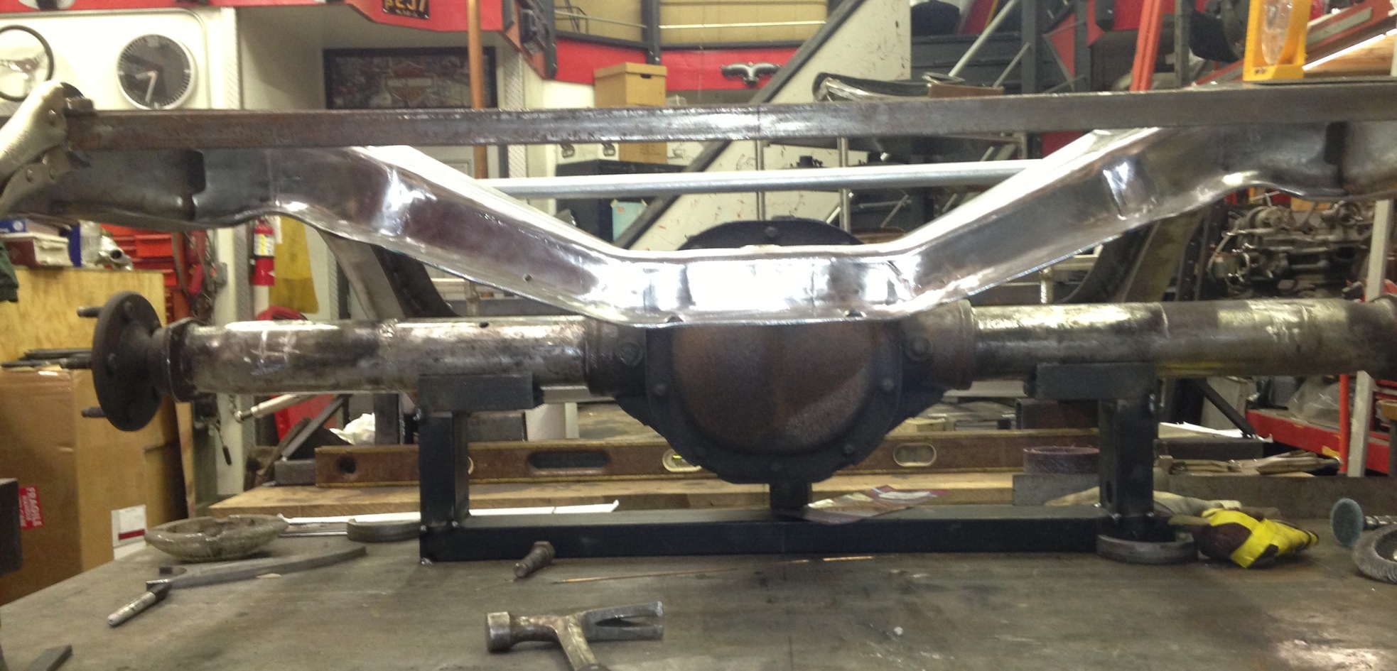

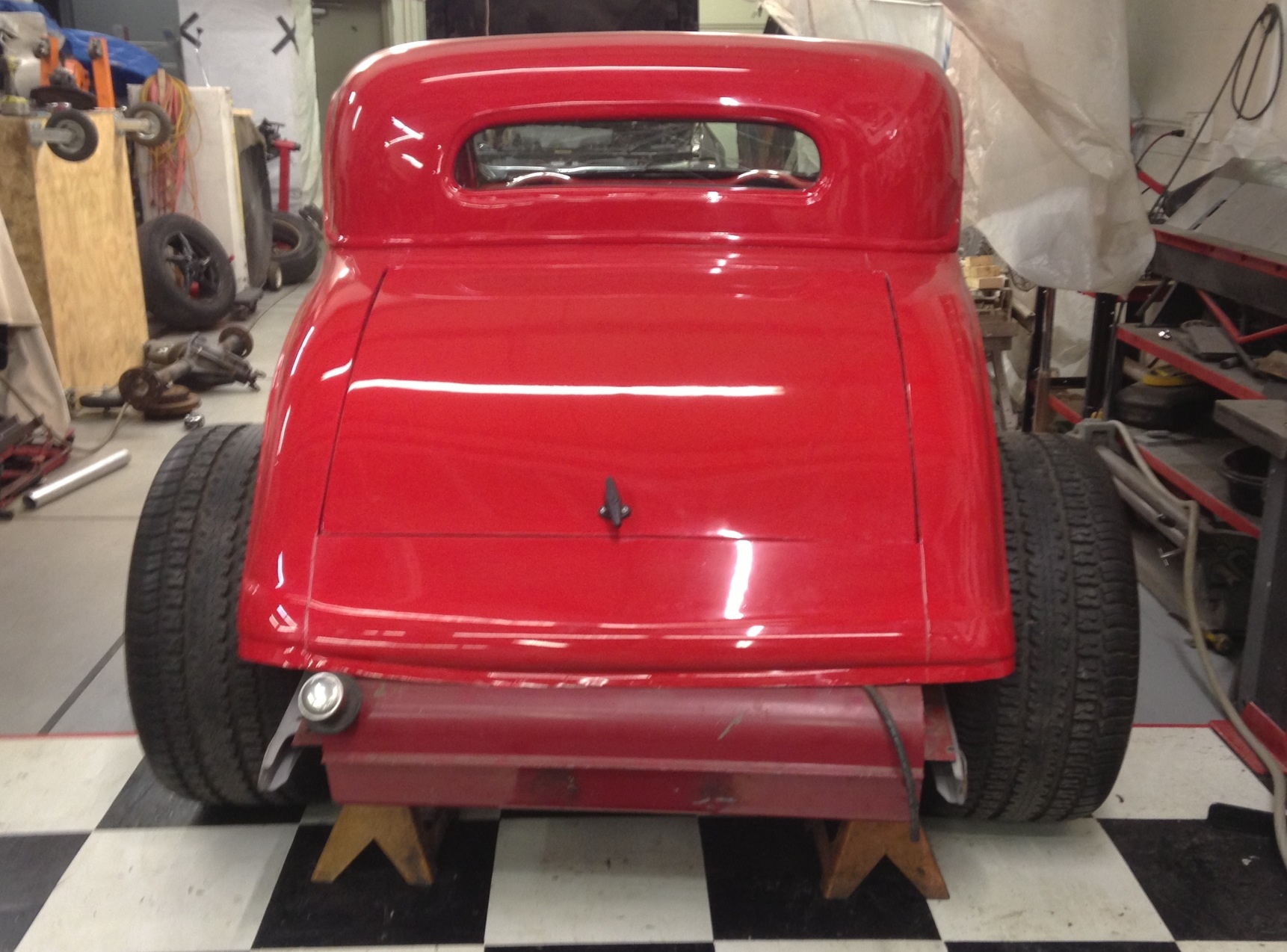

  11. Slipped the rear end in for a test fit.
    Damn near perfect fit if you ask me
    Edit: if you are seeing this for the first time, you'll like what happens with that crooked *** tail Pan in a few months. This gets a lot better as it goes on. I get to the tail pan around post 319

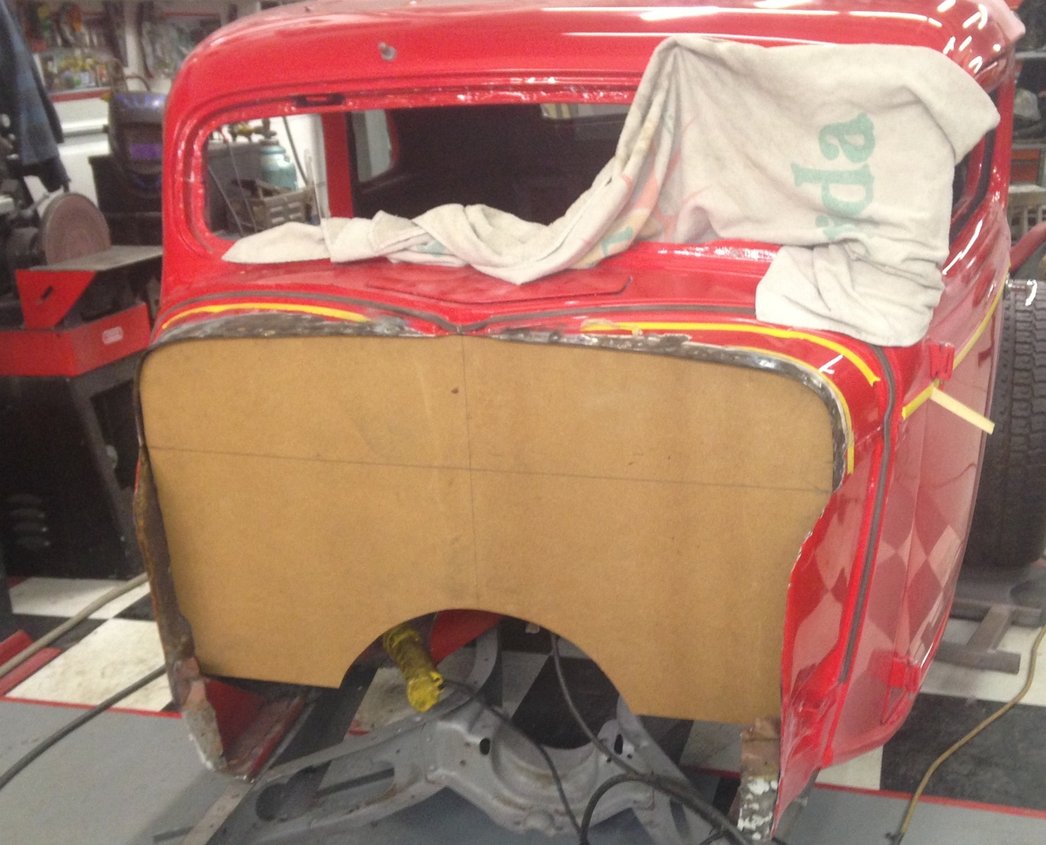

  17. Here's the Masonite template.
    This is going to be a flat firewall backing mostly for structural.

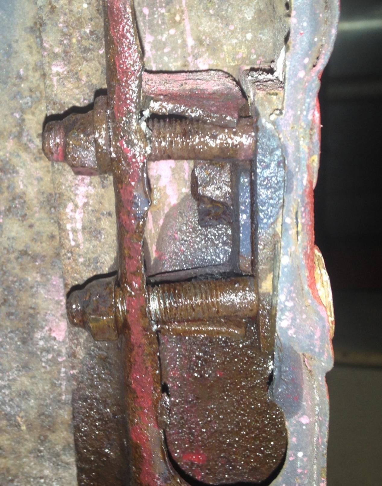

    Perfect days for mind numbing tedious tasks that take forever with nothing to show for it. For example these hinge bolts. Might as well fix the loose hinge while the firewall is out. I've been trying to do this without burning the paint off of the cowl but I'm not getting any where. Been thru a hand full of nuts doing the "weld nut to broken bolt trick". Now I have the bolt broken too deep to risk that any more. So it's time to drill it out. Been farting around with it for 3 days off and on.

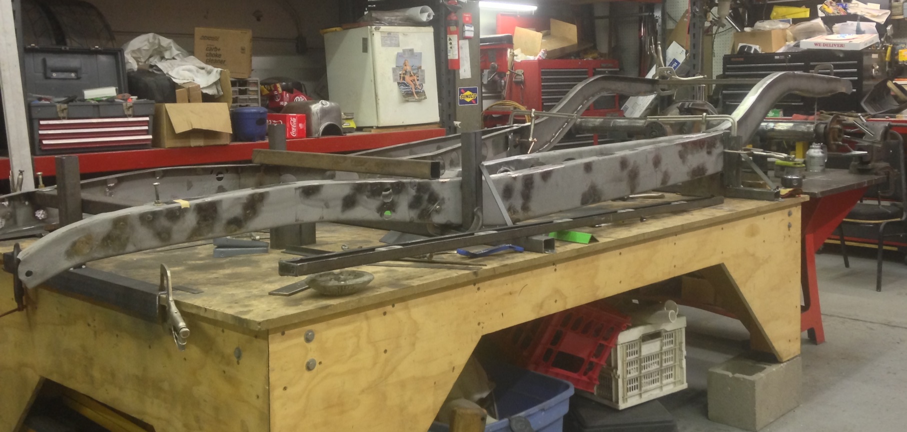

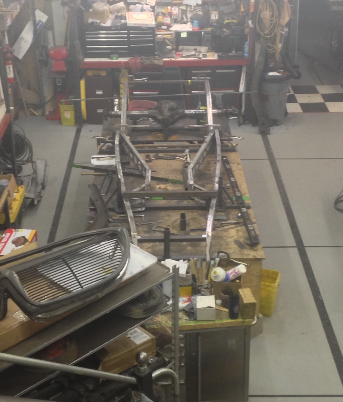

  20. Saved and then Modified a 33 frame
    oliver westlund, VANDENPLAS and Stogy like this.

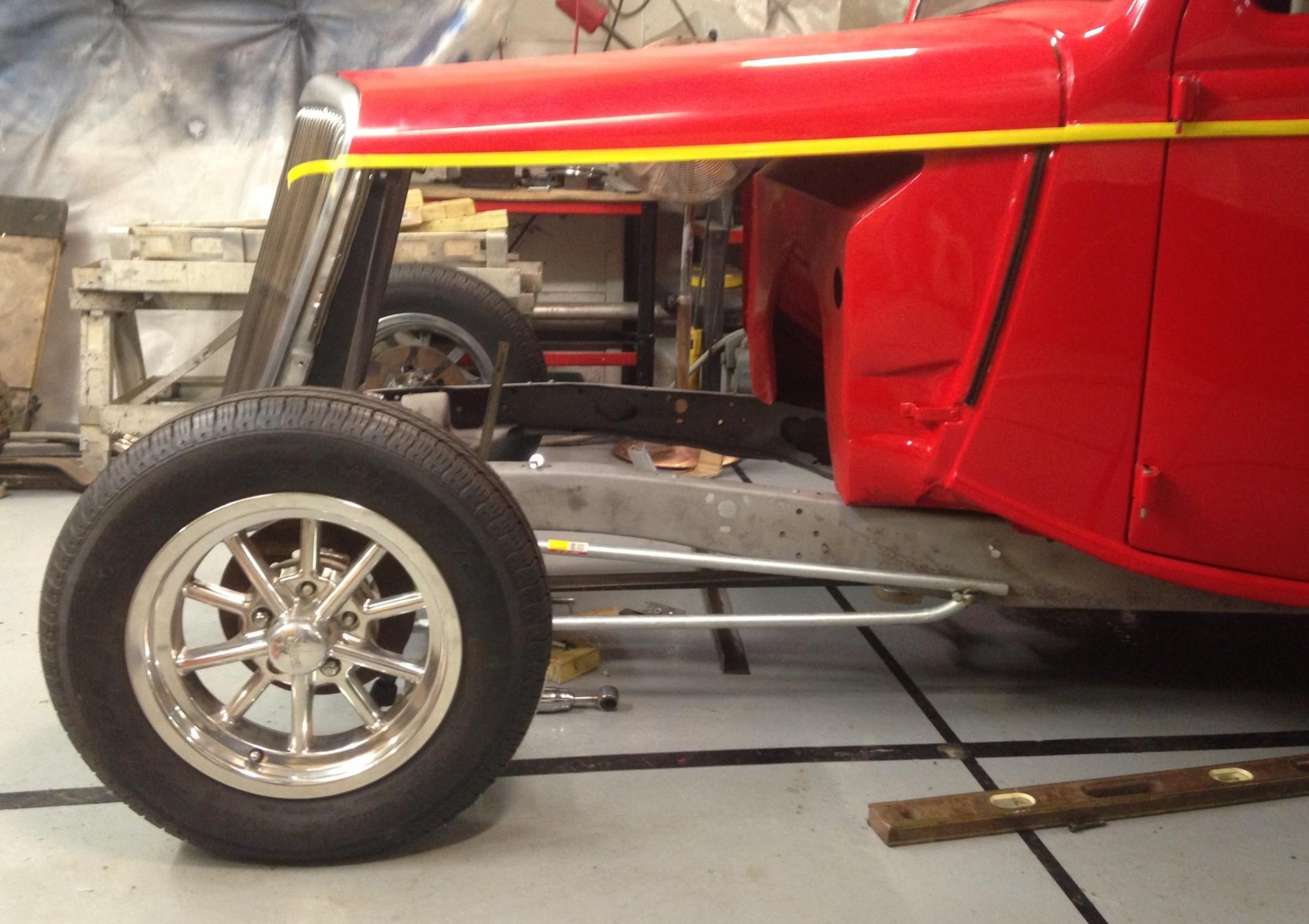

  22. Needed a little 2" step in at rear to make room for the big rear tires.
    2" rise at the rear crossmember to take "some" of the ch***is rake out. It's at 4* now.

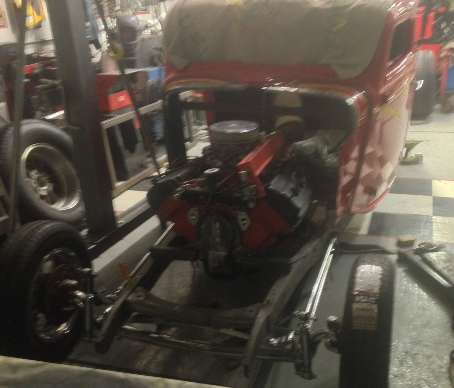

  23. Got the hemi placement & firewall mods figured out.
    None of the stock 392 stuff worked unless I shoved the engine back another 3 inches. So went with the BBC water pump conversion and everything fit nicely with a tolerable firewall setback.

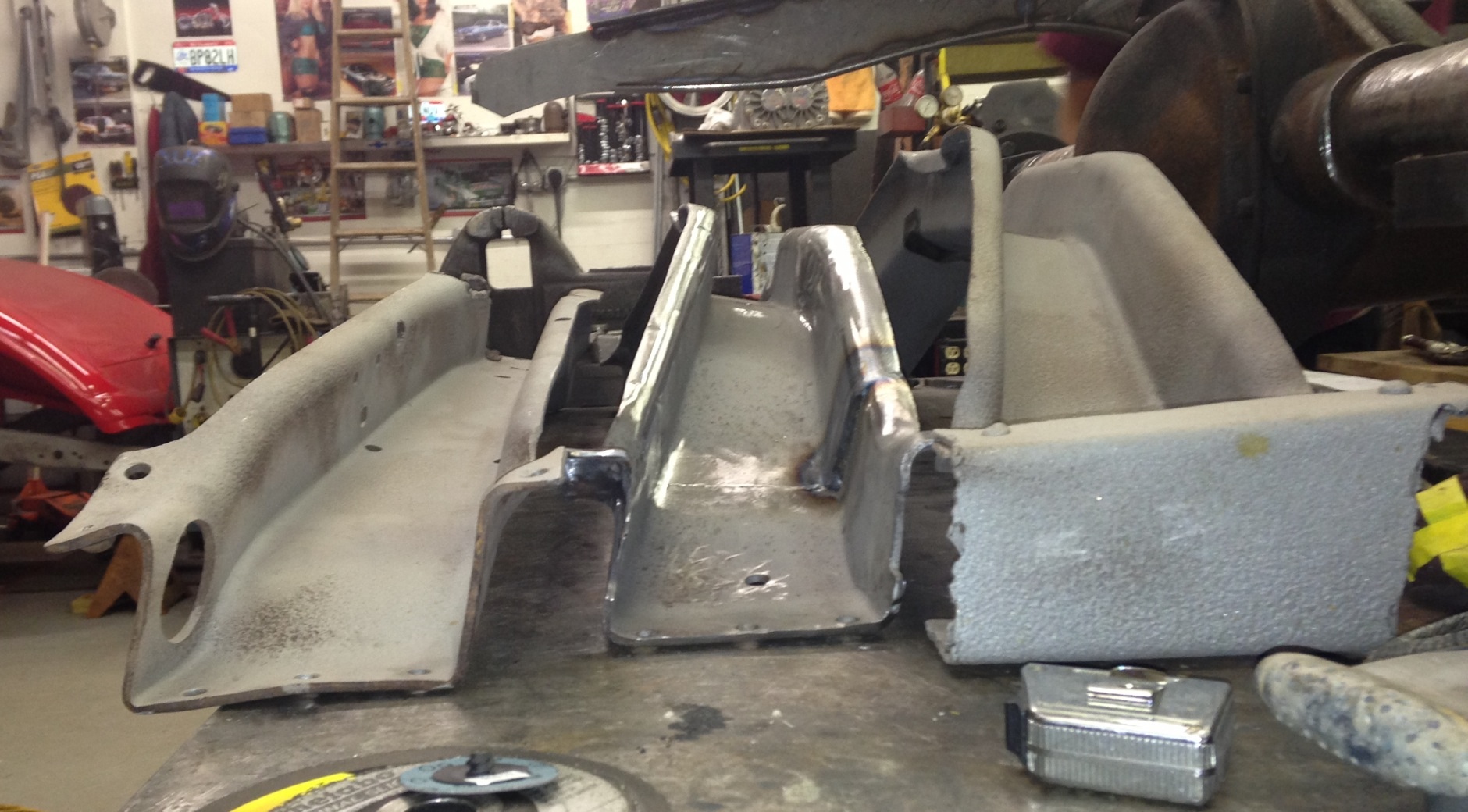

  24. Finish up the rear crossmember.
    A modified 1940 unit. It's narrowed 2-1/2 inches and raised 2 inches or pancaked some call it.
    Left to right - stock 33/34, modified 40, stock 35-40.
  25. The stock 33/34 center was too making the car either ride too high or the spring hangers too low.
    Then the rear kick up was altered by raising it to reduce some ch***is rake.
    That then made the 33/34 too high. Ugggh. But the stock 40 was too low. So I modified a 40 to sit right where I wanted it with a 1940 front spring at the back. I'm using a 40 front spring because the rear end is narrowed.
    What a dance :)!

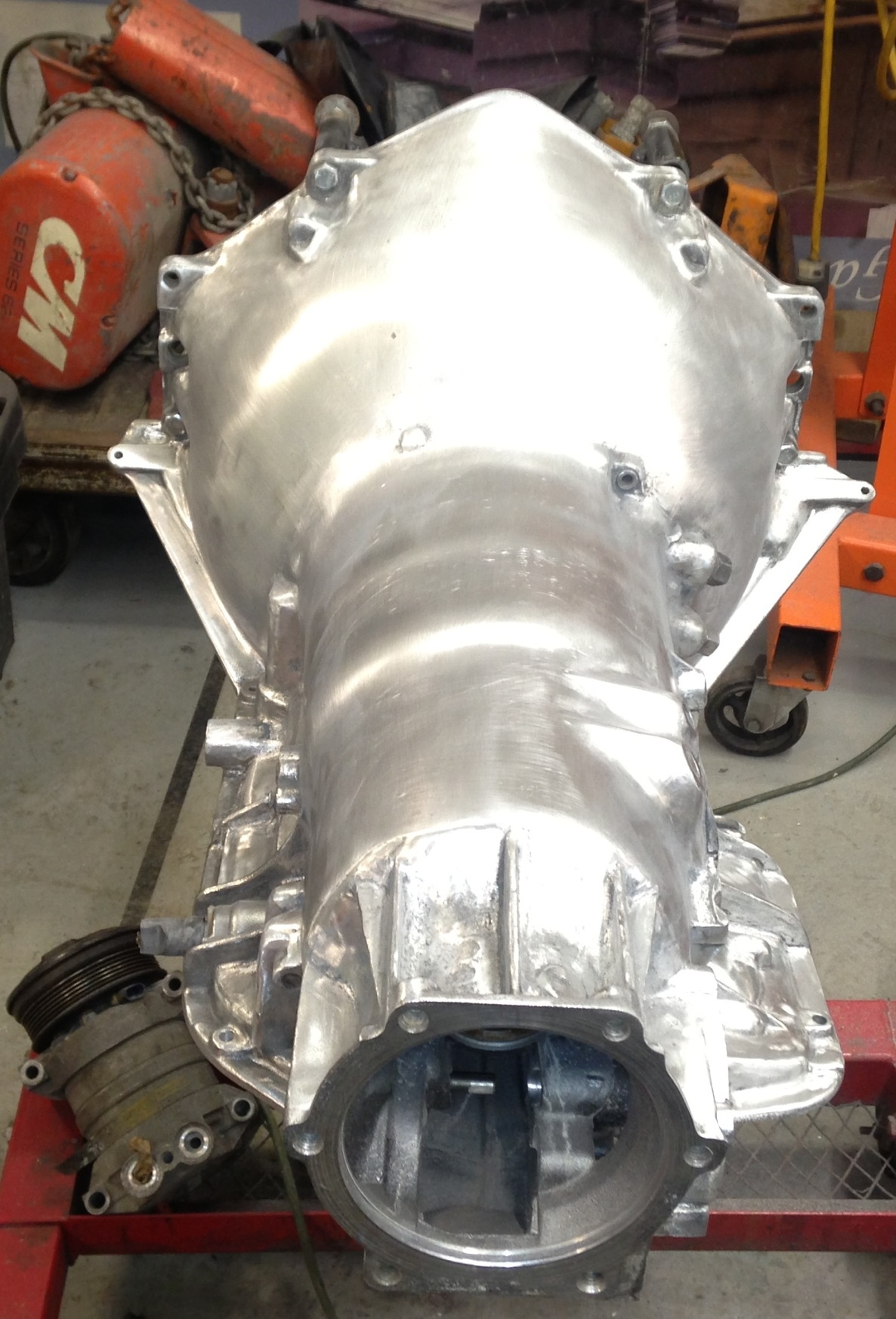

  27. Here's the transmission, ready for the buffer.
    This was all done with time that's normally just waisted.
    2 mins here, 15 mins there, few mins everyday almost.

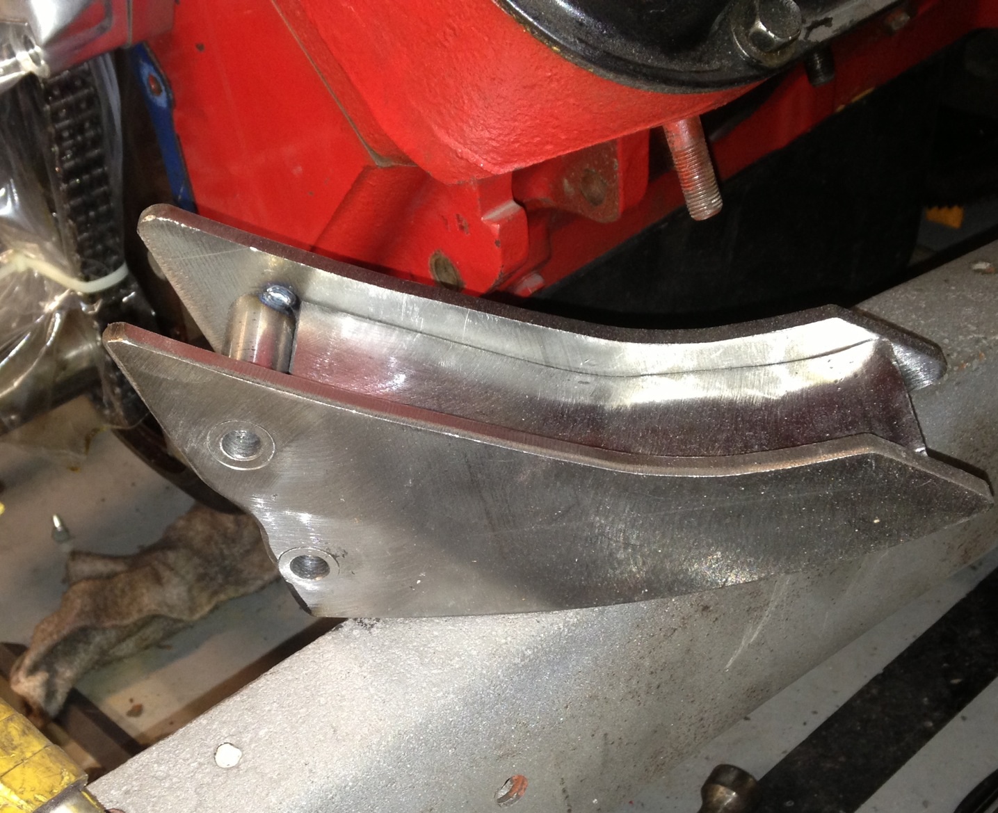

  28. Got a good jump on the hemi engine mounts.
    Have some speed holes to put in. Ill probably sleeve the holes and loose the cap.
    I'm not sure yet.
