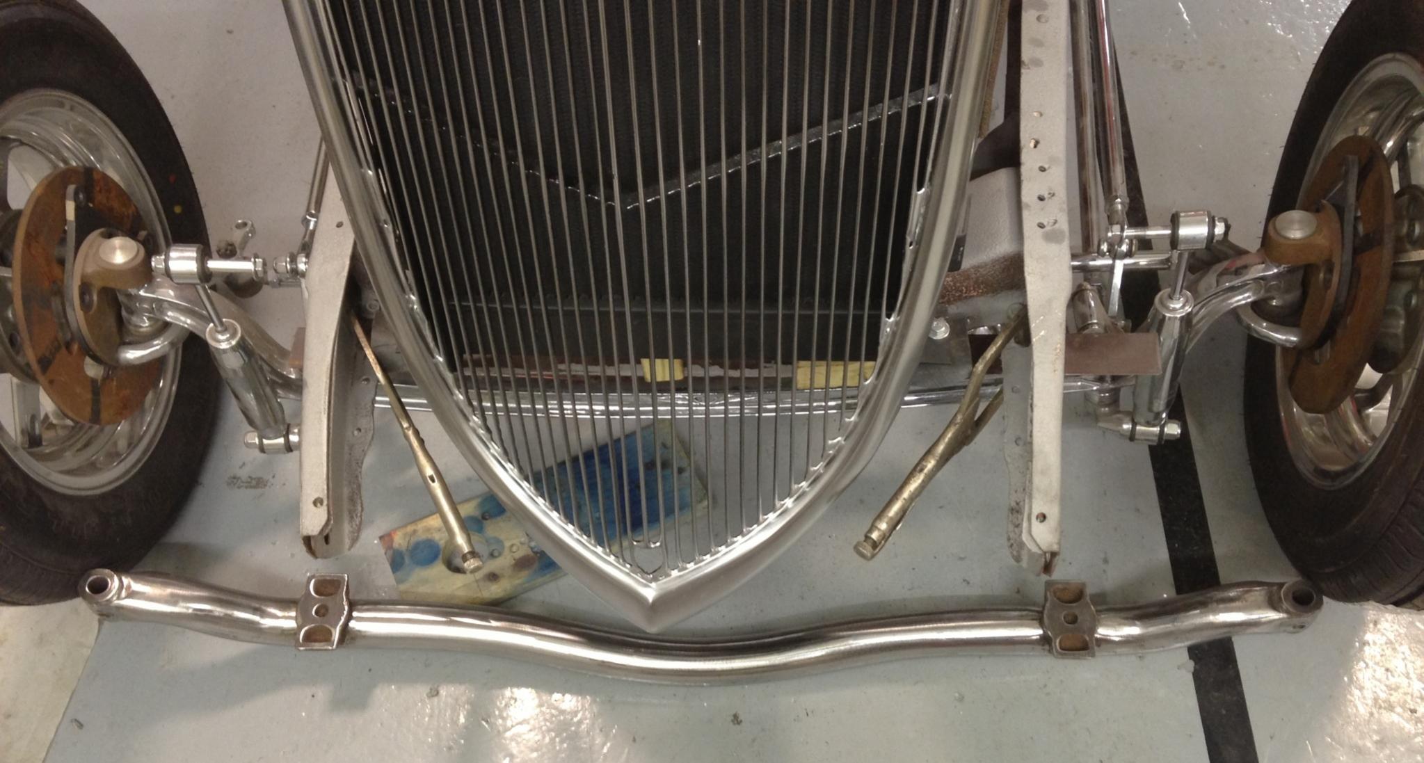

    I have just one question. Those Mopar doube-dips are fairly strong axles. Do you think it is wise to use hairpins with such a rigid axle ? I would think that axle is every bit as strong as the SuperBell tube. I don't intend to start a war, however I am of the ilk that believes "tube" axles are "designed" for 4-bar setups, or twin elliptic springs. We know that racecars have had tube axles with hairpins since the Ice Age, but the highways and byways that we drive our rods on are often not fit to use. Just wanted to say. Love the coupe. By the way, did you use a '35-'36 windshield frame ? Looks good. Hope to see ya at the Roundup. Good luck with ELVIS.

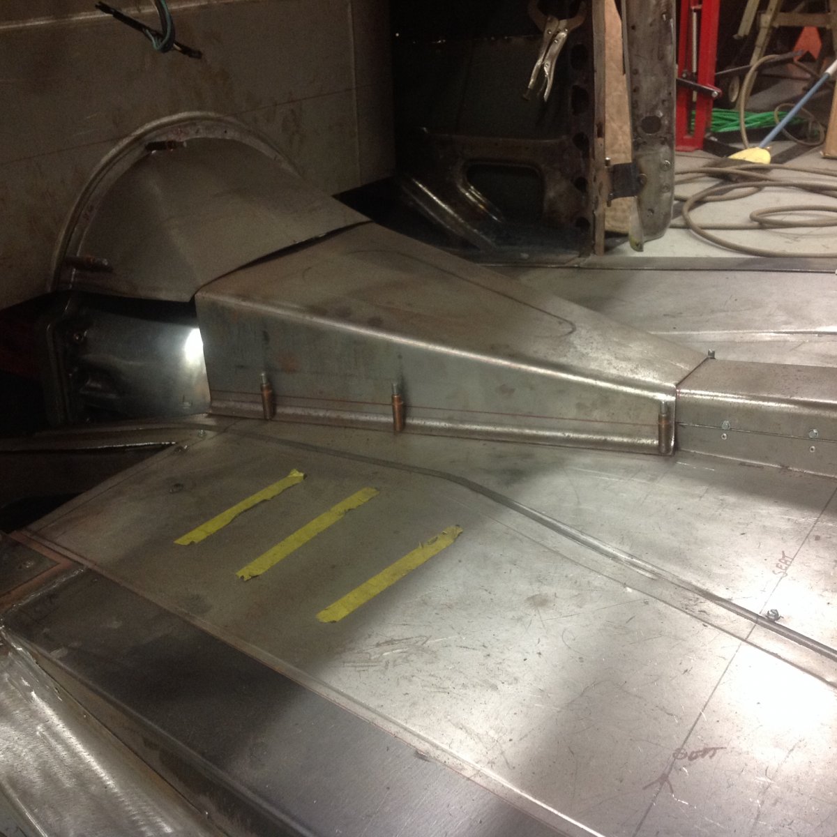

  26. It's been a while since the last up date, but there has been progress.
    It just doesn't show well.
    Nothing fancy - not really shaping just down and dirty forming really. Like HVAC type stuff.
    Anyway here's what got started yesterday and done today.
    I did this Trans cover and tunnel a while ago and didn't love it a whole bunch but it was good enough to do its job. I don't really need the tunnel, but it adds a tremendous amount of strength to the floor, a back bone of sorts. B
    Then I set my seats in and the tunnel hit the bases by 1" crap !!! So since I never finished it then I guess it's time for a redo.
    So from some Jerry rigged bent up loops in outer space the shortened tunnel I got paper template - then I got this.
    Put in the brake and came up with the lower 1/2 of this
    Missed a pic or two of The upper section
    But once I had the lower 1/2 set in place it was just pretty simple to get up to the firewall.
    A few pieces of duct tape to support the paper then make a template.
    I cheated and put it in the slip roll to get the first part of most of it shape.
    Then I finished with it over my knee to tighten up the transition.
    The fire wall edge was turned up with vice grips then back to the stretcher to capture the firewall radius.
    So that the upper part of this
    Getting it to fit in is a sneak up on it dance. Tweak fit repeat trim tweak fit repeat.
    Before View attachment 3392298
    After
    Still have One little piece to get on the hump/tunnel.
    Maybe I'll run the tunnel thru the planishing hammer maybe not

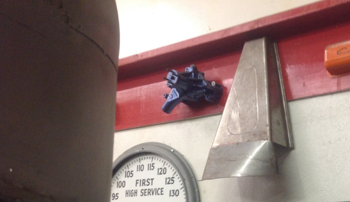

    The old one ? It is just hanging on the wall now
