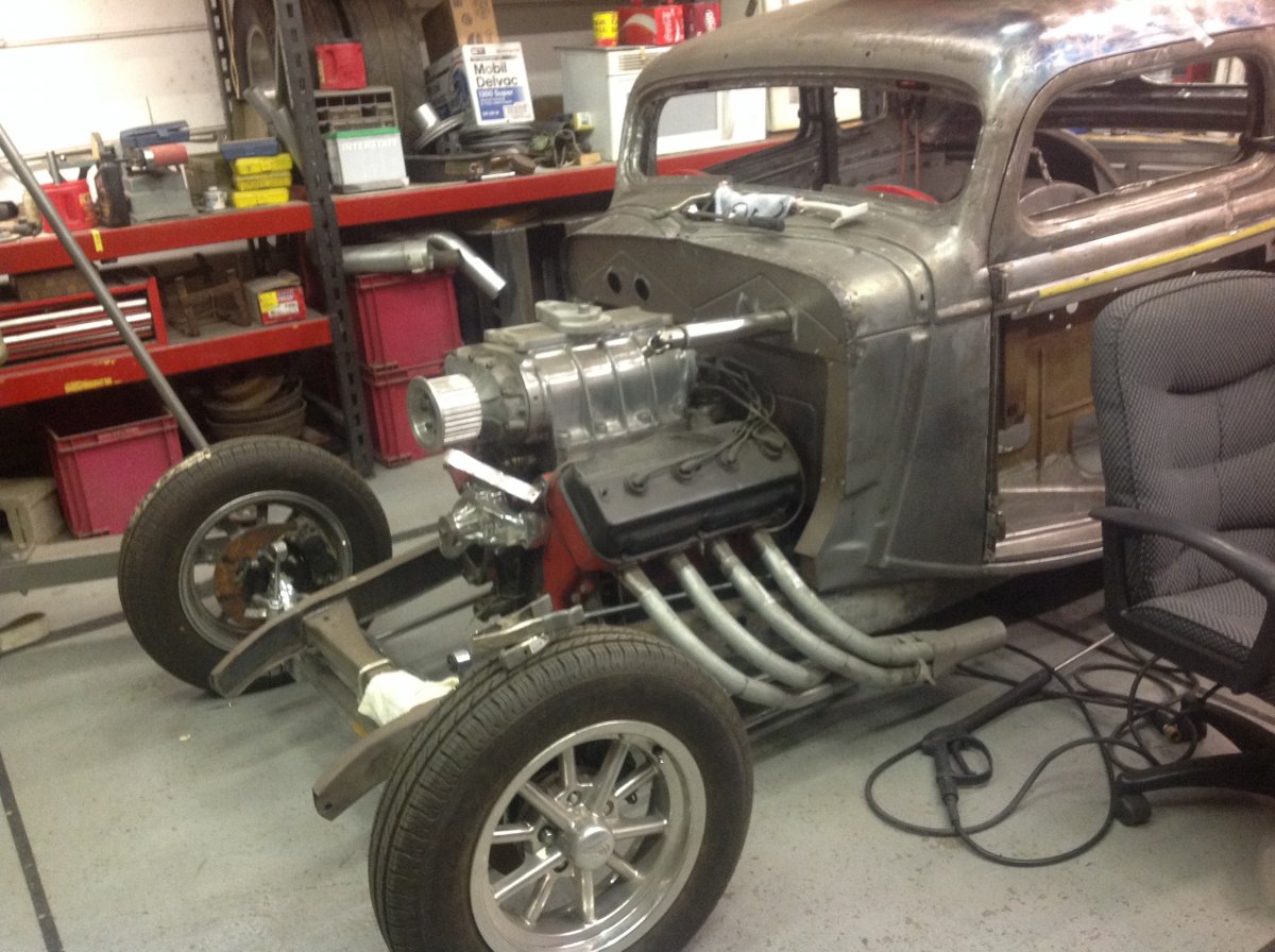

  16. Merry Christmas everyone!
    Finally got enough tacks on the gas tank for its first trial fit.

  24. jhexide
    Joined: Feb 23, 2012
    Posts: 334
    jhexide
    Nice work there 31 Vicky,what size,and brand tire you have on the front,
    i just got those same wheels only grey center ,for my T bucket.!
    Thanks
  25. gdaddy
    Joined: Mar 6, 2010
    Posts: 169
    gdaddy
    from nw fl.
    would you mind telling me where they are made ? 165/80/15 tires , thanks . ronnie
  26. Off brand made in China
    Wow is that pic crappy I'll get a better one later
