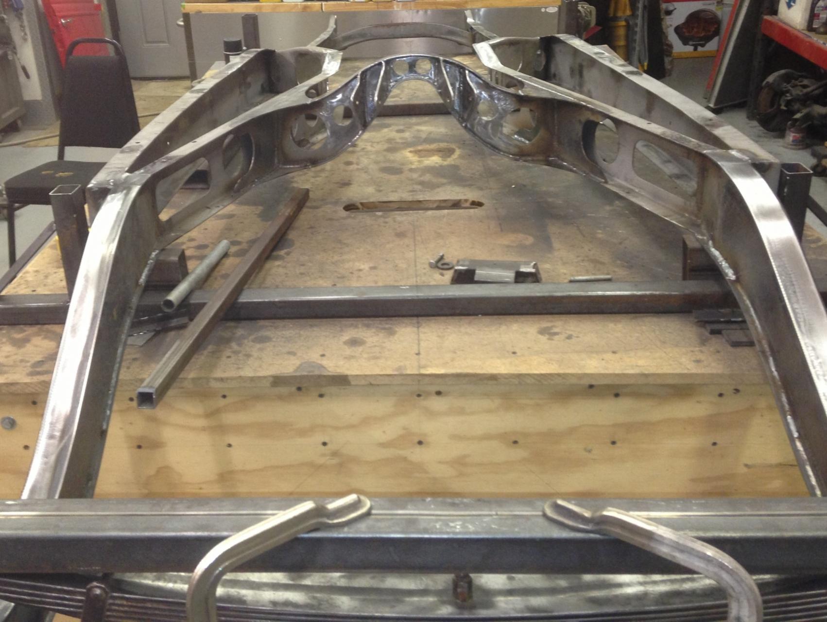

  16. Got the frame flipped and welded.
    Big milestone deal to me.
    VANDENPLAS likes this.

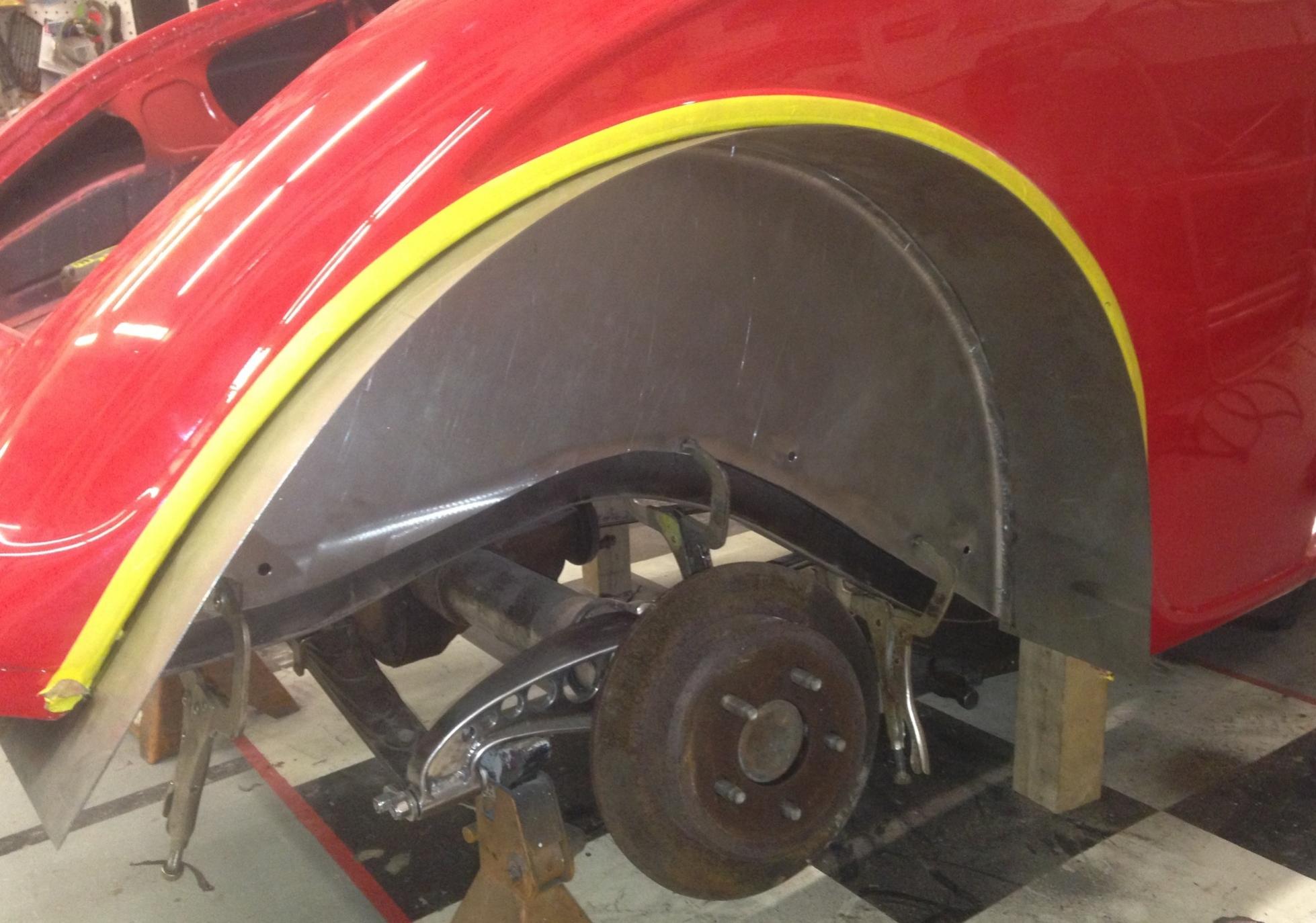

  20. This cobbled mess of a wheel and it looks just as bad on the other side but both will be leaving.
    New subrails that follow the frame, some bead roller work and it will nice.

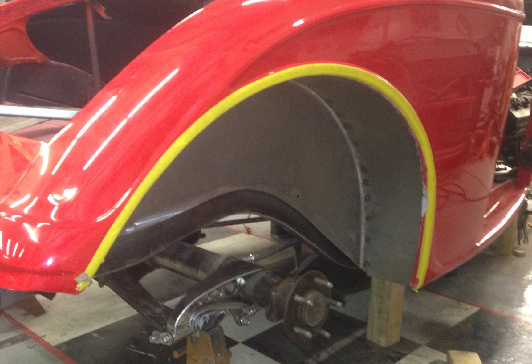

  21. Right now, this is a major improvement over the other side.
    oliver westlund and Stogy like this.

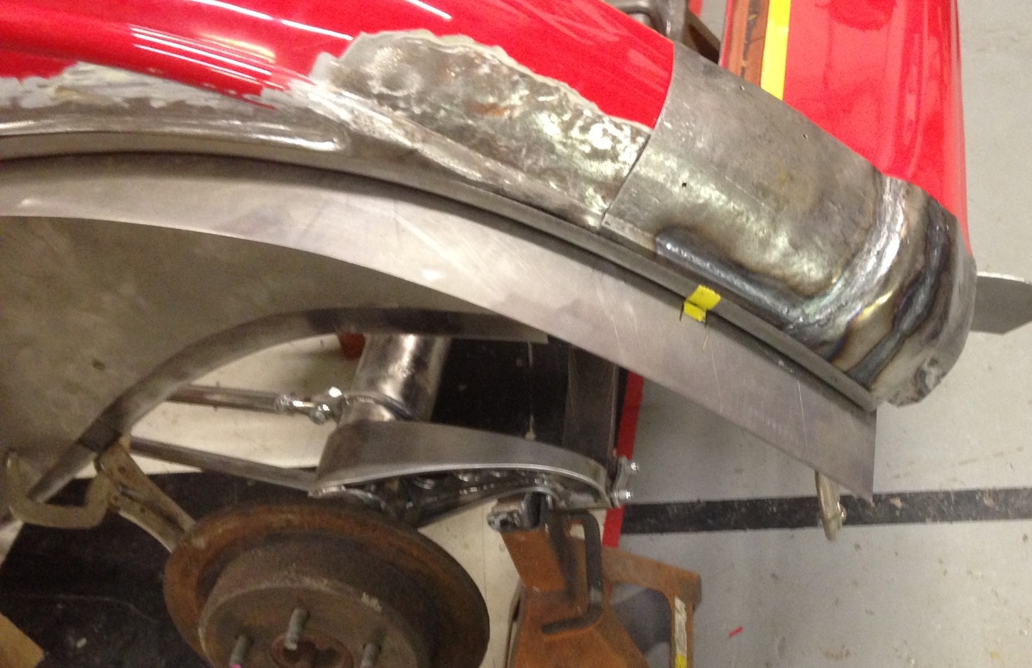

  26. Well this wheel well turned out to a much bigger PITA than expected.
    The lip, the tail and the trunk flange.
    Stogy likes this.
