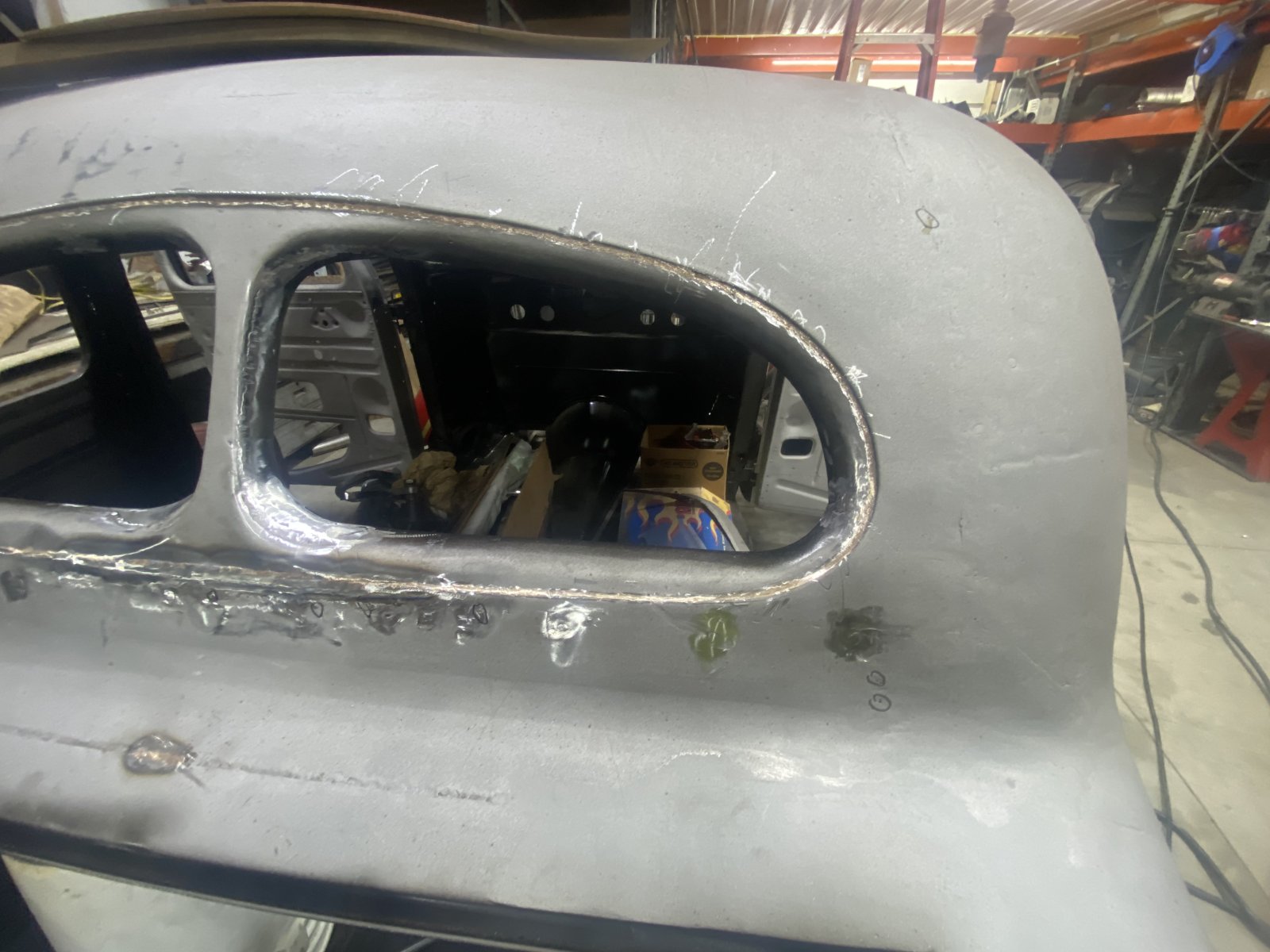

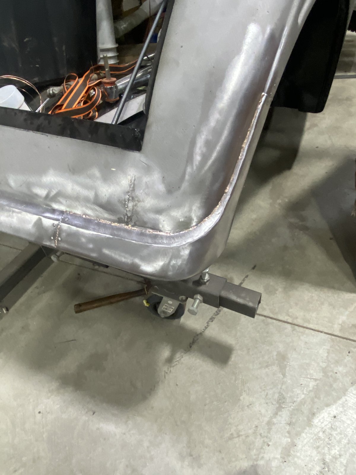

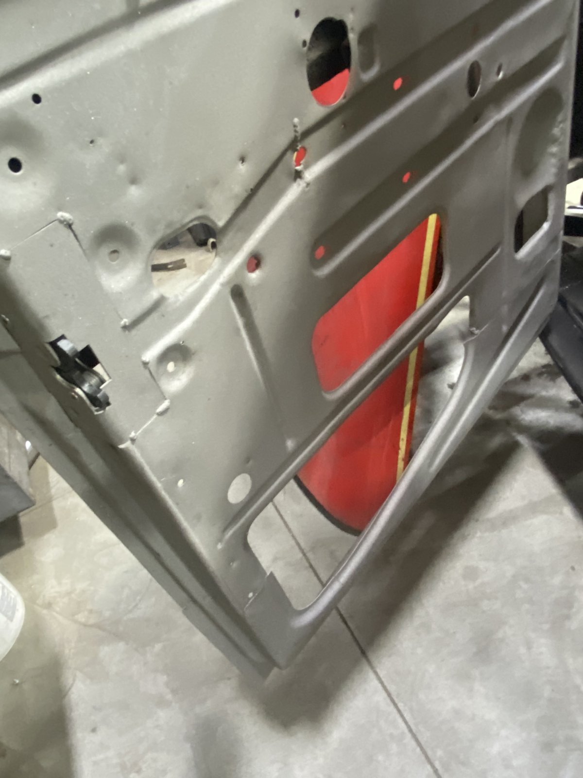

  1. The corner is welded on.

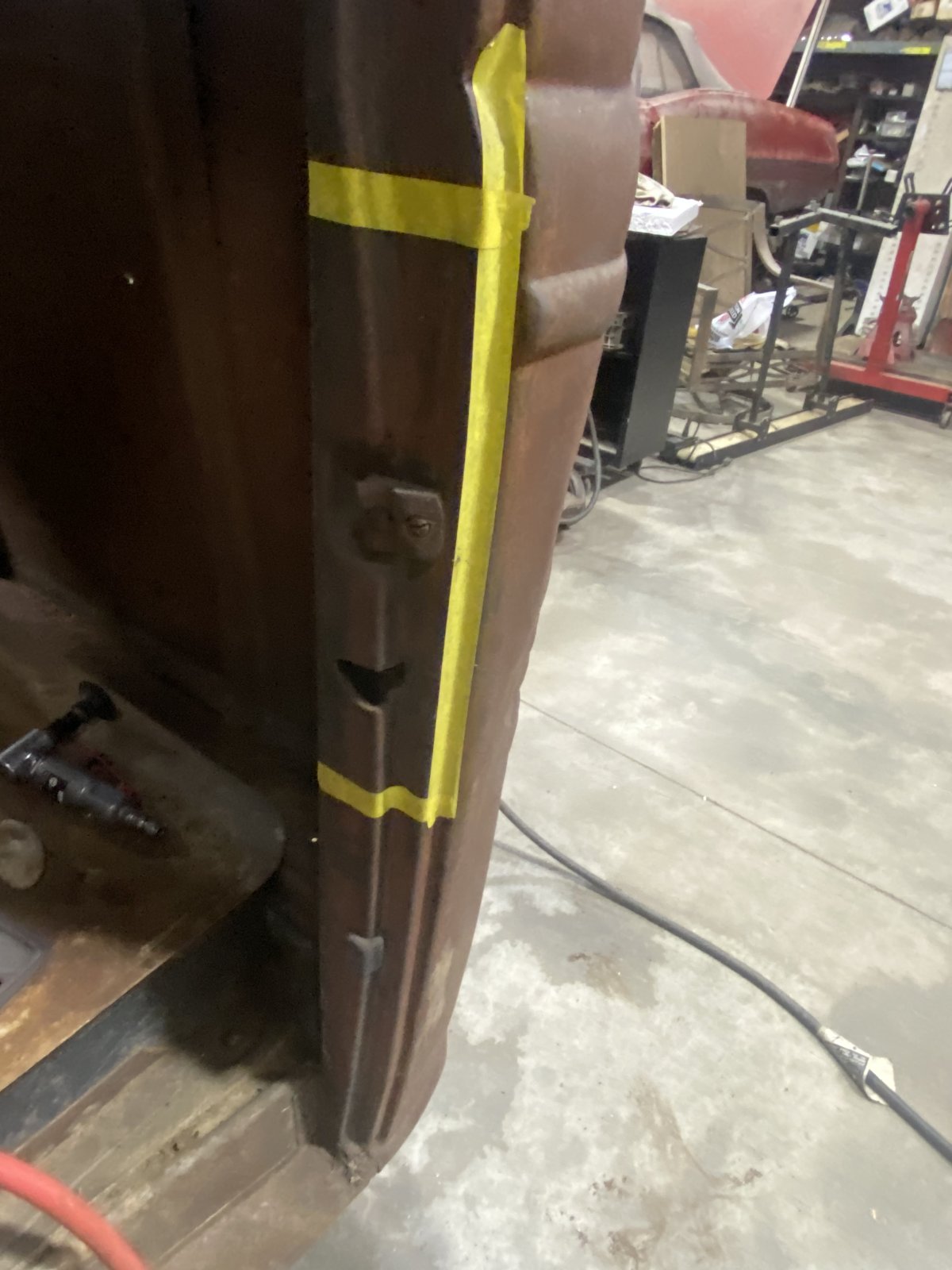

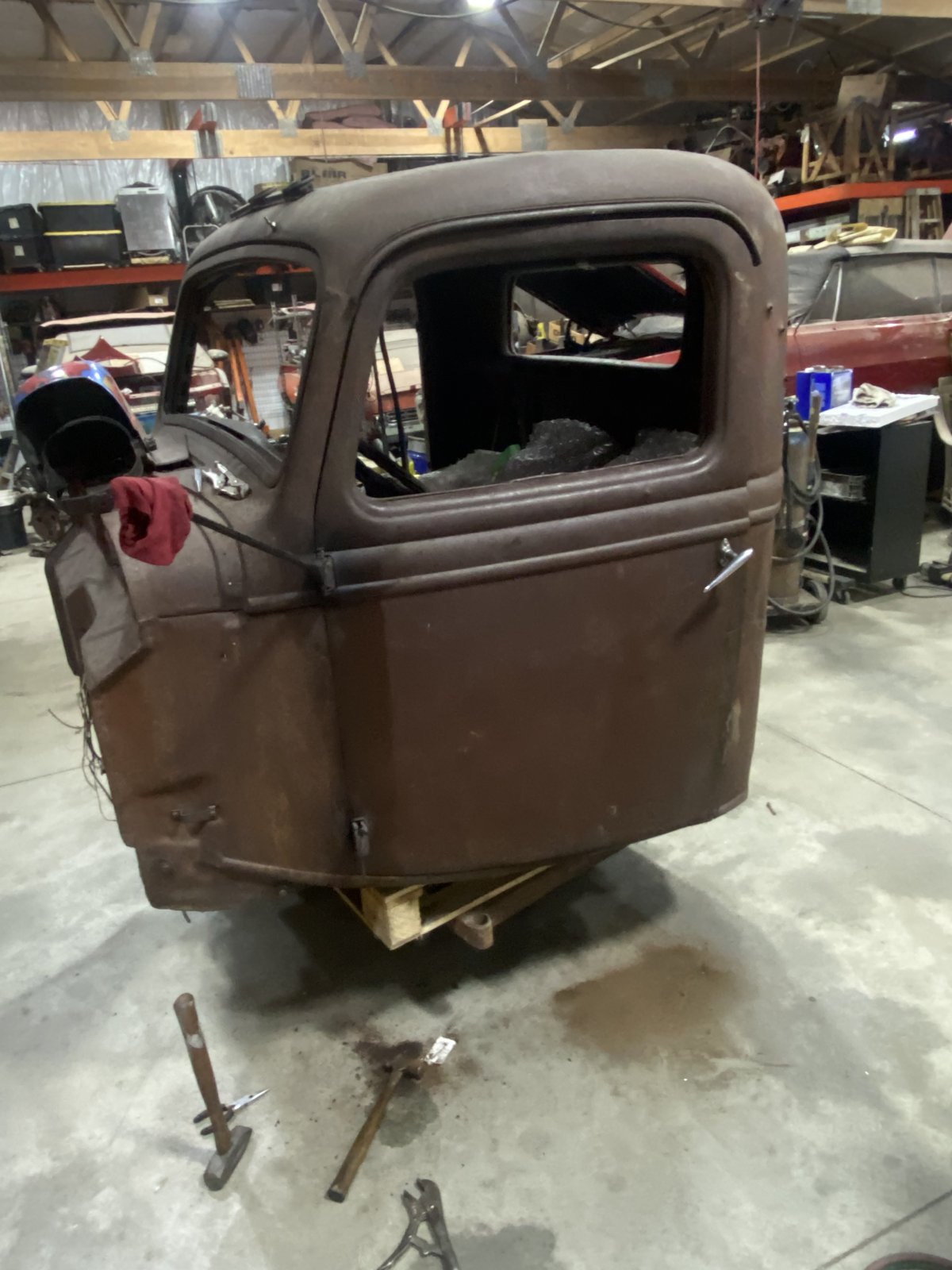

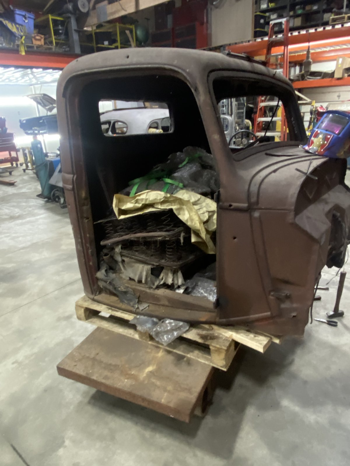

    I remember buying this cab, but can’t remember when. I need parts of the doors and door jambs. So it’s beating them damn pins out. 3-1/2 out of 4.

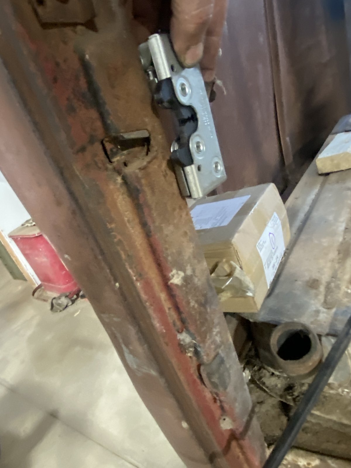

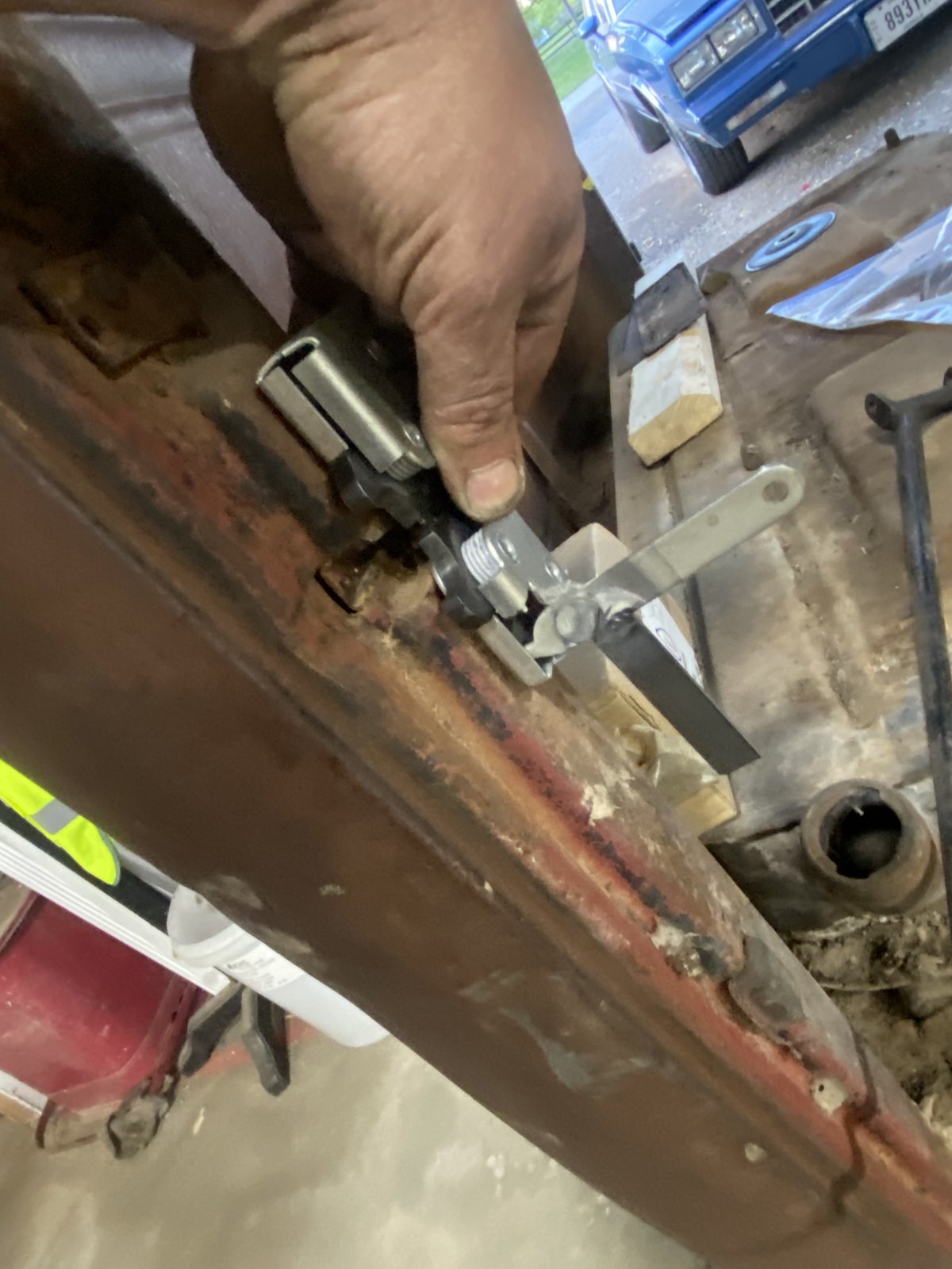

    My buddy talked me into bear claw latches. I’ll not argue they are FAR FAR superior to the old ones. However installing them requires completely redesigning the windows, not just a little bit but all of it and the fuzzies, the handles too. So In order to retain some sanity I’ll be uninstalling the bear claws and need the Doors/jambs sheet metal and mechanisms.
    Plus these doors were copped wrong, cut apart and redone. I can use them parts to do it right. That’s why I bought the cab.

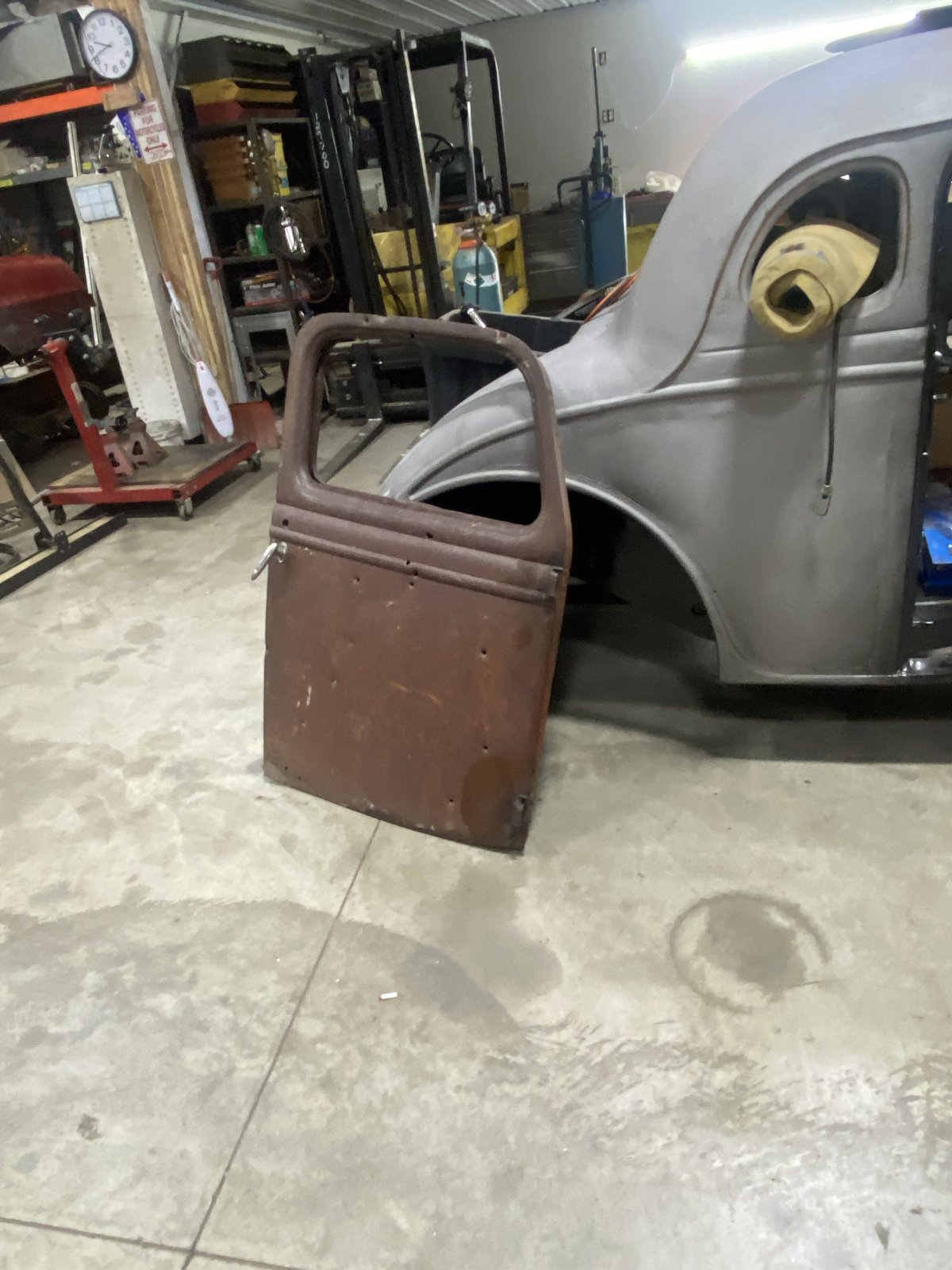

  2. My parts haul for today .
    Both doors , loaded.
    Upper dash trim,
    L side post trim
    Windshield frame nice too.
    Few more to go
    I’ll need these area of doors jambs, maybe I’ll cut them maybe I’ll copy them F9D67D4E-0643-4C7C-B85E-05ED80C16619.jpeg
    the bear claws kinda caused a stoppage because nothing else worked after the install.

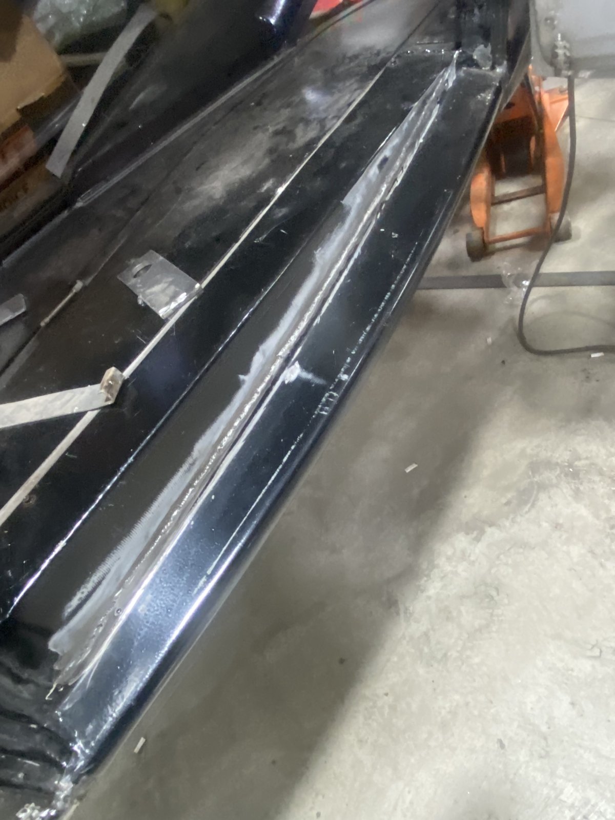

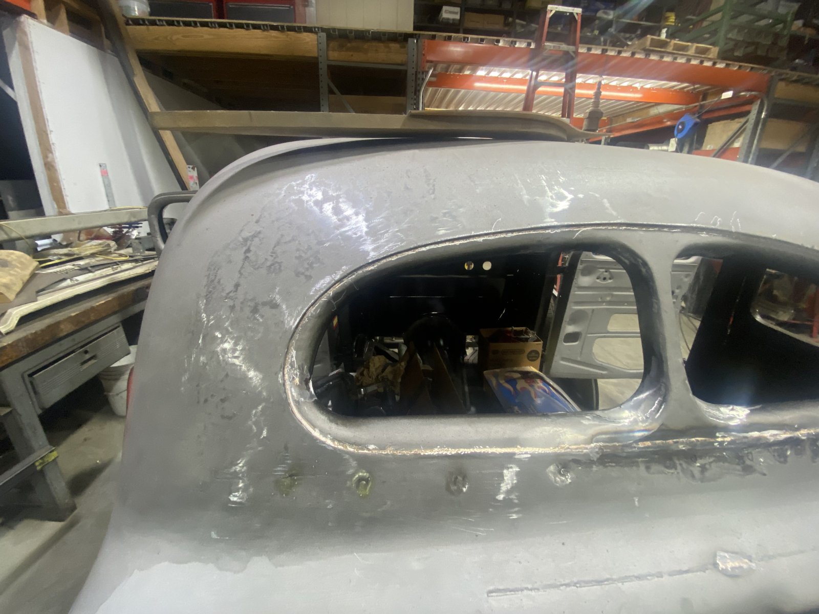

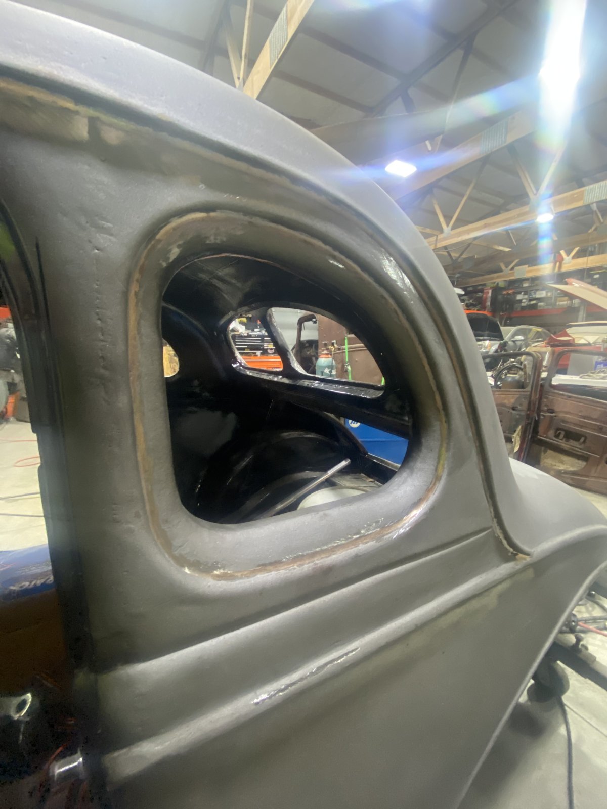

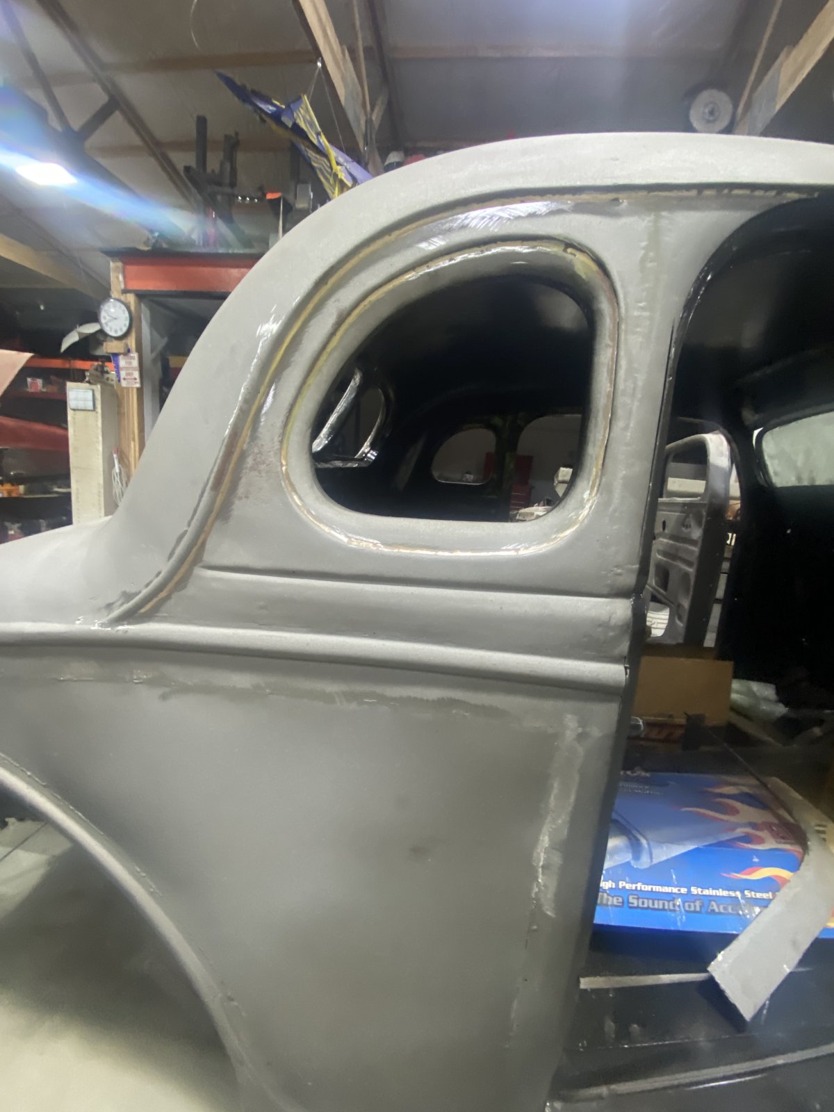

    Just some precision grinding and dremel tooling. You know when you’re going along and say to yourself “ I’ll get that later” ? Well today was later for some of that monotonous stuff. Plus I kinda forgot where I left off on this thing so it was also a thinking day while accomplishing something.
    I like the silicone bronze for stuff like this. It tools down really nice in the corners.
    I started making a special male and female dolly for tightening up the body line then dinner was ready.
    Oh And dousing the door hardware.

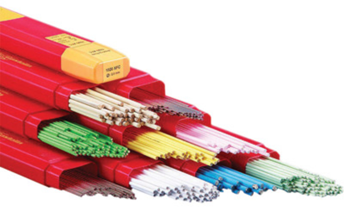

    Many years ago the shop I worked at used a lot of Eutectic coated brazing rod, great stuff. Is there a super primer that sticks well to it today? Bob R (3).jpg
  5. Brass was never the problem, it’s the flux and not cleaning it off that causes adhesion problems.
    Silicon bronze doesn’t have flux, I put in with tig welder. You can even run silicon bronze thru a mig but I haven’t tried it yet. Shits expend now, $28.00 a pound at my supplier

    Started staring at those damn bear claw latches, got an idea that will probably work but I don’t know how to make them look ok.

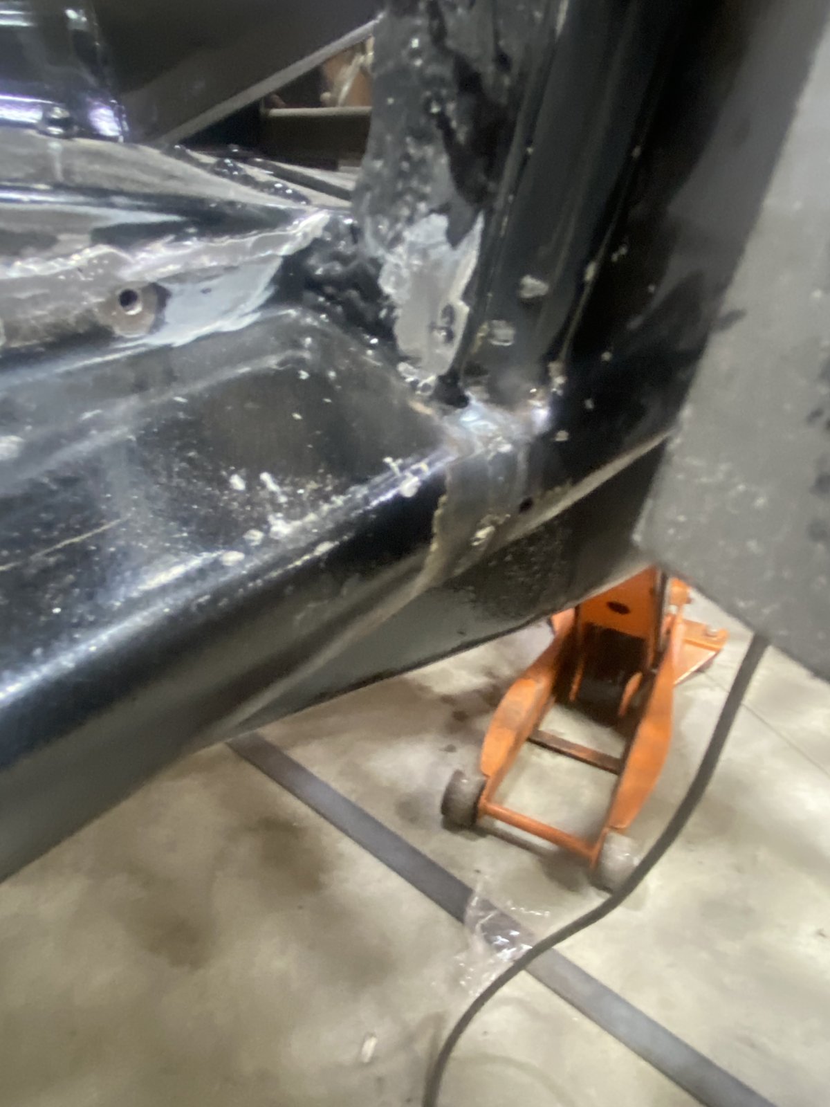

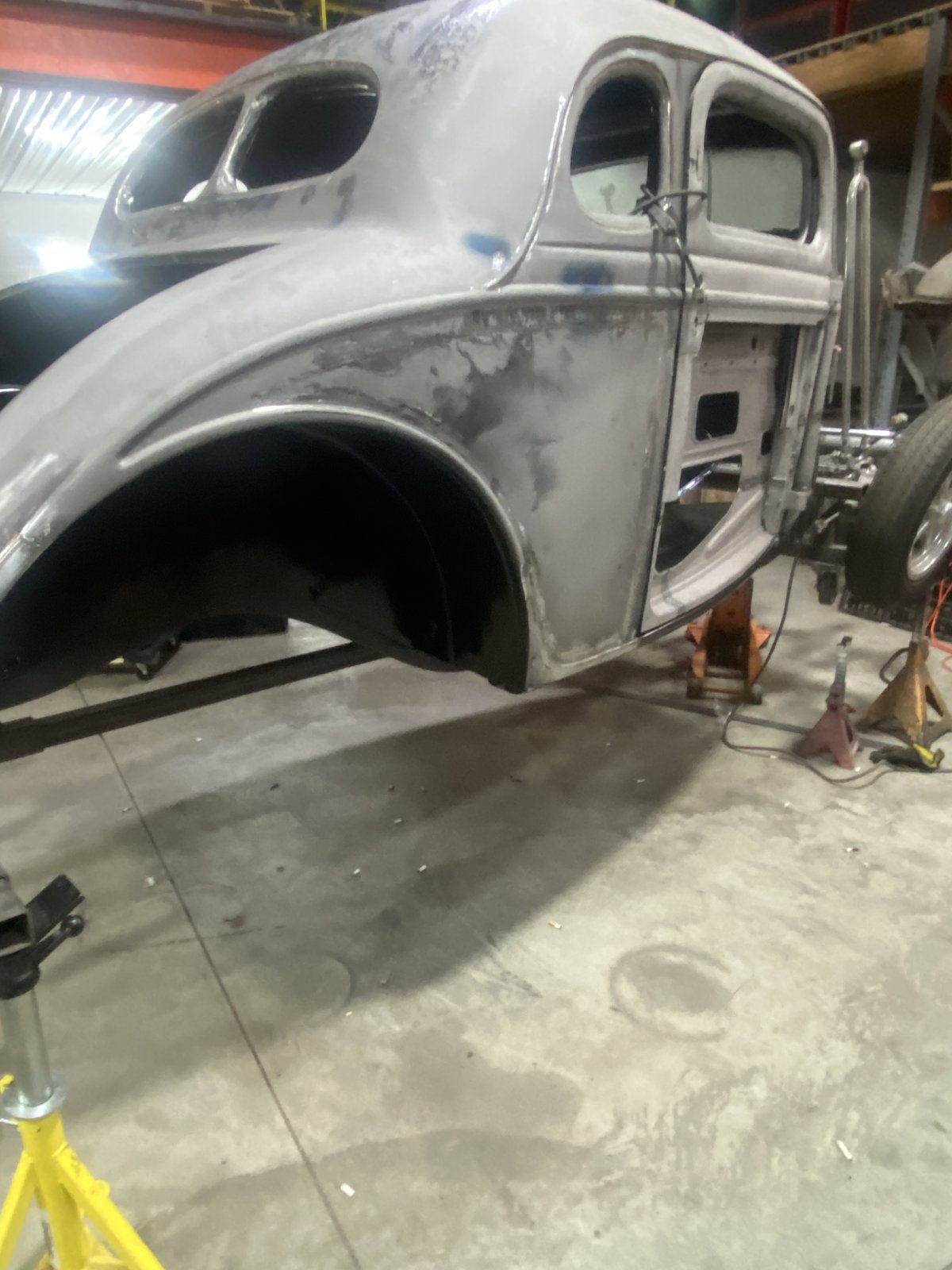

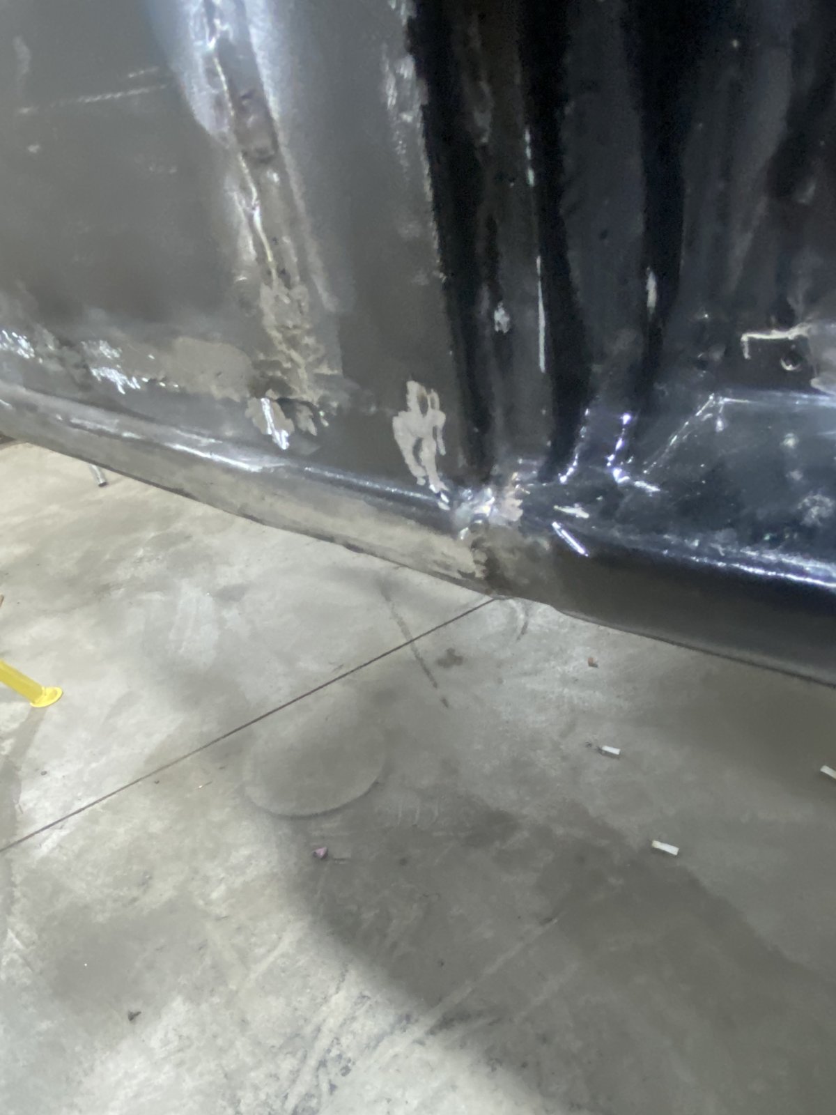

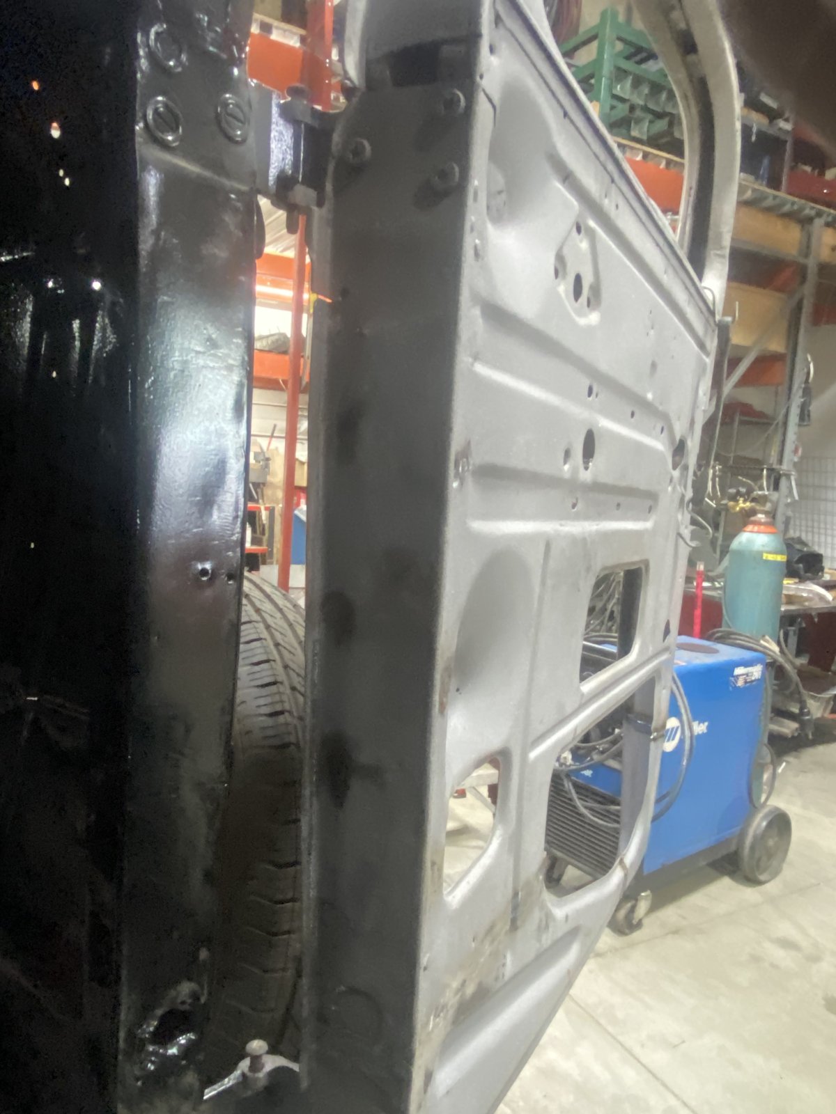

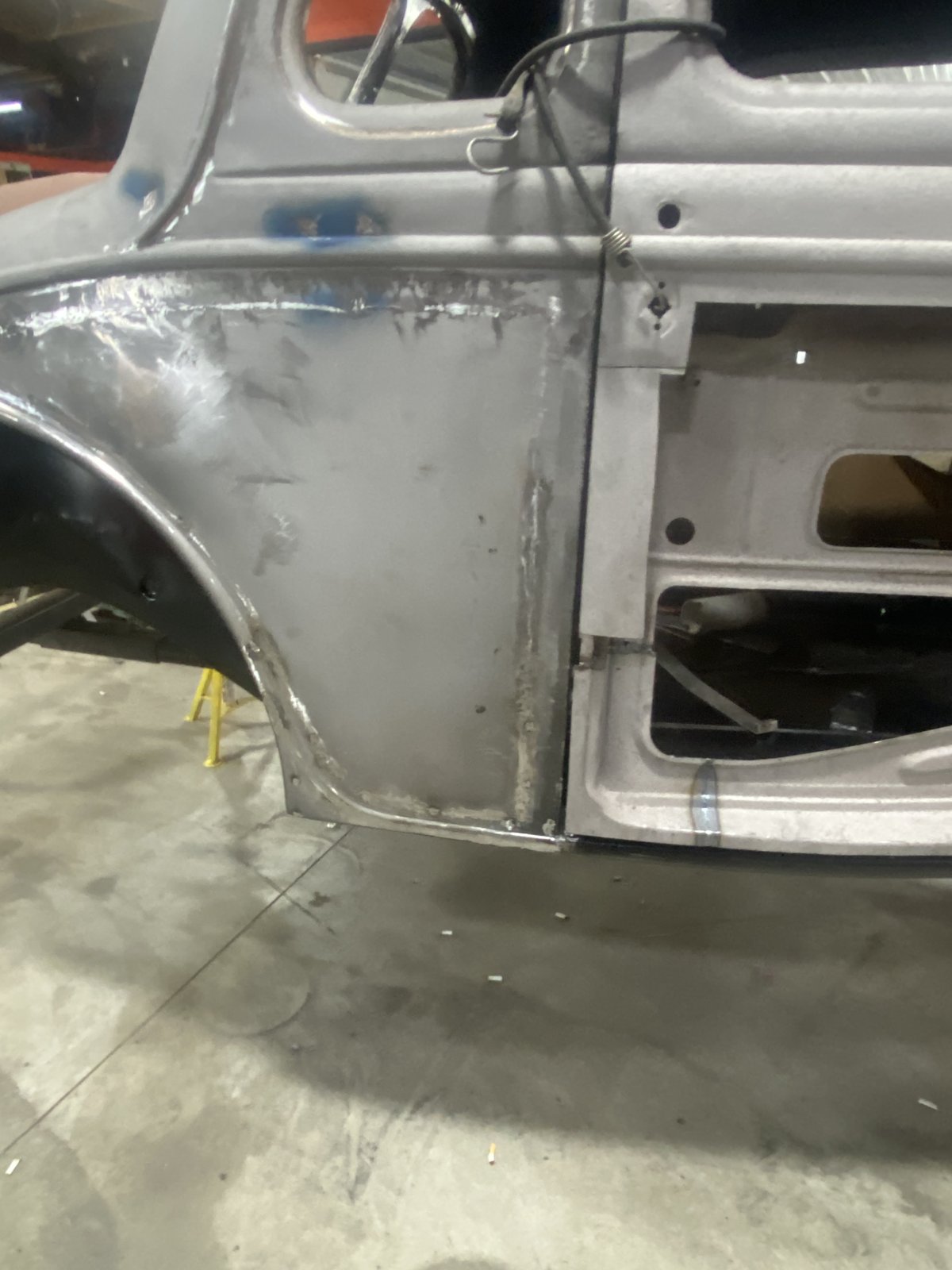

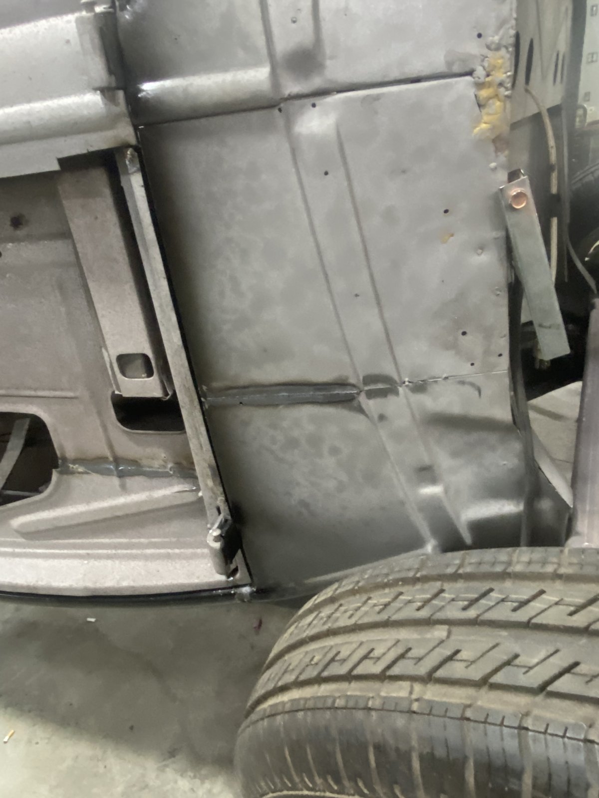

  12. I couldn’t get out of Friday evening activities and that’s ok because the food was good, company was great and my wife made it up to me so, I was bright eyed and bushy tailed. Saturday’s party was canceled so that never happened. The sucky part is my helpers Mom passed away Friday morning. Sunday after dinner I help my wife pull weeds in her garden. Monday 5:30 am till noon. Here’s what happened.
    Got lots of welding done, figured out the door skins are garbage, did some more metal finishing on the 1/4, pretty good progress.
    Inner door stuff welded
    You may remember this area has bubble gum brazed water pipe
    4A60F830-8B30-47B6-9F89-A3349436E872.jpeg B4A41BE3-10A2-4FB7-B04F-5CFE352E5452.jpeg
    inner to outer rocker welded
    An inside shot of progress and burnt epoxy,
    lower cowl 1/2 welded, that damn axle and tire was in my way. (No help to move it.)
    Got Elvis up pretty far to it’s easier.
    lots of welding here got the lower inner all welded in.

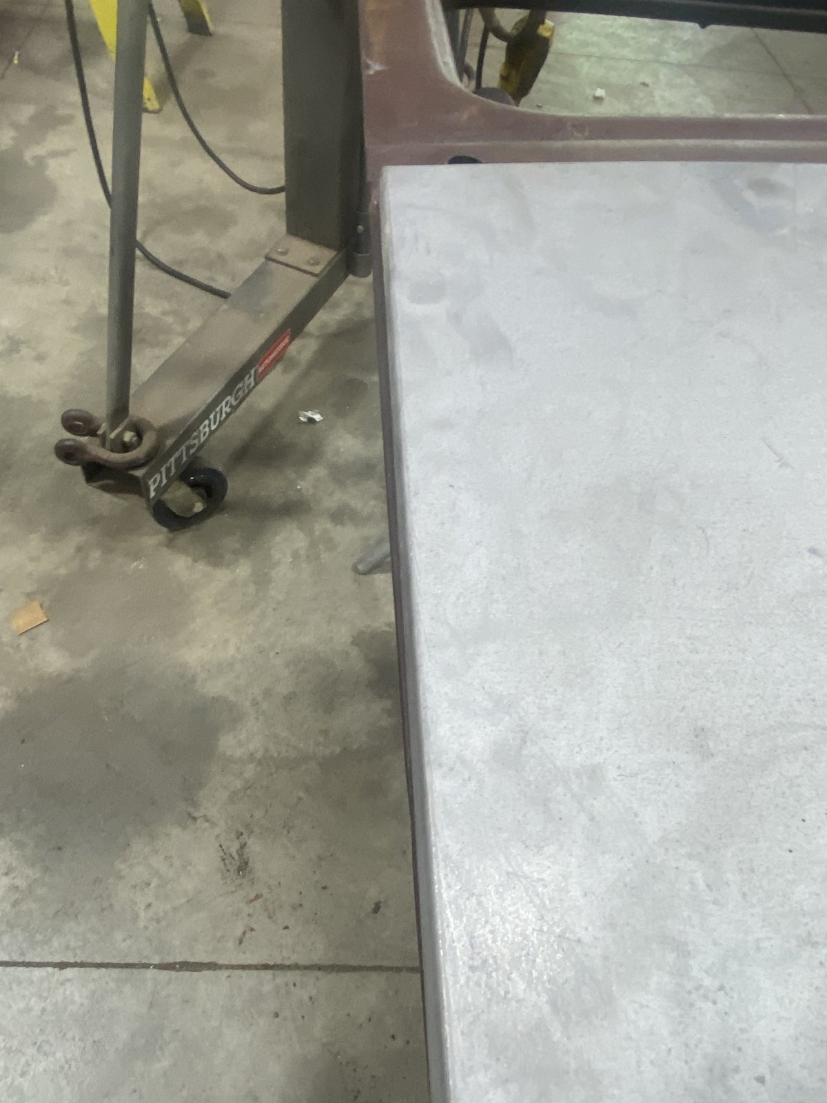

    Almost moved to door skins but they are for shit. Zero to 1/4 off no matter how you look at it. It’s possible to get 2 sides almost but then it’s zero to 1/2 out on the other.
    The lower radius is all jacked up too.
    I’ll probably just make my own at this point.
    Just to be sure I wasn’t fucking something up they fit like shit on the spare cab too.

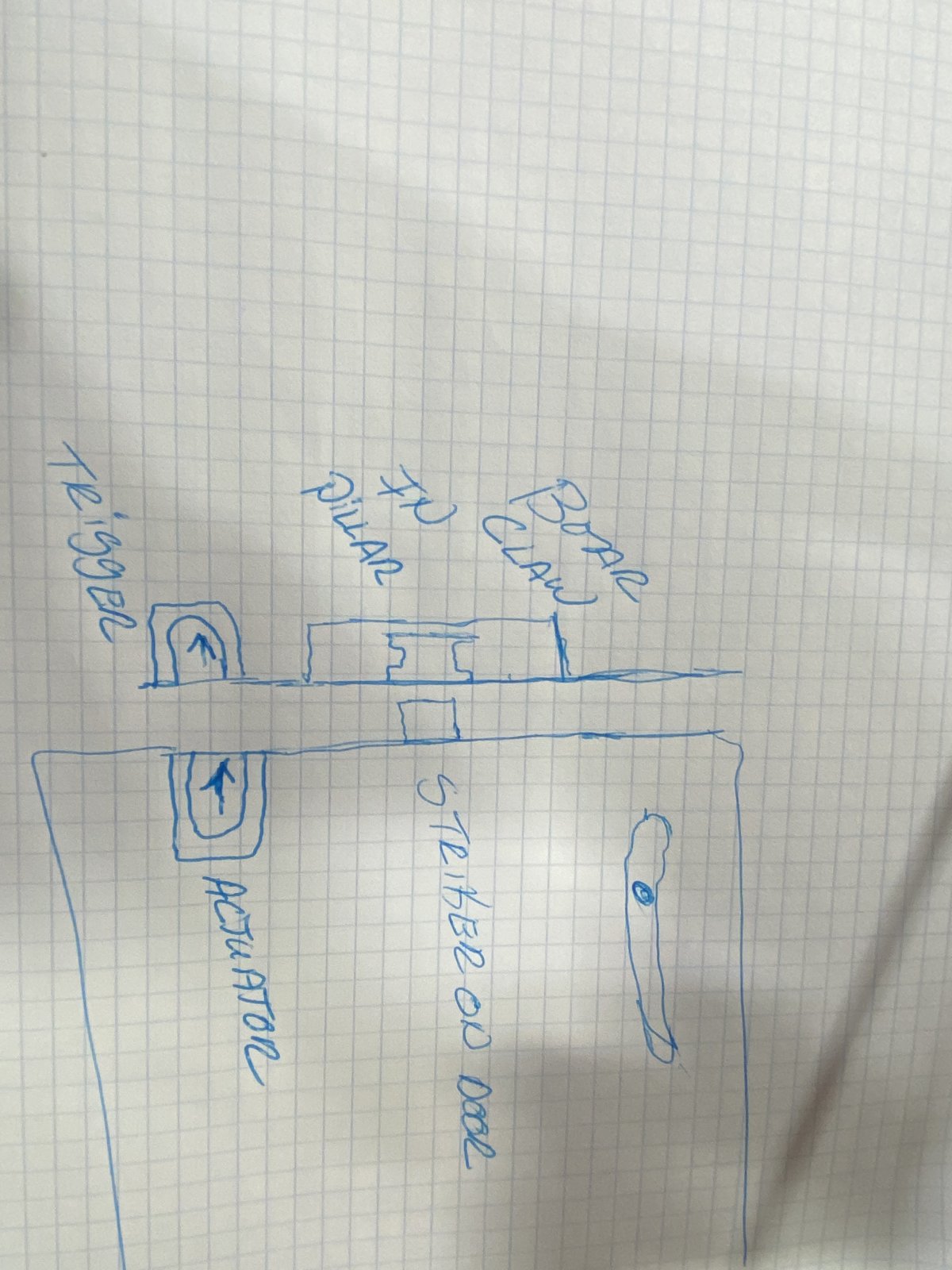

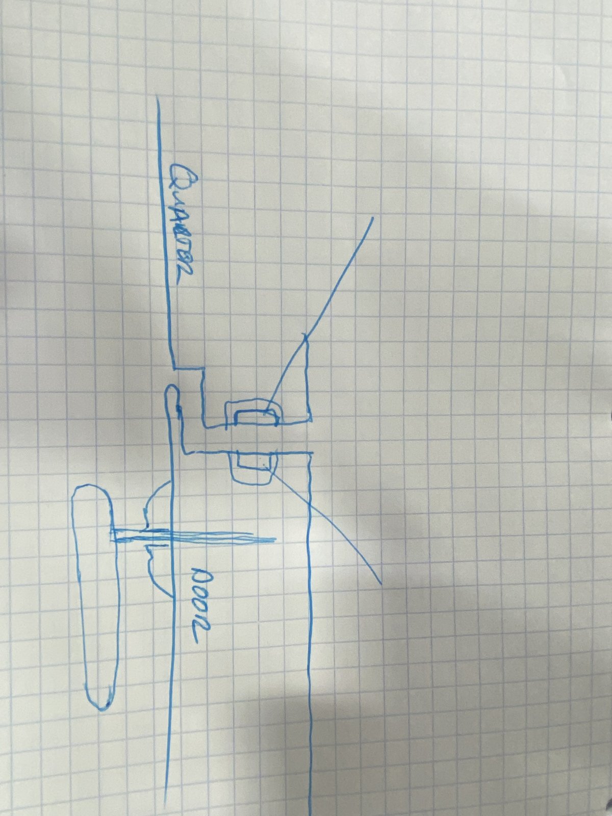

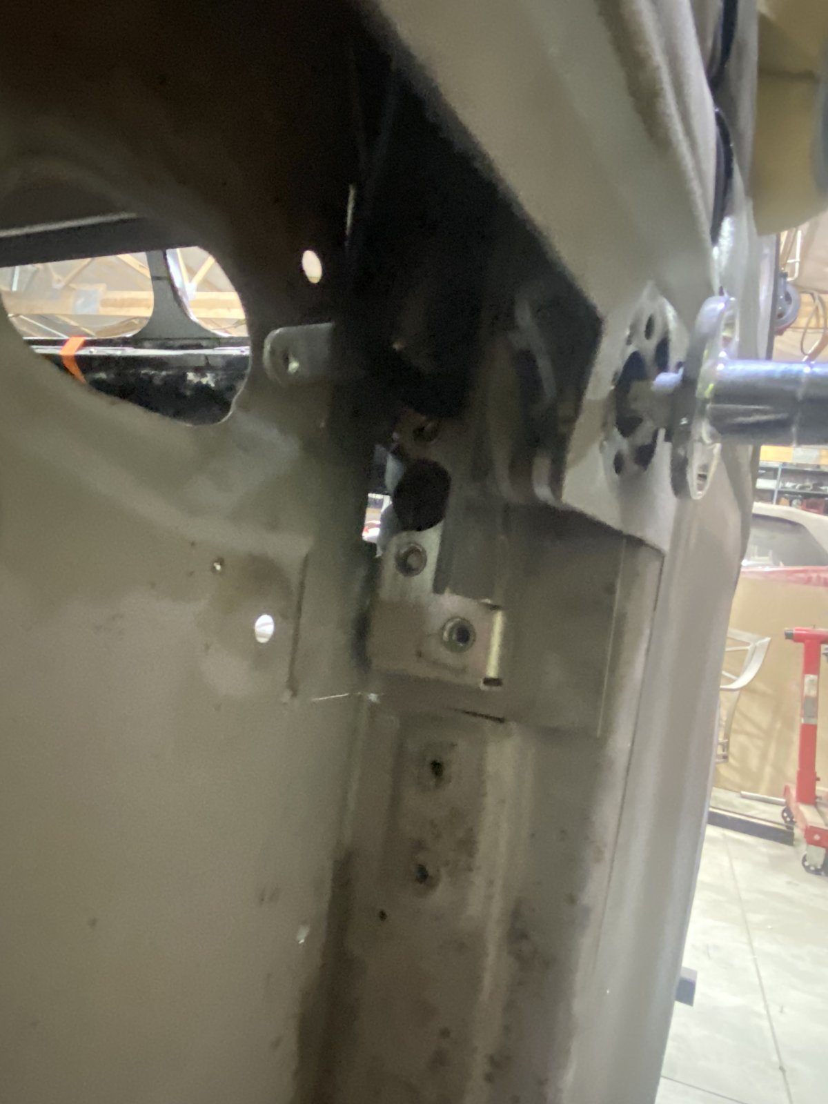

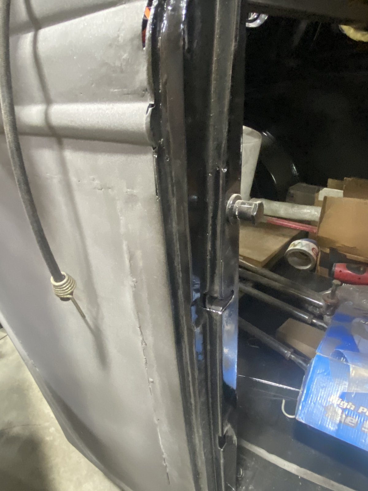

  14. The latches fit here sunk into the pillar with the striker on the door.
    75A94B8E-0ECE-4FF0-9557-C001E8BB92DA.jpeg 919B4163-40B4-48E2-AED7-F29E1E4B9E17.jpeg
    The problem comes from how to trigger it through the door jamb without the mechanism acting as a dead bolt.
    D4C576E7-8375-406E-A3A1-35341CBB48F5.jpeg 2E7B5487-42C0-4855-935D-DC26B10B172F.jpeg

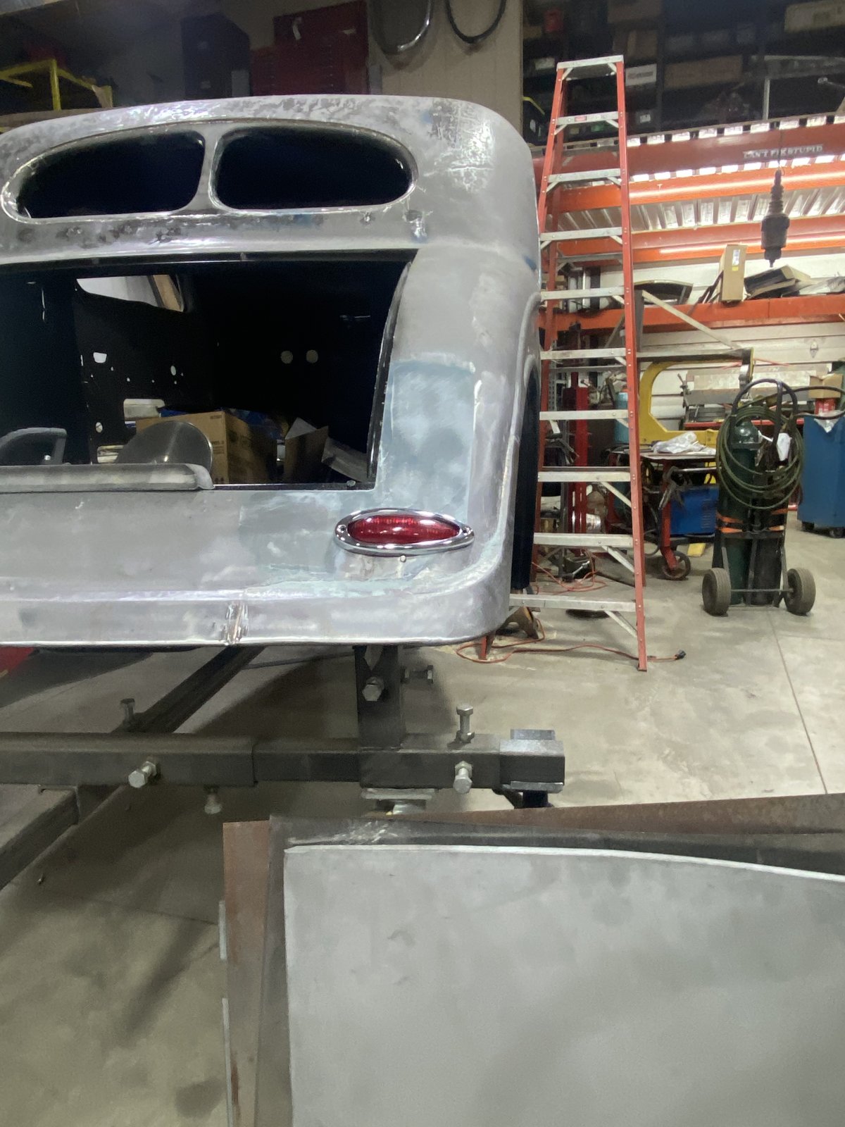

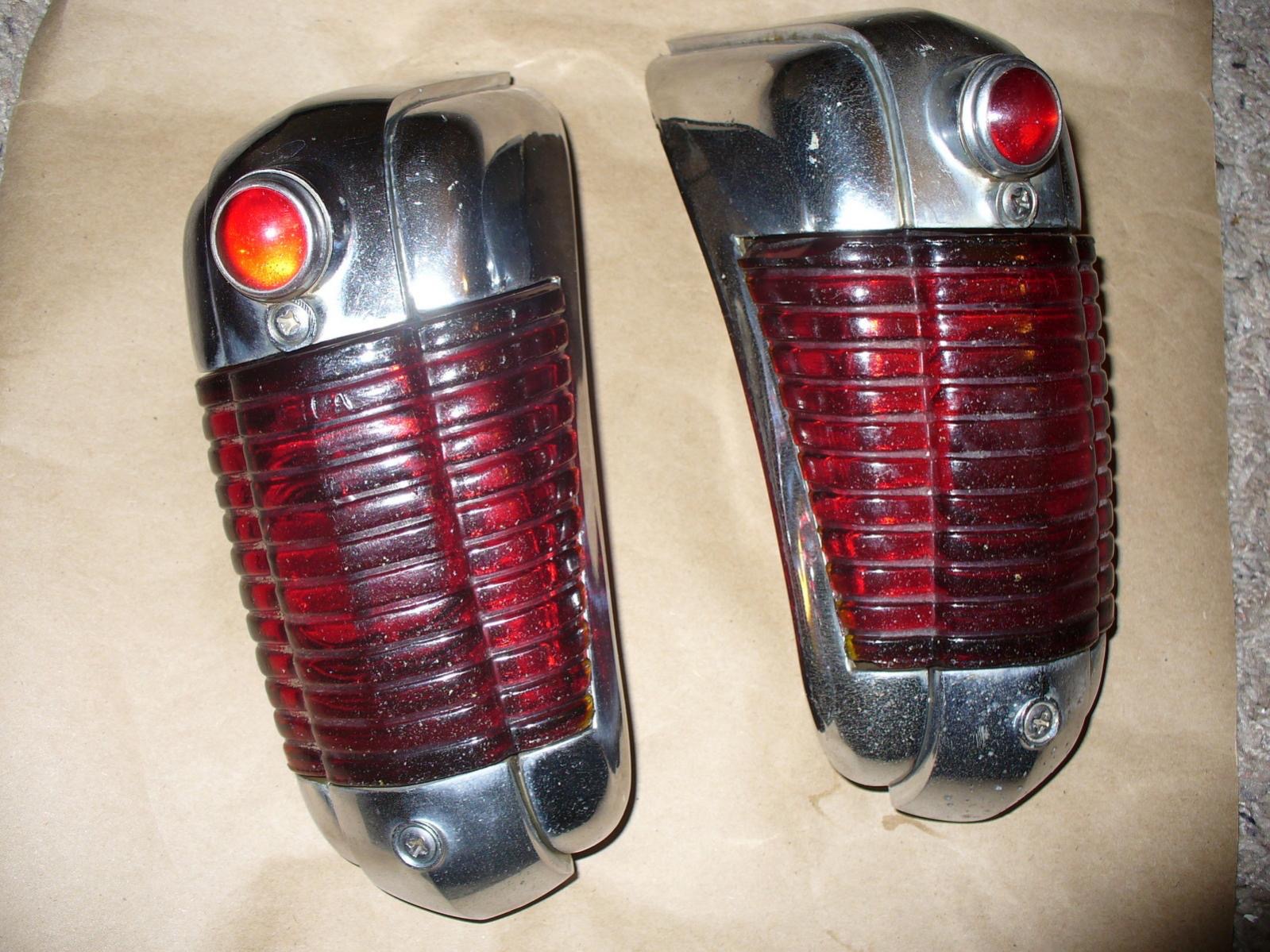

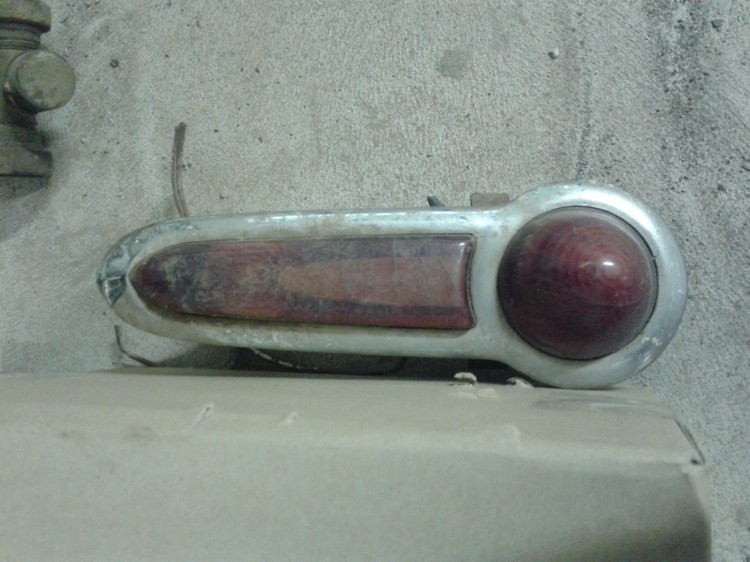

  15. Still haven’t found my damn motor mounts.

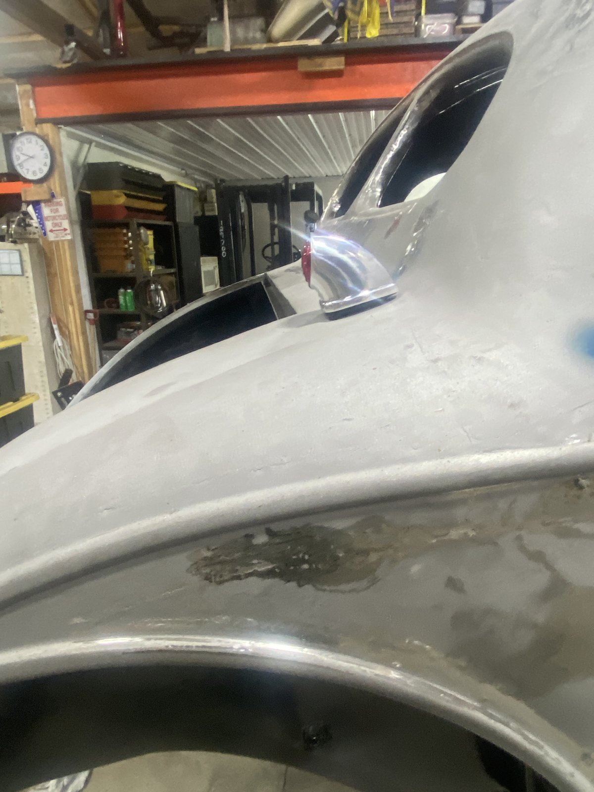

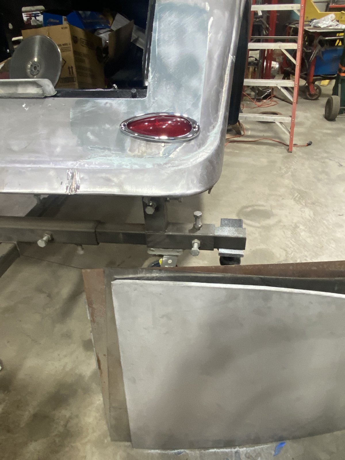

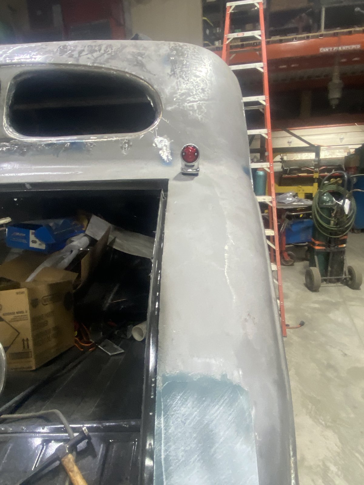

    But I think I decided on tail lights to play with.
    Fat in, fat out, little ones up high or not ?
    I’d rather not need the ones up high but they are more for the oblivious drivers than me. I won’t be looking at them lol.

  16. Johnny Gee

    Fat in no high ones.
  17. That’s what I like better too,
    and that’s opposite of original application.

  18. Fabber McGee
    Joined: Nov 22, 2013
    Posts: 1,438
    Fabber McGee
    Maybe tint the back windows a bit and put a little LED strip on the inside. Your car, but to my eyes the little elbow light is fugly.
    Joel W, brEad and 31Vicky with a hemi like this.
  19. Don’t do the “Cuban” brake lights .
    if your gonna do that you might as well of left the pipe , rivets , self tappers and 134567777 gallons of body on this doushe canoe .
    do a small strip of led lights in the bottom of the back glass .
    or insure it to high heaven and then hope you get rear ended …… it’s a joke . No , no , no .
    But you can get a bit more creative for additional tail lights
  20. Douche canoe - lmao
    Once I get the tail lights figured out and cut in I’m ready to get the bodywork and primer from the body line up and over the roof from tail pan to cowl.
    The elbow lights might become the reverse lights mounted under the body.
    I’ve got a set of those OT fleetwood 16” long pointy cadzilla lights. Everyone else likes them, they aren’t right for the car but man do they follow the body contour.

  21. Post a pic of the caddy lights against the body .
  22. I might get in trouble for that
    VANDENPLAS likes this.
  23. atch
    Joined: Sep 3, 2002
    Posts: 6,355
    atch
    Yep...

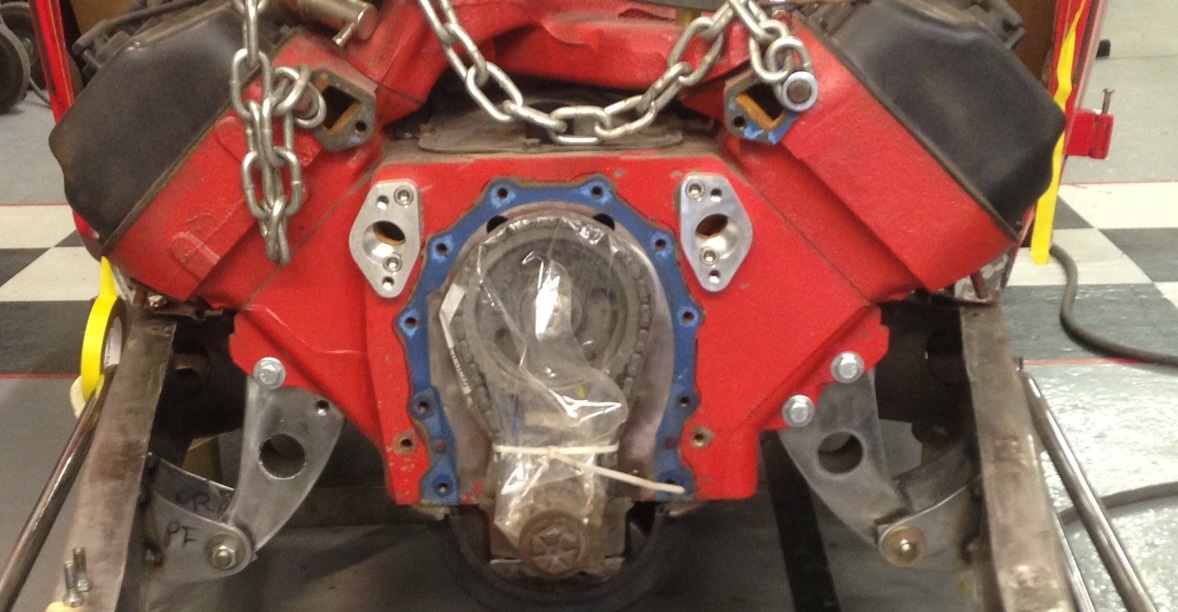

  27. Found the motor mounts this morning.
    I was like a little kid!

    How close was that box to everyday traffic? My misplaced stuff turns up with in arms reach most times.
    Stogy likes this.
  29. The box was tucked into a far corner on a high 6’ shelf. There was a clustered mess on the floor so really couldn’t get to the shelf.
