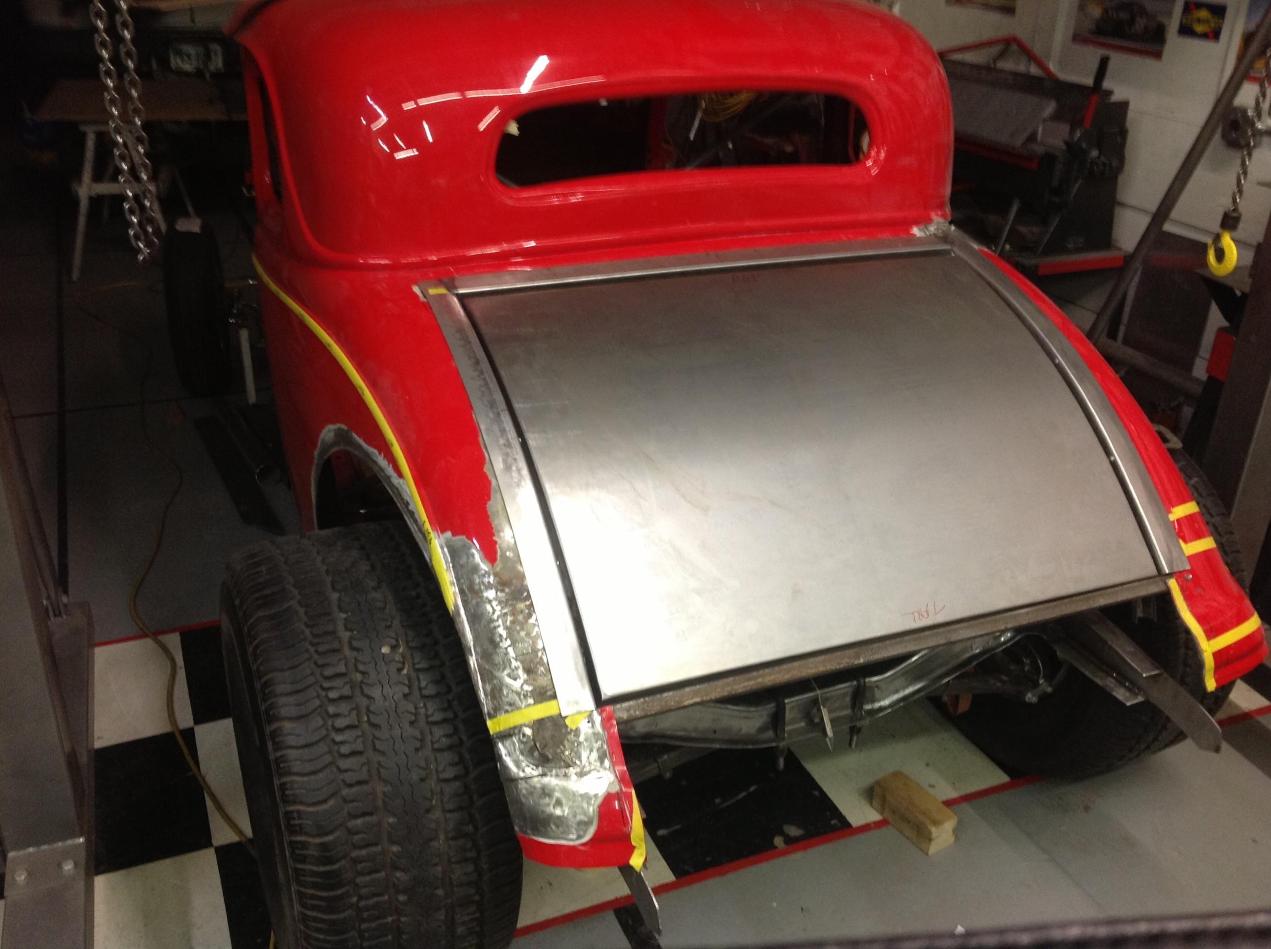

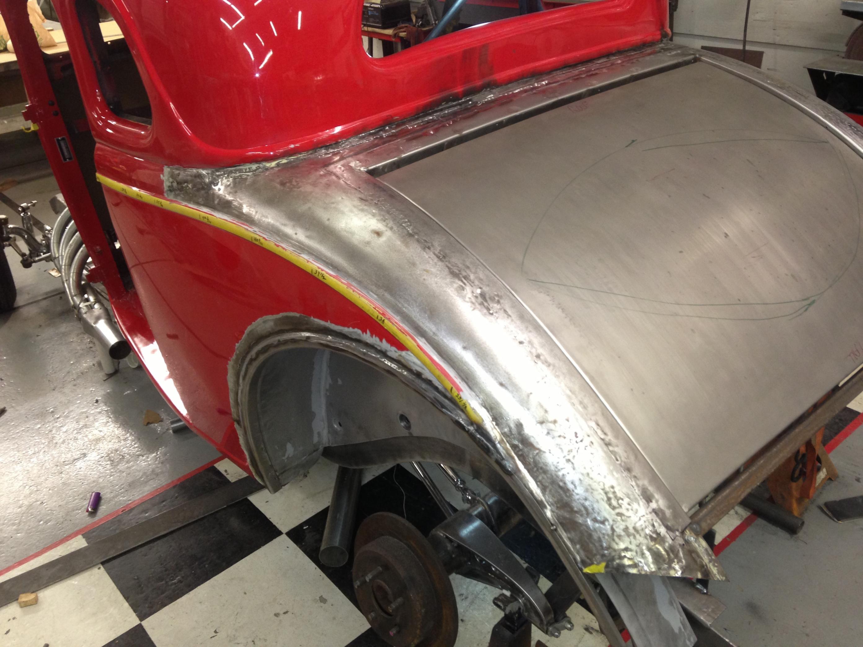

  1. Made all of this today.
    Drip gutters, trunk edges and the deck lid framing.
    Great forearm and hip workout.
    Where's the tequila ?

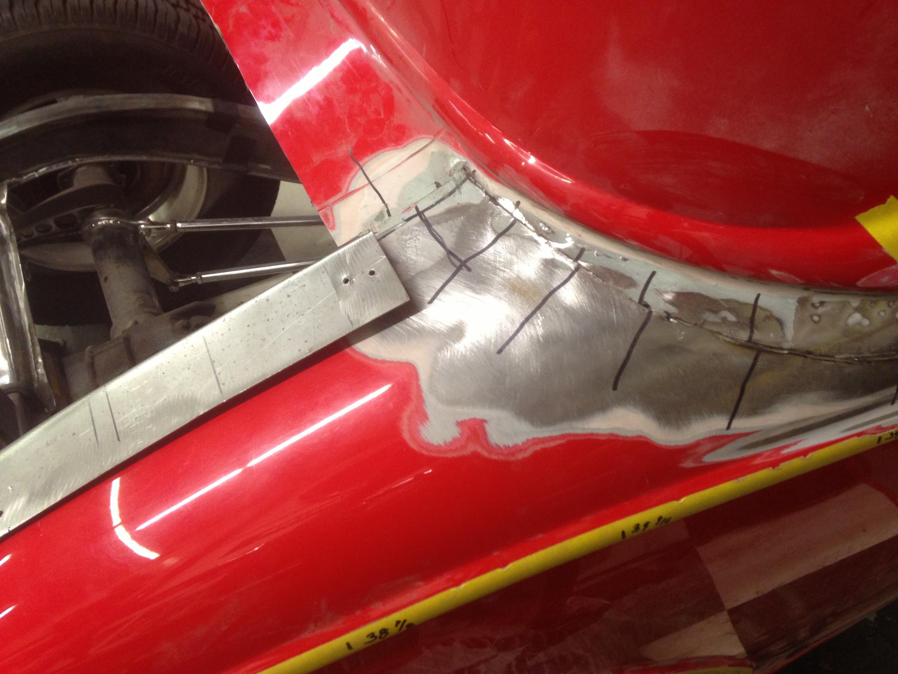

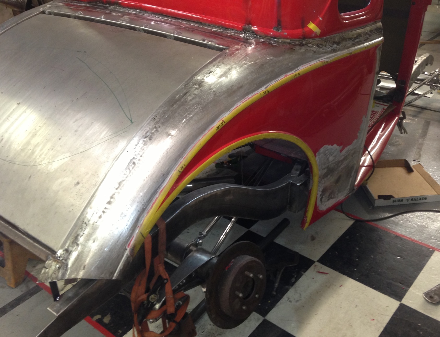

  2. Well I've pondered how this could have happened for over a week.
    I've measured everything 7 ways to Sunday with help. I knew what needed to be done but didnt want to do it or believe it. So i Called in some extra experience from 2 different gurus who confirmed my opinions. Nobody wanted to see this happen but I had to cut the quarter off.
    The witness marks show how far it was off. Needed to pivot 3/4 of an inch and slide forward about 3/8 of an inch and then jack rear corner of the roof up almost 1/2".
    It's amazing how much better everything fits but its just a infinitely frustrating event to grind off the body work and paint that was a significant part of the price of the project and the deciding factor to buy the project in the first place.
    I do believe my goal of rolling out in End of April/May for spring has gone down the ****ing tubes.
    I'm gonna get drunk tonight and weld this ****ing thing back together tomorrow.

  3. Nice huh ?

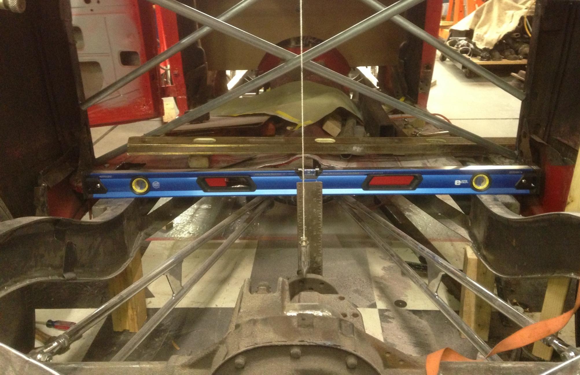

  11. Few steps backwards and everything is plumbed up right now.
    Amazing how much better everything looks.
    The quarter adjustment swung the *** end over onto center.
    Skooched the deck lid 5/8 up on one side and 5/8 down on the other, that made everything nice and centered and symmetrical off the door jambs.
    After that, needed to shift the body on my killer ch***is- 3/16 forward on one side and 3/16 back on the other. Hey now the engine doesn't look crooked anymore either. The rear window isn't kattywhomp***ed anymore.
    No compromise adjustments needed now.
    The difference between before and after is dramatic.

  14. Wound up needing this much pivot to get p***enger side to match the drivers.
    I'd say that's dramatic.

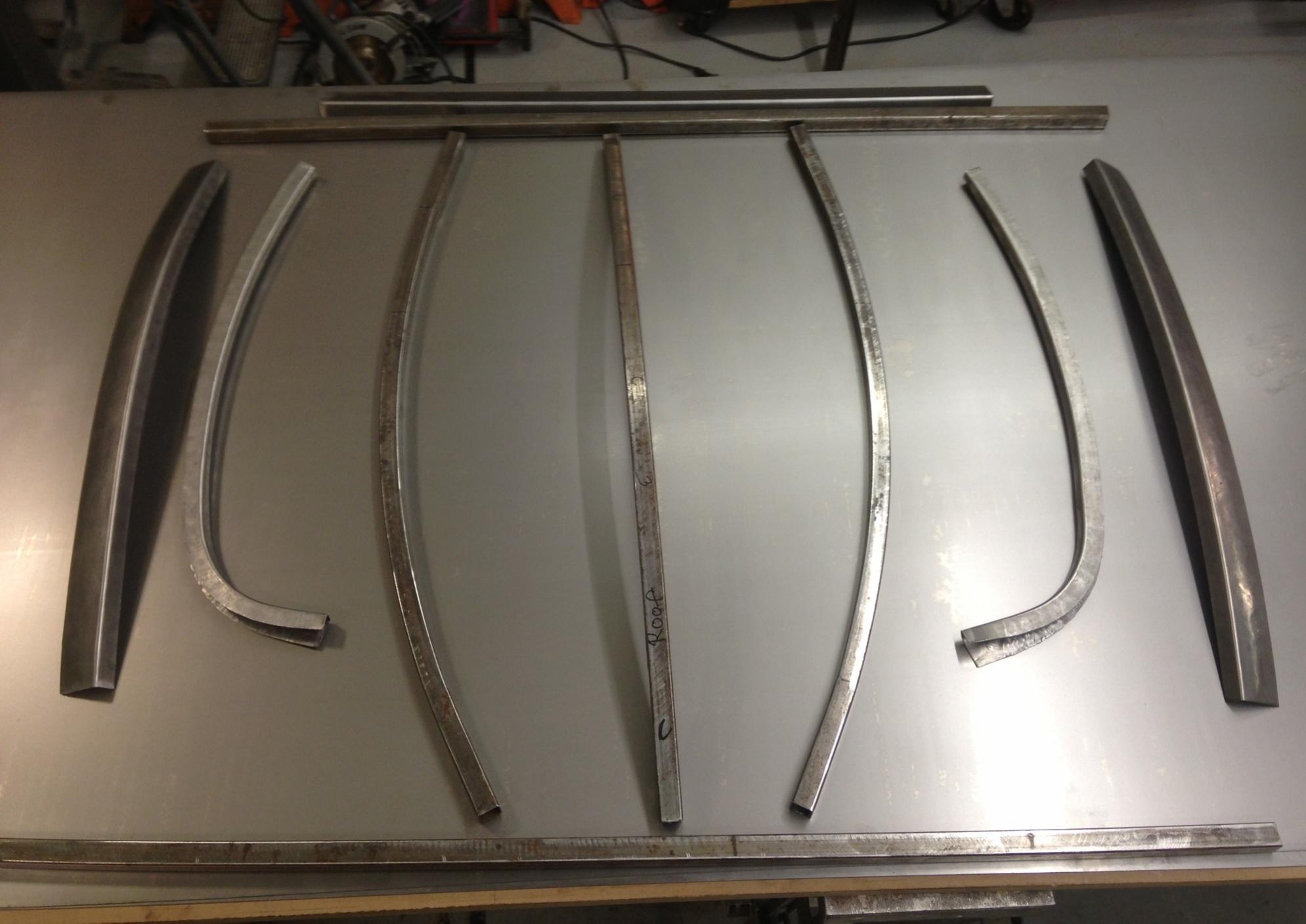

  17. Made the deck lid.
    Only difference is that this one is symmetrical and it fits.
    Some layout, box and pan break, shrinker, Wheel the crown into the center.
    It's a little more involved following the patterns but that's about it.
    Had to modify the shrinker stretcher stand to get it in there but that was pretty easy.

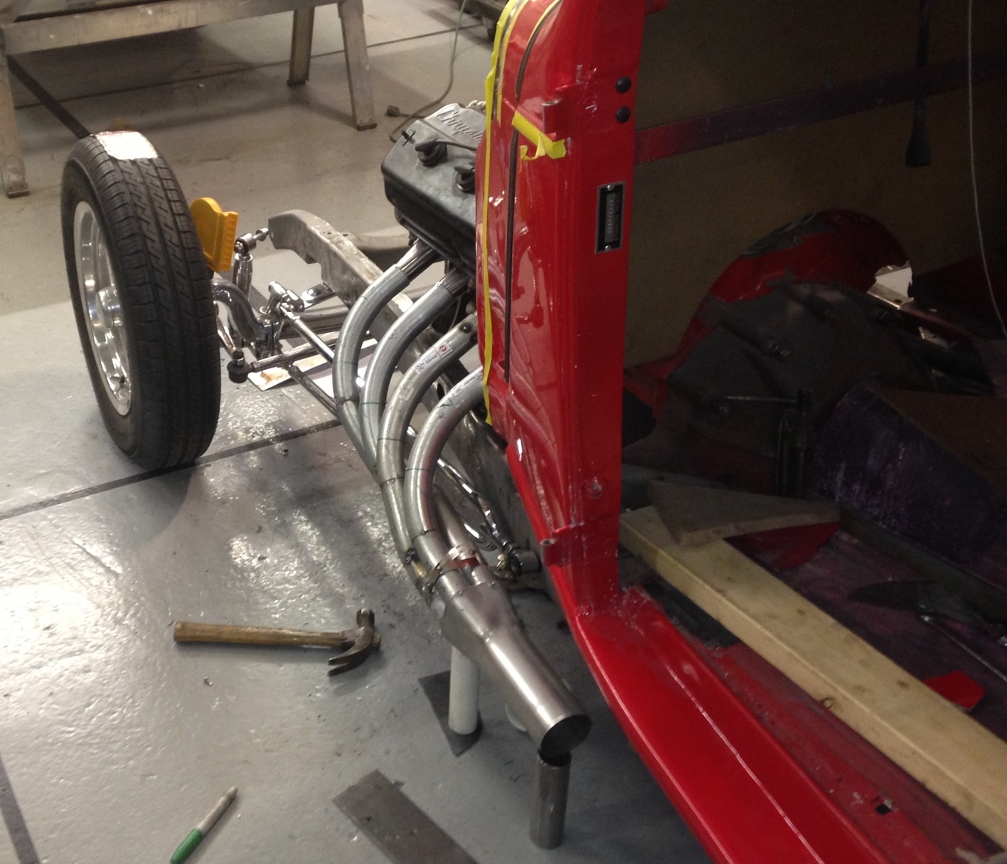

  22. Headers mocked up.
  23. I'm really digging them

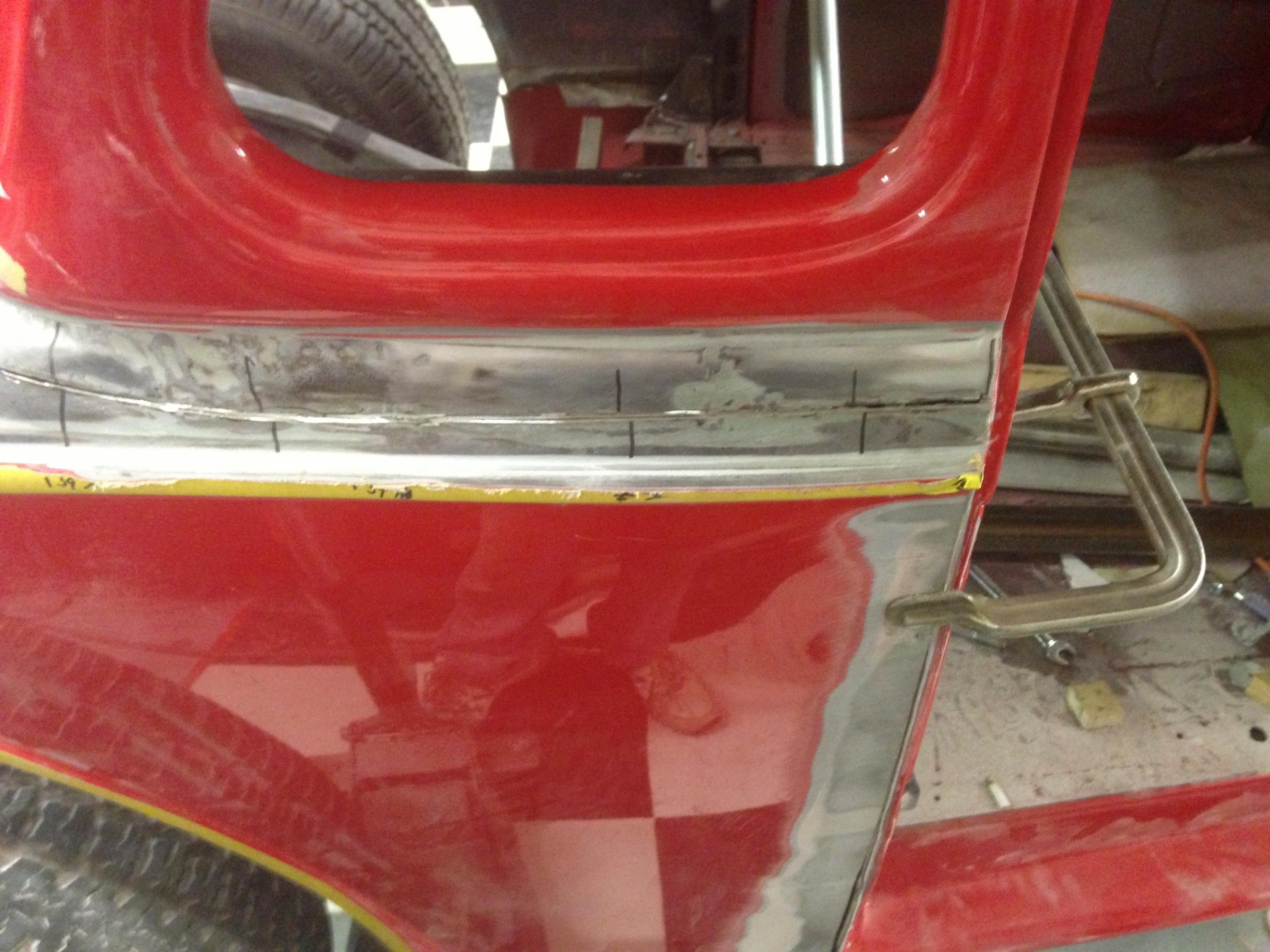

  24. Got the quarter all welded back up.

  26. Drip gutters too!:)
    All this kind of difficult to do because the *** end of the car was like a slinky with all that metal removed. Measuring was futile because the heater kicking on would move it around. Clamping one thing moved the other. It was a dance to get it all square and symmetrical for welding. Major setback but I think that hurdle has been cleared.
    My fab and forming, welding skills are dead on. I just wish I could get the metal finish up to the same level. I know there's guys who could smooth this out enough that a few coats of primer will be all that's needed.

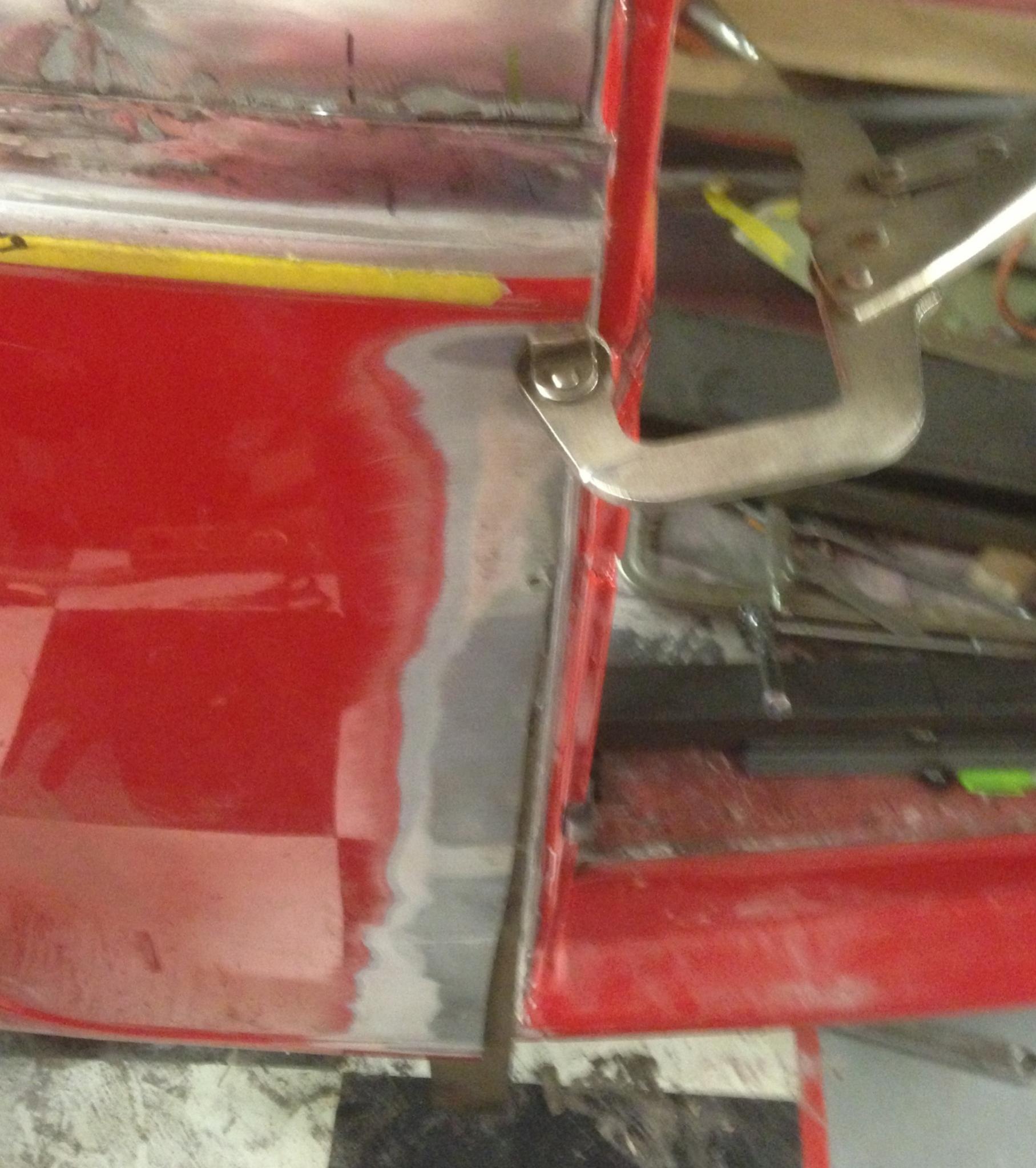

  29. And now we are here .
    Stripping the paintwork and bodywork.
    VANDENPLAS likes this.
  30. P***enger side is the same .
