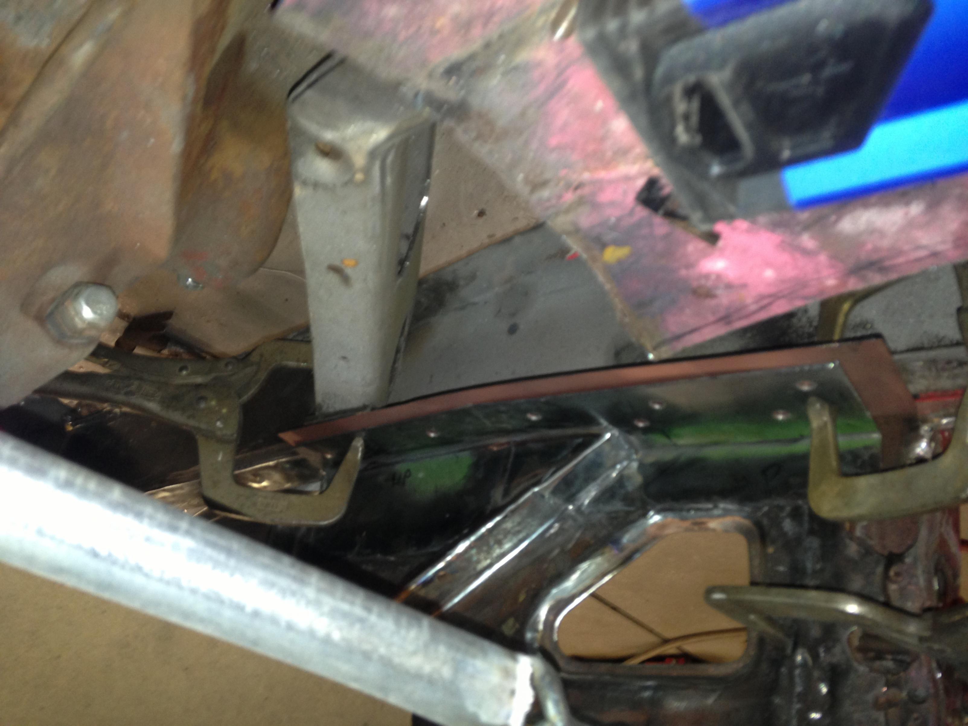

  4. See, when I was playing with the hinges, the rocker / door jamb developed a crack at the a pillar. Considering that's a structural point including the body mount and support for the cowl/ doors I figured I had better investigate. Well thru the mud, then the caulk filling the hole- what do I find? A pipe, a 36" long pipe that some how is tiring to hold the car together by the tinny br*** tack. Some further investigation revealed some engineer figures that the 35" long cantilever bearing on the 20 gauge pop rivetted to the inner rocker will do the job ! Brilliant !!! There was only 1 tack on the 36" pipe so it moved easily 3/8 to 1/2" back and forth. Thankfully the bondo and caulk were there to control that .

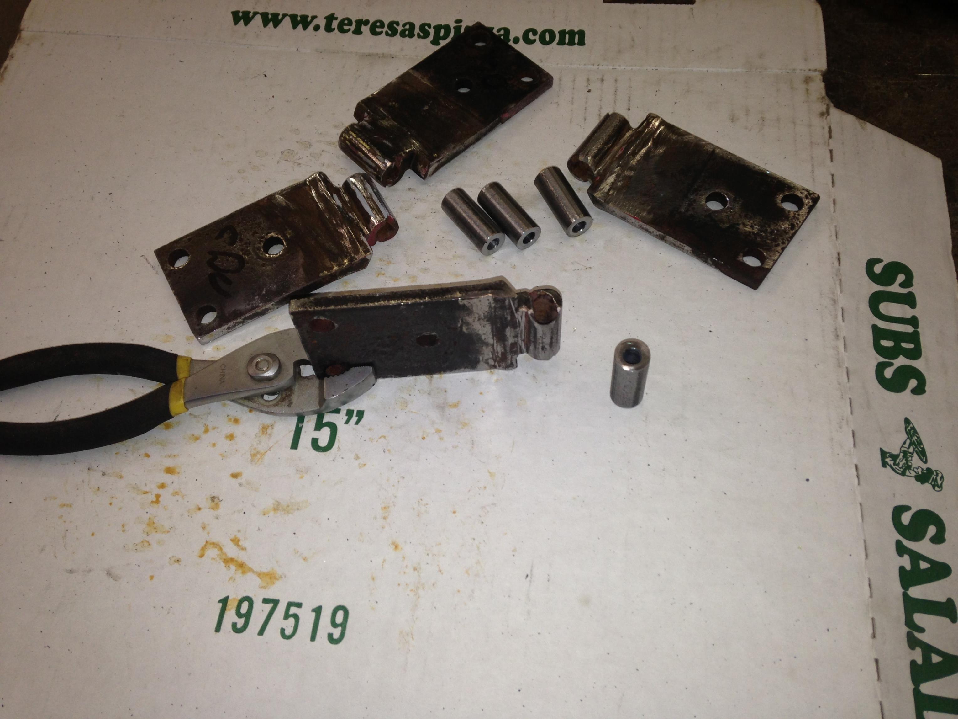

  7. The hinges were woorballed out, some more than others.
    Ball nose end Mill to remove old parts. Spun up the new ones.
    Welded them up. This worked extremely well.
    VANDENPLAS and Ric Dean like this.

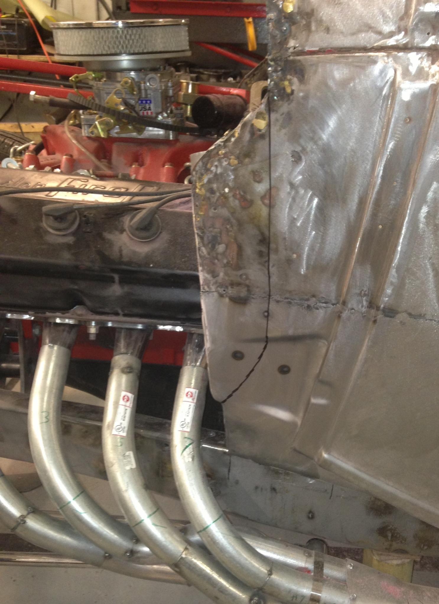

  8. Cowl foot-
    Tried 3 times to rotate this pic , sorry.

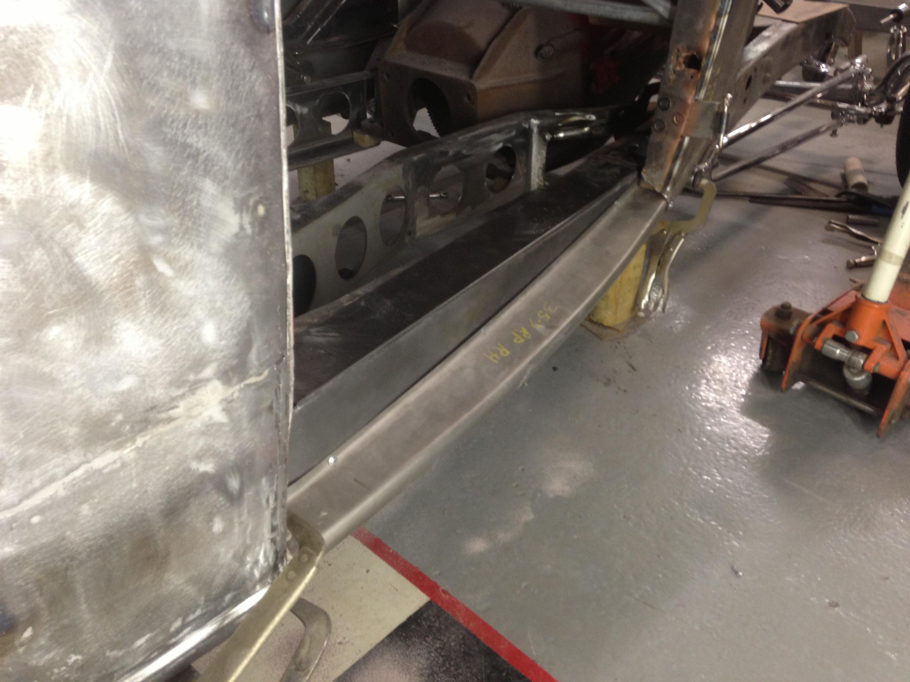

  9. image.jpg Rockers, inner rocker/subrail piece
    Before thumbnail & also see 153 -4
    After - nice, clean, simple and actually structurally quite strong. Almost like factory but with a little artistic interpretation. Ill finish the backside when the body comes off the frame, screws will come out after finish and final welding. Sorry that pic is so big, wow?
    VANDENPLAS likes this.

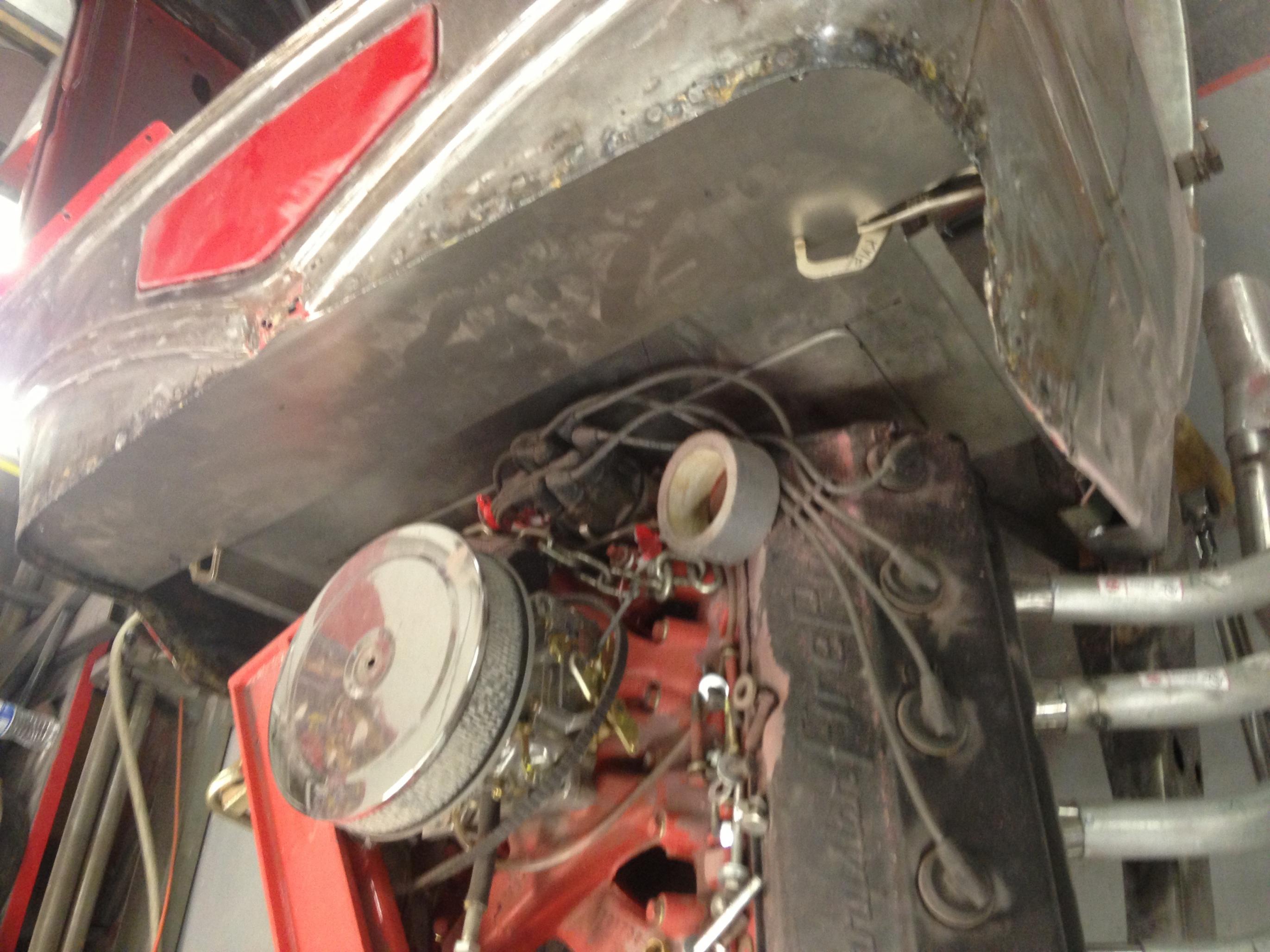

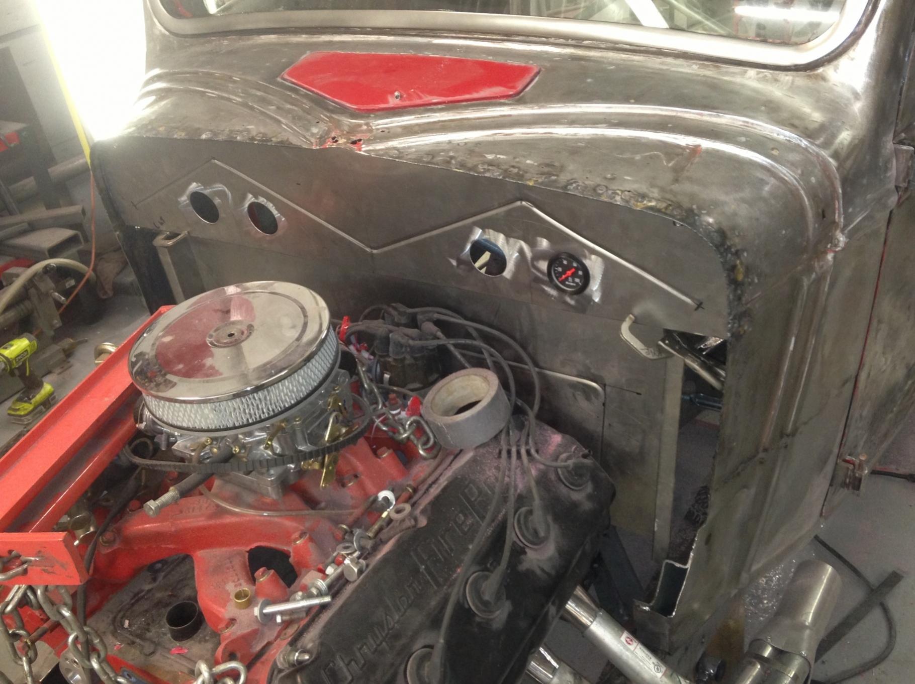

  12. Firewall started , well missing

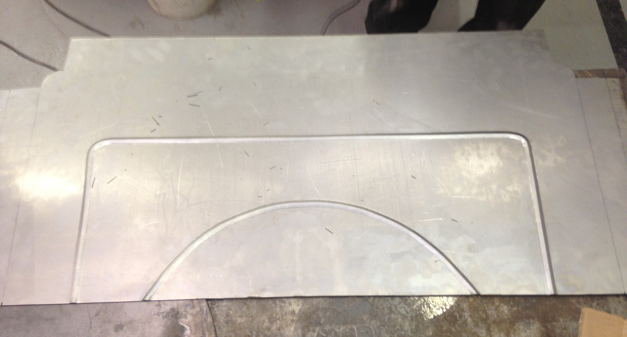

  13. The fire wall needs a recess for clearance.
    Some simple beads for strength before heading to the brake.
    The beads go in because I plan on covering the firewall with some very cool ribbed stainless.

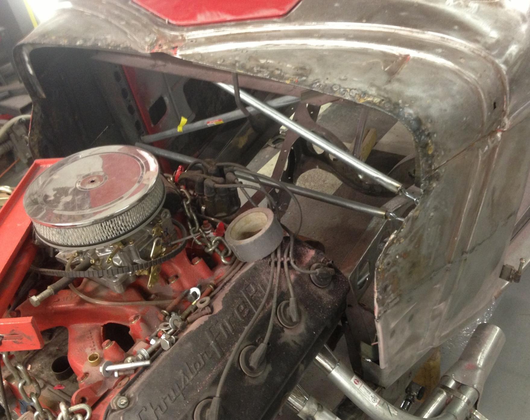

  14. Cowl sides need haircut .
  15. All trimmed up. Nice I like it.

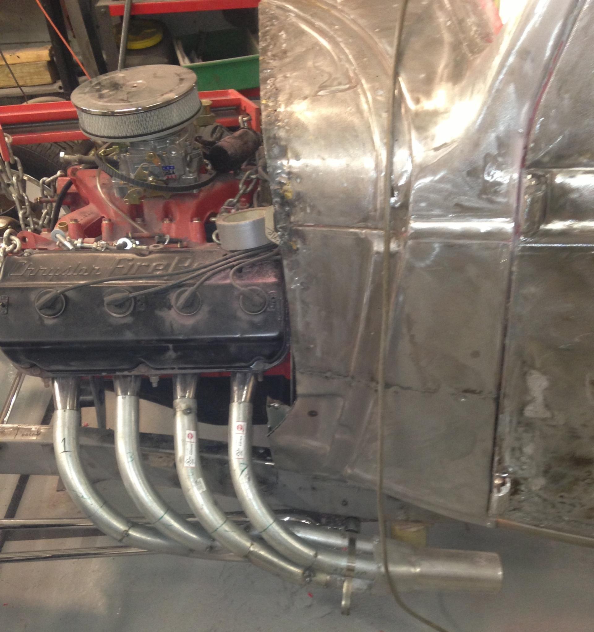

  16. Top section needs some beads and gauges.
    oliver westlund likes this.
  17. Got this headed in the right direction now.
  18. Almost done, thinking on an edge treatment
    oliver westlund and VANDENPLAS like this.

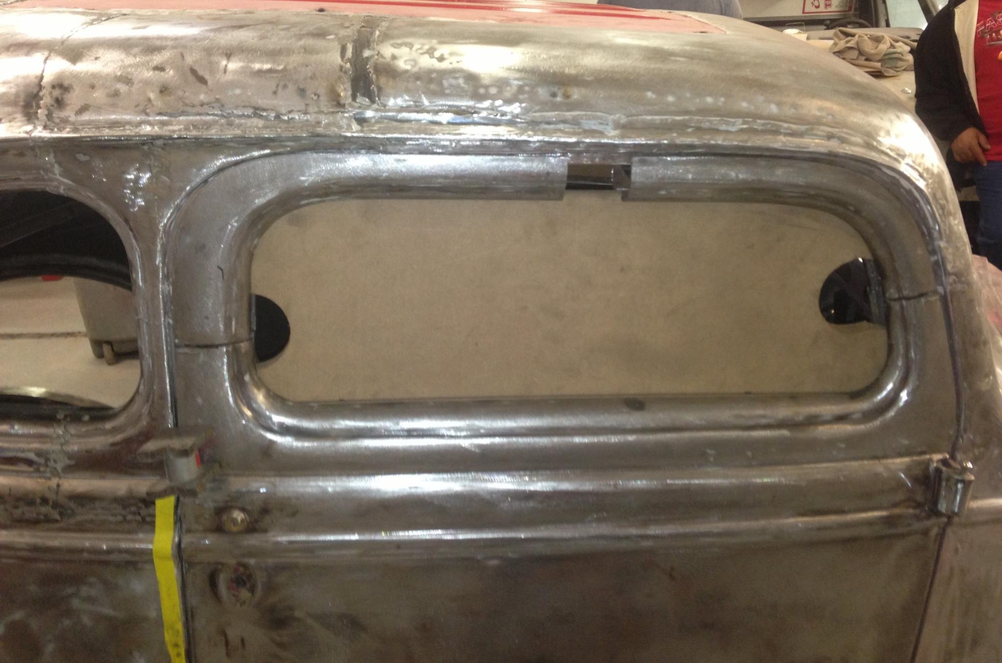

  19. image.jpg Now the cowl is done and the door hinges are fixed with the doors hung nice & straight. Being level to each other hanging off the cowl, the B pillars squared and locked down & everything is good up to the body line.
    This is where the real fun starts, fixing the chop.
    Now that the car is totally stripped of its prettyshinyexpencivesandedandrubbed red paint to bare metal, its easy to see that some stuff just can't stay the way it is. A tape measure would have been real handy here before hand, but who needs a tape measure when you can just "mud" it up right?
    The entire car will need to be cut back apart and put back together. Ill be doing it in sections to keep the disaster area under control while this goes on. The windshield posts are off- WAY OFF! The p***enger side post is back from the front 3/8 of an inch. This was masterfully disguised by a gallon of bondo on the post and inside the rusty windshield frame. Not all of it was rusty because some of it still had paint on it all nicely paved over with mud. I'm guessing that's where the first **** up was because the rest of the car was fudged to accommodate that. With that post off, the drivers side post is twisted and since the roof from windshield mid door was not altered the drivers side mid door roof takes a wicked left turn to meet the back and the p***enger side is sort of where its supposed to be, that is as long as the post remains misaligned.
    So how does one attempt to correct this? Man I don't know any other way that having every problem mapped out- then developing a plan so there are no double work projects. I started with the doors. I figured its about the best place to get an idea of where the hell the roof and upper B pillar wants to be because they can't stay where the hell they are now. Geeze !!!
    I cut the doo tops off and made a buck out of 3/4" mdf to fit in the window channel. Lined up everything off of the inside and glory be- a pretty damn straight door appeared from the dogs hind leg corkscrew mess. I guess you can polish a Turd or make a silk purse from a sows ear. HAA! The door planes excellent now instead of needing 1/4 of mud to not look and like a roller coaster. I also made both doors identical vs their former condition.
    The drivers side door was the worse of the two. The drivers door was about 1/8" shorter that the p***enger side at the front, and it was 1/8 shorter in height at the rear than the front. So a 1/4" at the rear vs p***enger. The pieces needed some shims to help hold the alignment due to the torturous twisting needed to get the thing welded the first time.
  20. This one didnt need shims to push the twists out of the pieces, just cut and realigned on the buck. it was relatively the same height front and back just a little *****.
