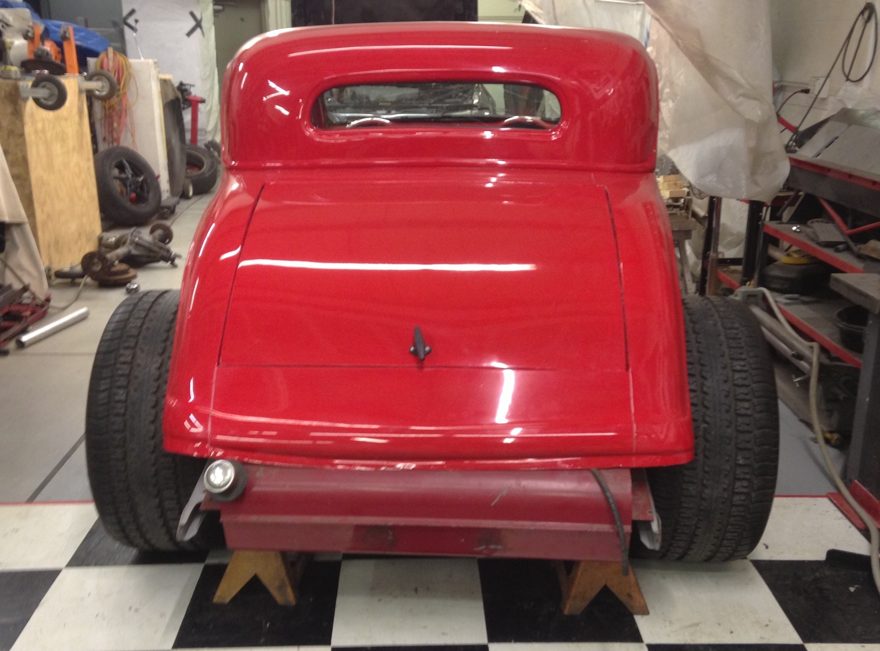

  1. It's a tough call, I like them 2" channel and 2" chop, but that's me. Nothing crazy but just enough to knock the ugly off. About all you can find is uncut or radical chops.
    In that photo , with that stance if the grill is aligned as if with a hood, the grill chin is 4" under the pavement. Some guys like them like that ? I believe that every lowering trick known was used on that one. If one is good 2 is better thinking. Just that some don't compliment each other and actually cause problems when commingled. The channel is also wedged, almost 8 in front and about 5 in the rear.

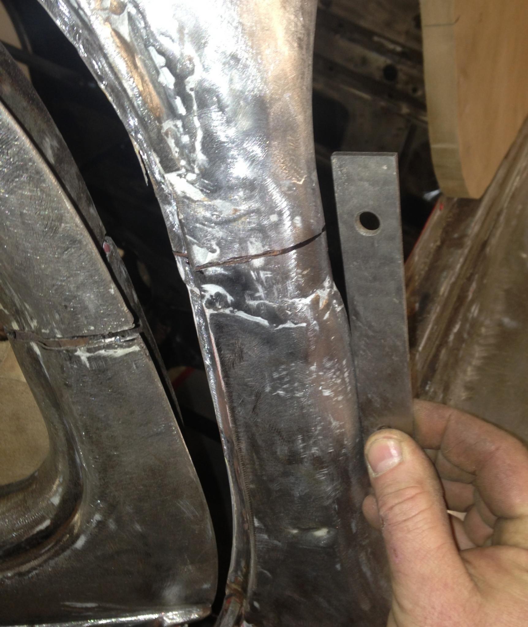

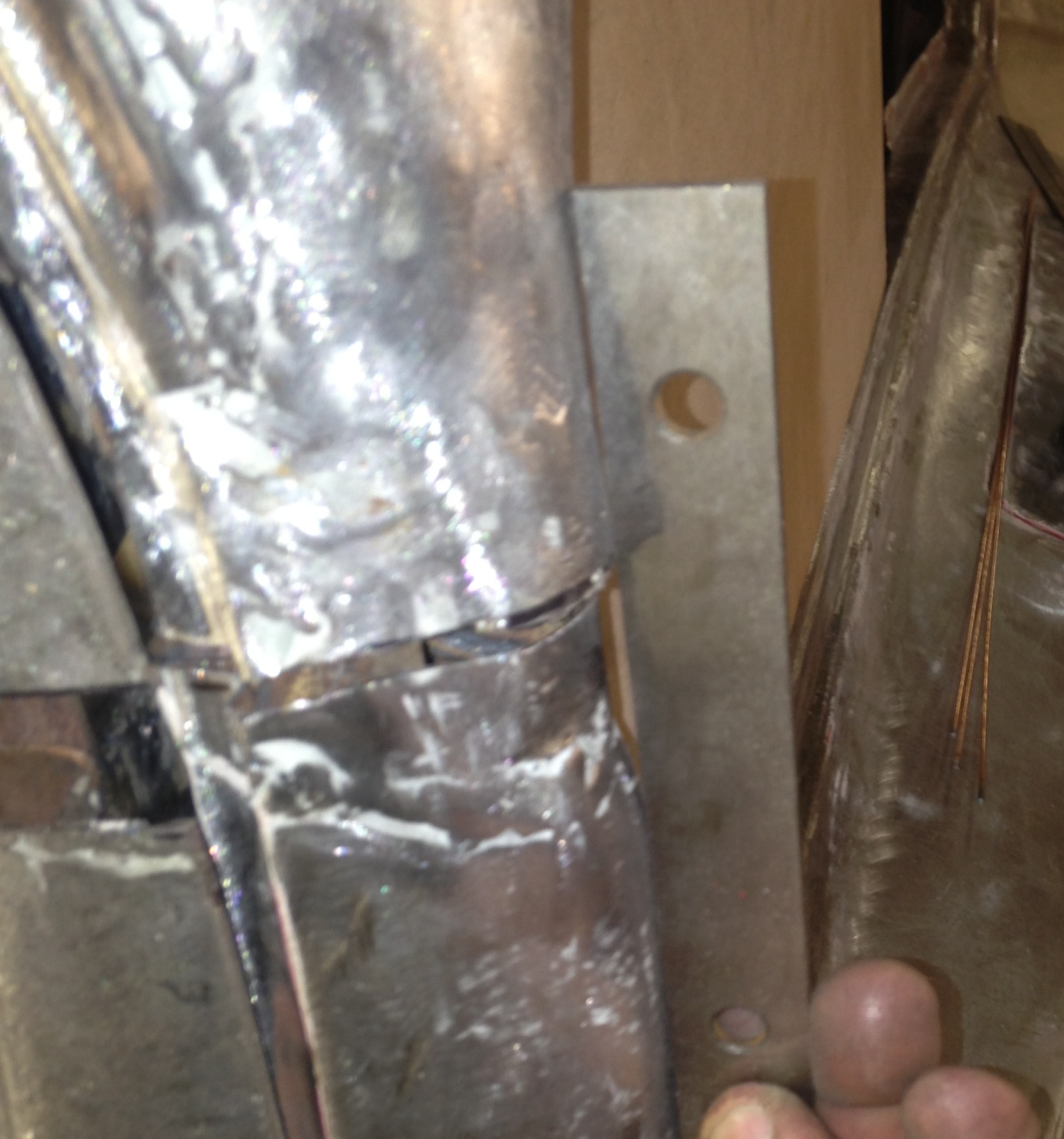

  2. So here is the passenger side post before the cut.
    There's another piece in between the windshield and and cowl sections too, about an inch long.
    It's not been welded so right now the plan is to open the skin back, properly weld the roof portion of the structure cowl section and probably make a new skin over the posts.
  3. Here it is after the cut. The metal was pinching the saw blade and this was a rough cut to make. But after it was cut in two, it jumped about just as much the other way. You could hear the car go aaaaahhh! So, I had to remove the cowl foot shims at the front I put in to get the doors aligned. With the cowl bolted to the frame, the post is almost where it needs to be and the door is really close at the B pillars. I think a hinge twerk will do it. The windshield opening was very hard to get an accurate measurement on, but we could tell the drivers side was higher. So make a sanded to fit MDF template of the drivers side and see if it fits in the passenger side. Nope, about 1/4" shorter. Once the post was cut - the Mdf drivers side template was put in the passenger side to get an identical opening. Part of the problem is that the original cuts were not made at equal heights. That's very very important for reasons that may not be obvious at the moment but they show up later. Wait till you see the back window!! Geeze

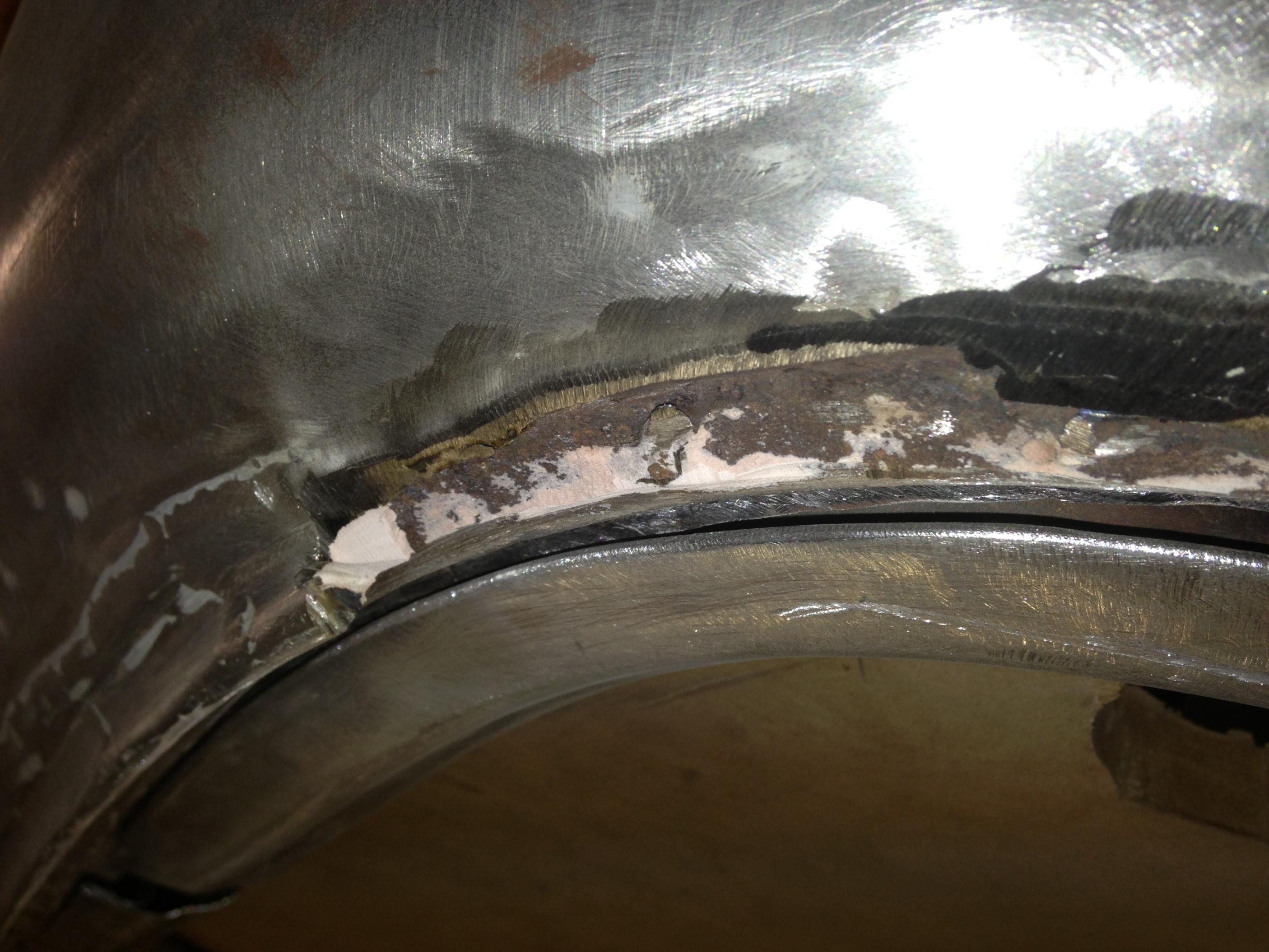

    So there's nasty flakey loose rust that you don't bother to even blow the loose shit off that was left after removing the rain gutter. Then hang a 1/4 rod way to far out there off of some crude hammered crap. The next logical thing to do is fill (try too anyway) that void with mud up against the flakey rust.

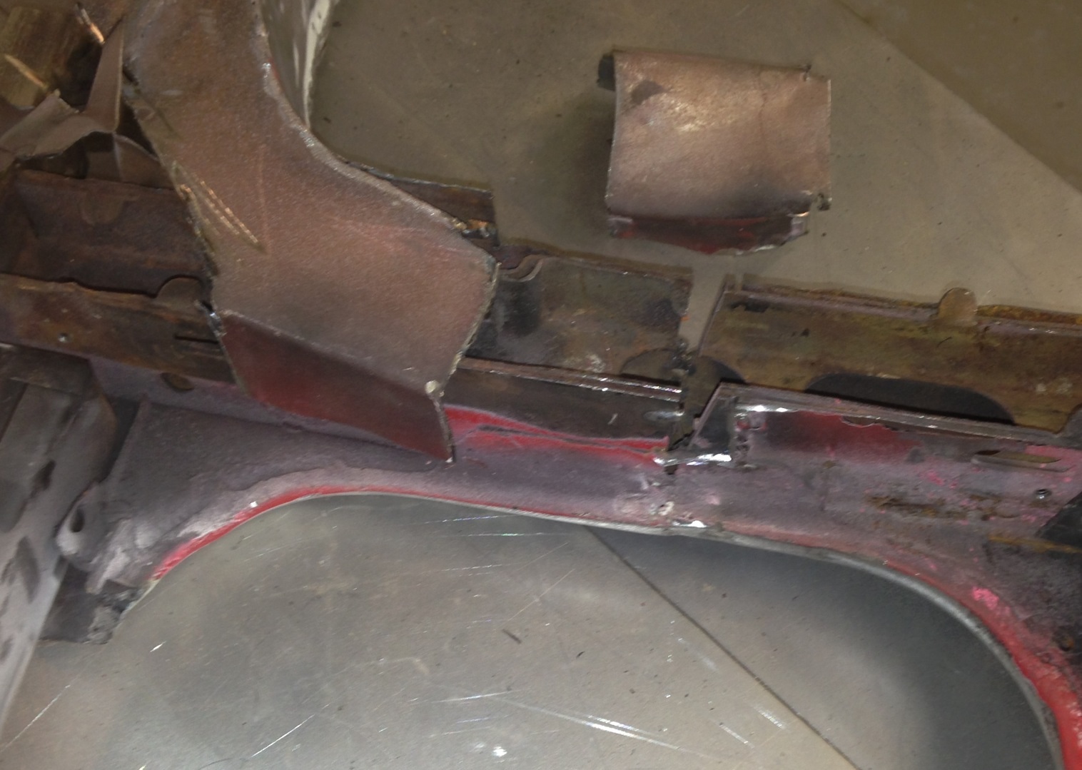

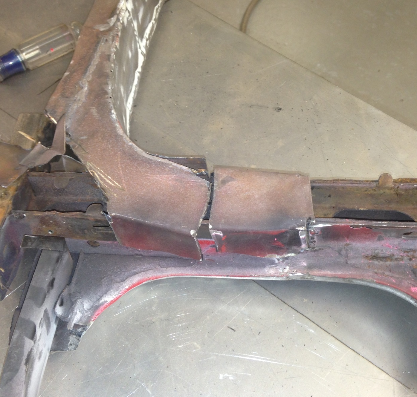

  7. This is how the Chopped B pillar was put back together. Weld the outer skin together (poor fit up on that too!) and leave a gaping hole/disconnect in the structure, then wrap it with a crudely formed piece of 22 gauge door jamb fixer piece.
    Welding at least some of this major structure would have been Soooo easy to get 50-75% of welded back together. Quite A bit more work to get it 100% welded but wrapping (covering it up from view or concealing it) with a piece of 22 gauge spot welded on? Good thing because I was going to let my Mom drive this .

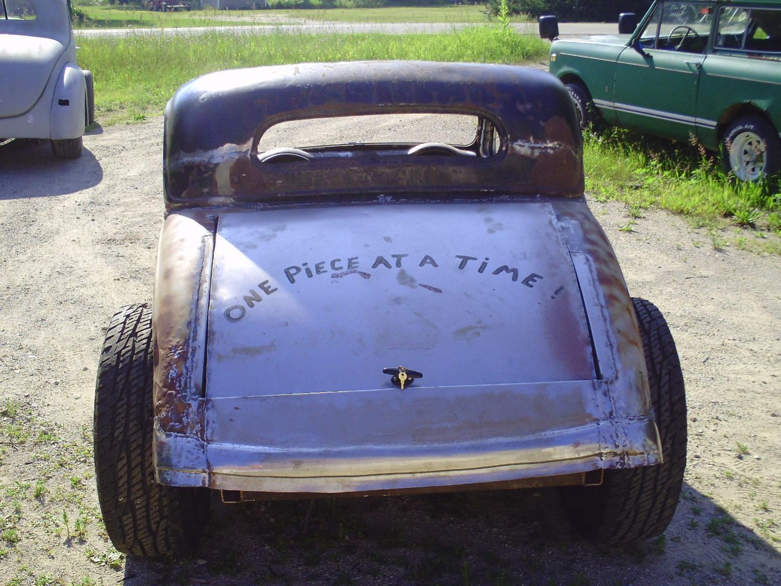

    i have 31 buick coup [future project] i nick named "clint" because there appears to have been 3 types of body work done in the past; the good, the bad and the ugly.
  9. Yeah - consistent ? Not really because there were clearly two different types of fab and metal work. Crappy and then really shitty and the two changed sides as they worked together. Ive been watching for something of better quality metal work , something at least "half assed" here but not yet found. The bondo sculpting was pretty damn good, the fine detail body work was lacking and the paint work was exceptional. So what's kinda nick name you got for that one? I'm trying to laugh but its still hard.

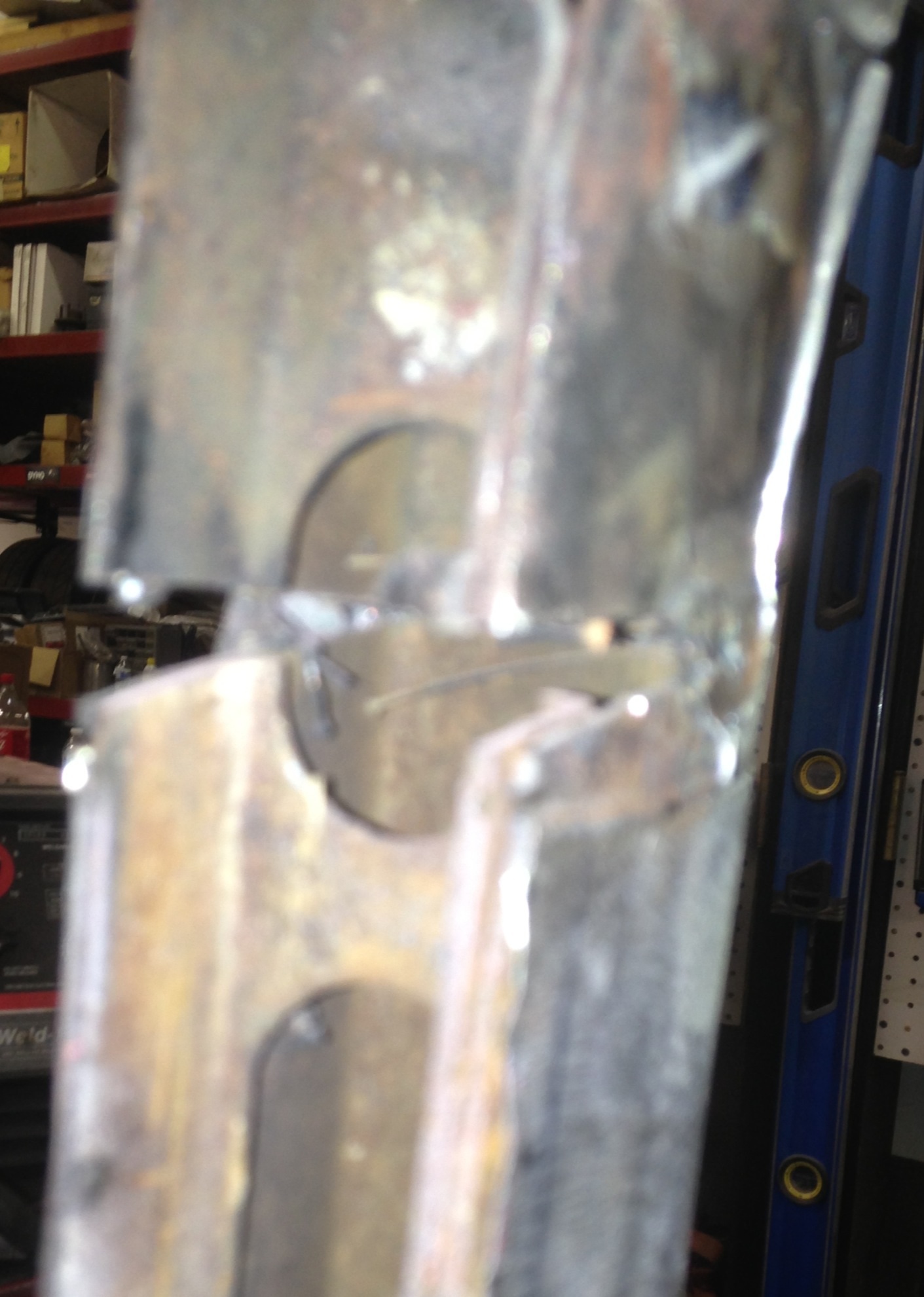

  10. So here's what I mean by "concealed from view"
    After the prying its a little contorted.
  11. And then ...
    I mean it- why the hell wouldn't someone weld this up? It's right fucking there. I suppose its just a B pillar right and the skin will hold it :confused:
    "Buyer beware" is one thing but this is really pissing me off.:mad:

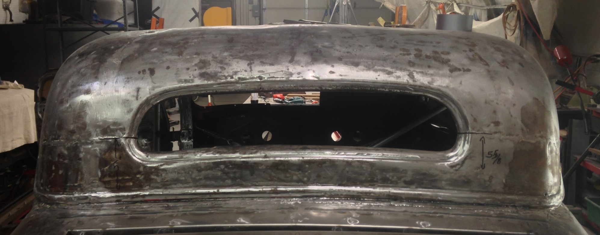

  16. Here's the back window I mentioned earlier.
    Just for reference- the grid lines of the camera view finder were dead nuts level with the garage door bracing.
    Cut at 5" up from the bead on one side and 5-5/8 on the other.
    Look how screwy that makes that opening look. It really crowds the drivers side lower corner too. imagine the mud needed to straighten that out!! It was sculted really well too. All the "brown patches" is rust thats has now been wire brushed and that was under the new bodywork and deep bondo first hold very well to rust. The shiny parts are where the steel had paint and primer stuck to it also under the deep bondo. The top part of the window opening is like Swiss cheesed tinfoil, at least that had a little bit of duraglass.

  18. This pic is from the build pics I got, apparently the mud was being mixed while the pic was being taken because what you see here is the surface prep I found under the mud.
  19. All that crap hiding under this.
