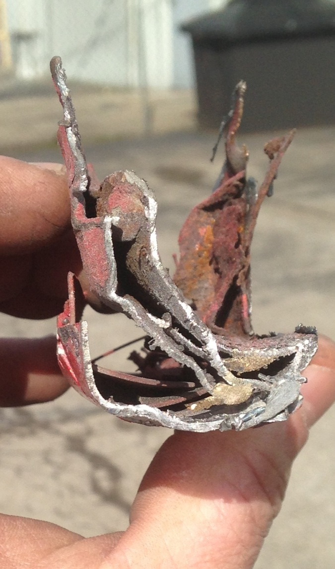

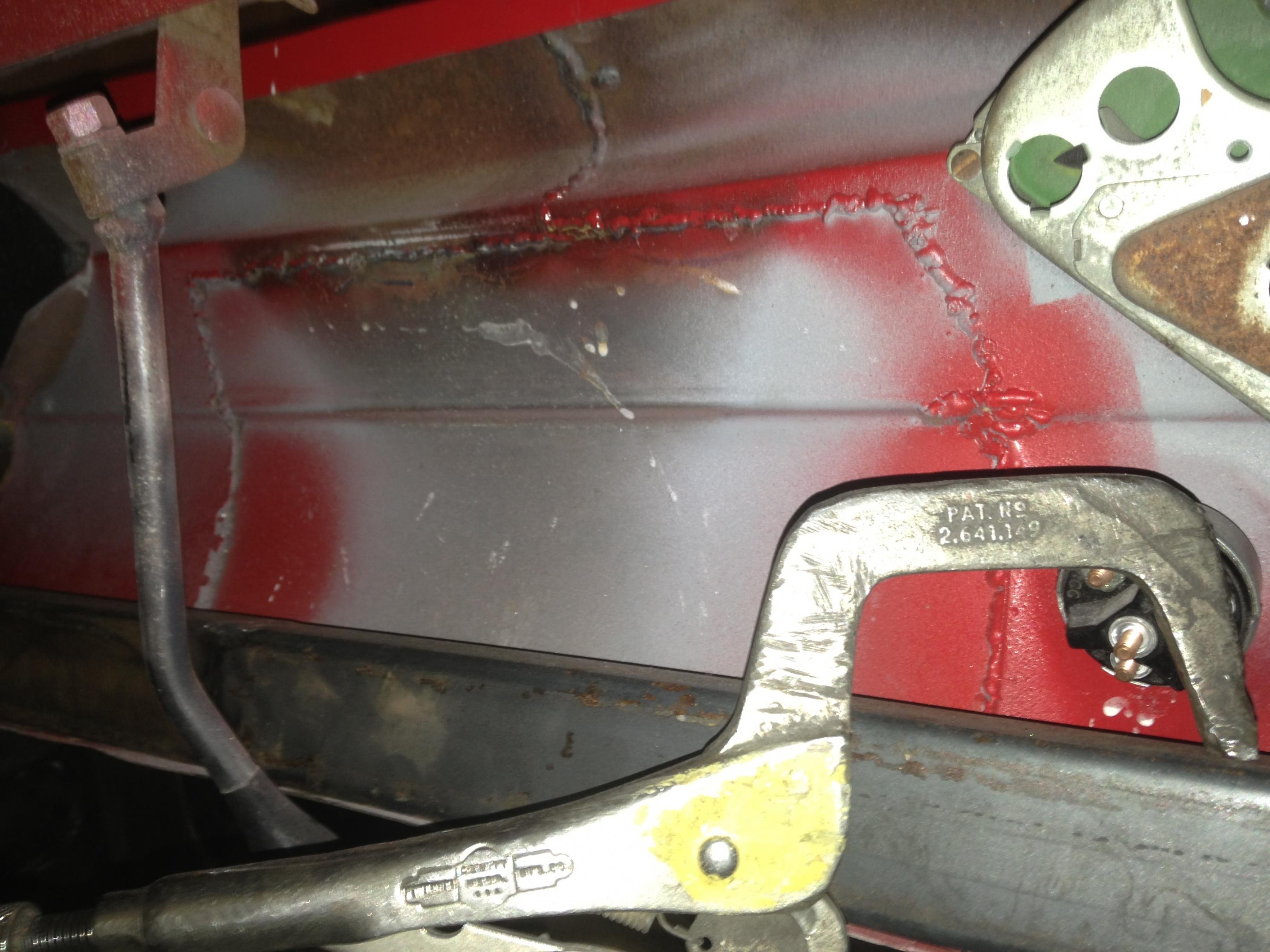

    Here's a section of the lower cowl. It's hard to say what what here, but there's 7 "layers" or individual pieces here.

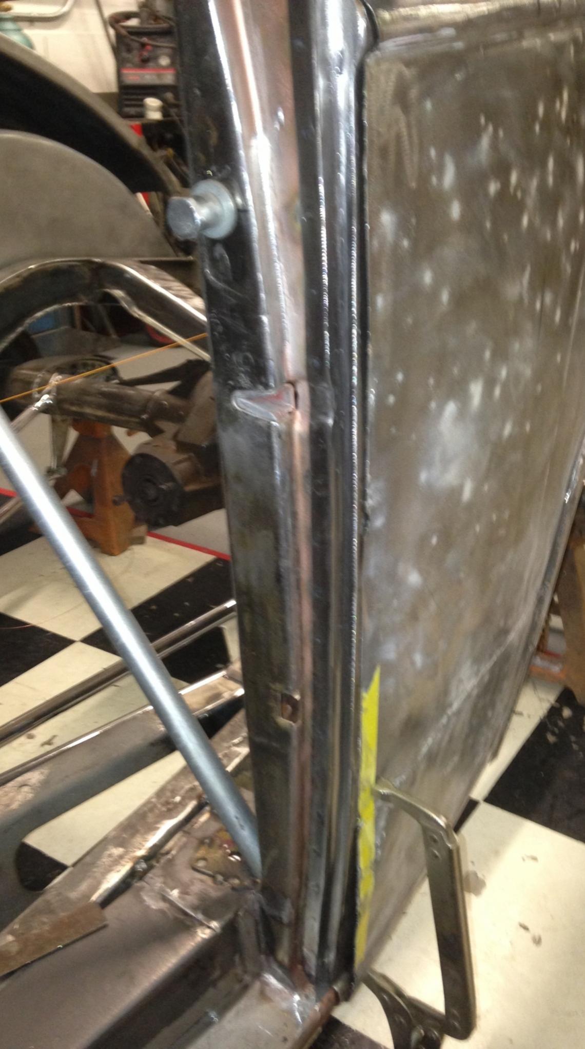

  16. Turned the corner today, actually tacked some of the car back together !!! I'm pretty stoked about that, it's a milestone on fixing this mess.
    I got some door jambs from Colorado and had to rework them, m***age them, and clean them up. They needed the strikers removed and plated for bear claws, the dove tail receivers removed and rebuilt reinstalled , the jamb feet replaced because the guy i got them from cut everything off. then Chop and Fit them to the doors, then align everything. Ran center strings and made sure everything was square, plumb leveled, and symmetrical. Also made some 8' contour gauges and used those the set the jamb/B pillar. Since the doors have a curve, its pretty important that the curve doesn't p*** the apex and dive into the rear quarters, then back out.
    Then Packing that dip with mud -That's was the case originally. To do this the B pillars needed to move away from center about 2" or 1" on each side. This is further than stock in the original application and further than when I found them. Now I have to re-make new frame mounts but that shouldn't be too bad.
    Now I actually have really really nice door gaps that are straight. imagine that, some wouldn't have thought it was possible. All that took was a tape measure, a piece of string and the slightest amout of attention. Funny thing is there was no forceing of any part of the car. Once the cowl was squared everything fell right into place. It was almost scary.

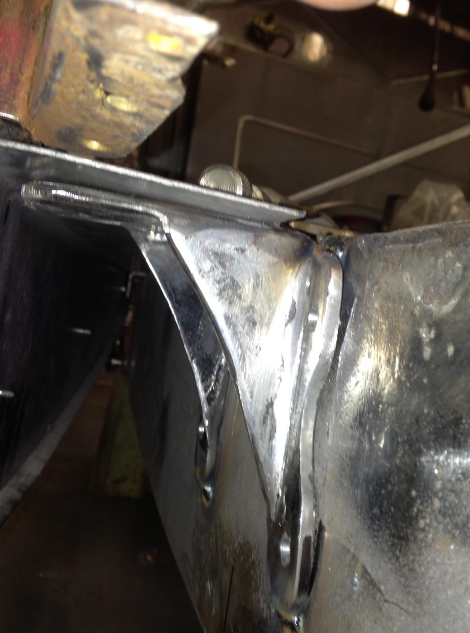

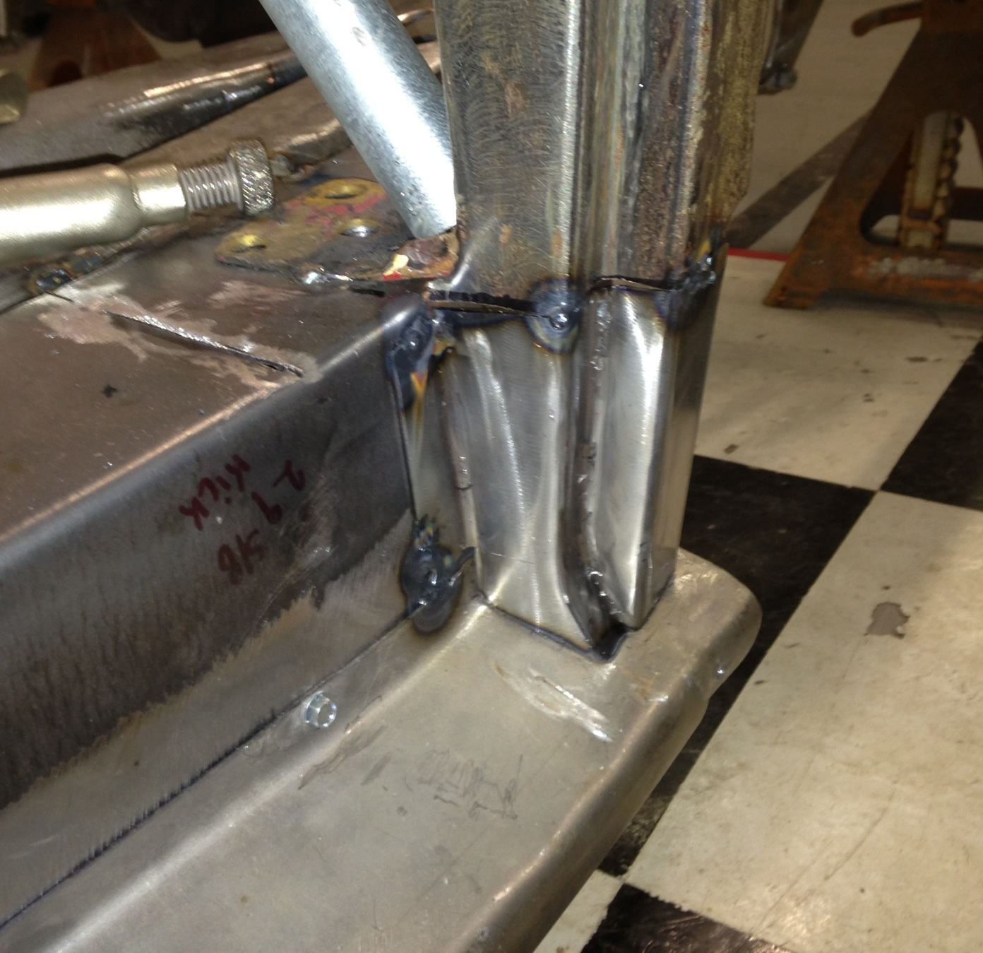

  21. Had to take care of some little stuff before heading to the next step. Sort of completing the previous one. Time consuming with little progress but very important.
    First was remove and modify the frame mounts,then get them back in.

  22. Make the little feet on the bottom of the door jambs where the rockers meet up. X 2.
    The jambs I got from Colorado had nice everything but these feet.
    To me: its some of these little details that really make or break a car.

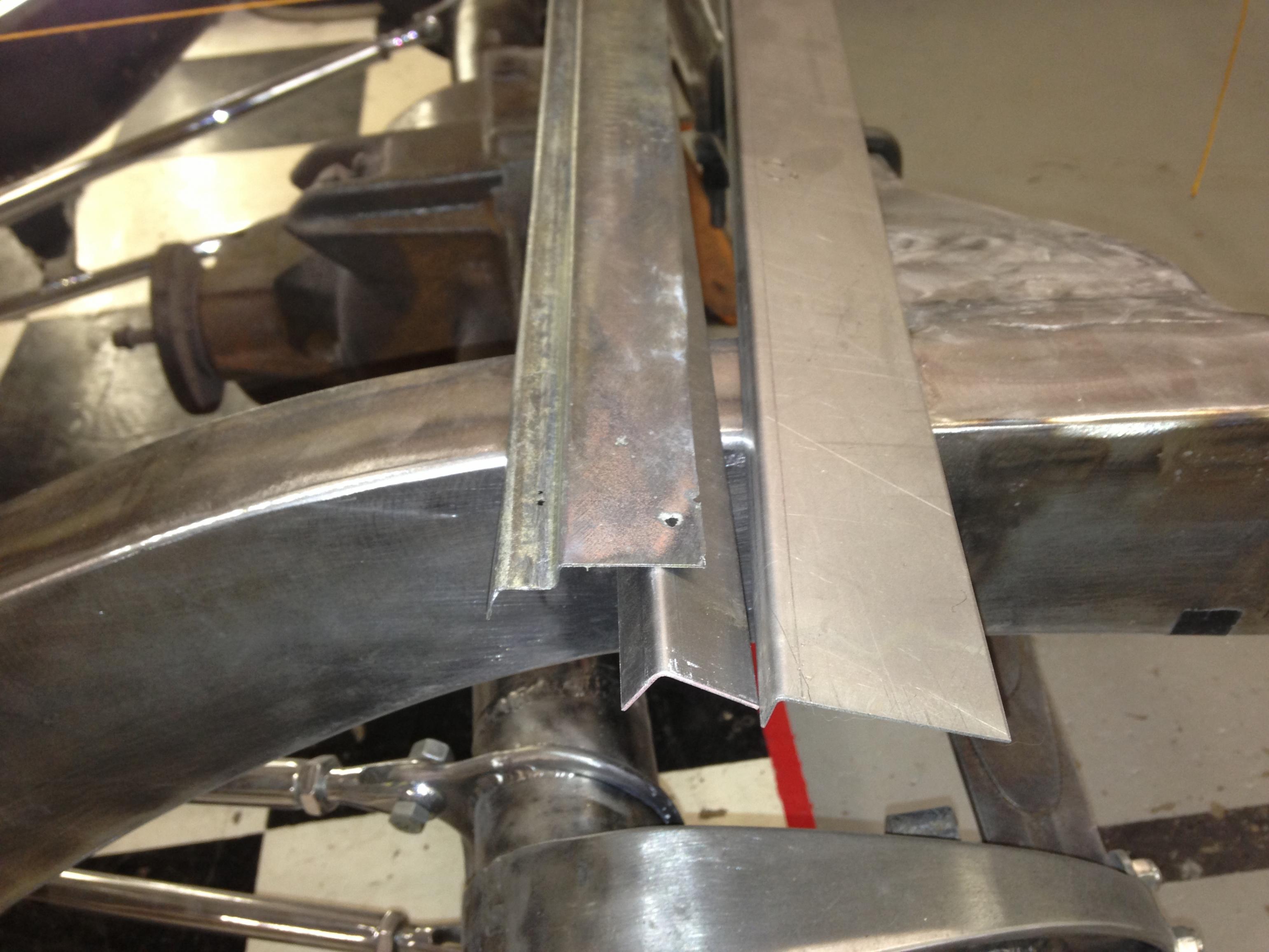

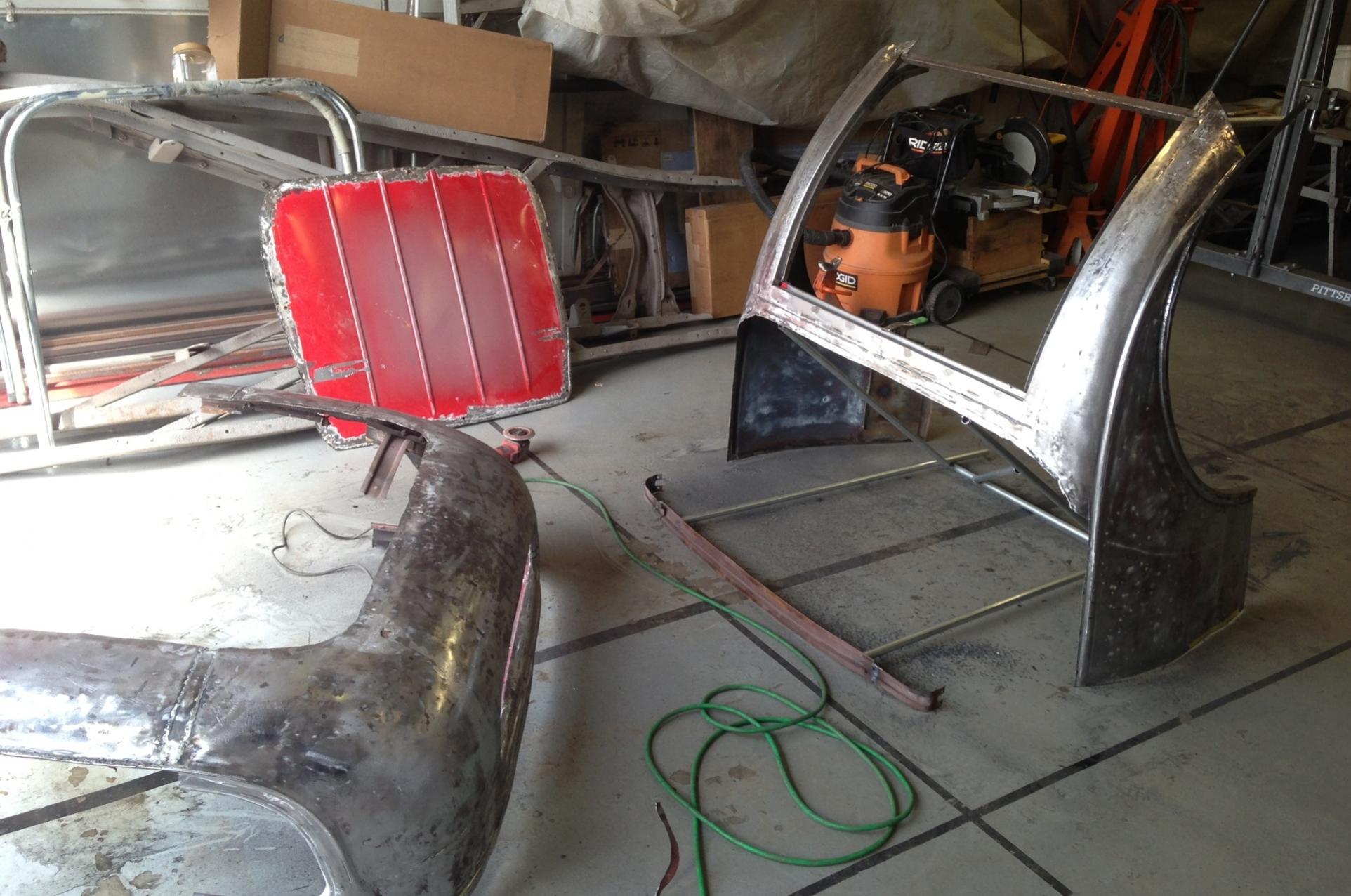

  24. Got the pieces cut and bent to make the part of the rear quarter that attaches to the door jamb. Since 34 Chevy coupe 1/4s will be mating up to 36 ford truck doors, there's going to be some more attention to details here to make it look right, fit right, blend together, and have a clean door opening inside and nice gaps. all without mud at least not gobs of it to build an edge, I hate mud at edges.
    My plan is to make a 2" stub that does this, then weld the 1/4s to it. I would have liked it smaller than 2" but the construction of the jamb doesn't allow and dolly access.
    The formed piece you see is part of the truck, but it formed to start the curve around the back. On the truck the apex is about 4-6" into the door. The apex will be about 7-8" into the rear quarter now, so it will look similar but very different. To do that, the doors closed position was manipulated until the last 4" end of doors curve at the bead planed parallel with the center line, just about an inch. Before the door and 1/4 both dived to the center at the b pillar and packed with mud. Ill probably use the belt line bead detail to save some time, but this is today's adventure. This goes from the under side of rocker about 2-1/2" up to the little rocker feet up then up to the roof line & around the top of the door.

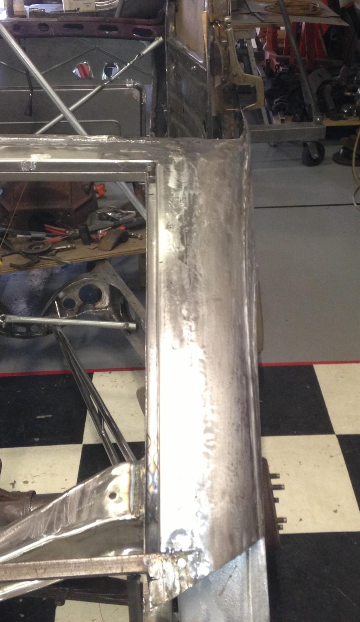

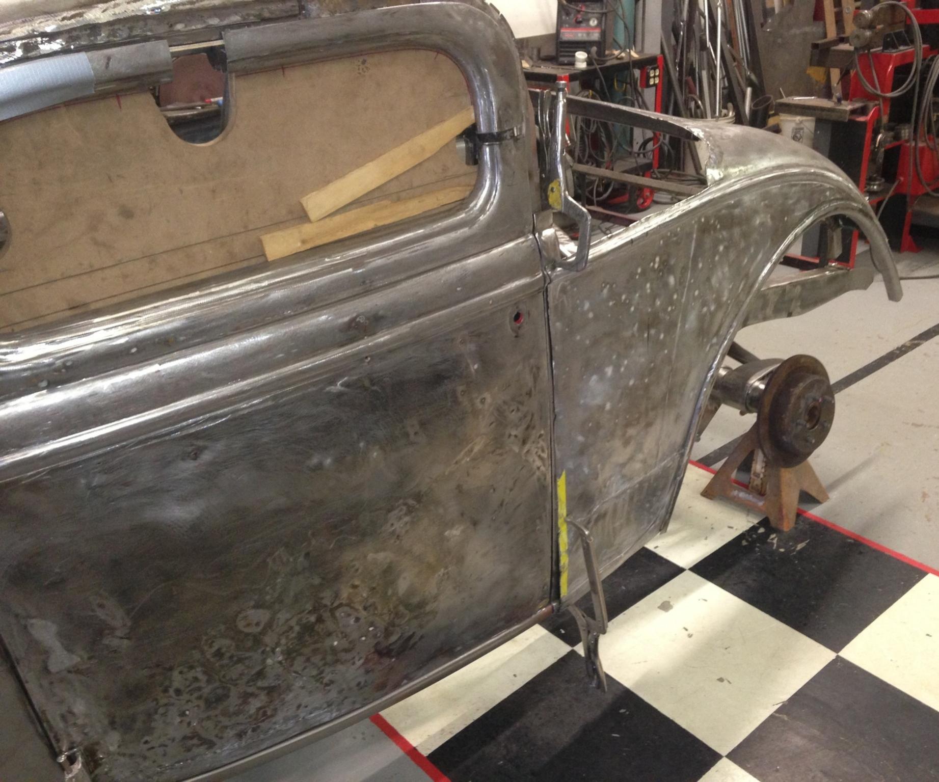

  28. Mocked the quarters back up, but there's some issues to correct.

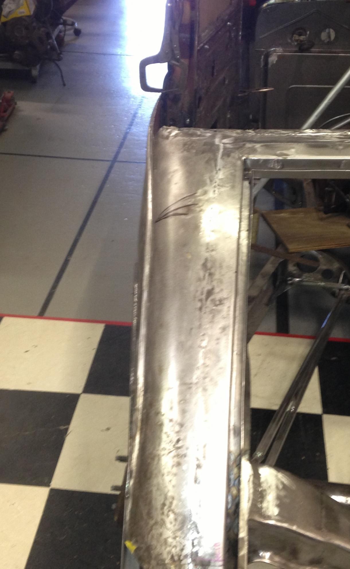

  29. Easy to see what's twisted up here.
    The wheel lip bead follows a nice line, but the upper bead sure looks funny.
  30. The other side is ****ed up the same at least.
    The top bead should fall on a smooth arc even though it narrows from the door to the end of the trunk. The former "mud job" took care of a lot of this. The quarters are actually twisted to center from a more vertical position at just about mid trunk. Should be an easy fix, cut the trunk frame loose, let it relax and fill in the missing wedge. I haven't cut it yet, but that's how I think it will work out. :)
