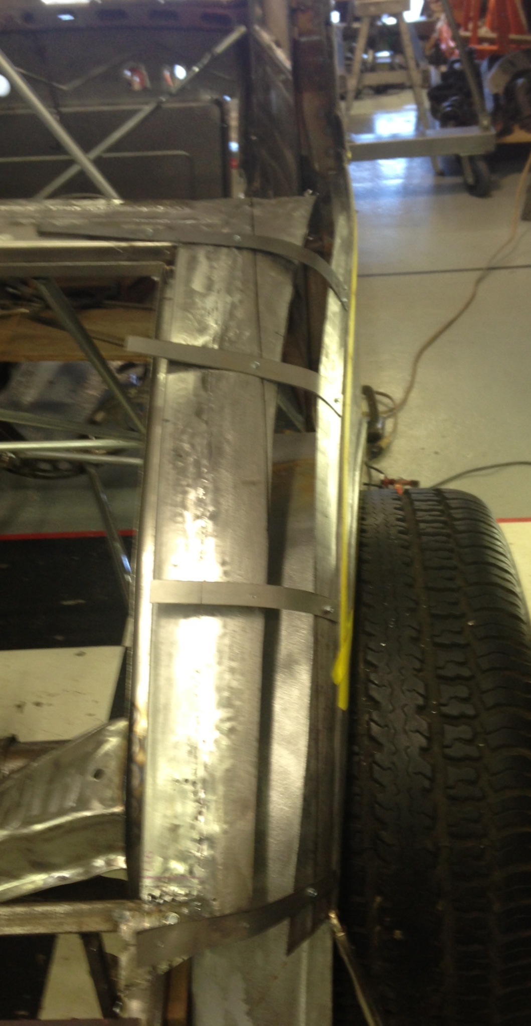

    This is a template to follow the curvature of the rear 1/4s and established by multi angle viewing. I had lots of help with the eyeballs and mouths of the those interested in helping. It's really amazing how different folks will see different things.
    After ducking around with it for days, really looks good as far as flow and natural curves. You'd think this should be easy but its not at all. And that's just to get one side, its even harder to get the other side to match. Damn quarters flop around like a cross between jello and a chicken with its head cut off.
    Now with the curvature measured and plotted a 1/2 x 1 reinforcement was formed to follow the compound curved of the plot. Then an exact opposite was made.
    VANDENPLAS likes this.
  5. The pieces were clamped and tacked to the inside of the quarters.

  7. Other side same way, and best of all matching curve:)

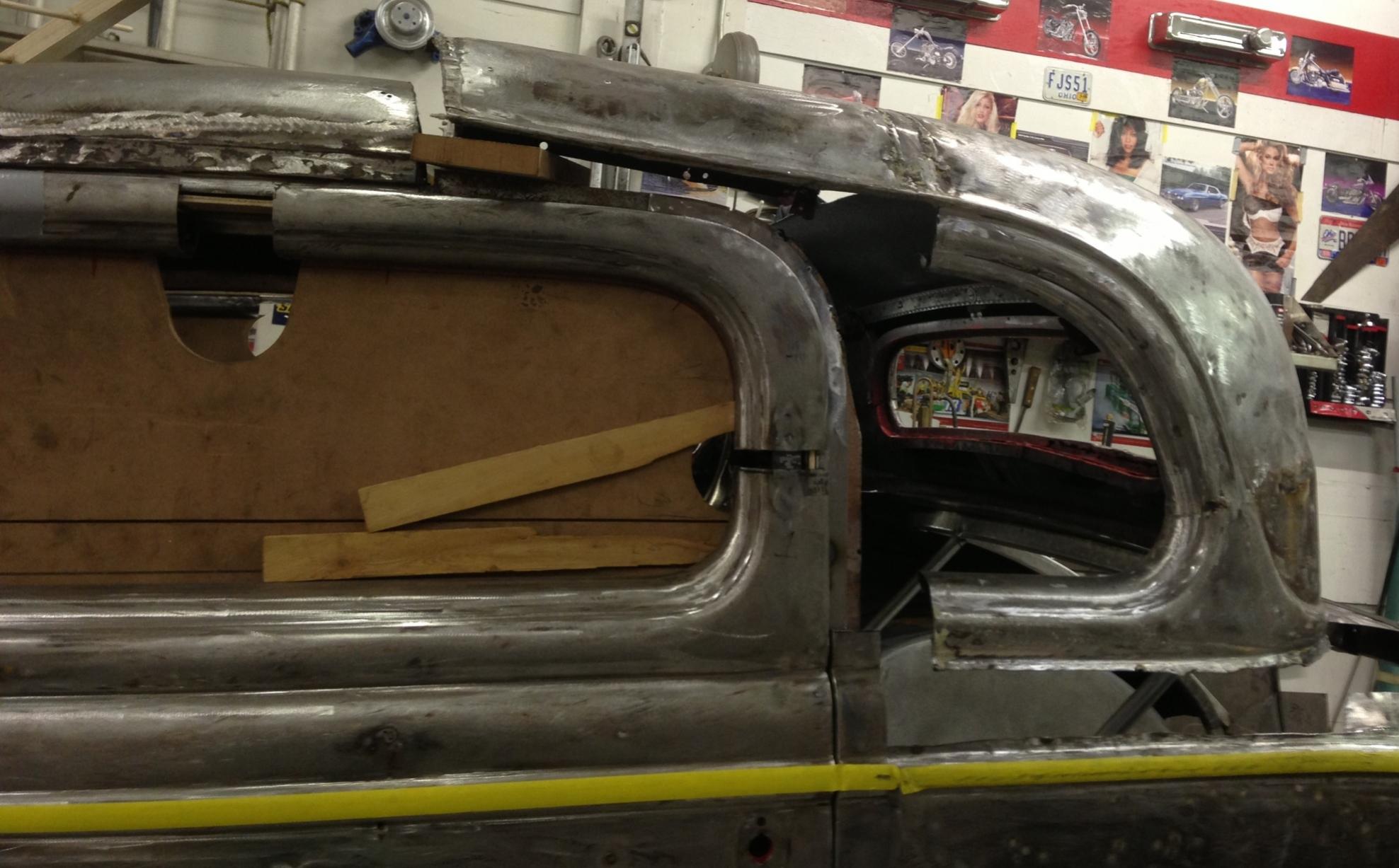

  8. This is how the quarters sit. At this point all I'm worried about is from the bead line down following the flow and smooth curve with no dive into the B pillar or door. Also didnt want a tortured bulge of metal under the window/roof to quarter junction. There will be more cuts and full pieces.

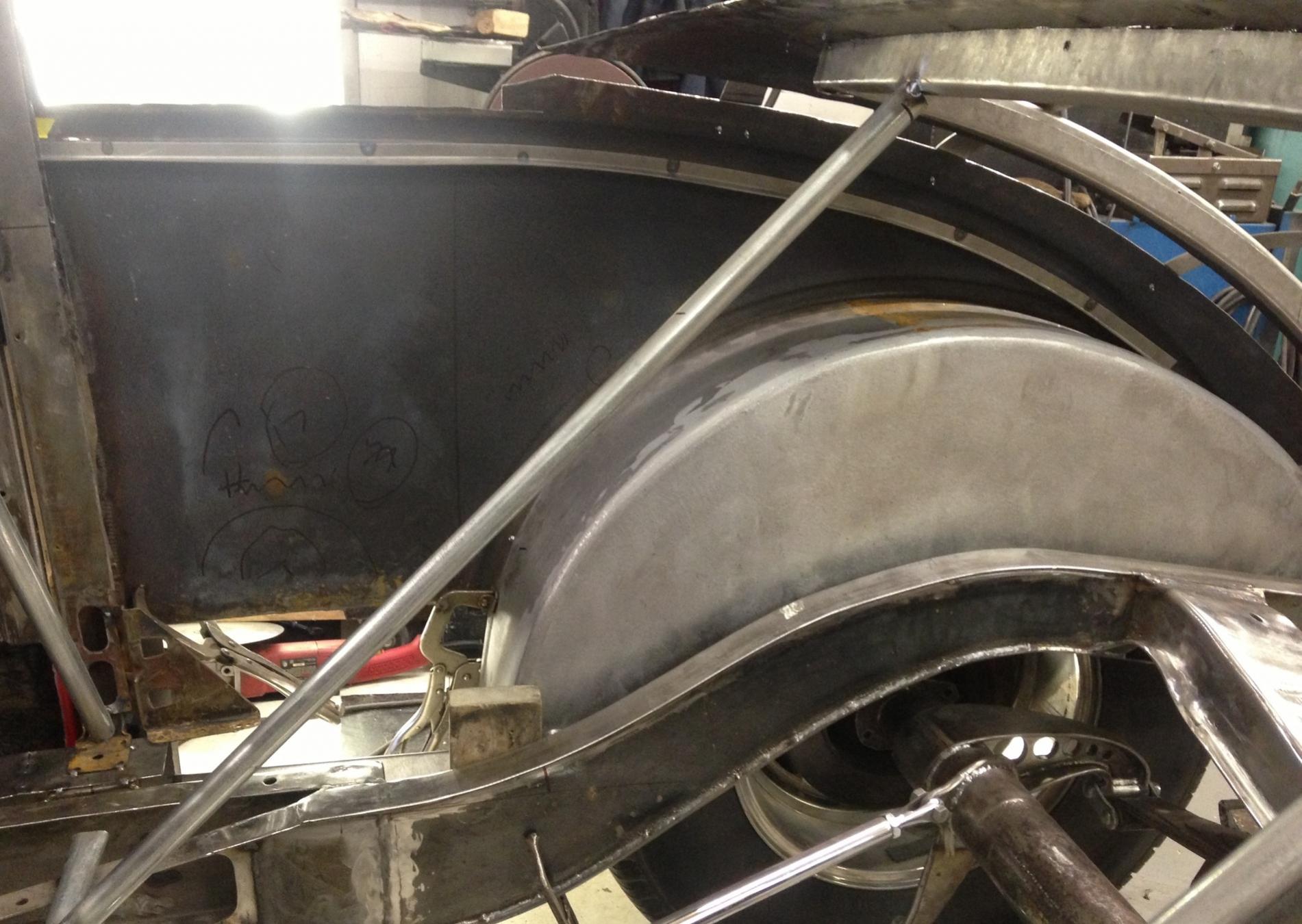

    I made 1 cut on this, and the gap now is far from uniform. It's about an inch at the top of the trunk, over 2" where the pinch/dip used to be and 1-3/4 " at the bottom of truck. Also had to drop the tails to get the profile bead to line and transition from the door without looking kinky.

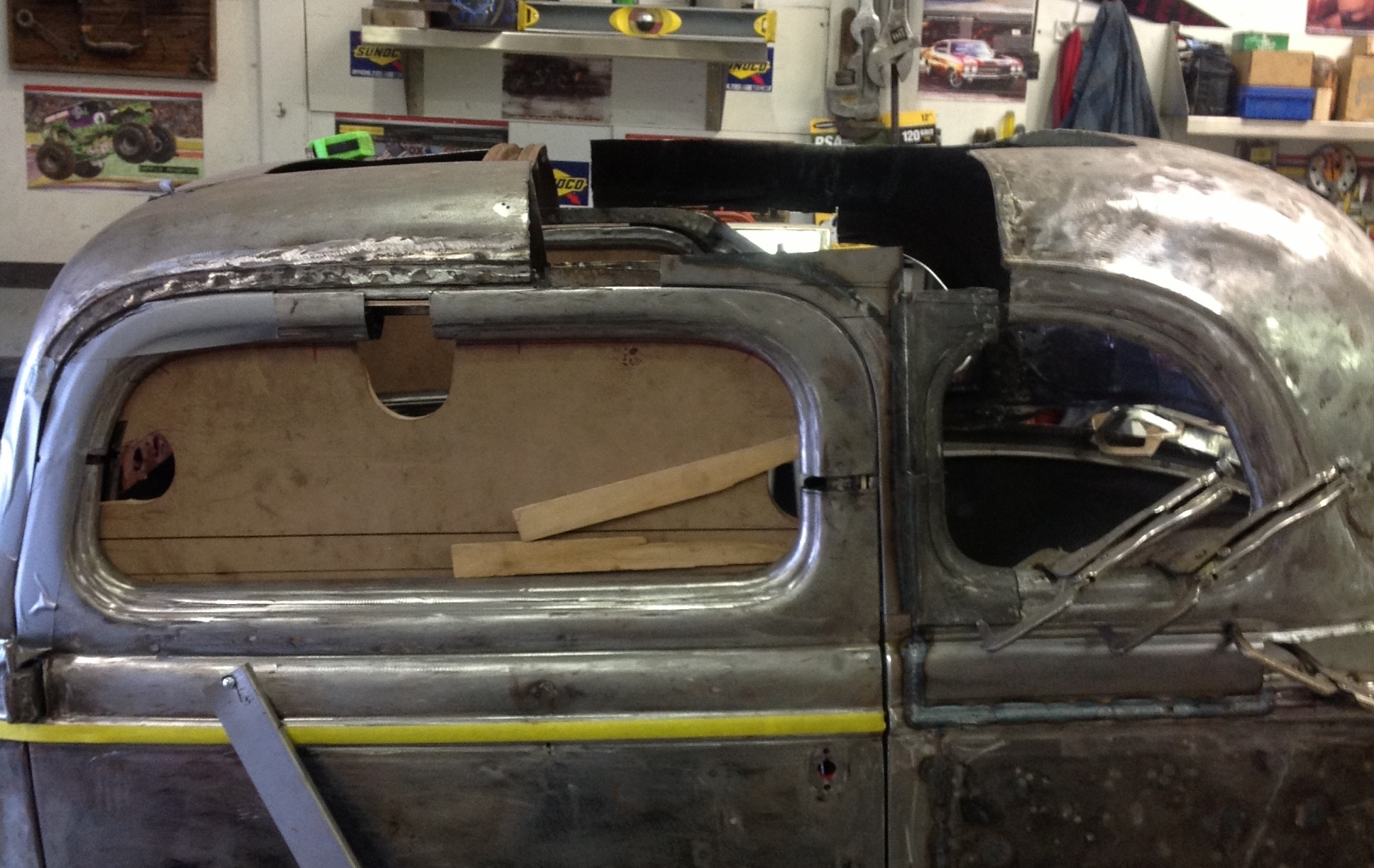

  10. So tried setting the roof back on. Since I'm going bottoms up on this, I set the bottom of the 1/4 window where it wants to be.
    Kind of strange the roofline is aiming for the street lights and hard to imagine that this was ever welded together.

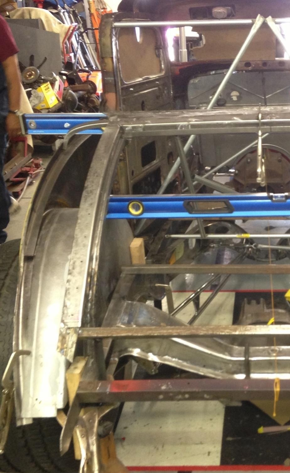

    I haven't seen it yet, but I bet there are no pics like this one .
    You know with center string lines, levels, braces, maybe measuring a few things.
    I lost track of how long we've been working on getting these quarters positioned. It's such a dance and then the 47 other things that you gotta do that pop up and don't involve the cars. You think you got it then find out you are only getting close. The closer you get the more you realize how far off you still are. But but but I really think they are where they need to be

  16. That last pic... what the....? Is something still Katy Waumpus there? It looks like the top right corner of the trunk opening is about 3/8" higher than the left. Optical illusion?
  17. Katy whompased picture I hope.
    The levels are dead nuts but my camera grid lines were off.
    In this crop the levels should be parallel with the top and bottom edges of the photo
    And my center grid line wasnt lined up either. Ill grab another and change that pic later.
    Here the center line should be parallel with the edge.
    I guess I was standing realyl off for this pic.

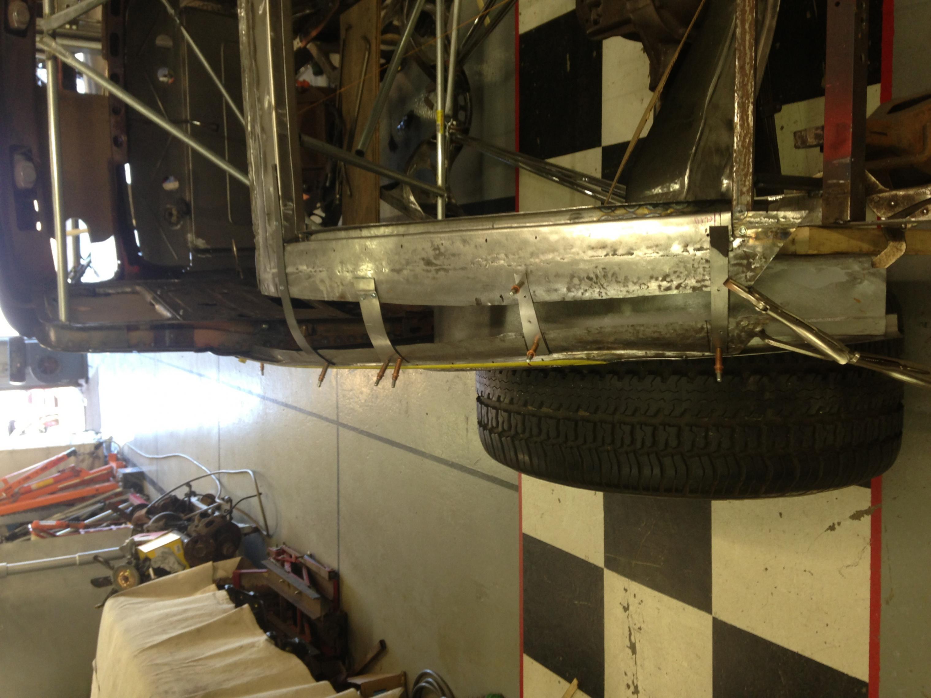

  18. Latest efforts are tedious and the progress isn't really that noticeable but it needed done before going forward.
    Fabbed up the inner rockers
    Fabbed the rear 1/4 patches for the area in front of the tires.

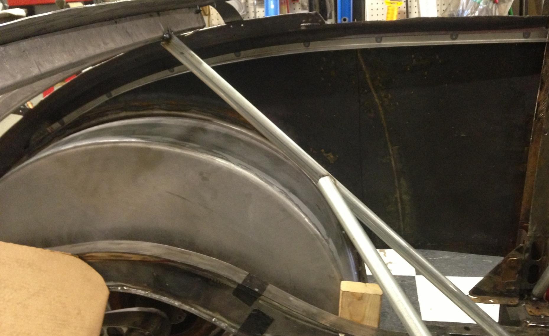

    Got the 1/4s, patches and rockers all welded in. Had to re make the inner wheel house and set those.
    Next will be to cut the new wheel to fit the lay of the real quarters and get those in. Once that's finished I think some more major progressive movements will be in store.

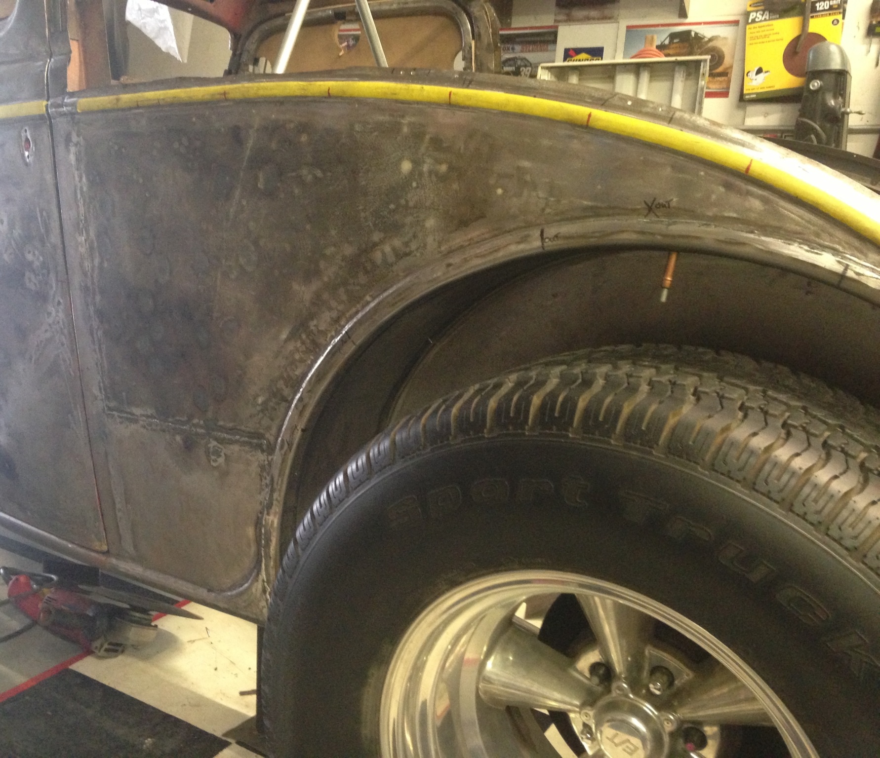

  19. Coming along .
    Got the wheel houses cut and ran them thru the bead roller for the step where they meet the wheel lip. All fit in real real nice.
    Got the rear sub rails made and welded in where they attach to front sub rails and rear wheel house.
    Not that its next, but its almost ready for the floor now.

  20. Inner rockers.
    No water pipe :)

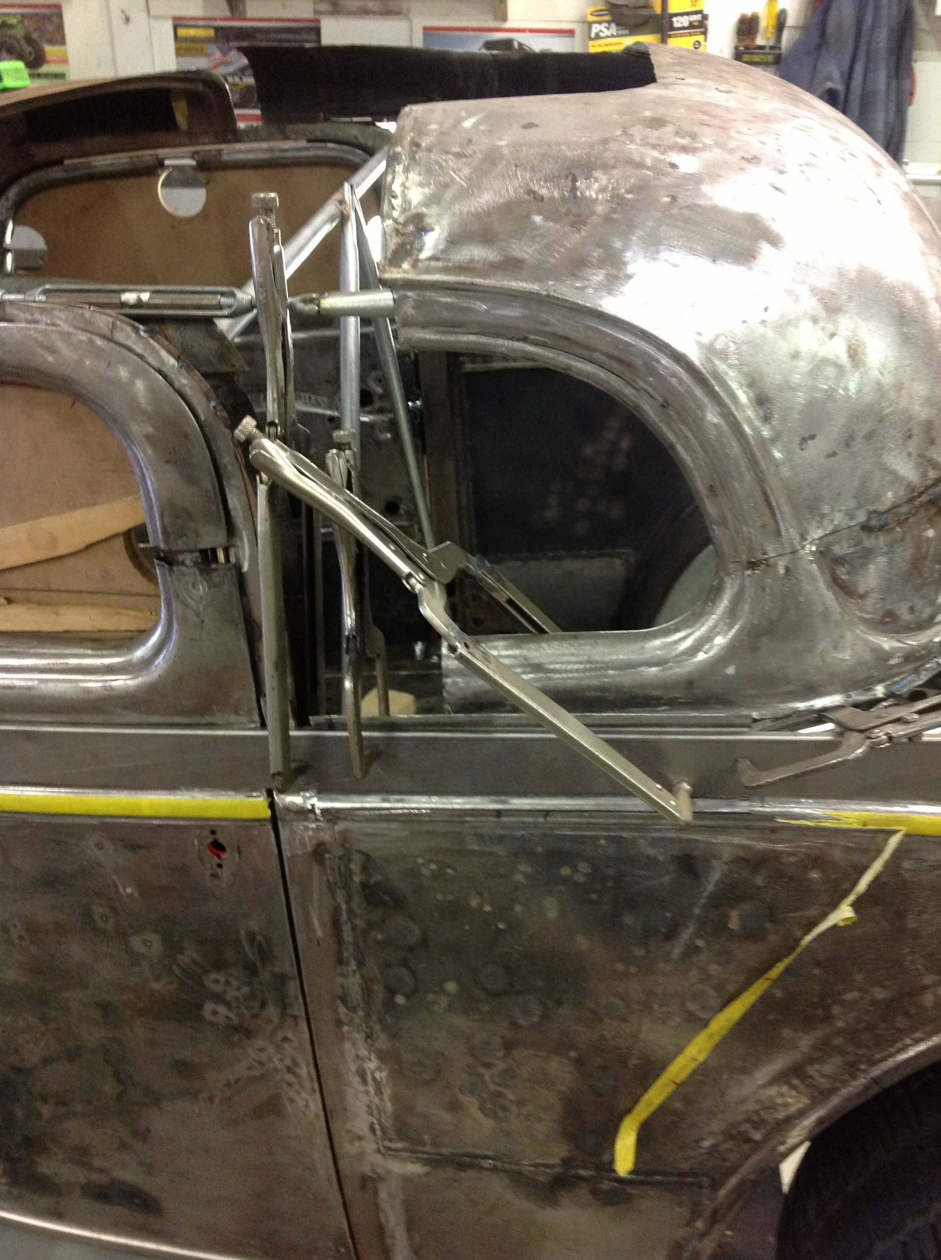

  25. Today's plan is to get the area of the 1/4 windows moving along. Almost all custom made parts to blend that into and over the doors and down into the top of the rear 1/4. I've been making these parts when I had time, lets see if I can get them in. :)
  26. Here's the mission
  27. Here's the parts.
    From my guesstimating, ill need to chop about 1" more from the 1/4 window to get the rain bead in the right spot because it was all jacked before I cut it apart.
    Later for the next steps- That means ill need to cut it above the rain bead and bring the roof up to get the roof line back.
  28. Good start on the drivers side.
    Can't see much of it, but there's a lot of work to get this far
  29. Looks much better along the bottom of that window and up the door now.
    Gonna bring the top around to meet up.
