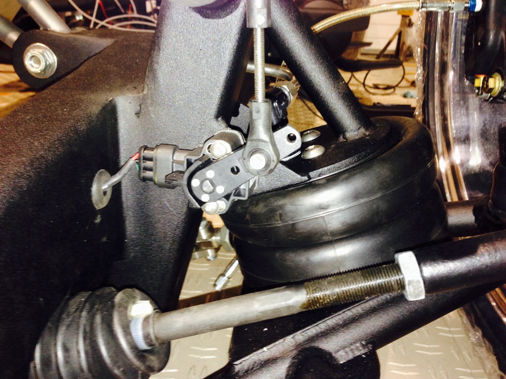

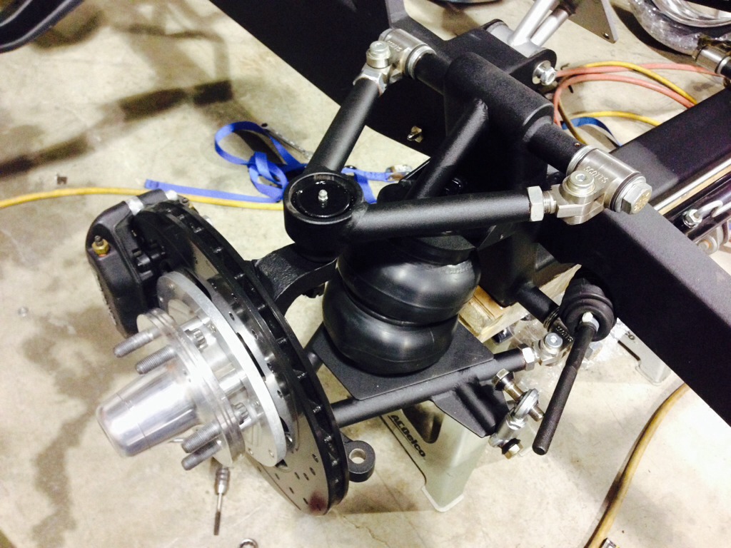

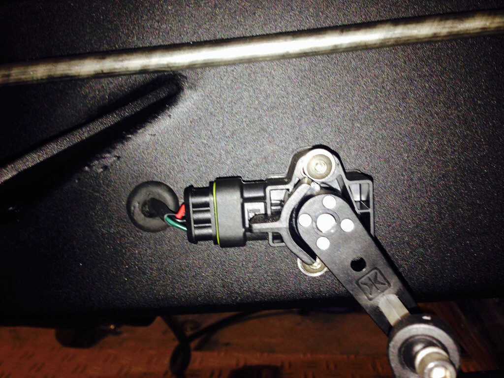

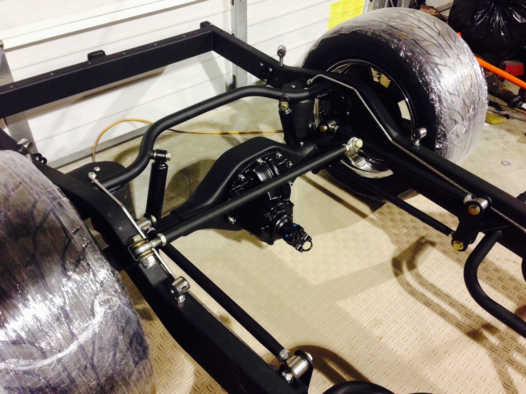

    My son's '51 Chevy 5 Window. We scratch built the frame and installed an Accuair system with dual tanks & compressors. The sensor wiring is ran inside the frame rails to hide & protect them (along with all other wiring). The suspension is from Scott's Hot Rods. The bags are from Slam Specialities up front and Firestone in the rear. We ran the air lines in stainless using AN fittings. This picture is flat out. This was as low as we could get it without cutting into the bed floor...which is plenty low for us.
    The truck is still under construction and hope to have it on the road within a year.
