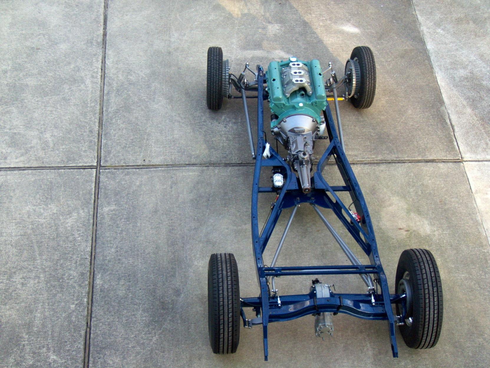

    Current project, 30 Model A, deuce frame and grill shell, Nailhead, 5 speed and a quick change.

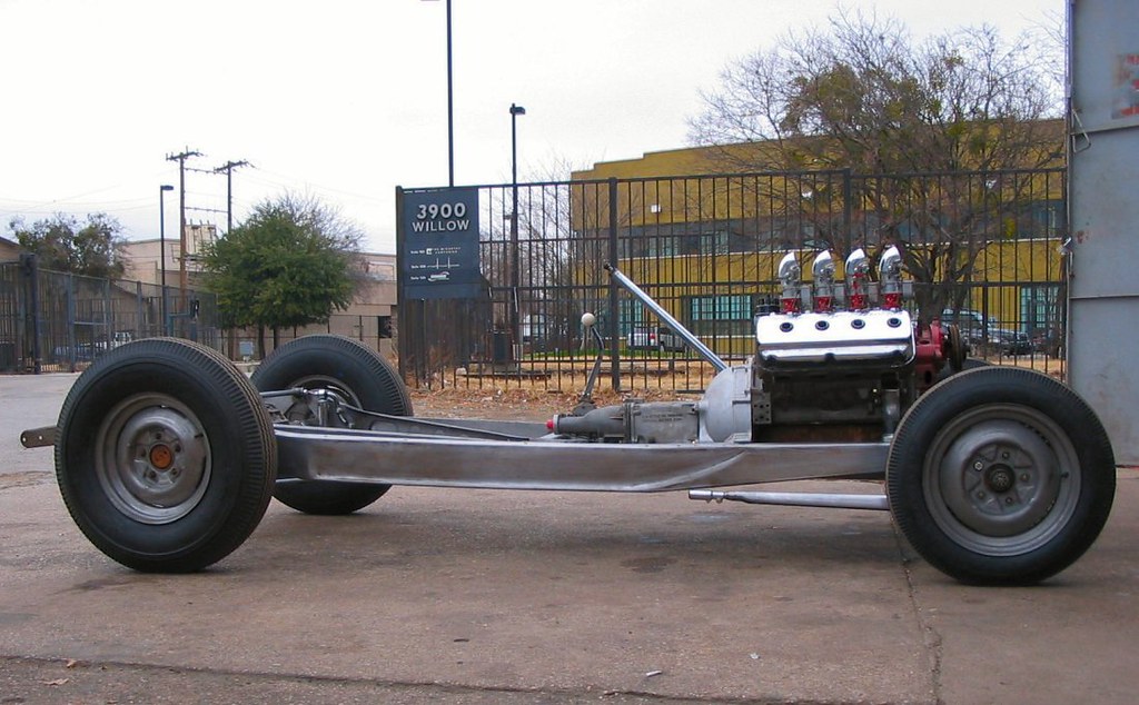

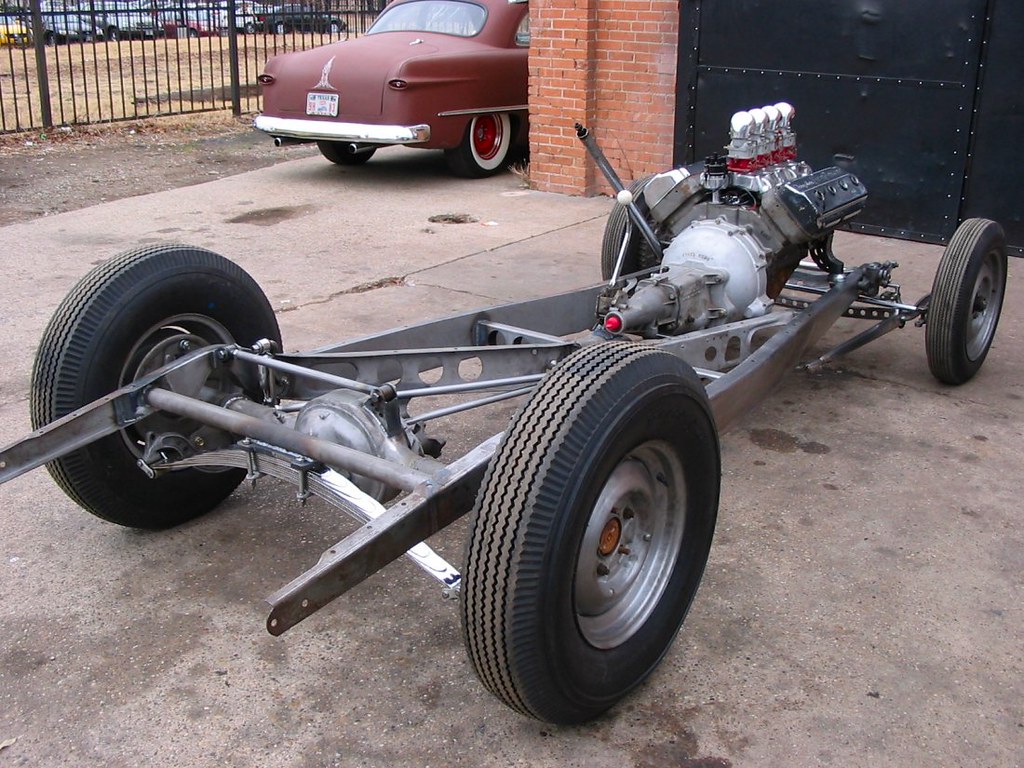

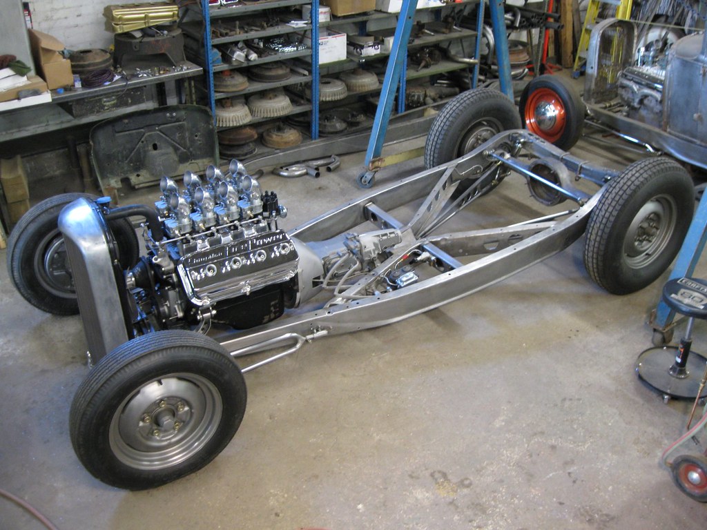

    Here's a few of the '32 Chassis I've built. Some could be considered "period correct", some are not so period correct, but just my "style"...for lack of a better description.
    I suppose these three would be in the "period correct" category:
    Texas Playboy (Theoretically nothing newer than '59):
    Swiss Model A Coupe (Theoretically nothing newer than '53:
    Sam's Roadster (Theoretically nothing newer than '54):
    Not so period perfect:
    The Wade Coupe:
    My '29 Coupe:
    My '29 Roadster:

    I wouldn't be able to pick from any of yours, Brian. They're all just too good to pick one over the other.

    Whoa whoa whoa!!! What's up with the Swiss and Sam's coupe Brian? Those are pretty rad.....simple compared to your other stuff but rad none the less! I'm still digging your '29 Roadster chassis as well. I talked to E.C. at the Roundup and he mentioned the possibility of getting back on that soon??

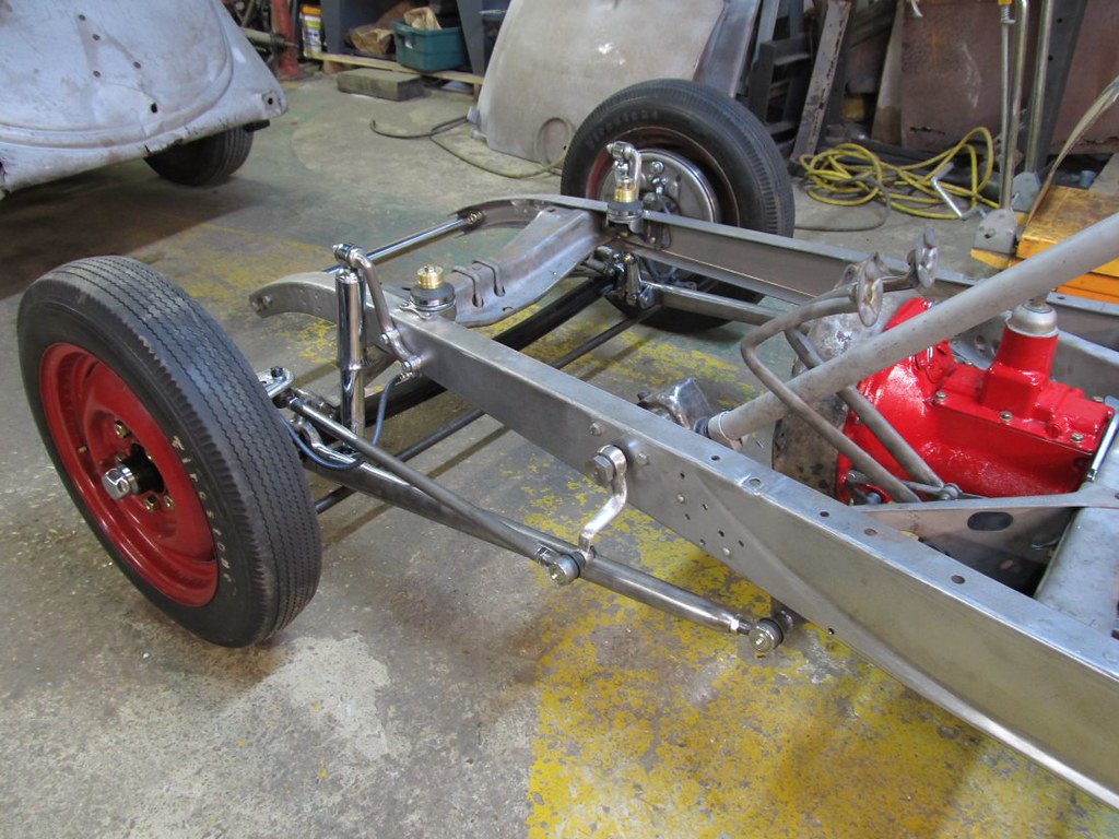

  22. Ken Crawford sent me these back in 2010. The restored '32 chassis of the Ken Crawford/Jerry Stroner roadster by Chuck & Mike Longley.

    That '29 chassis is ridiculous, it's perfect.

    Definitely some reference material here to be filed for the future. Is that '40-style cross steering tucked in the Crawford/Stroner chassis above? When was it originally built?

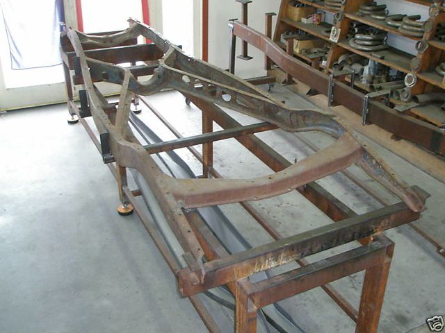

    What we started with & what we ended up with.......wish I still had it! :(

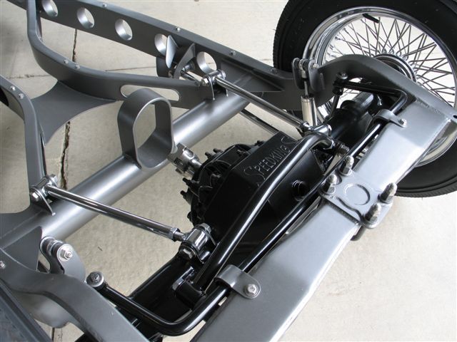

  29. Joshua Shaw
    Joined: Feb 7, 2007
    Posts: 2,191
    Joshua Shaw

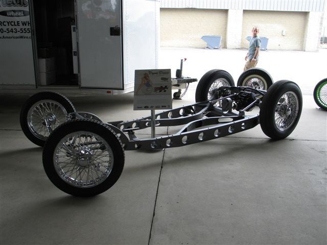

    Here's one that is "Questionable" on the Traditional side.. But it's worth showing cause of some of the neat stuff on it. The Front suspension is an exact "Rip=off" of early MILLER race cars. The cross members were cool. The Holes in the frame were "fun"... Had to find all the different size tubing so they "tappered" and followed the width of the frame. The Last Hole in the back was the actual cross tube that held the Drive shaft loop. This car was concieved, and design to be a 32 Ford roadster "Drift car" to take to SEMA and run with the Imports.. (Hence the Sway bar, and "beafyness" of everything) but, half way through the build the Owner ($) took it in a "European sports car" direction and it lost its magic.
    (I did NOT do the clunky, big front shock mounts. Those were done after my construction of the chassis)
    ...Okay, back to "Buggy spring fronts, Drum brakes, and WISH BONES!!!

  30. Bigcheese327
    Joined: Sep 16, 2001
    Posts: 6,709
    Bigcheese327
    What a cool concept. Was it going to run tall-and-skinny tires like that?
