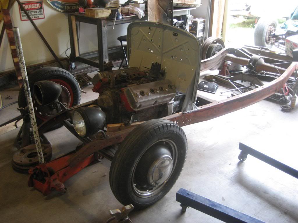

    The latest heap of parts, starting to coalesce as time allows... original rails kicked up about 2.5" out back with A front and rear crossmembers and a '40 center X and pedals. F1 steering, split bones, I've got a nice dropped heavy with deuce spindles for the front end... going closed drive welded QC out back. That pile of roadster underneath there will end up on top eventually.

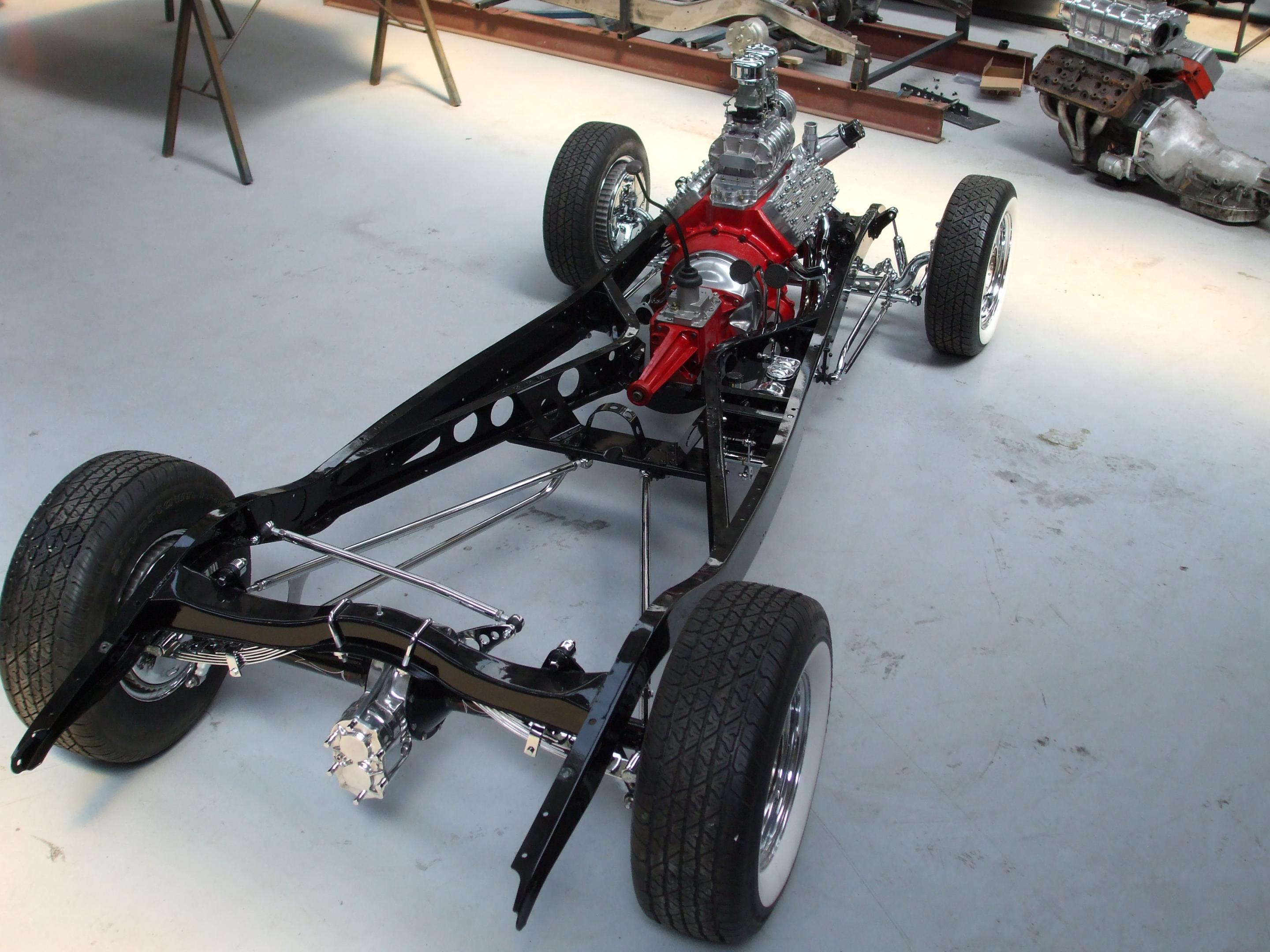

  11. 34 Ch***is I built for a customer a few years back.

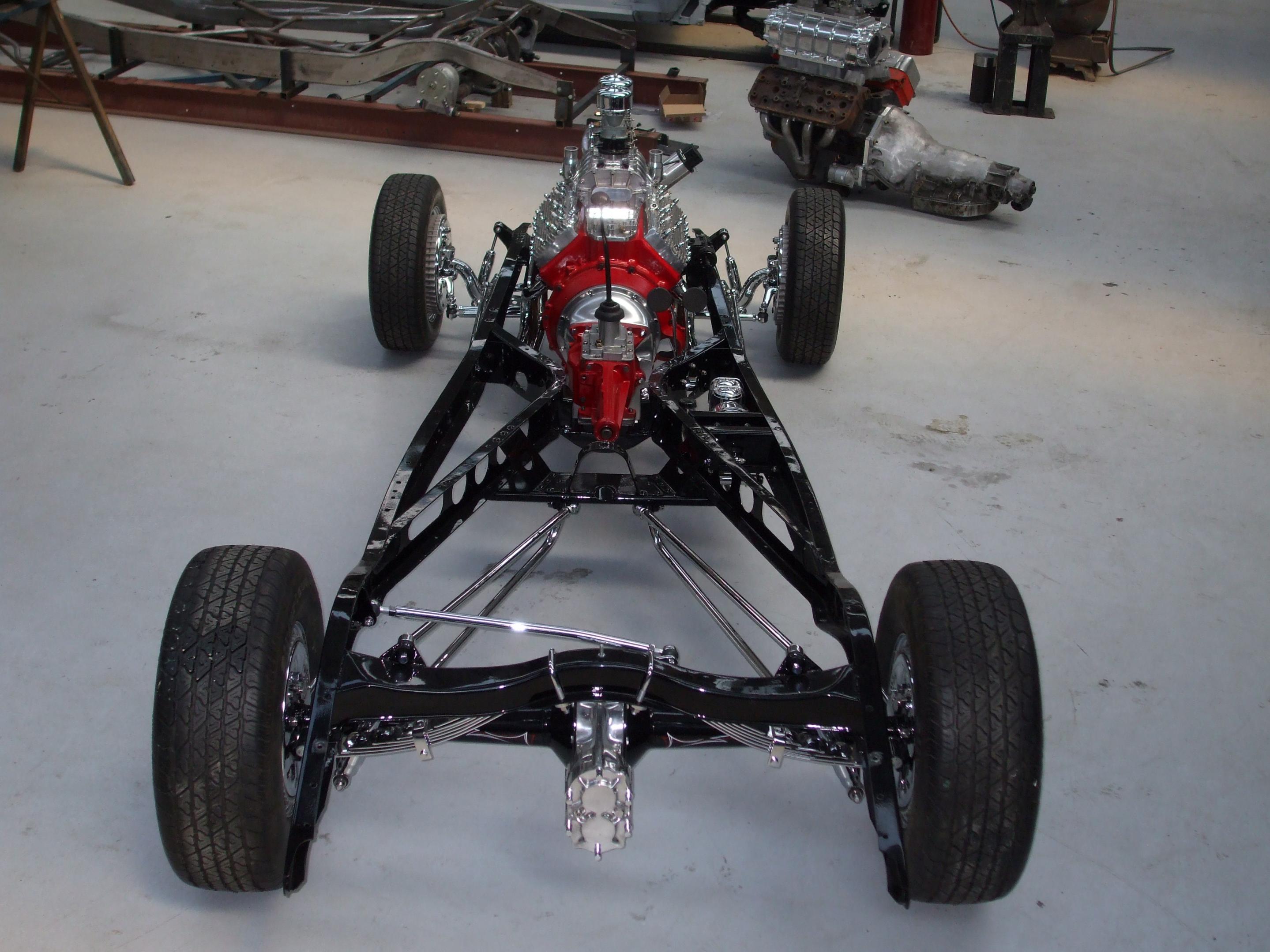

  12. another.

    Very nice Nailhead......now watch & someone will let you know that it's not Traditional :D;)
  14. Yea I guess someone probably will, Flathead, dropped axle, quickchange and a model A spring, No welding on the ch***is either, made new rivots and re-rivoted at all back together as well including all the new crossmembers etc I made. Its trad enough for me!
    Wheels ruin it for me though, but as they say, the customers always right!!

    Yeh! not a big fan of the Chromed Wires myself.....but hey, it's different & I like different.....be nice to see her when the Body & all is on her :D;)
