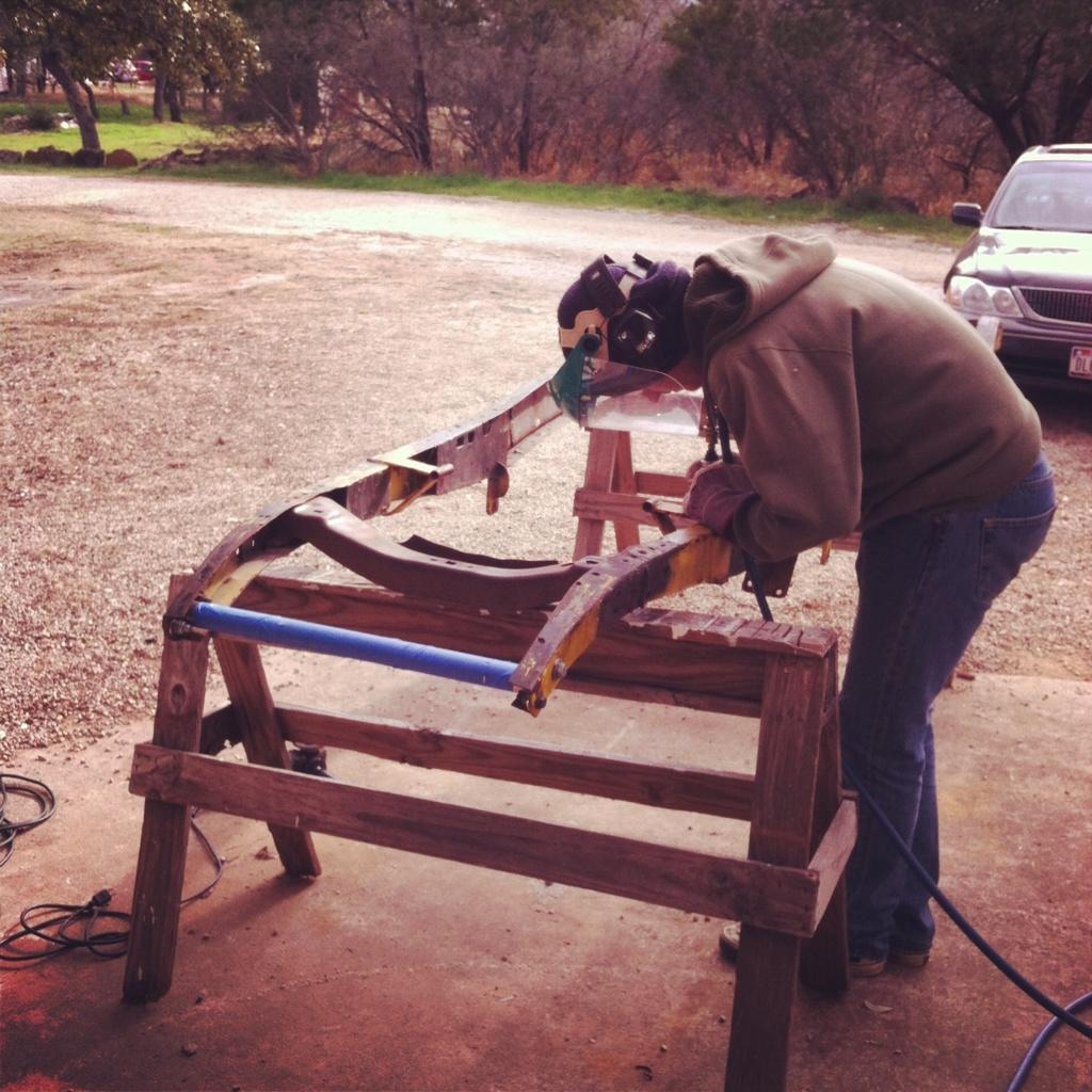

    This is the org 32 frame The Kid is working on cleaning up for his A coupe build. He is a 14 yr old building his first hot rod . Build Thread link in footer. Building this traditionally with a '51 Studebaker 232 v8. This frame had served as a street rod chassis and was a hacked up mess. He is removing all the four bar mounts and poorly installed boxing plates. Looked to have a Vega steering box. Removing that bracket too and install a F1 box. Axel and split bones are org 32. Rear end is also 32 utilizing the 32 rear crossmember. Unsure on what bones to run in the rear, leaning towards 36 bones with spring hanger removed. Will update more here as it comes together.

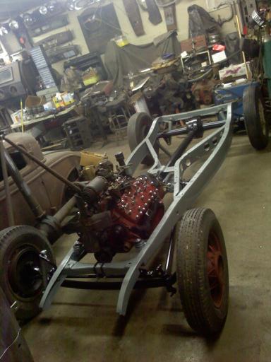

    Here is our Roadster at the beginning stages . The only thing that has changed is the engine . I went back to a Flathead for my own reasons . The frame is stock, unmolested with original cross members that my Dad got in the early 60's . 39/40 rear end w/torque tube driveline, Early Ford 3 sp , stock pedals , stock tank with addition of a fuel sender , stock 32 axle dropped, lever shocks, unsplit stock wishbone, 39/40 brakes . All early parts . She is very fun to drive !!

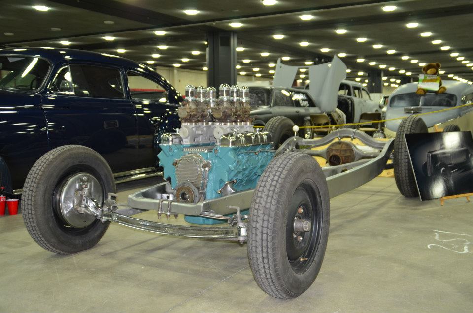

    Bulls A tudor chassis, another customers 32 chassis for his 31 roadster, and a 33 chassis for Marcys 33 3 window, will be flathead cadillac powered.

    HotRodA , My Dad made the engine mounts about 40 years ago . They are simple and clean . The steering arm is one from Speedway . It is originally straight . I had it bumped at and iron work shop and then rounded the edges . It was very bulky and ugly to start .
    Thanks , Mike
  29. ^^^^Very nice, Mike. The mounts mimic the early flathead mounts, perfect for a stock 32 crossmember.
