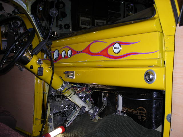

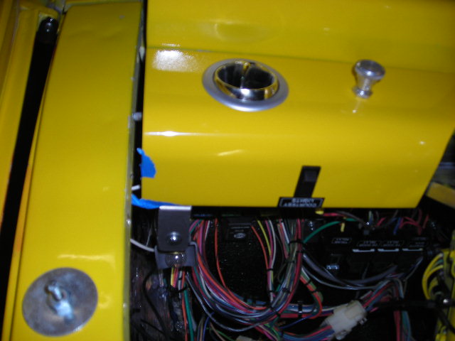

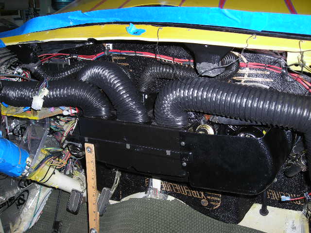

    I put this older version Vnitage Air unit in a friends 38 ford with a set back firewall a few years ago. It did require a short dash extension but it all fit in a less that stock firewall space. The custom truck style dash board also has less space that a 40 dash. You may have to eliminate the cowl vent lever but may be able to use it with an electric drive motor for it. You would probably have to cut the glove box down to just a space to store your insurance and registration papers. Building a hot rod with modern conveniences always rewires putting 10 pounds of stuff in a 5 lb space. It's just part of the fun. Personally my experience with these AC systems in these old 39-40 Fords shows that the cooling systems have trouble cooling the engine on 90-100 degree days without AC. You may find that you have to turn off the AC when you need it most which makes all this effort and expense a questionable effort. I know many will pipe up and say they never have a problem. That's okay , I don't want to start a debate or argument , just stating my opinion. When I drove this car with AC I certainly enjoyed having that cold air blowing on me from the dash vents. I am building my second 39-40 ford now, both will have heaters but no AC. I live an area that experiences about 2 months of frequent 90 to 100 degree days. If a car event day is going to be forecast at 100 degrees I just stay home.

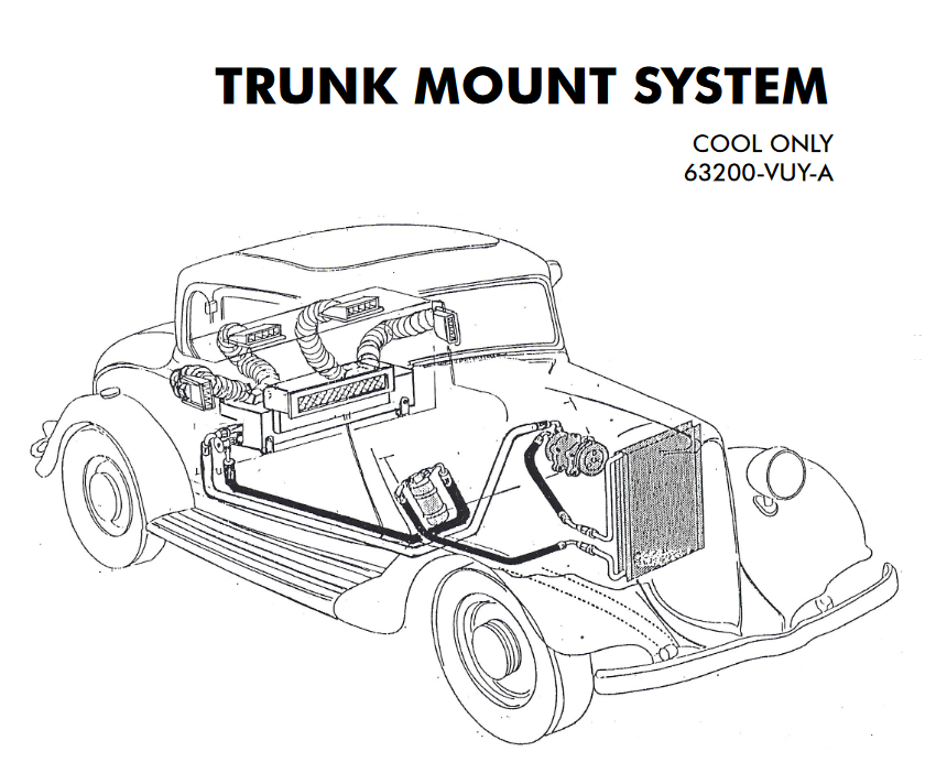

    Okay just one more thought. This picture should give you some ideas of how to install the unit.If your 40 has the rear package tray you would have a convenient place to mount some outlets. a couple more attached to the B pillar. I see the air intake would **** air from the storage area behind the seat. So if it were me I would have to throw less stuff back there to keep that intake clear;). They also make a trunk unit with a heater but I think you already have a ford heater on your firewall.
