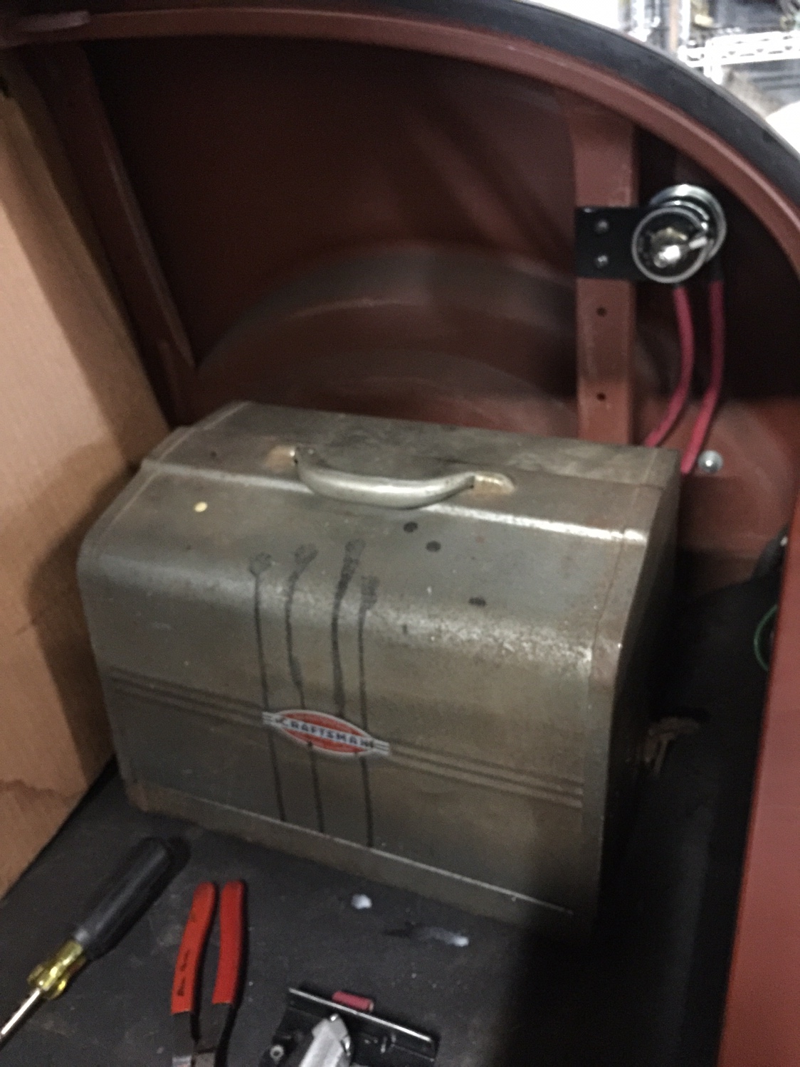

Projects Trunk mounted battery
Discussion in 'The Hokey Ass Message Board' started by jakespeed63, Jan 17, 2019.

    I did the same thing for my Comet. The bottom of the box was removed and the back has an area where the cables come through a separate panel so the box can be removed without disturbing the cables.
  2. fleetside66
    Joined: Nov 20, 2006
    Posts: 3,162
    fleetside66
    I've got my battery in a Craftsman box, too. I bought that tool box for myself for a X-mas present in '72. Yes, it's sad & pathetic. It works just great...big enough for the battery & some spare parts, vented with an old louvered speaker grill. I'm not sure if the gases are rising or falling, but nothing's blown up in all the years I've been using it.

    That old toolbox is a great idea. Way better than the typical black plastic box that seems to come std with the trunk mounted battery kits sold everywhere. I am going to file this idea for future use!

    Love what you have done and it looks great too but a metal battery box always scares me should the battery come loose somehow. That's one of the reasons why the plastic ones are used in boats and caravans etc.
    You have insulated connectors which helps but maybe line the inside box surfaces with 1/16"+ rubber sheets and use a non metallic battery clamp too.

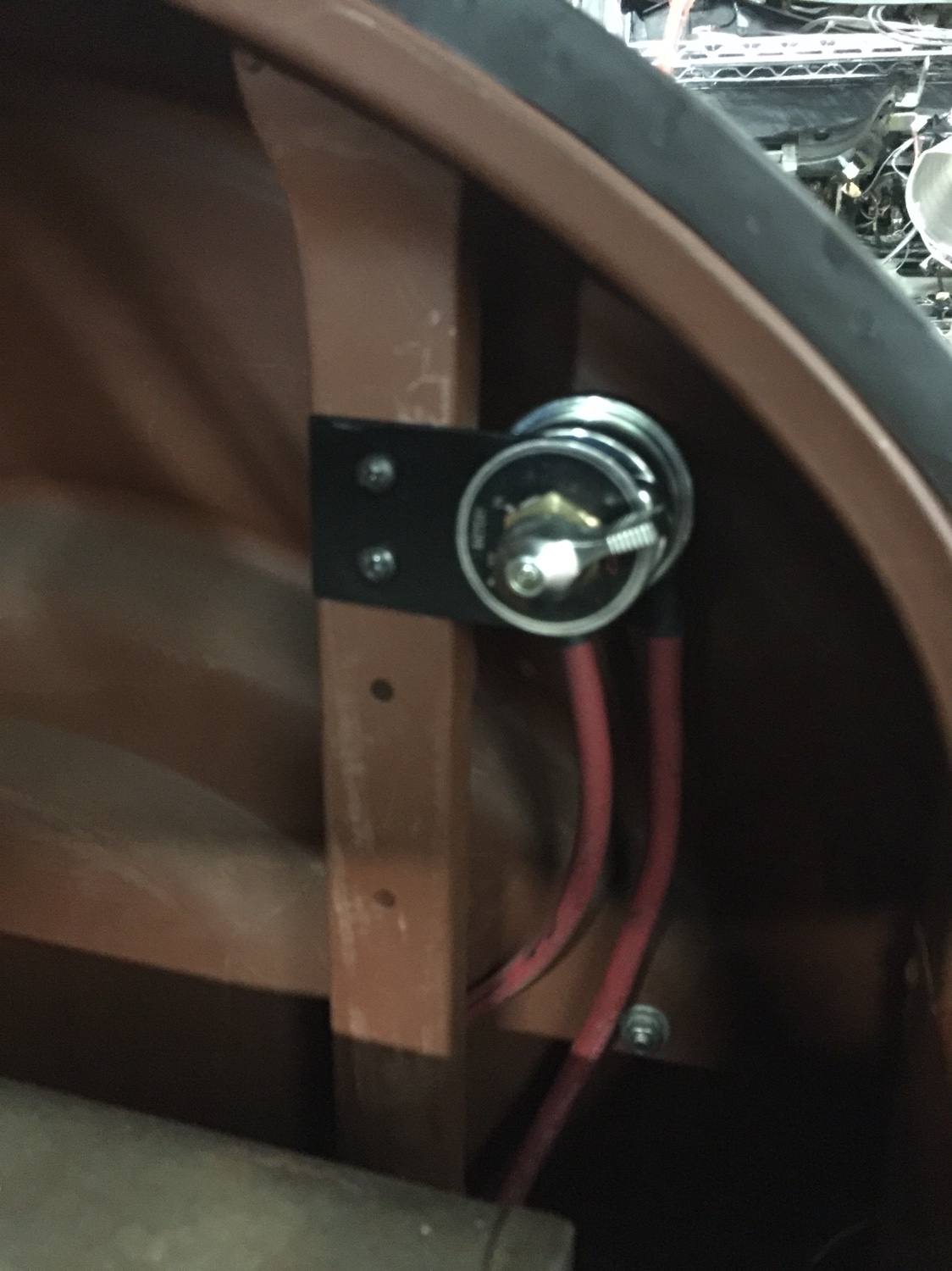

    Neat idea using an old tool box to hide the battery. Good idea to have a cut-off switch too, but I would have switched the ground side. Thanks for sharing.

    what is the thought on the battery disconnect switch the hot or the ground thru it?

    As a simple disconnect either will do. But to both disconnect AND kill a running engine (NHRA rules for trunk mounted battery) you have to disrupt the power which includes the feed from the alternator. And the switch must be accessible from outside the car (NHRA trunk mount battery)

    NHRA says battery disconnect on the positive side. I also had to run a separate cable to the alternator to kill the engine. The tech official asked me to rev the engine up to 2000 rpm and then he would hit the switch to make sure it would kill the engine, which it did.
