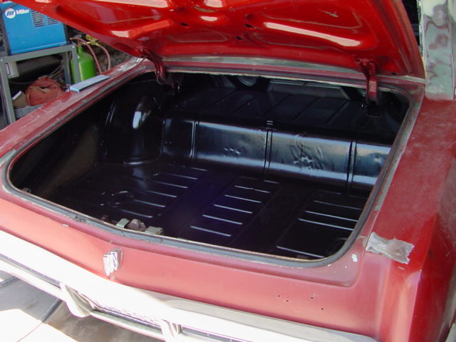

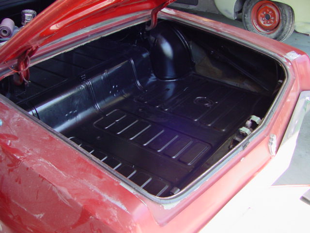

    POR-15 is supewr durable and stops rust...
    worked for my Riviera... looks NOS again...
