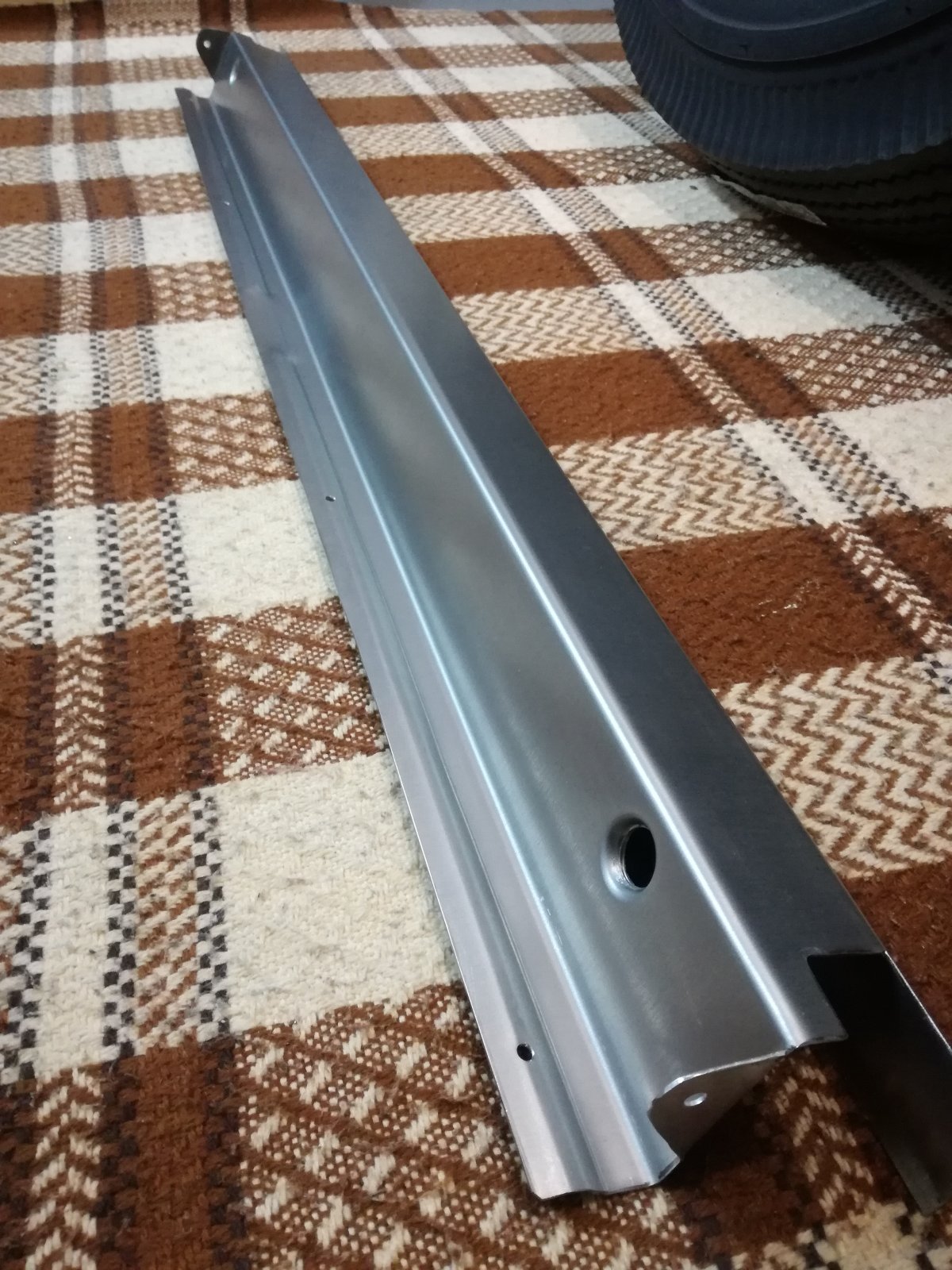

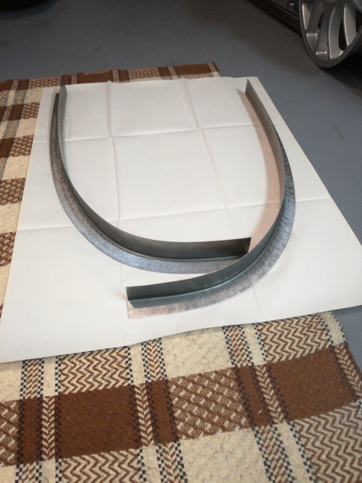

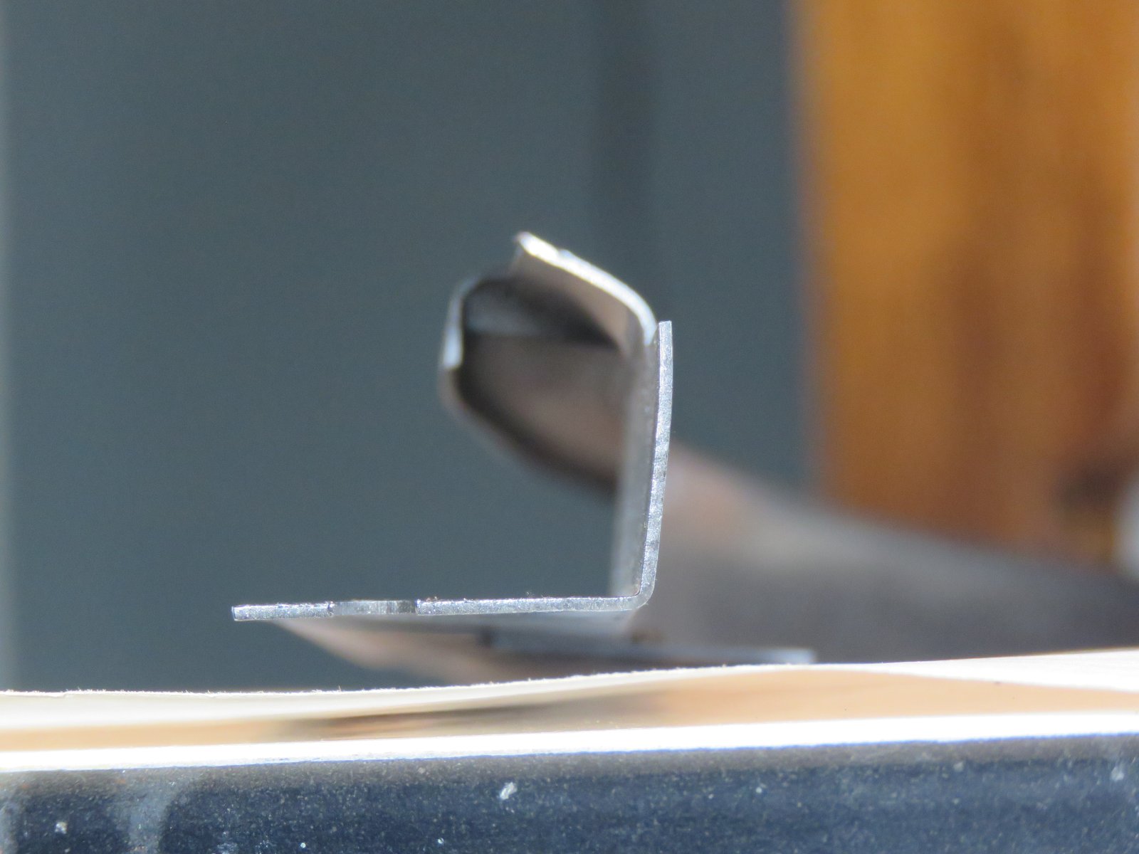

    Hello,
    Building my Roadster almost from nothing but with care about details.I would like it to look original.
    I know there are many posts asking for dimensions and sometime it can be annoying.
    Could someone please make measurments for me ( bending angles would be awesome ) + width of the whole part...detailed pictures are also very welcome.
    Here are couple of pictures from my build. Parts made completly from scratch:
    Thank you in advance!

    Those are some nice looking parts!

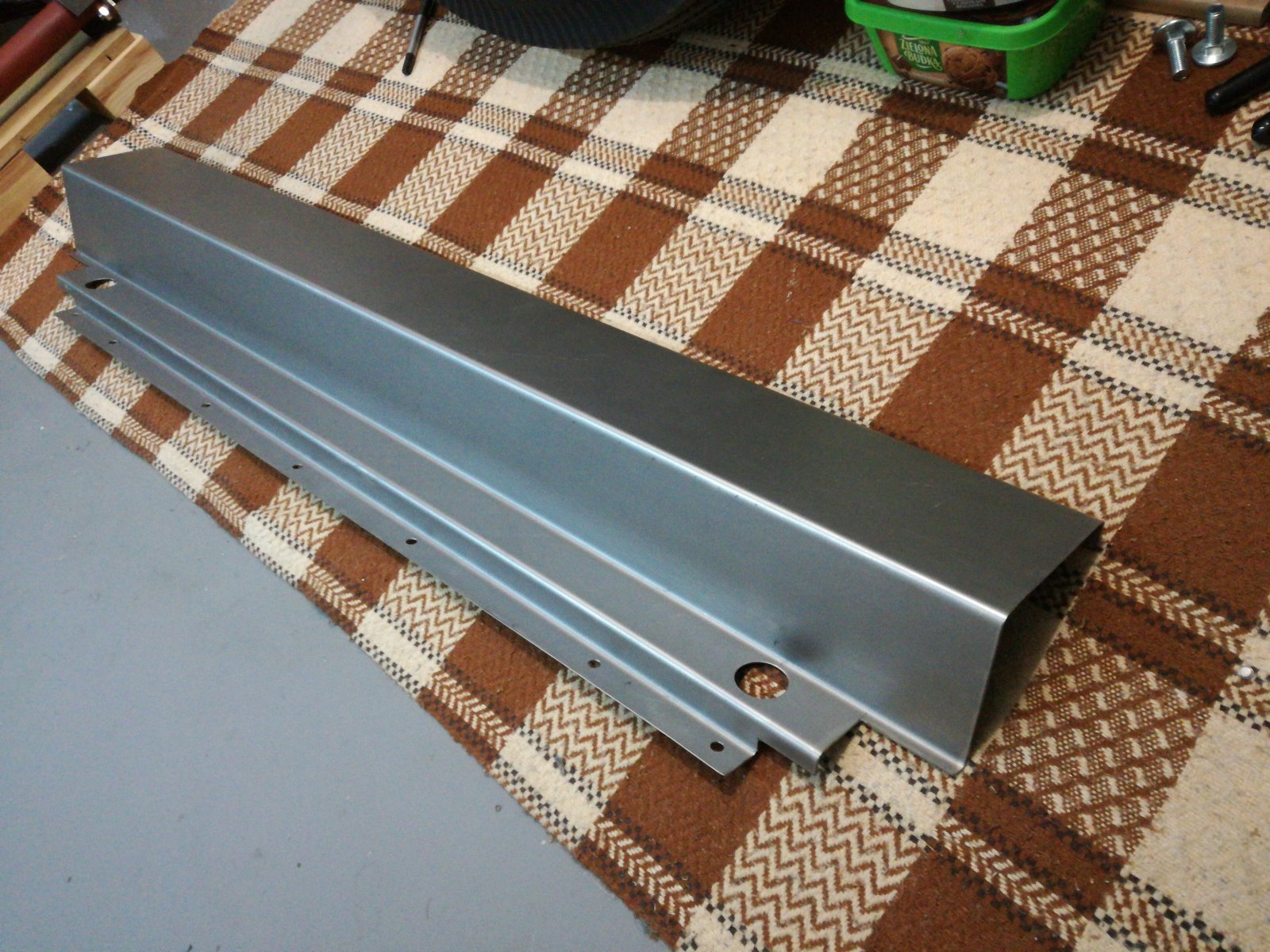

    I have a brand new set of United Pacific trunk side gutters that I haven't installed yet. I can't help you with bending angles but maybe I could trace the outline on some paper and mail it to you. this would give you the contour outline. I could post some details pics and measurements too. Those parts look outstanding!

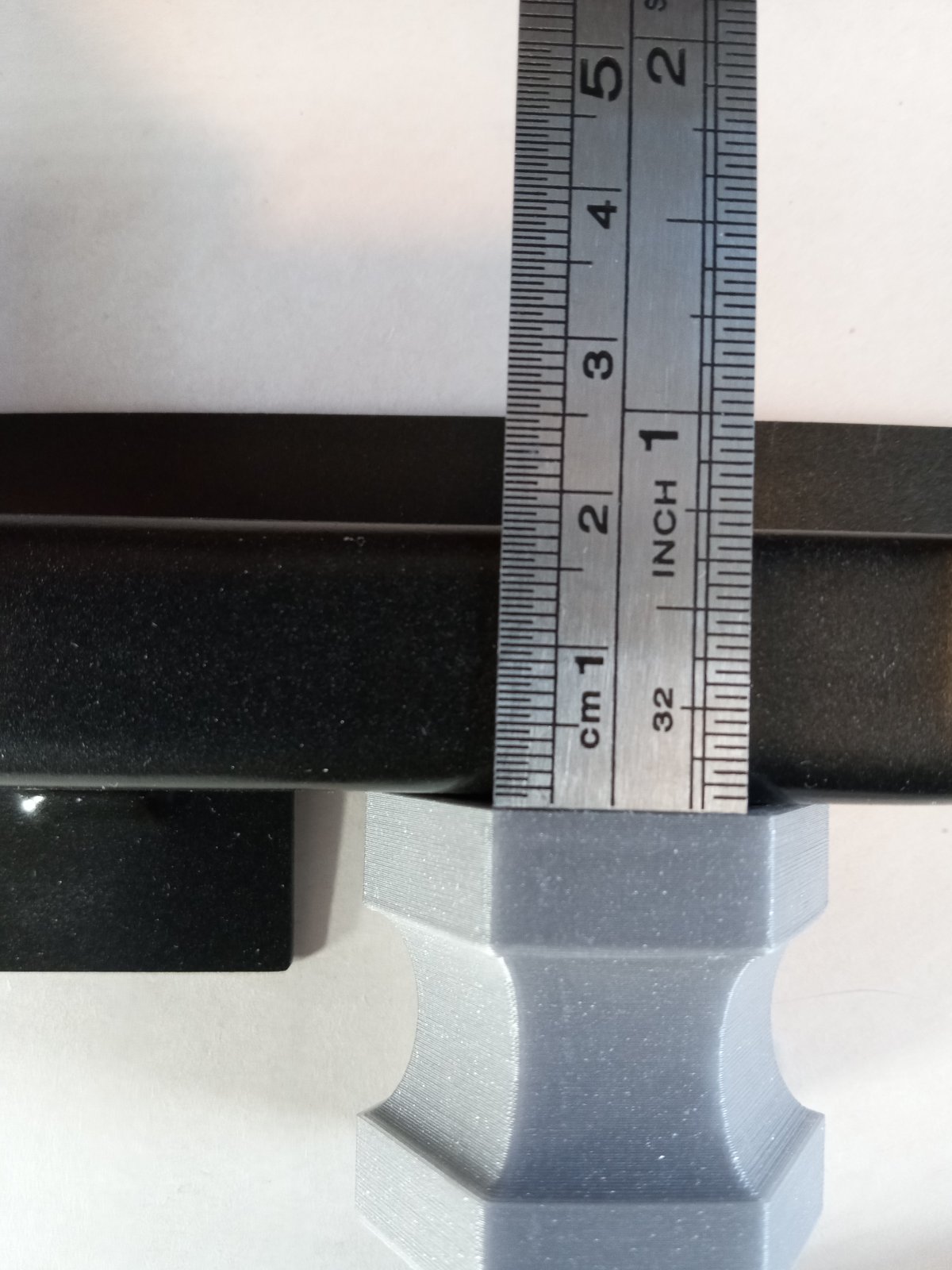

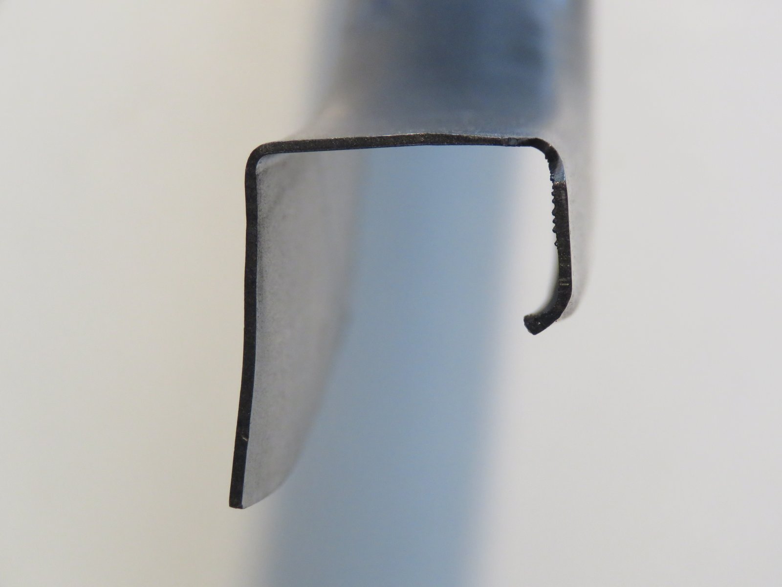

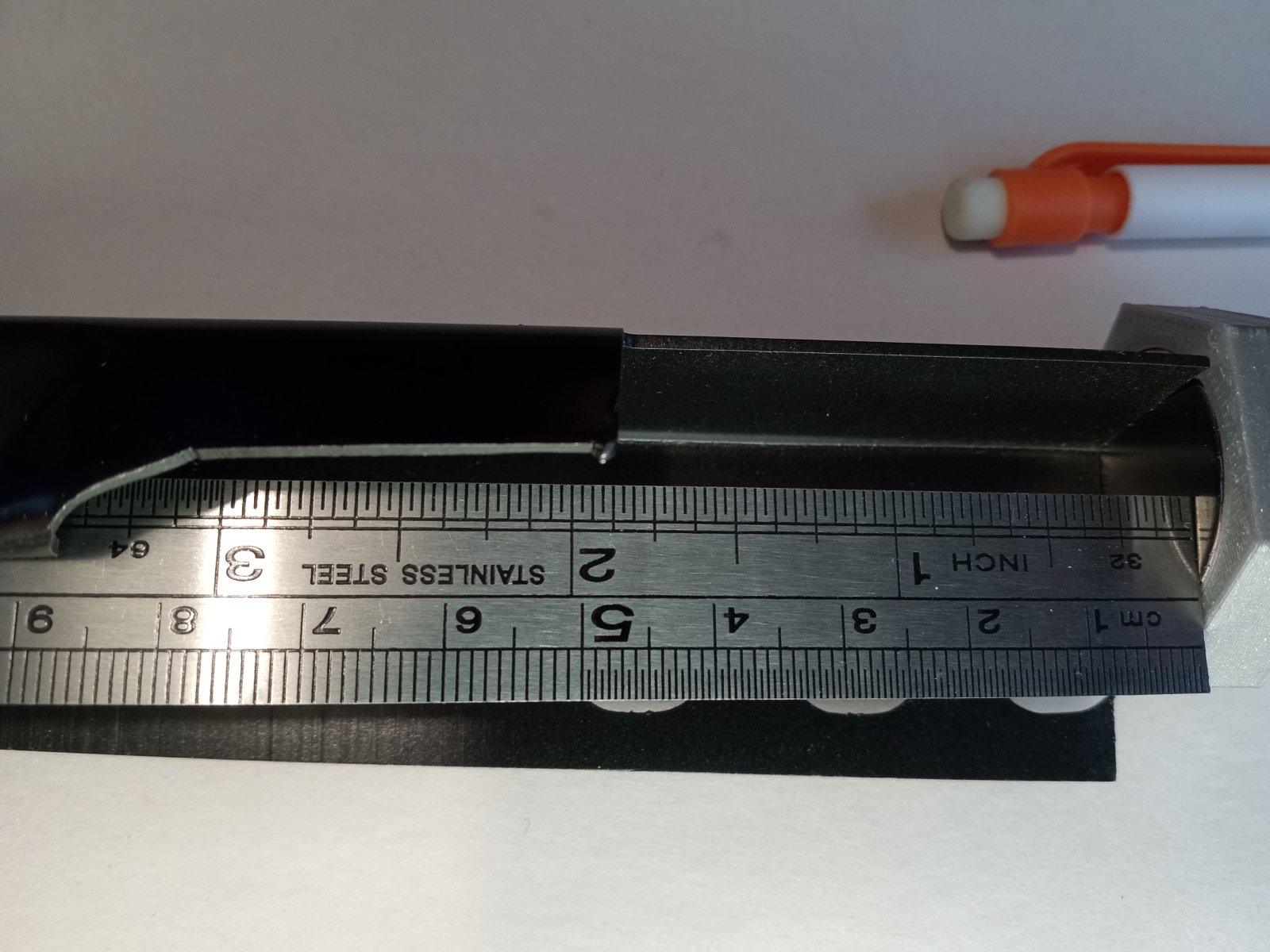

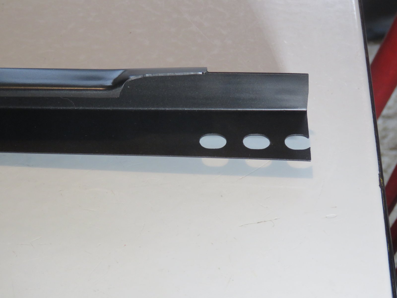

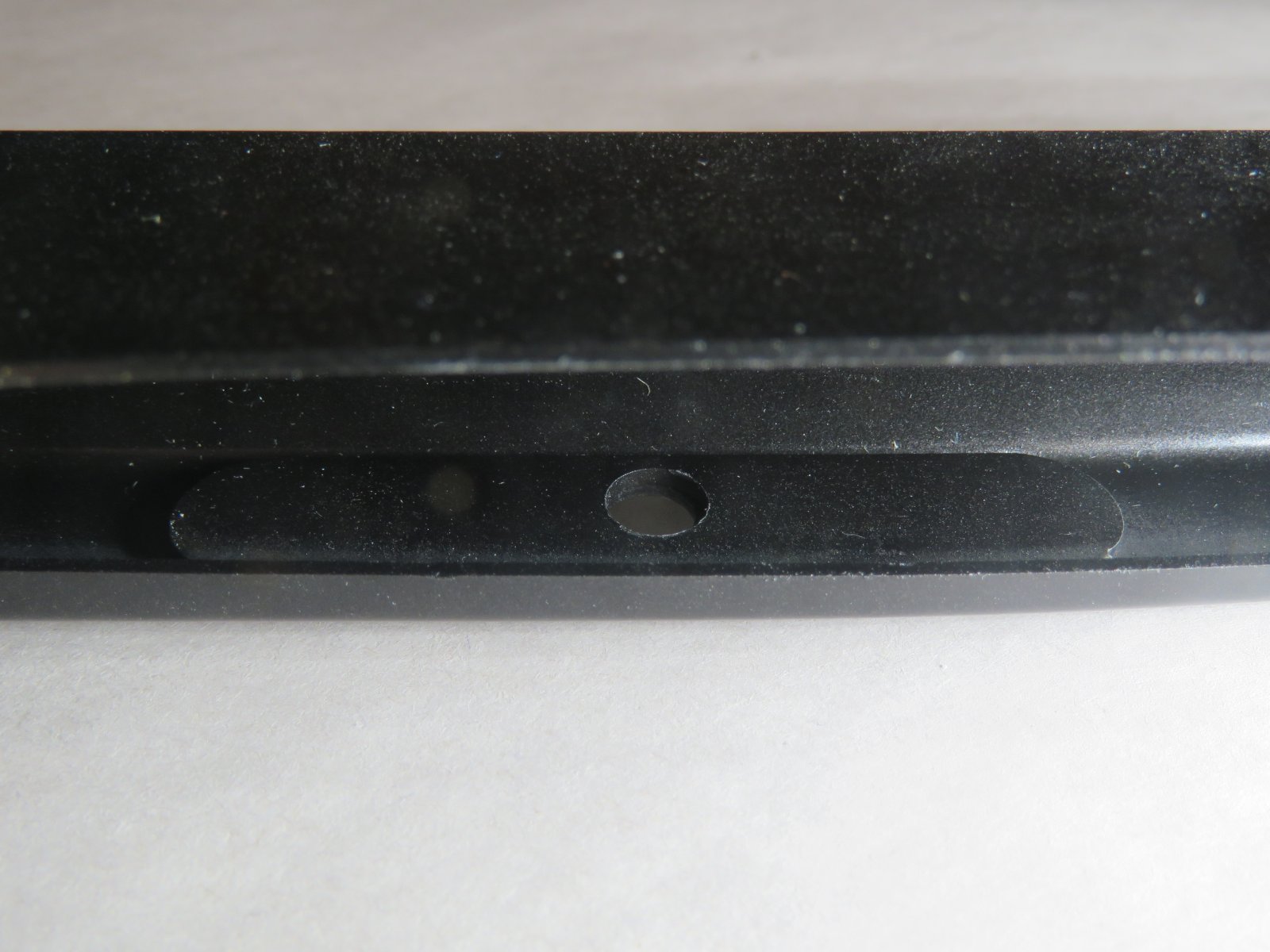

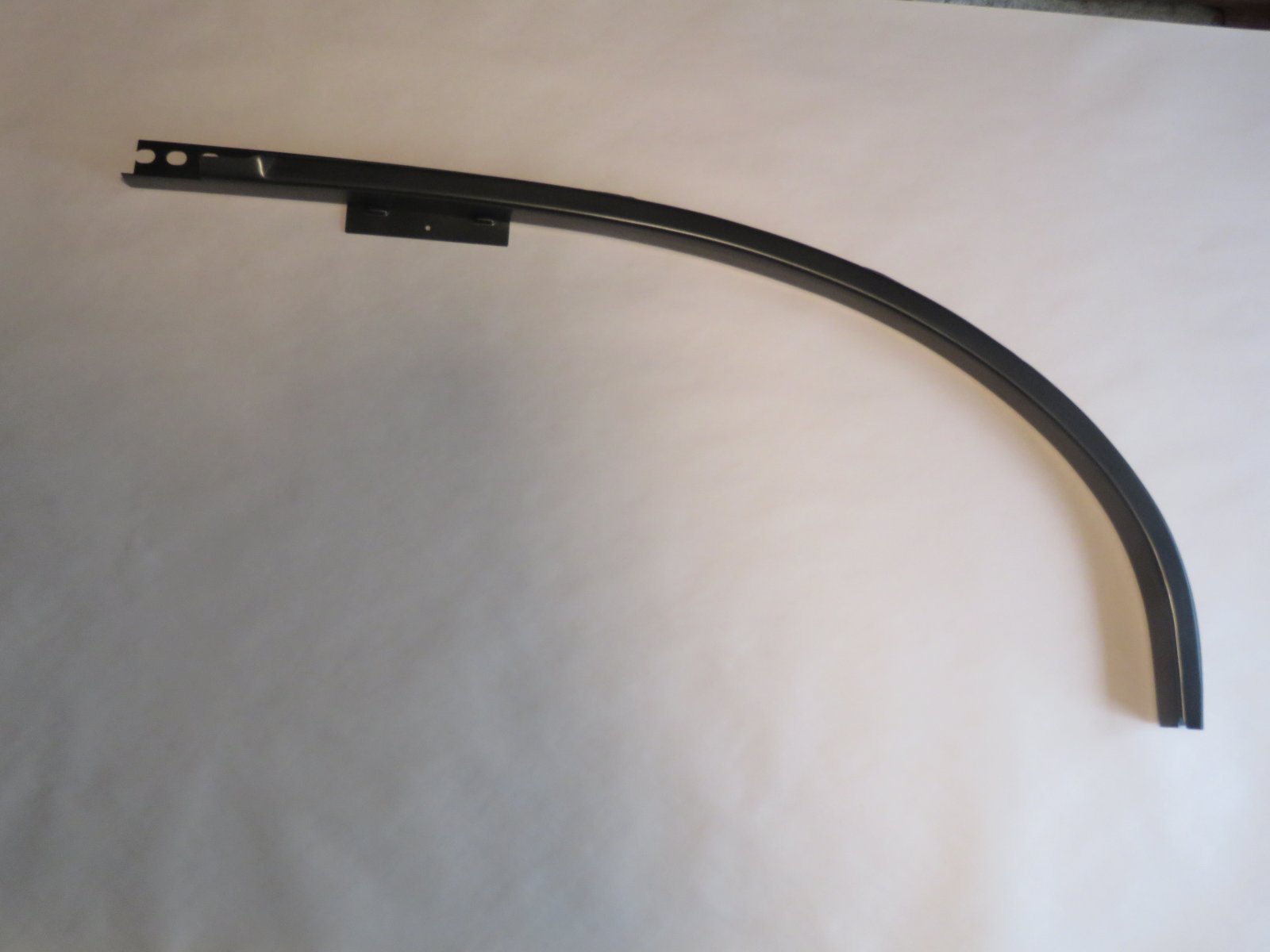

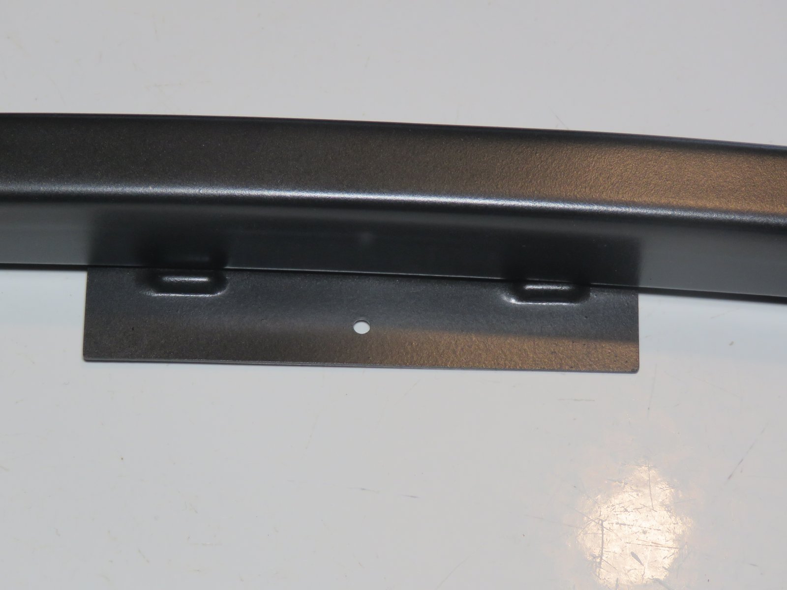

    The height of the channel is about 0.7" overall but tapers to about 0.5 - 0.625 at the end as it curves down at the back. IMG_4742.JPG
    V8-m likes this.

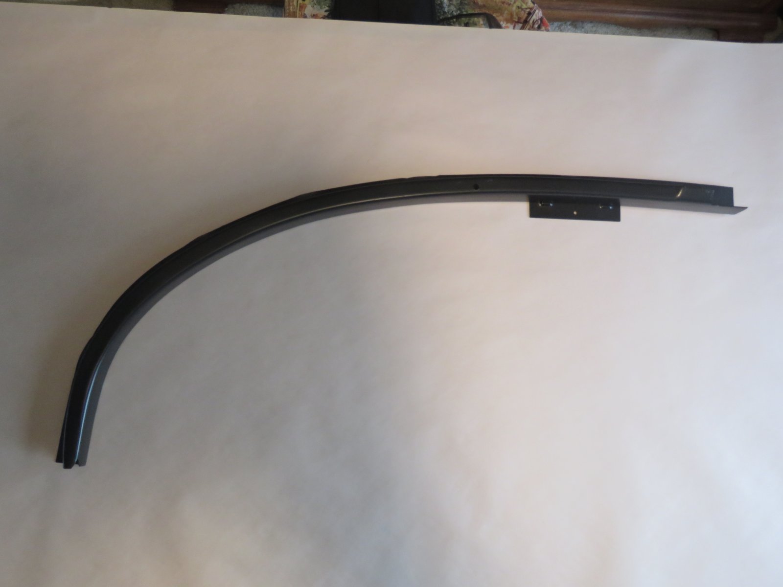

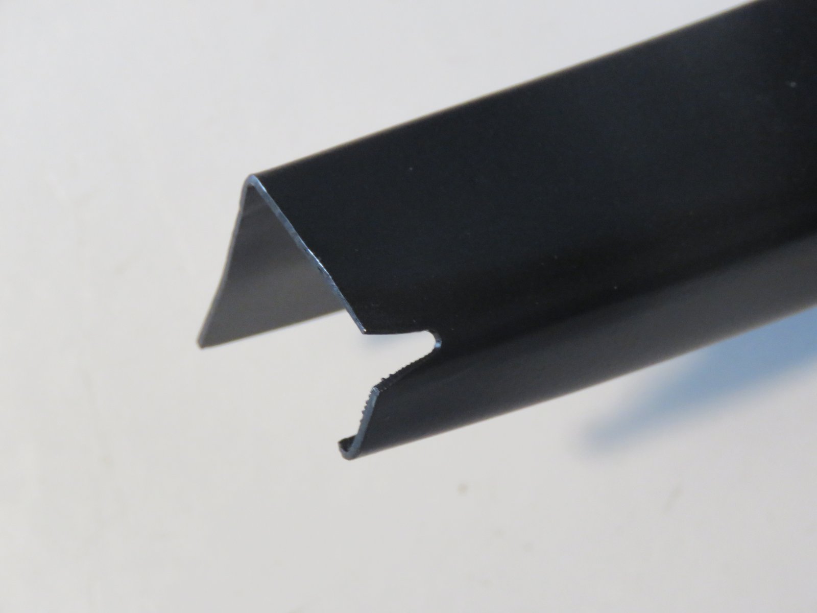

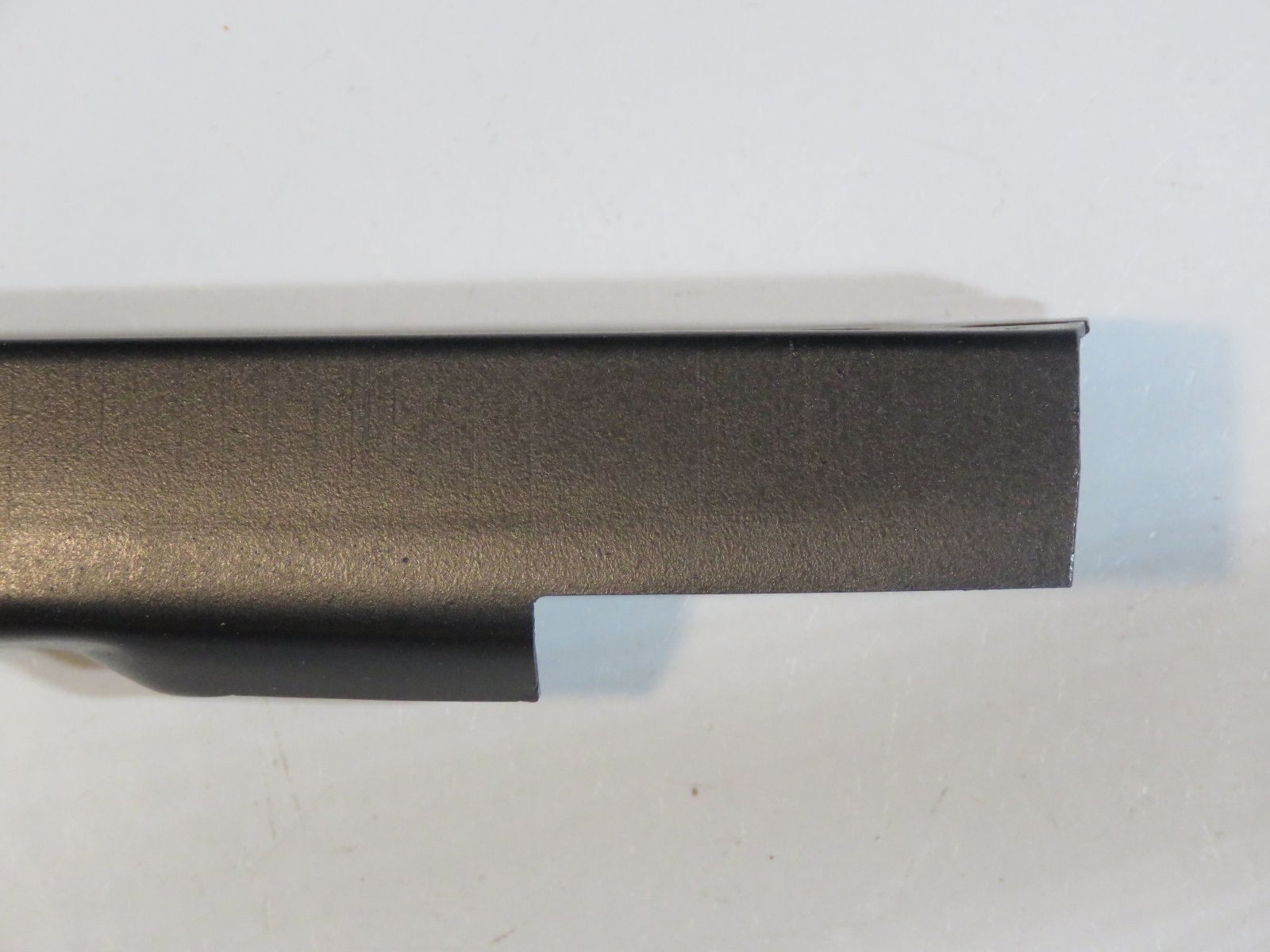

    V8-m likes this.

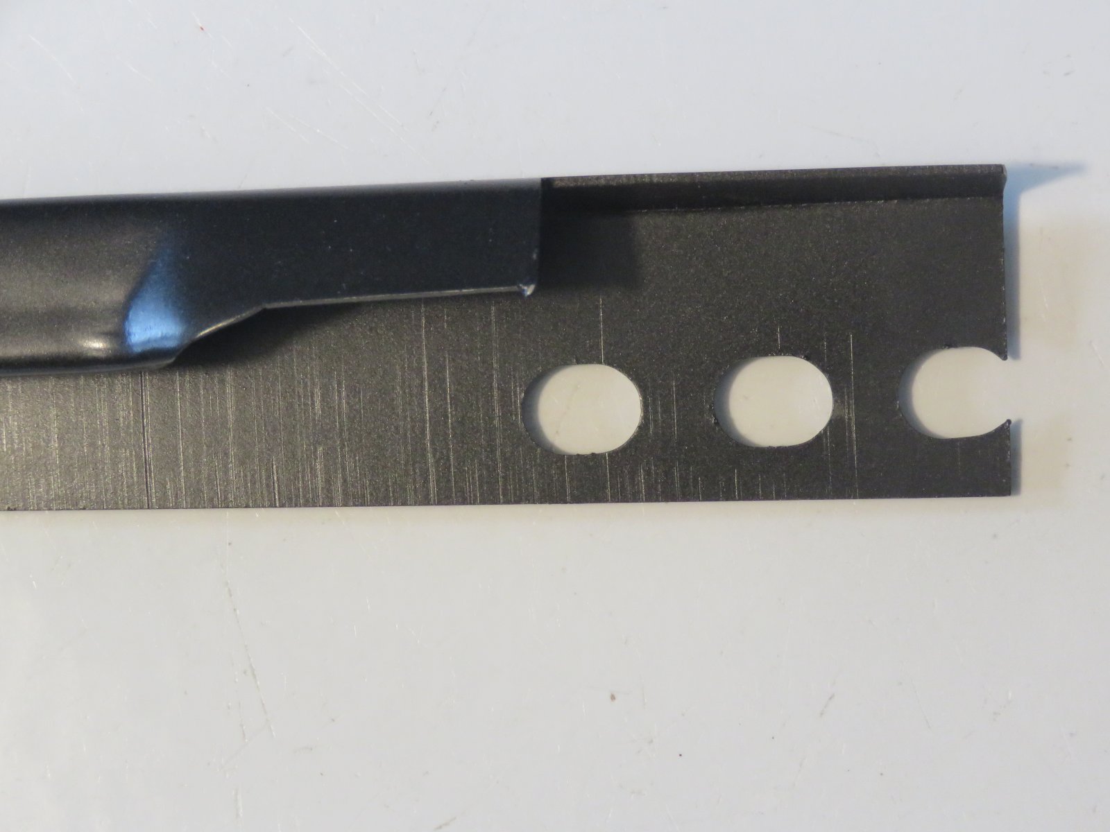

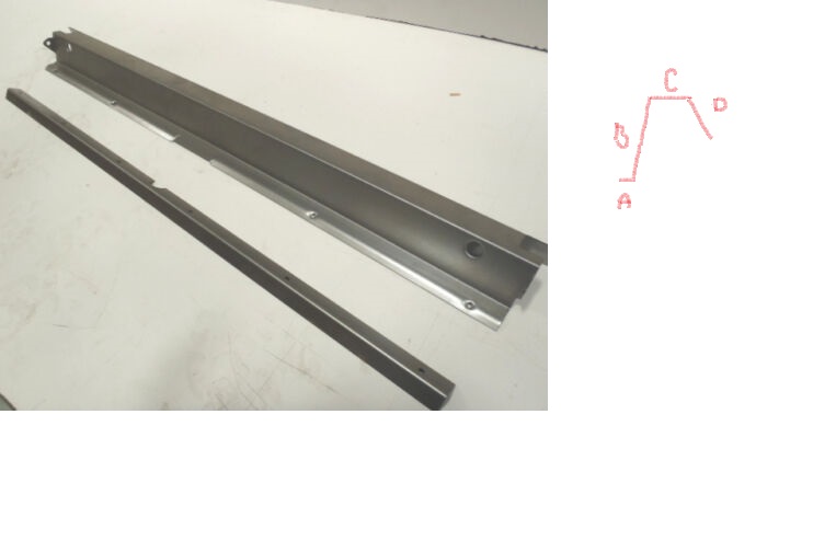

    PM me your address and I'll send along the tracings.
    IMG_4744.JPG IMG_4749.JPG IMG_4744.JPG IMG_4750.JPG IMG_4749.JPG IMG_4761.JPG IMG_4764.JPG IMG_4765.JPG
    clem and Budget36 like this.

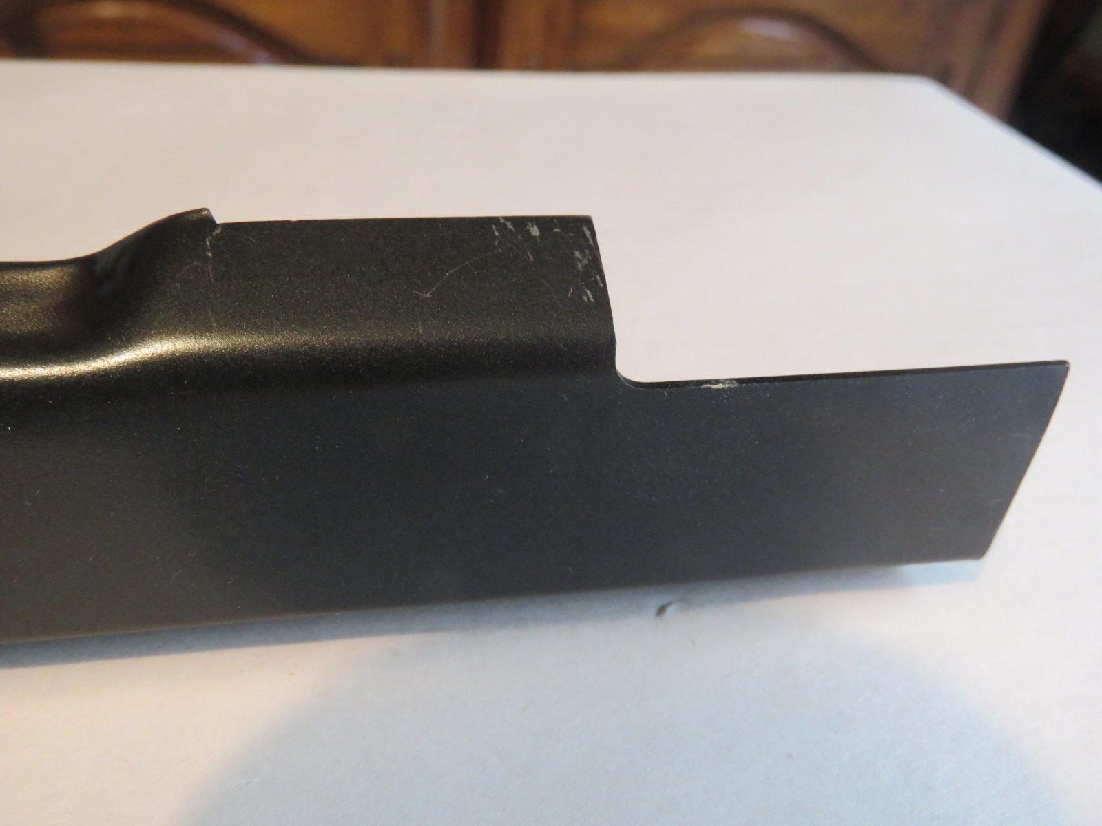

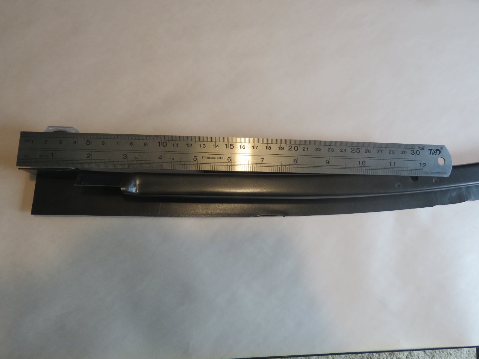

    V8-m likes this.

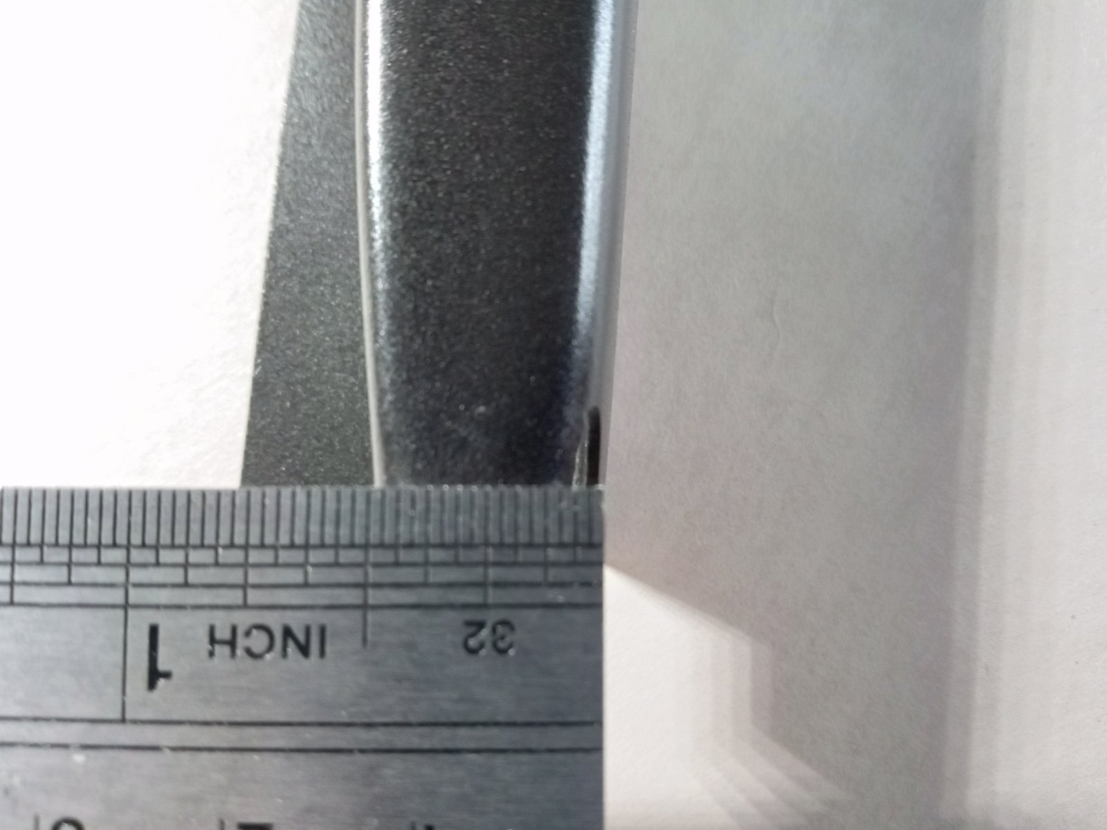

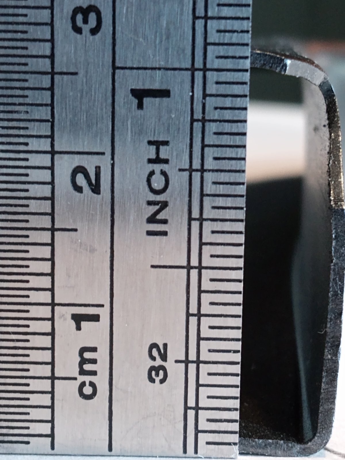

    Awesome ! One question: on the last picture total high seams to be 2,5 inch.. am i right?

    The channel is only about 1.25" it varies as the top edge that gets hidden behind the quarter is quite uneven. You'll see this on the tracings. IMG_20221127_160215190.jpg
    V8-m likes this.

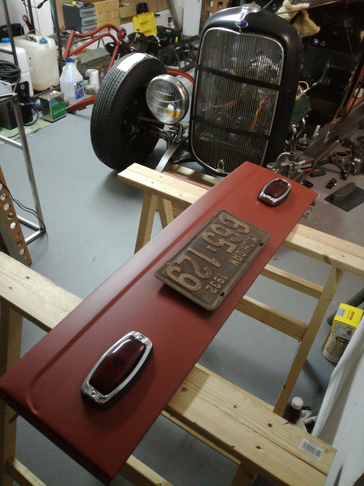

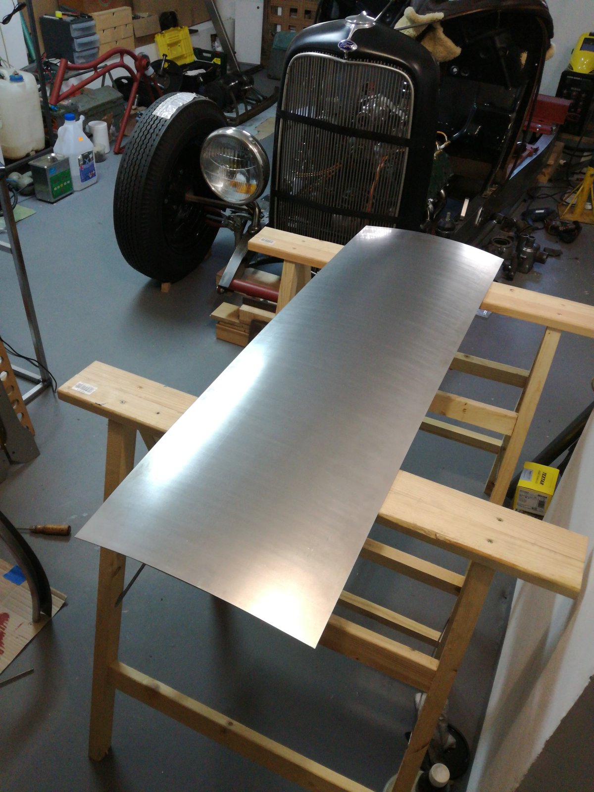

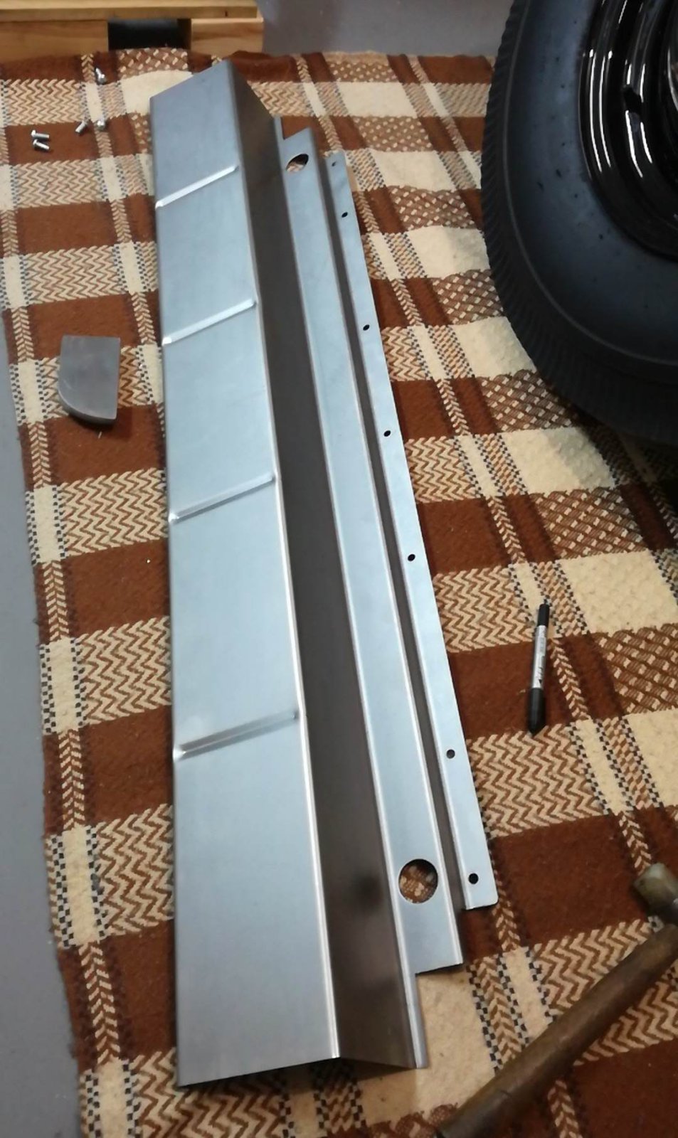

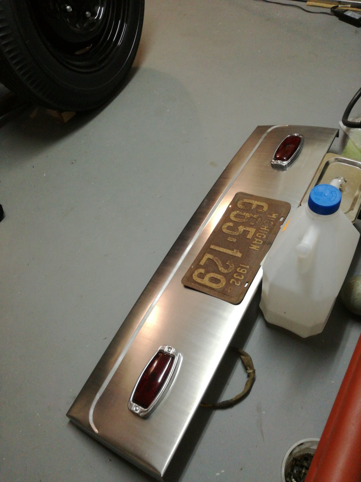

    Hello guys, panel made
    deuceguy likes this.

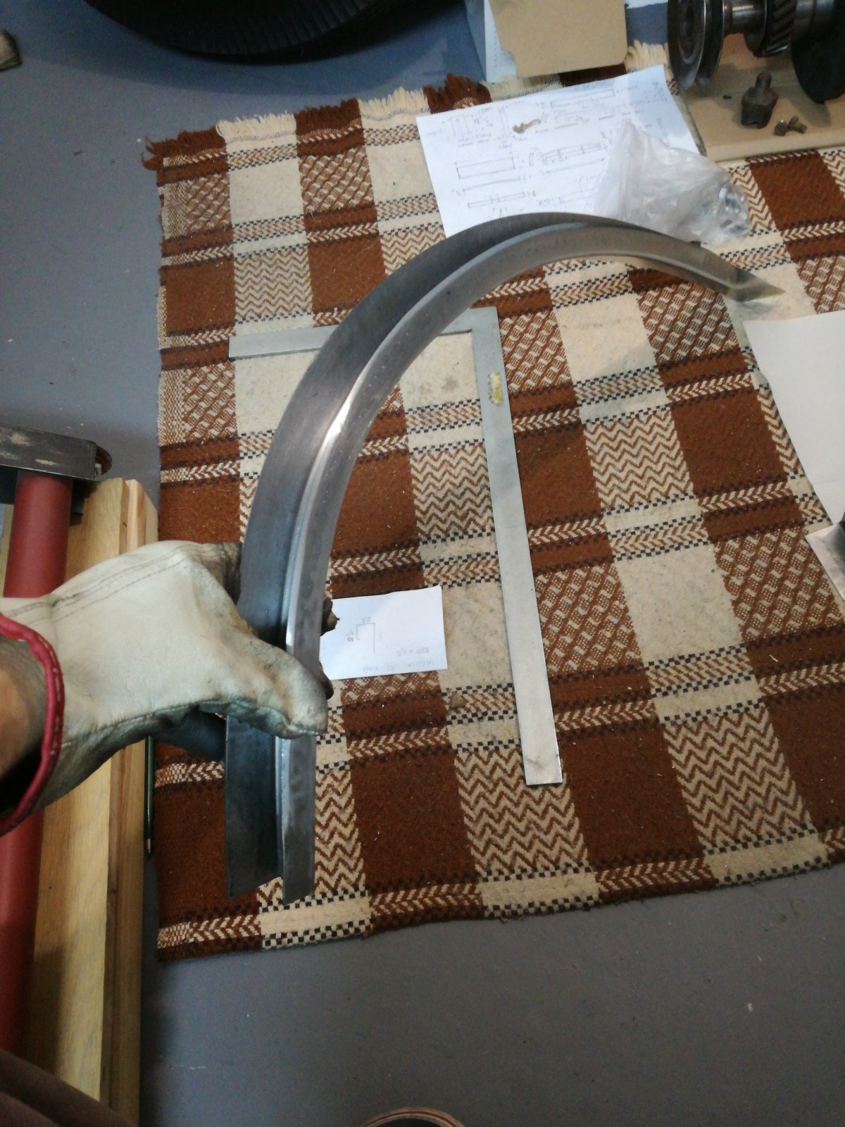

    So.... after some time I'm back. Thanks @deuceguy I could make some progress.
    All hand made with shrinker and stretcher, hammers , brake. Thanks again for help!

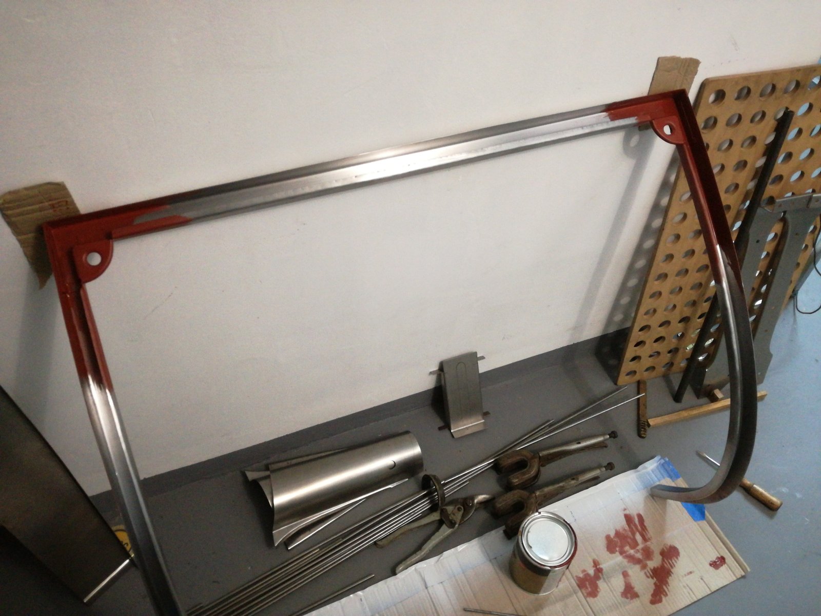

    Today i finaly spot welded it and partly painted with primer.

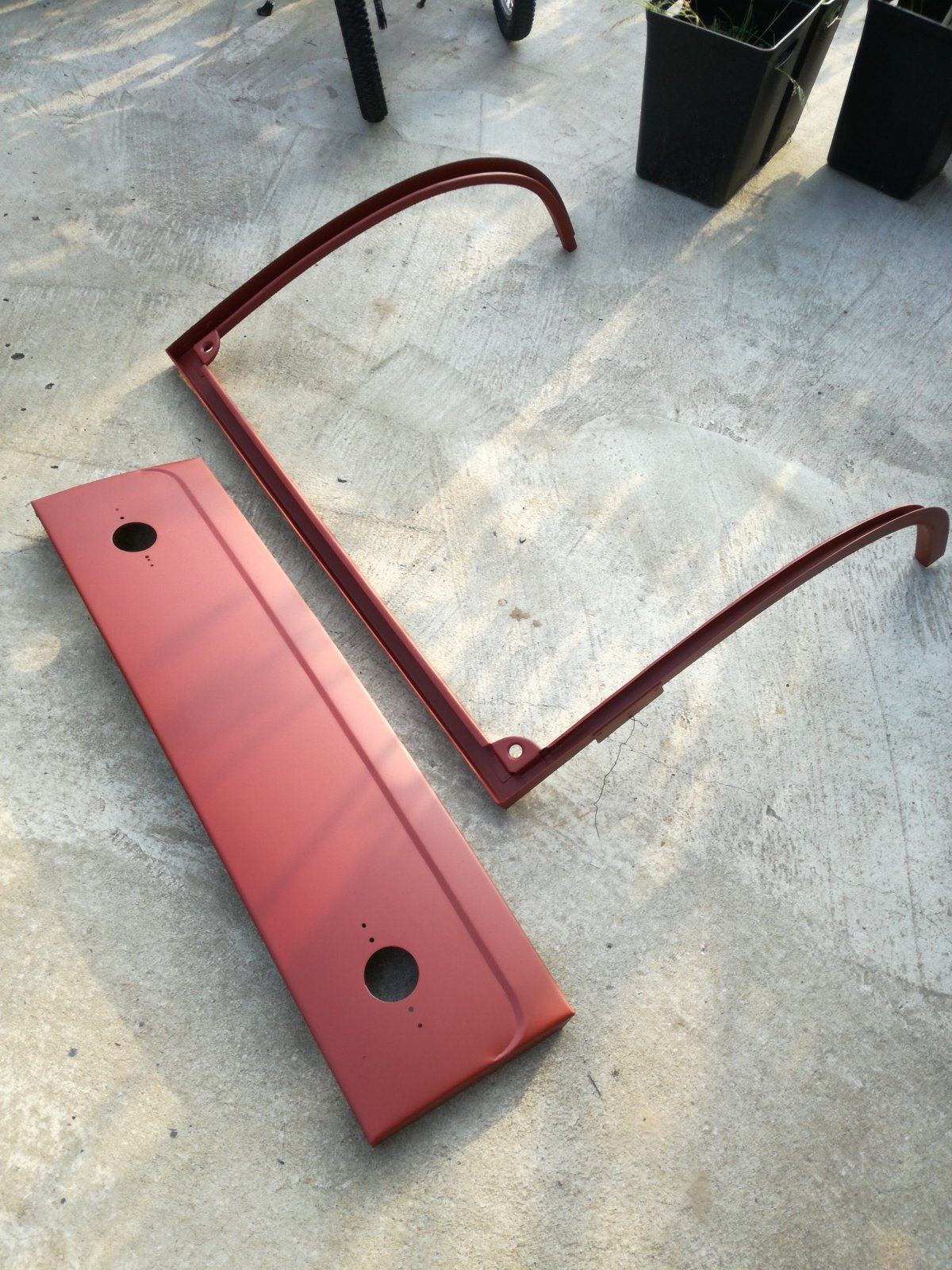

    Yesterday painted with red oxide primer together with hand made rear panel.
    Thinking about starting my own thread....
