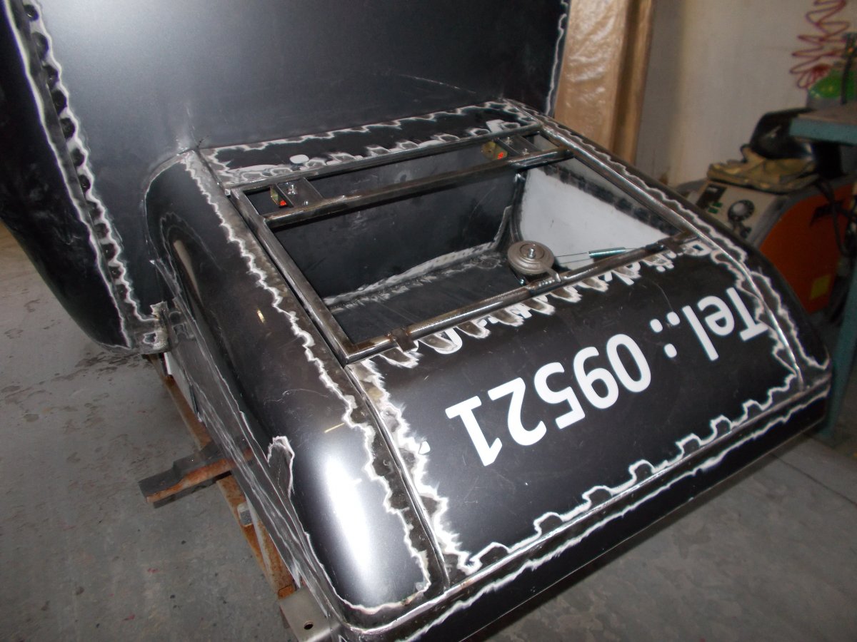

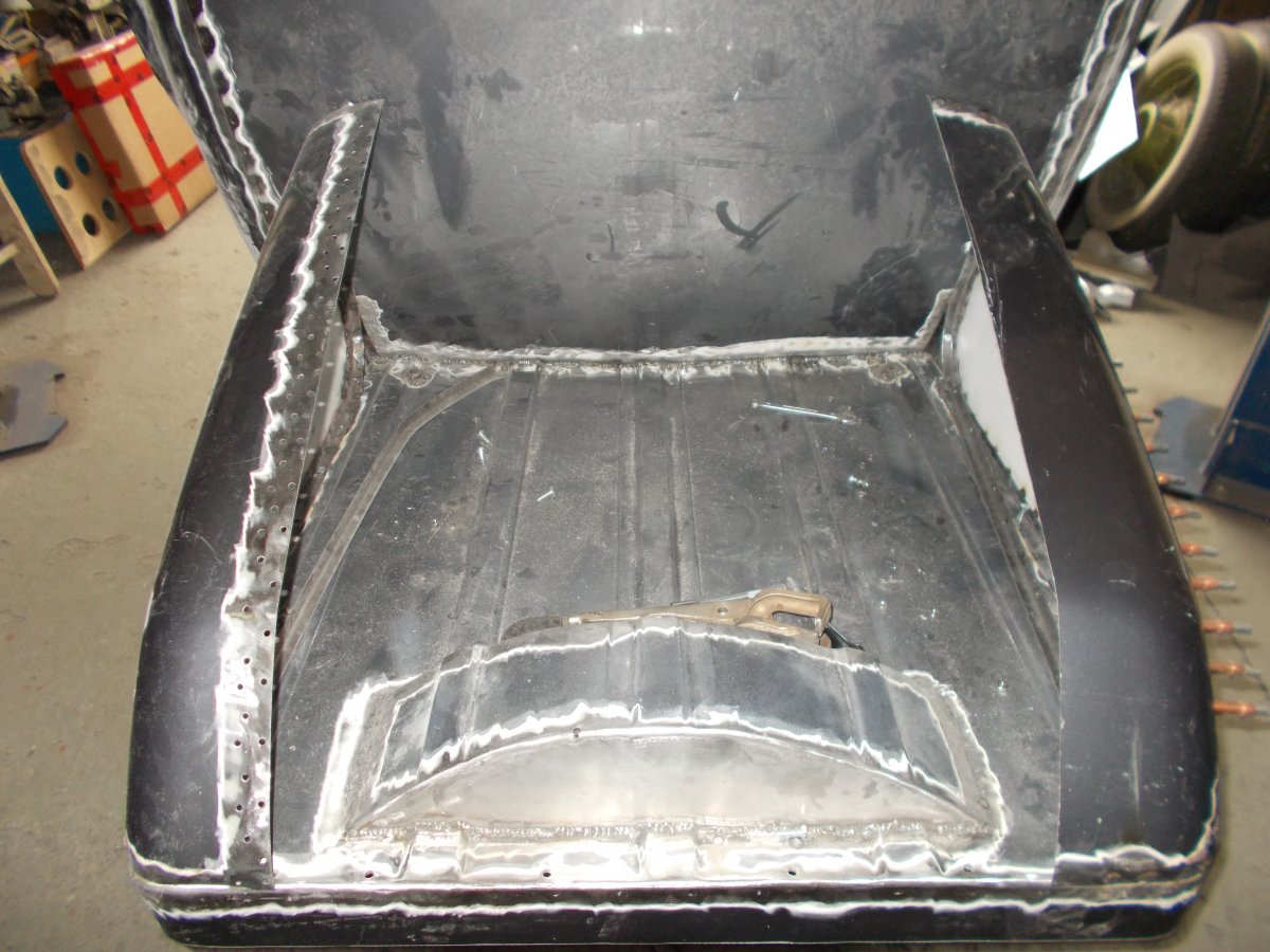

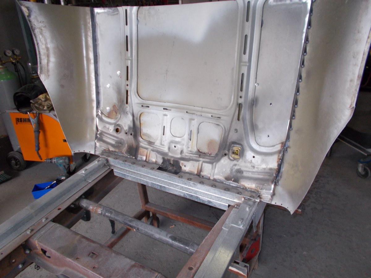

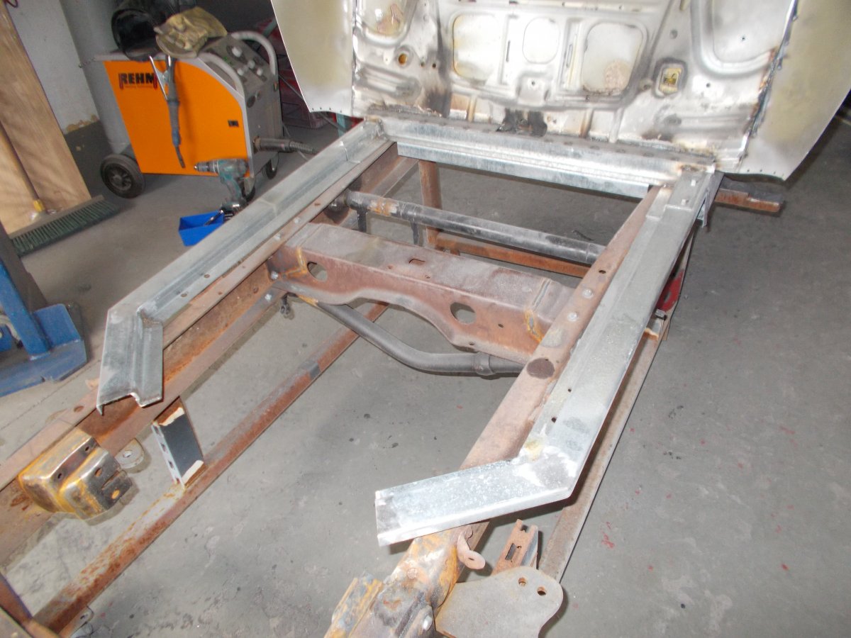

    So I made a start and forgot to take photos until I got this far.
    I've made up the Model-A frame and I narrowed it quite a bit to make it more T like. This entails narrowing the engine mounts and the two brake cross bars too. I also lowered the engine 1 1/2" at the front and 1/2" at the rear.
    I started by welding up a full length subframe out of some industrial shelving profile I found lying around. Then I used the roof panel from the Courier to make the trunk floor.
    The rear of the bucket is made of the hood (narrowed) with the fenders welded on. I worked out that the hood, split down the middle would also make perfect bucket sides so I bought an additional hood from a junkyard.
    The trunk isn't 100% authentic. It's higher at the front than a typical 15ish roadster but as I want to put the gas tank in there I figured it wouldn't hurt to have a little more space.
    Although it's not 100% authentic I've tried to build in typical Model-T styling cues like the skirt around the subframe below the trunk and the little triangular filler pieces between the lower bucket and the trunk.
    DSCN0823.JPG DSCN0824.JPG DSCN0825.JPG DSCN0826.JPG DSCN0827.JPG DSCN0828.JPG

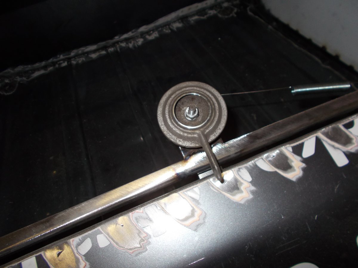

    Today I made the frame for the trunk lid together with a latch made out of a '32 light switch I had in one of my boxes of junk.
    I've ordered a beading machine so I'll wait til that arrives before making the skin.

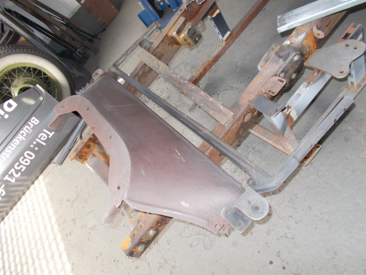

    Unfortunately the Model-T firewall I bought in Canada is too wide for the cowl top I have. The firewall is a '19-'23, my cowl must be earlier so I'll have to chop it down to fit.

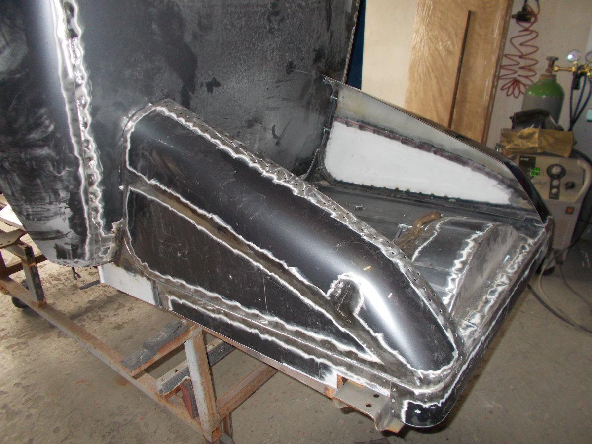

  18. edwardlloyd
    Joined: Aug 2, 2003
    Posts: 2,074
    edwardlloyd
    from Germany
    Is some pictures of how it looks today. Obviously this project will need some filler;-)

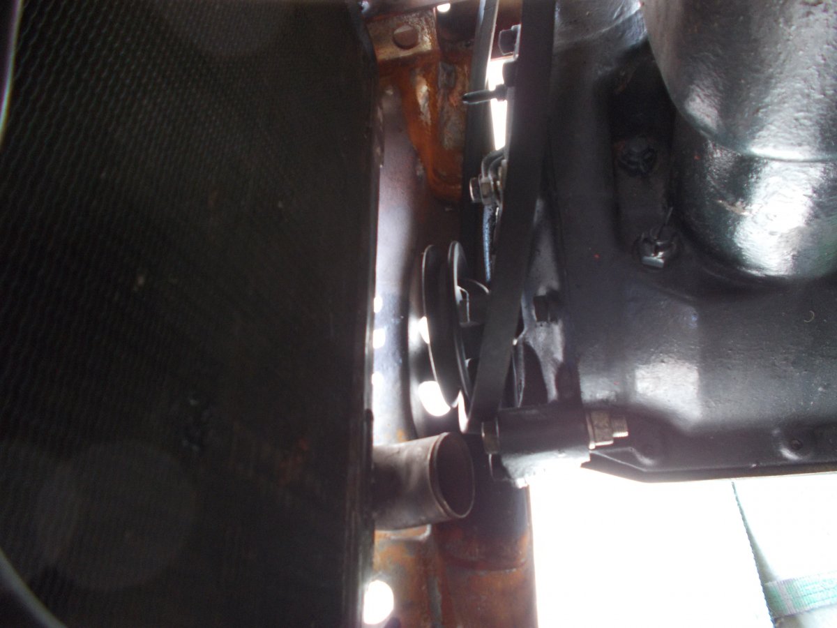

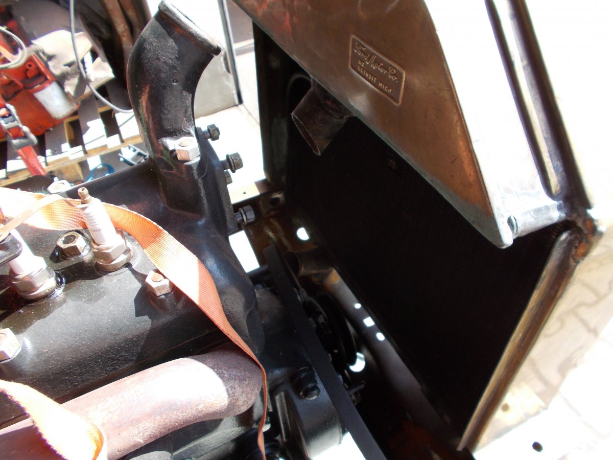

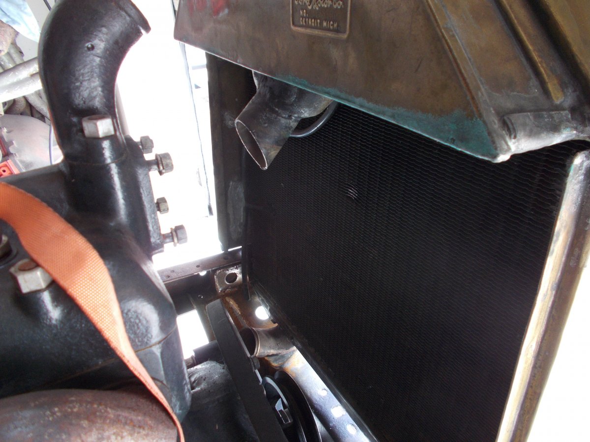

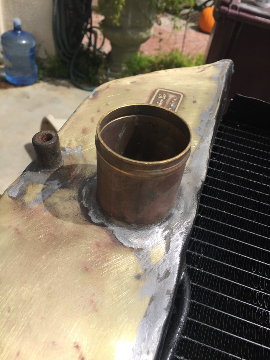

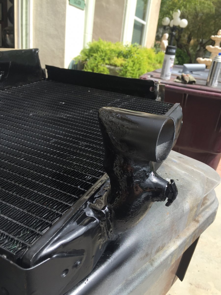

    I don't think anyone has ever fitted a Model-A engine behind a 1915 br*** radiator. Nothing wants to fit! No space for a fan. The water pump wants to share space with the upper radiator outlet.
    Unless anyone can show me some amazing tricks, I think I might have to use an electric water pump and an electric fan. I'm not to bothered about the electric pump, but I would like a mechanical fan.
    Even the lower radiator outlet interferes with the generator bracket, but that can be cut back a bit. DSCN0811.JPG DSCN0815.JPG DSCN0818.JPG

    "Unfortunately the Model-T firewall I bought in Canada is too wide for the cowl top I have. The firewall is a '19-'23, my cowl must be earlier so I'll have to chop it down to fit."
    Model T firewalls from their beginning through the early part of the '23 model year were made of wood. Ford switched to steel in about April of 1923. That firewall was the same size as the '15-'23 wood ones and had three vertical ribs stamped into it. In June of 1923, Ford began producing the '24 model cars, which had wider and taller firewalls. Those have five vertical ribs. You might have a '23 or earlier cowl top and a '24-5 firewall. If you were here in the States it would be easy to find a steel '23 firewall. Even though they were used for only 3 or 4 months, there are plenty of them still around. It's probably not so easy to find one in Germany.

  24. Amy
    Joined: Oct 10, 2010
    Posts: 81
    Amy
    We fitted a br*** radiator behind a 51' Nash straight 6. Not really the same as model a but it was a challenge.

    Indeed, I have a 5 rib firewall which is nearly 4" wider. So today I narrowed and shortened it and it now fits my cowl.

    from Germany
    I didn't really want to alter the '15 br*** radiator, but now I've seen how good yours looks, I think I'll go that route. That will at least allow me to run the stock water pump. Just leaves the fan to be solved.

    Forgot to mention that we were not able to make the mechanical fan work... So it looks like we are going the electric fan route. Still trying to find a way to hide it or make it not nearly as noticeable, since there is no hood on the car.
    Also we didn't want to alter the outlets on the radiator but decided it was better to have the outlets relocated then to have a pretty ugly radiator hose wrapping all over the place.

    Yes I feel a bit guilty about modifying a 101 year old radiator, but it's probably the best way to solve the problem. I do have a br*** shroud which may fit. That would hide the fact that the fan is electric. I'll measure it and check. However I haven't a clue what car it's off.
