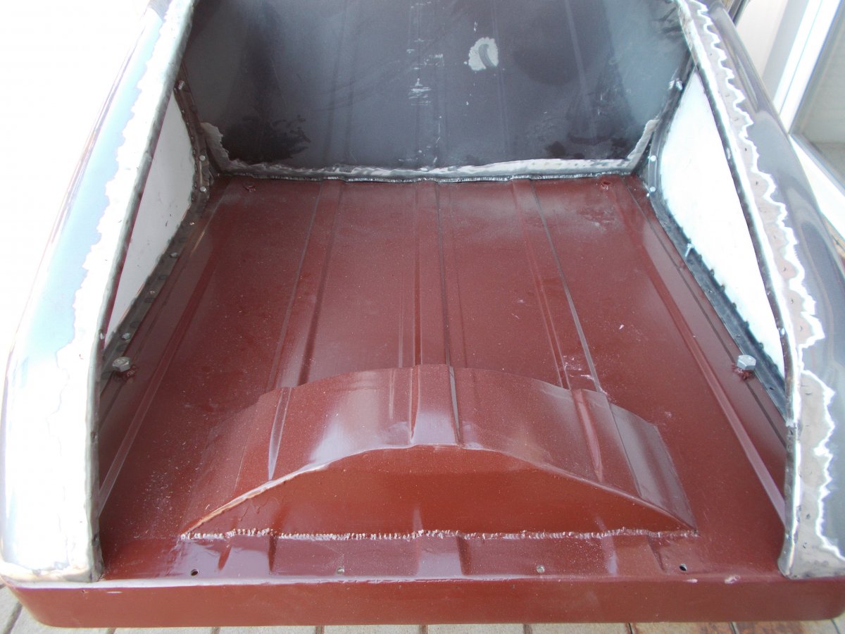

    Got some more pictures here with the trunk floor painted. The Fiesta hood cut in half forming the sides of the bucket. I have attached it using tiny 4mm nuts and bolts and won't weld it in place until I've done all the work needed on the side (doors, hinges, top edge beading etc.) The 4mm holes are easier to weld up in the end. Also the sides are much higher than they will end up being but that will be dealt with later. Also one side will need a door working into it.
    Amazingly the captive nuts where the hood was originally attached to the hinges ended up at the base of the A-piller so I was able to use them to attach the sides to the subframe.
    DSCN0857.JPG DSCN0858.JPG DSCN0859.JPG DSCN0860.JPG DSCN0861.JPG DSCN0862.JPG

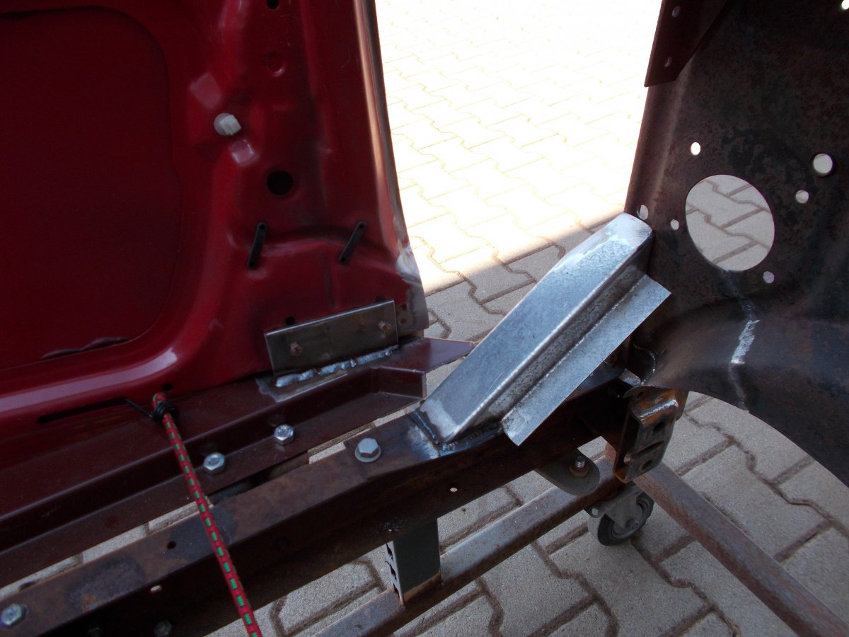

    Yesterday I also triangulated the firewall feet a bit like the way '32s are done. Now the firewall is rigid. Now the tricky bit will be making those compound curved cowl side panels. I'll need to have a trawl through all that Ford Courier sheet metal I've got;-)
    The brown color on the trunk floor is the final color. It's actually a rust proofing semi matt paint and that's all it's getting. The firewall and cowl top will remain the way they are. I find them so beautiful as they are and don't want to cover them up with paint.

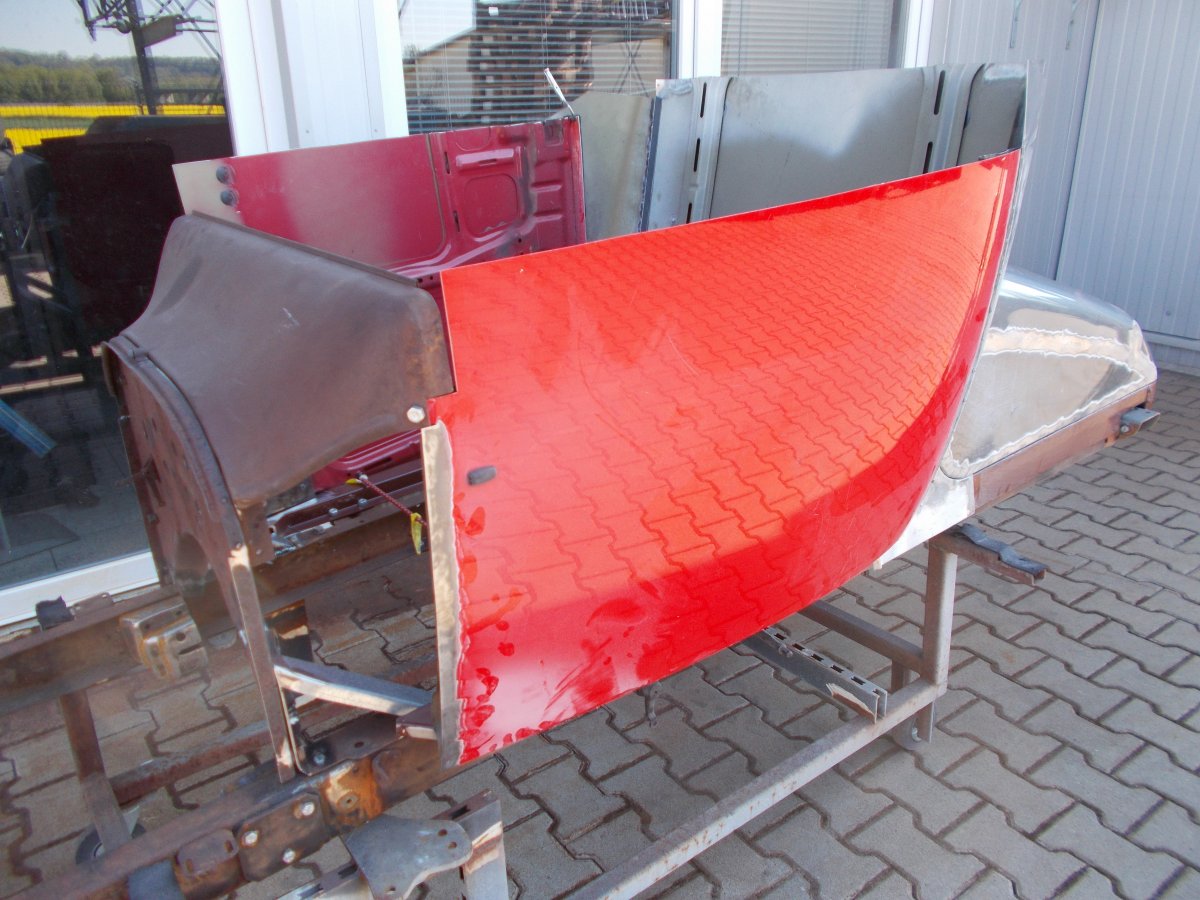

    Next up the lower cowl panels. These made me think a lot first because the panel curves in both ways a most panels do, but at the bottom its convex and at the top it's half convex and half concave, so how does that happen?
    Only way to find out, grab a piece of metal. First off I want to say how impressed I am with the late 1990's Ford steel. It's so malleable you can form it into shapes with your bare hands. It's like plastic! It welds well with little distortion as long as you remove all traces of the zinc coating.
    Now I was needing a panel with flanges on three sides and as you all know getting that out right first time is impossible, so I didn't try. First I made the flange which will weld to the firewall out of a tapered double flanged piece I found where they place those dummy windows on the sides of deliveries.
    Next I cut my side cowl panel a little oversize out of the Fiesta door skin.
    Then I folded a flange at the top and bottom. The top one angles up to follow the Model-T cowl, and the bottom one angles a bit down to meet the side of the bucket. Once the flanges are bent on the convex door skin suddenly trys to go flat and gets all confused in the process. Then using my shrinker and stretcher tools from Eastwood I put curves back into the panel and after much adjustment it fitted perfectly. Amazingly that once convex panel did the complex twist I needed! As luck would have it the panel was then welded to the side panel, which used to be the Fiesta hood, and I could sandwich it between outside skin and the strengthening panel which is now my A-piller so it's already very rigid. Actually I think this car hood gives me a level of side impact protection I wouldn't have in a real Model-T.
    Here's some pictures. As you can see the door will be on the left side of the car because I'm building it RHD.

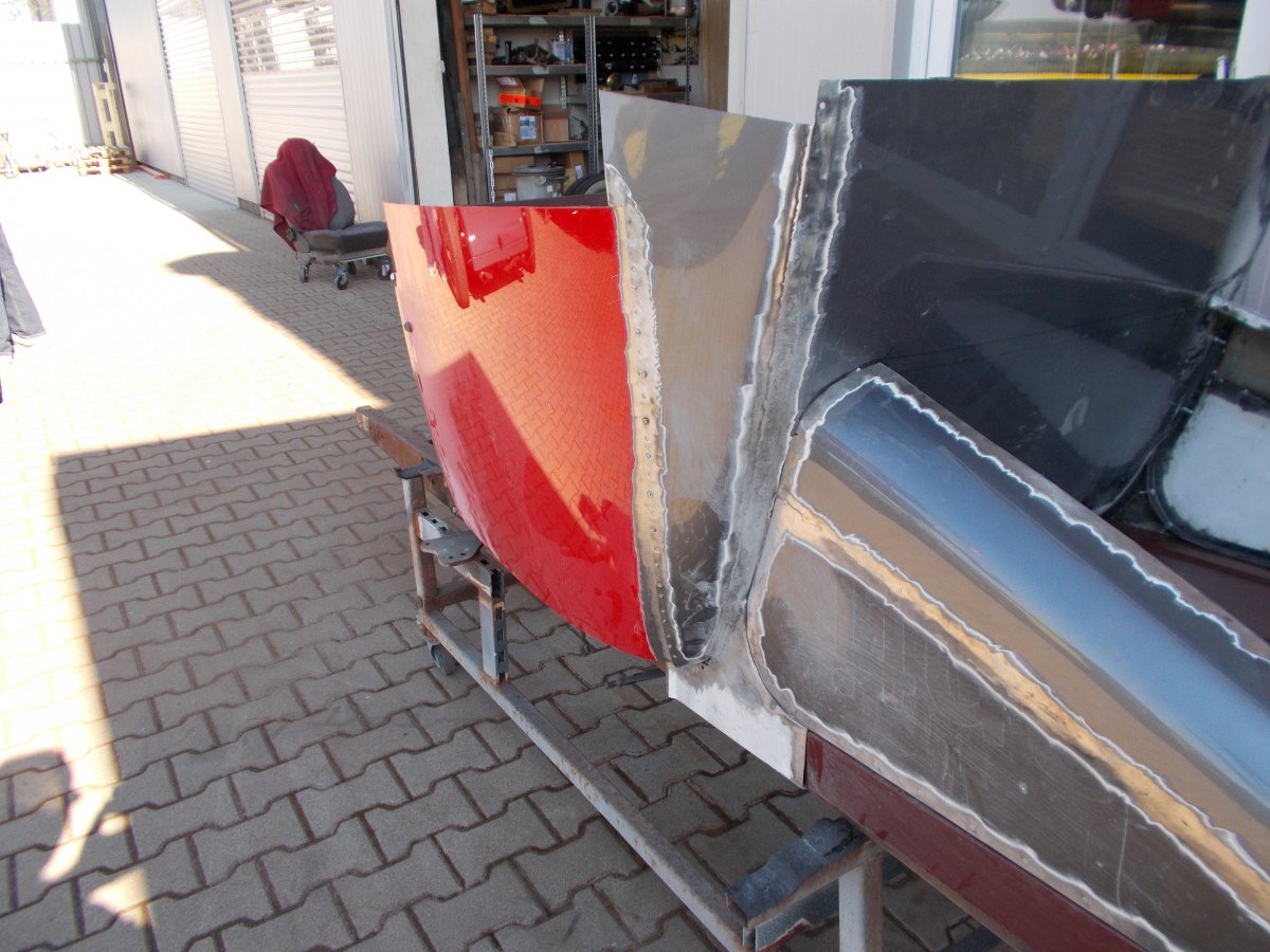

    The two cowl side panels took me 12 hours in all. Then yesterday I made up an inner door frame, or door jam if you like, from the top of one of those rear doors on the delivery. The part with the window in it. I cut it down, narrowed it 4" and welded it up again. Then I carefully cut out the inner bracing on the hood where the door jam was to sit and cut the A-pillar back a bit, so the door jam slide perfectly into place. Then I cut out the opening. It won't be welded in until my beading machine turns up and I can put the upper bead in the side panel. The inner door jam has a factory feel about it. Actually looks more modern than T's were but it's functional and will mostly be covered up anyway.
    Today I started on the door using the top of the other rear door from the delivery van.
    Once it's all welded up it'll be very rigid.
    More tomorrow.

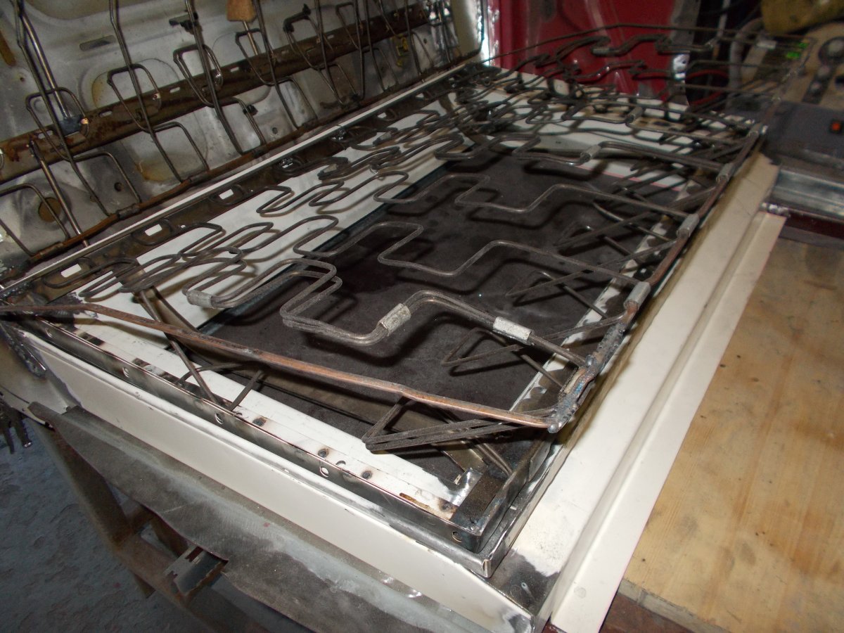

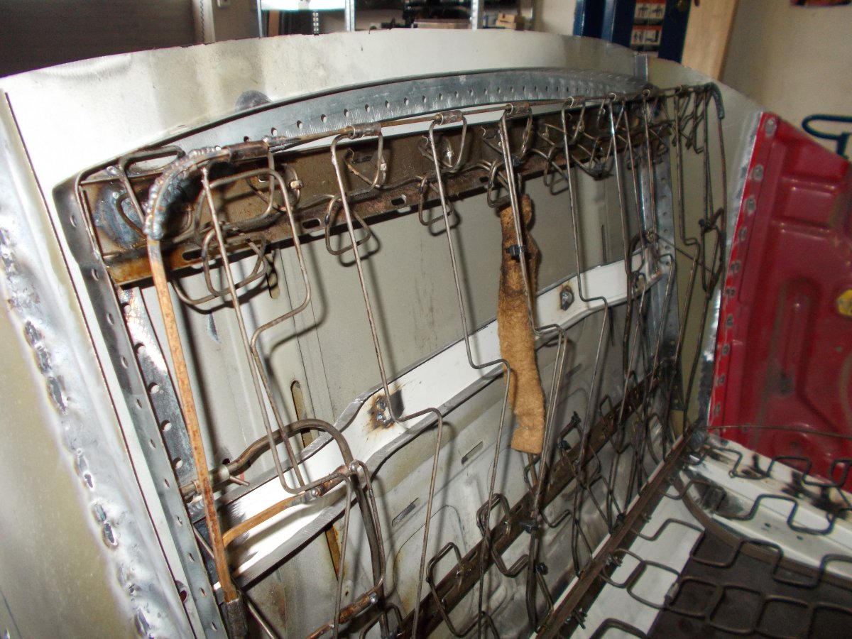

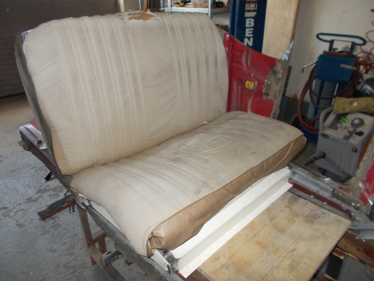

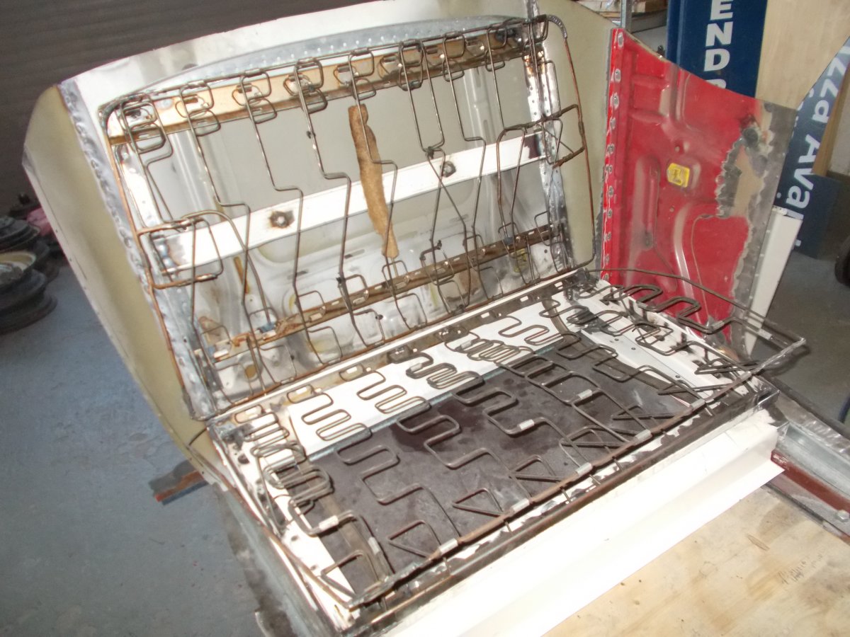

    I made up the seat now. I had an old 1970s MK2 ****** rear seat which was still wire framed like in the old days. I think many 70's compact cars still used sprung rear seats. The seat was too wide so I stripped the upholstery off and narrowed the frame. I also made up a seat base out of two old electric storage heaters which were made of a nice heavy gauge steel. I temporarily replaced the upholstery so I can test sit in the car - important for steering wheel and pedal placement.
    So even the seat is Ford! But the seat base is from AEG.
